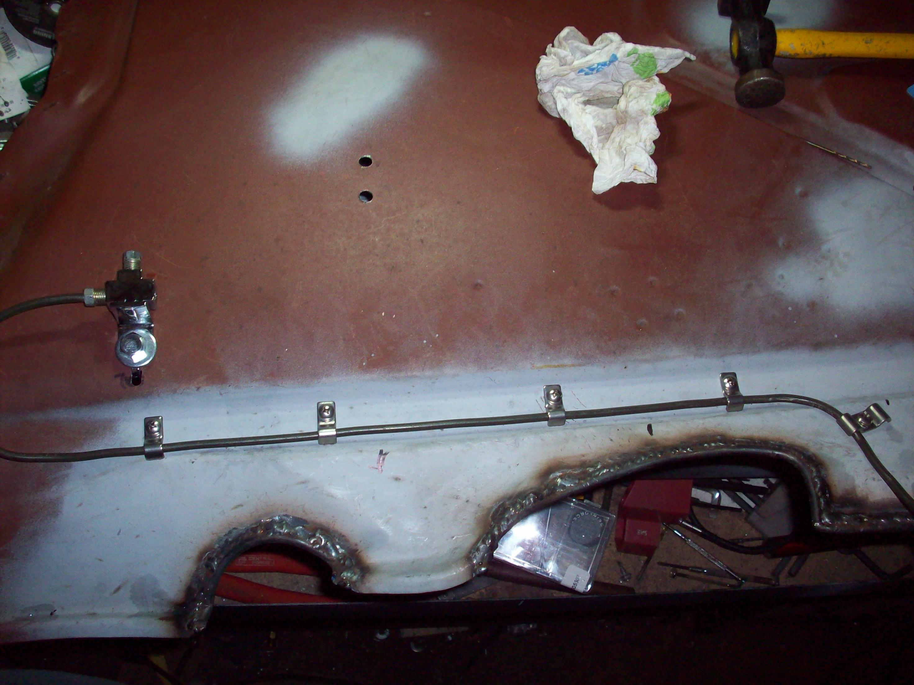

    Well I just got back from a week long vacation at Disney World and boy was it fun. I decided to get back to work on the brake lines and really got some good work completed today. I spent most of the day bending and straightening lines. I will finish my work tomorrow on them and then start working on the big line from the rear axle. Once everything is where I want it and ****oned down to the frame I will go get them double flared and that should be all she wrote :D
    Here are a couple shots

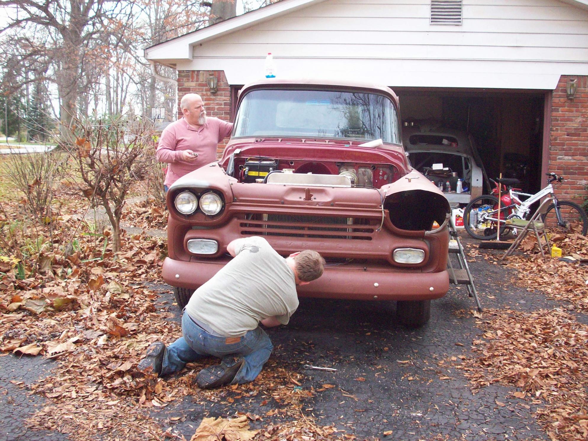

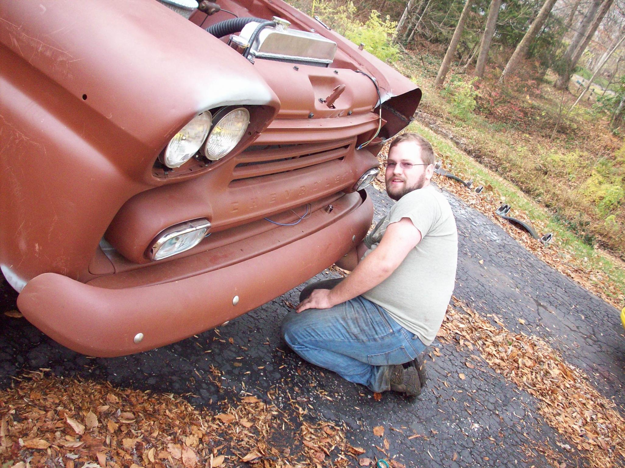

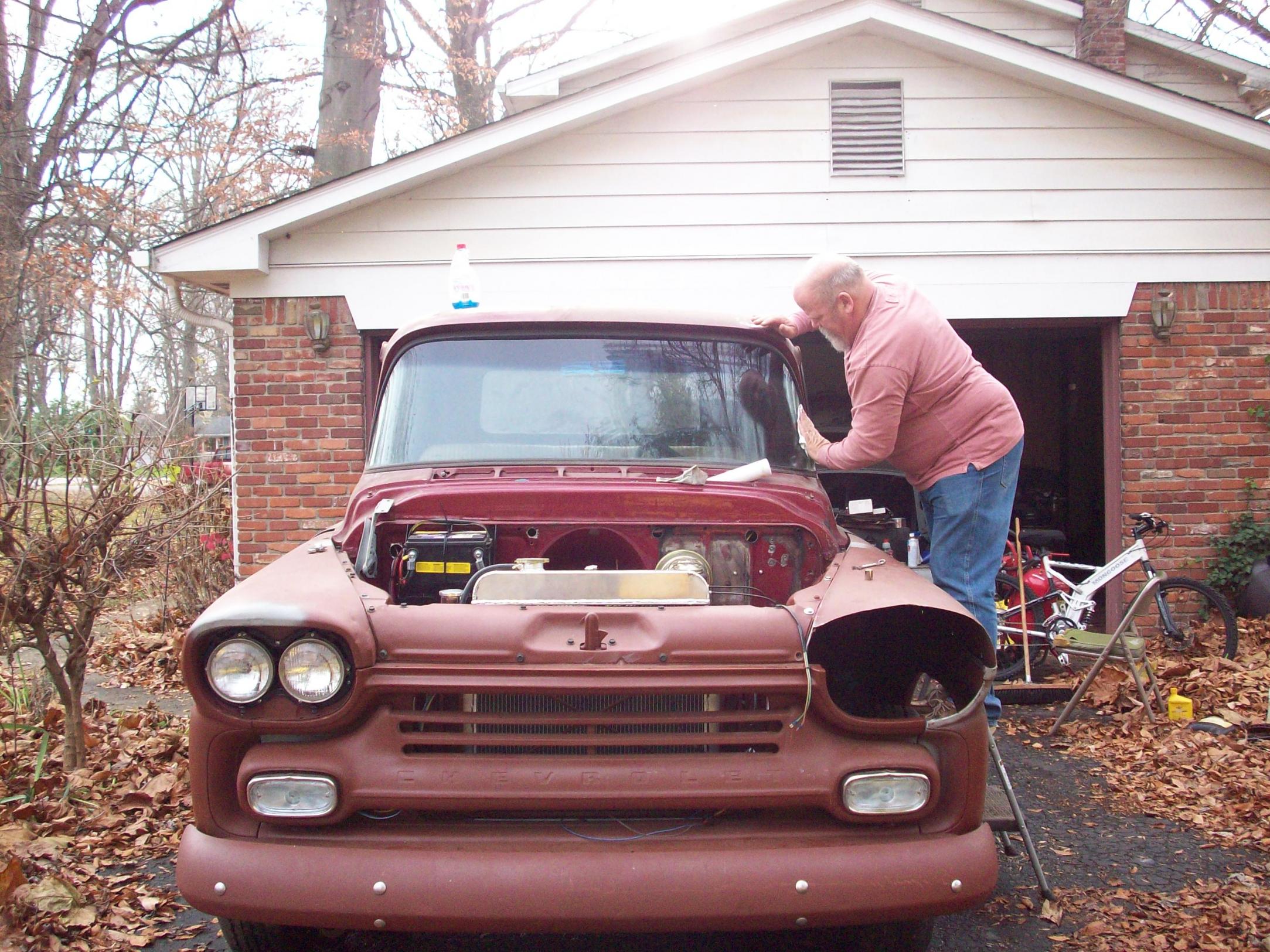

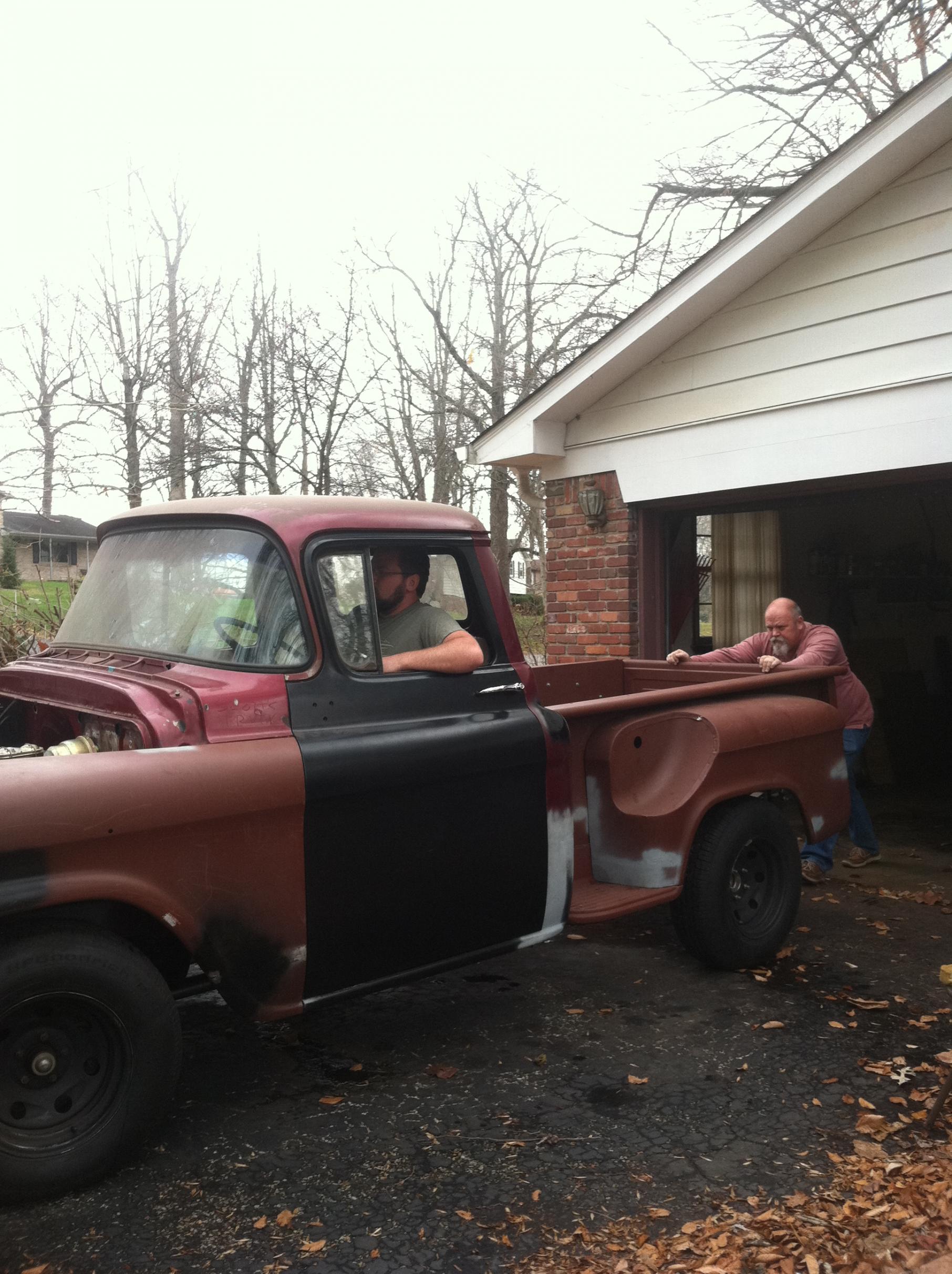

    Here are some pictures that Shannon took of my Dad and I working the truck:
  21. 1959apache
    Joined: Nov 22, 2009
    Posts: 2,635
    1959apache
    Here are some more

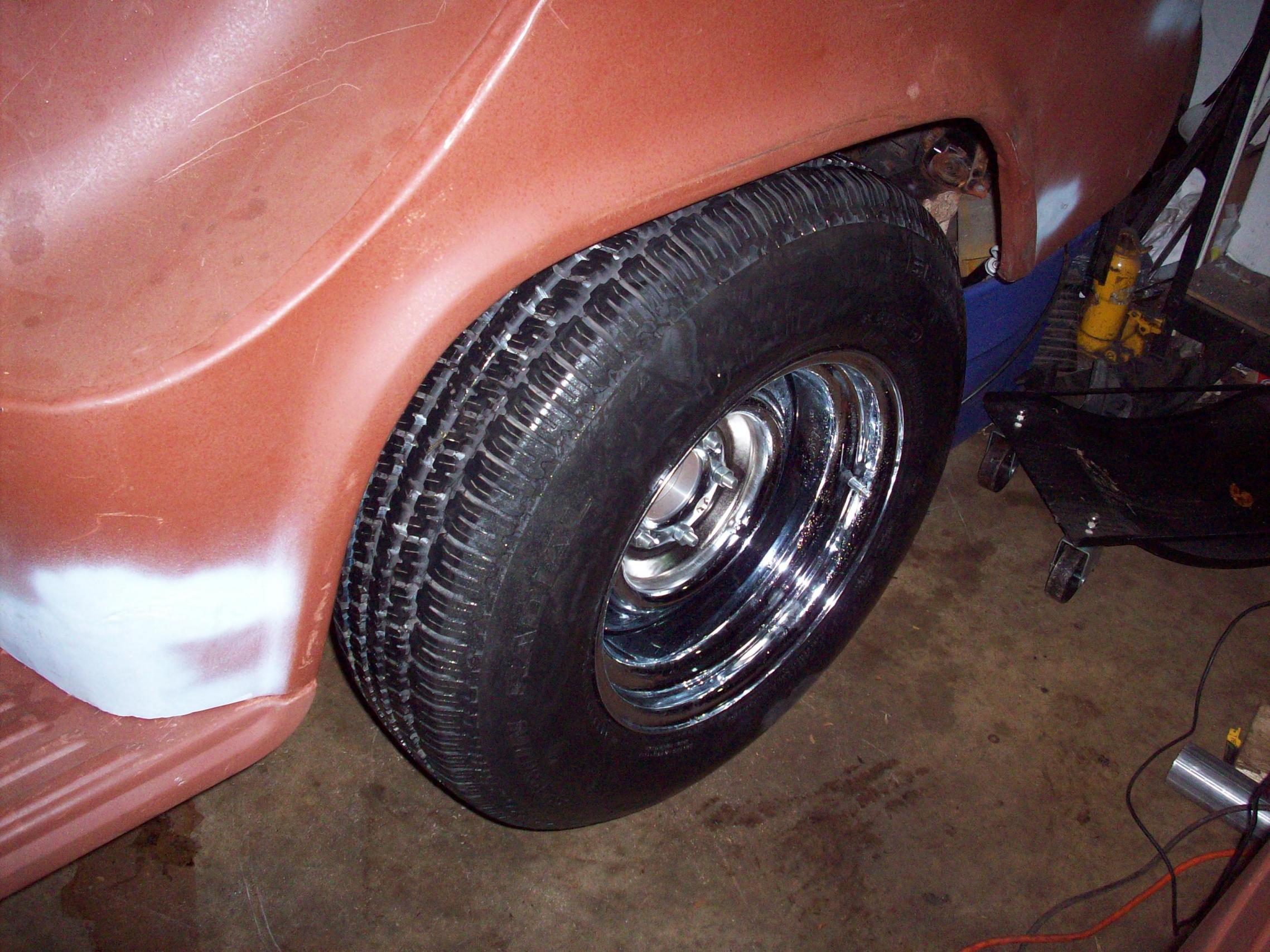

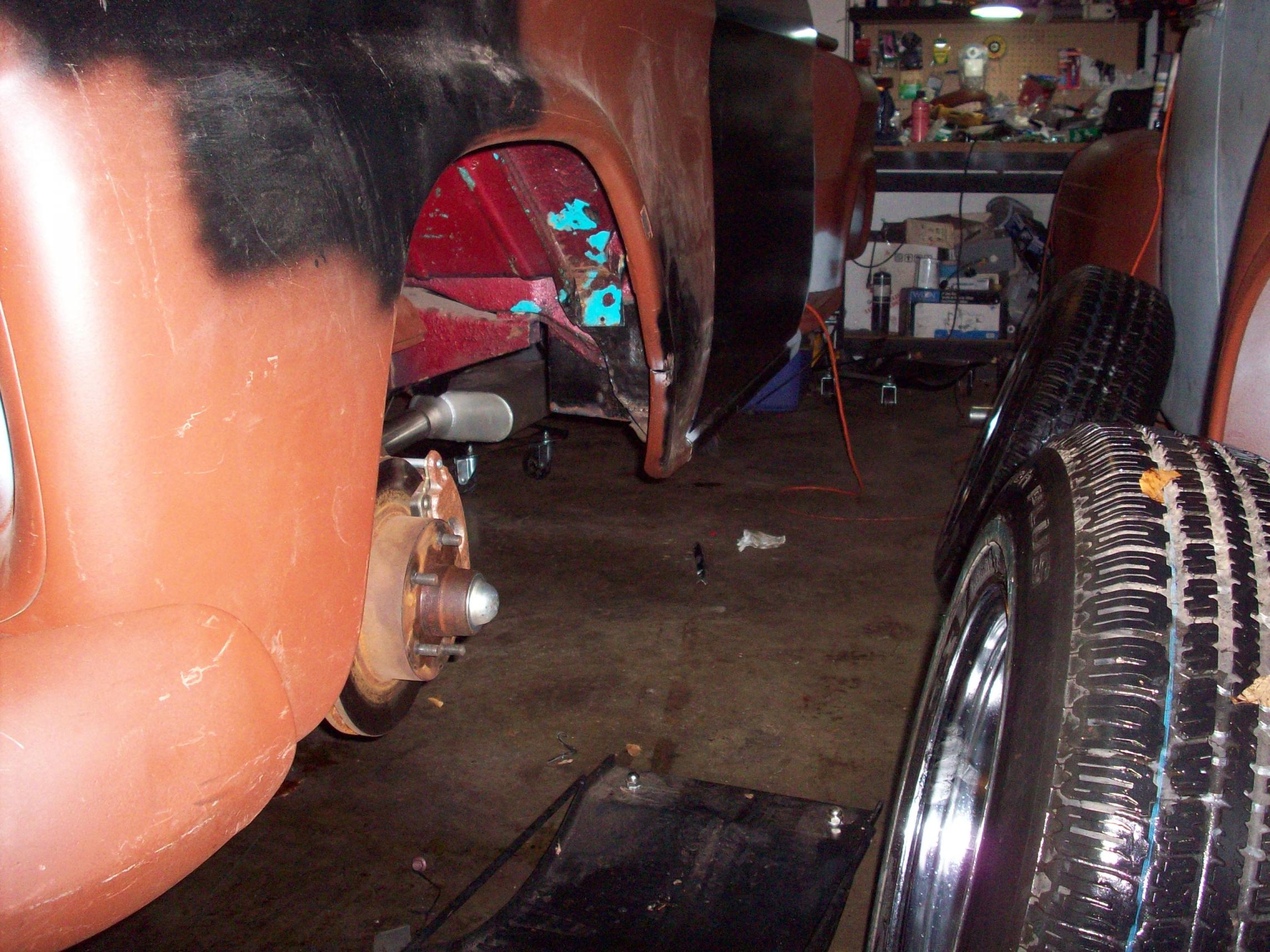

    Well... The Apache got a new pair of wheels! I bought these at a swap meet a long time ago and always thought they were 16" rims... I have 15" tires on the truck as it sits... So debating on what to do.. get white walls, regular tires, or sell the nice rims I remeasured and found out they were 15".. Soooooo. I went over to a buddies flopped the new rubber from the ****py wheels to the new wheels and took them down to get balanced. I am jealous that I own them lol. They look good!
    Here are some pictures!
  30. farmer12
    Joined: Aug 28, 2006
    Posts: 7,724
    farmer12
    I think the wheels look great. They may even look better than WW's, even though both would do the trick in my opinion. Keep up the good work!
