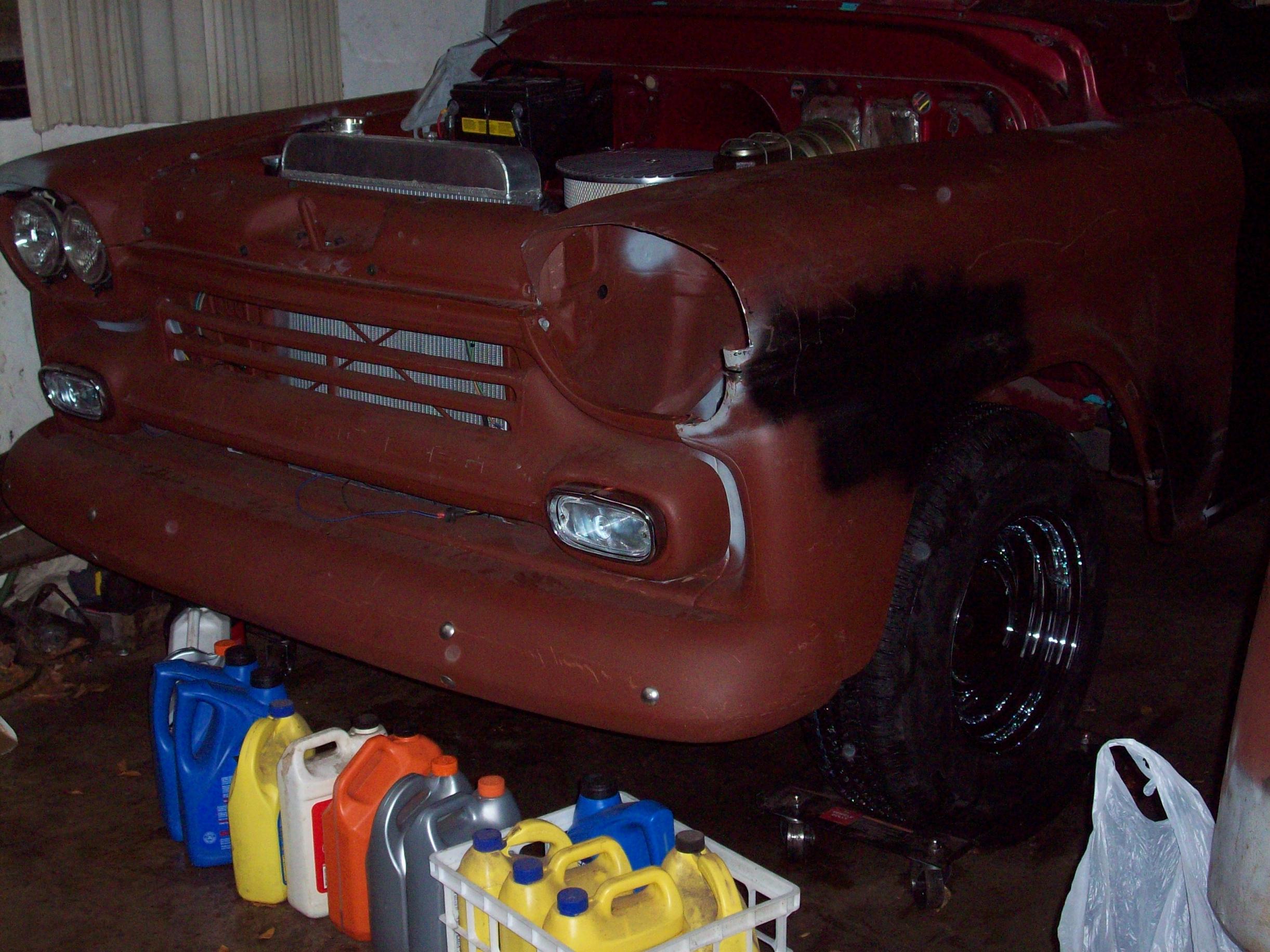

    Here are some more. I couldn't decide on which style I liked more; with or without the center cap. But here are some more pictures. It makes all the difference with this truck. Hell, once I get that drivers fender back together I am just going to bolt everything up and scoot around town with it that way for a bit! :D

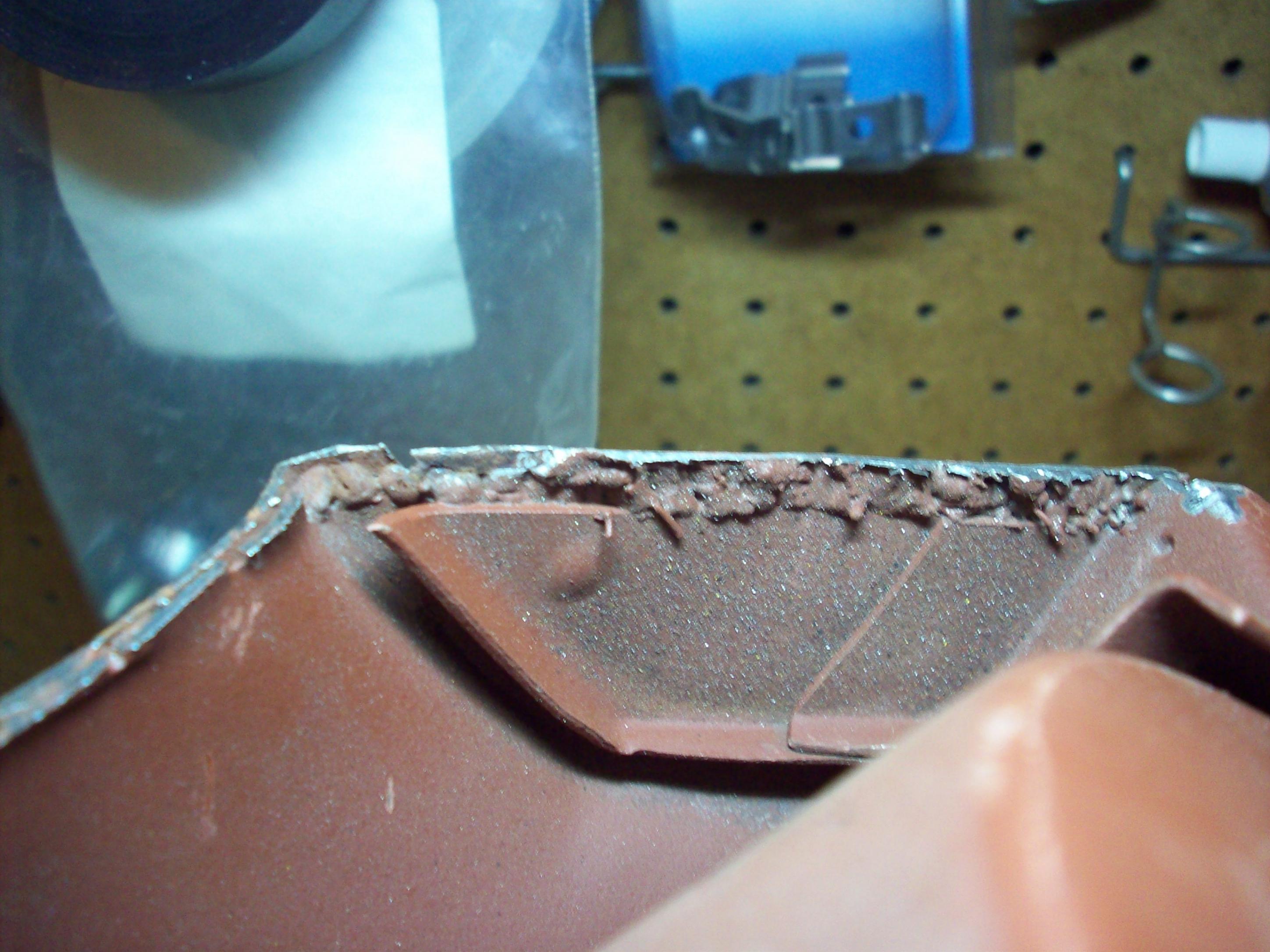

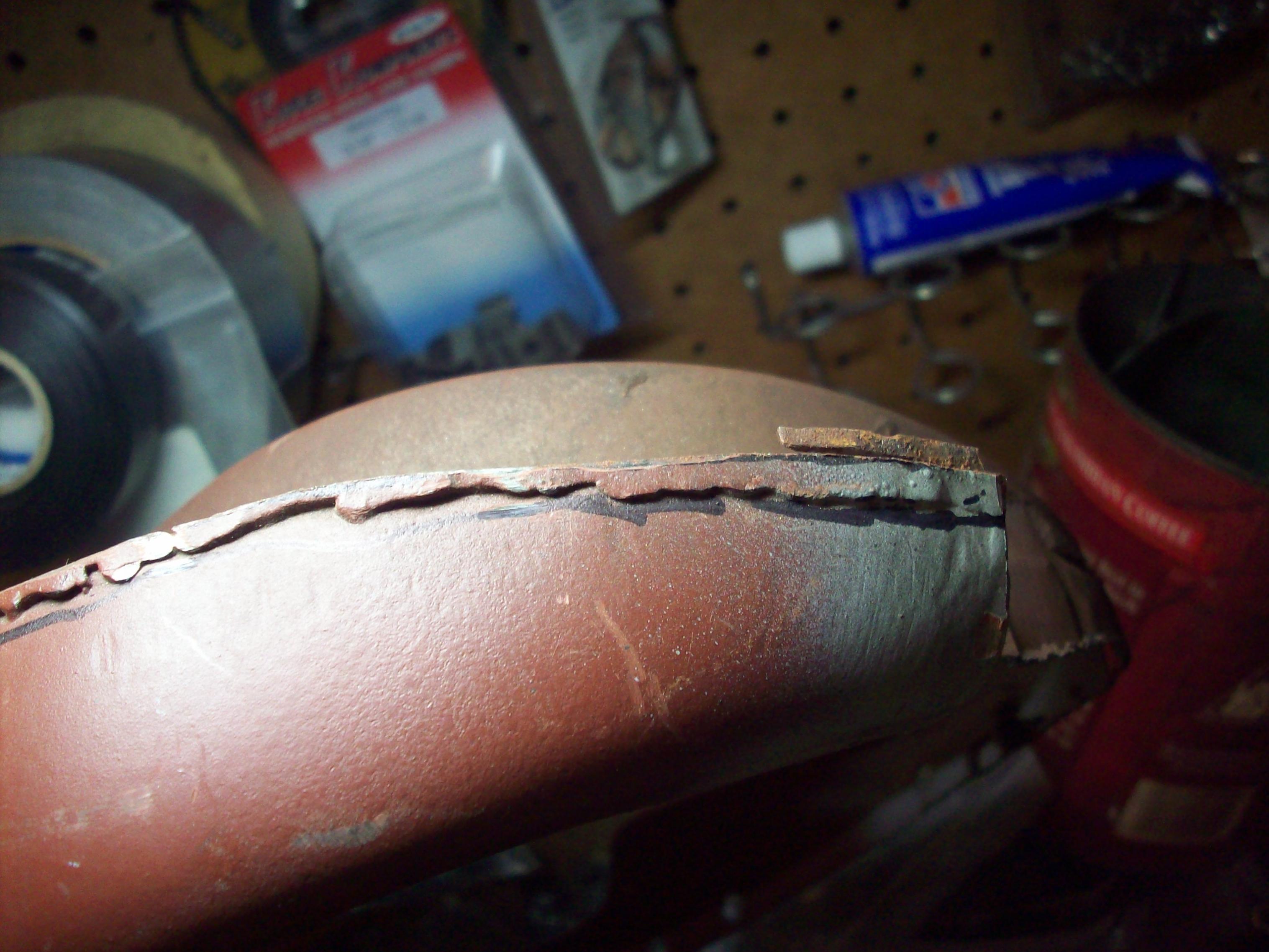

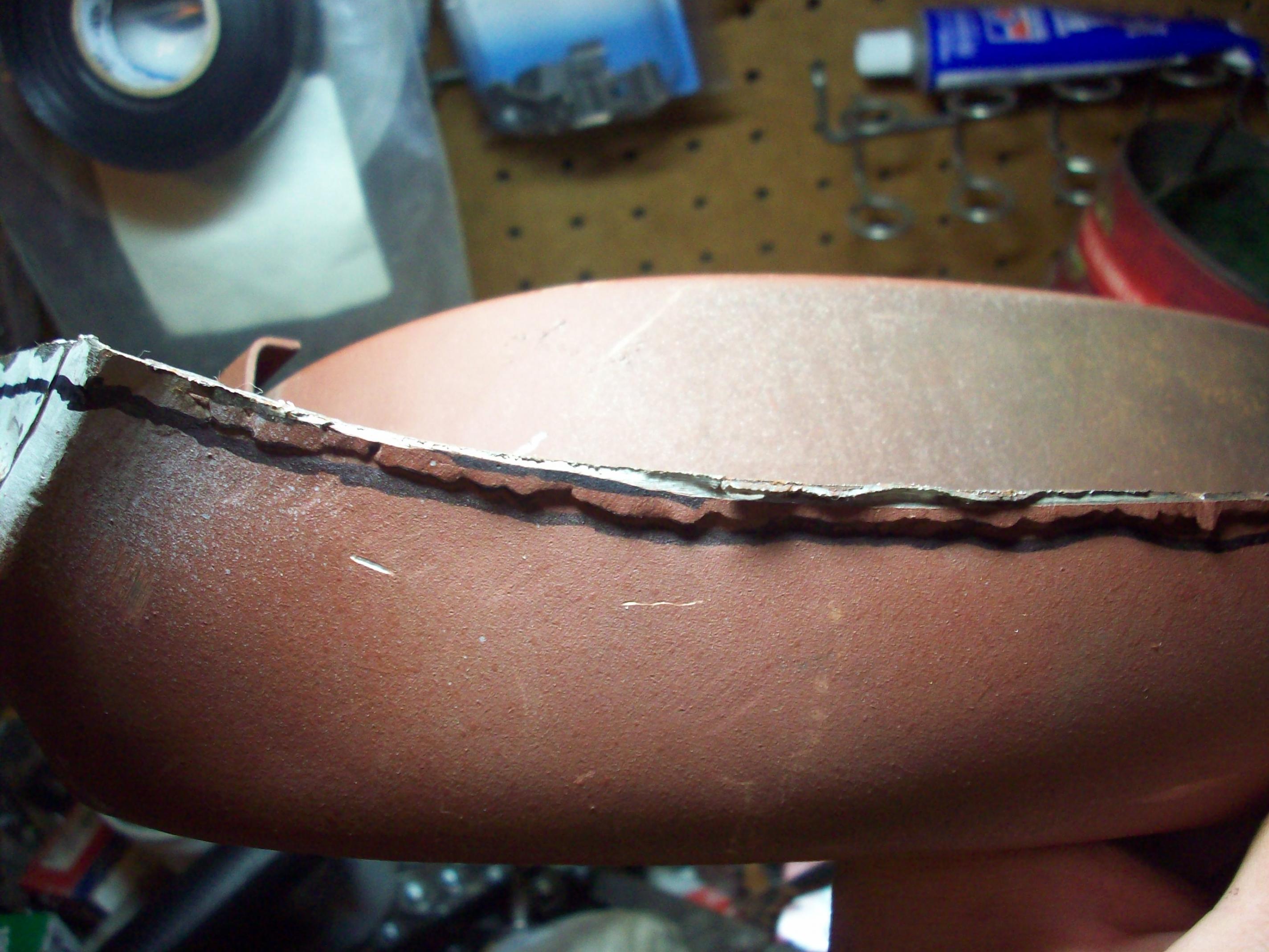

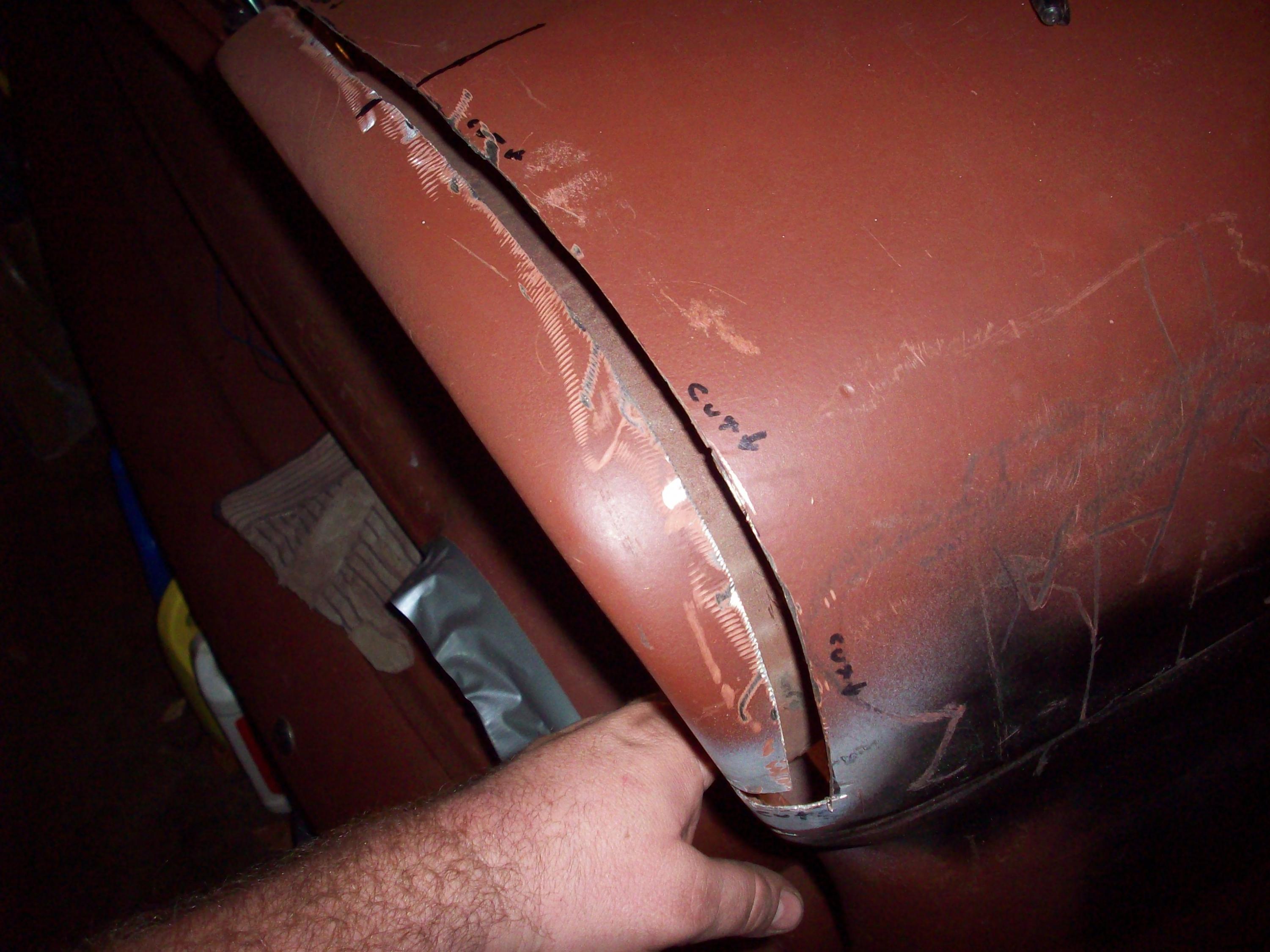

  7. 1959apache
    Joined: Nov 22, 2009
    Posts: 2,635
    1959apache
    Here are some pictures of the abortion... I mean bodywork that some local kid did to splice this eyebrow on this fender. I am redoing it so I don't have to cake everything with an inch of filler to hide, plus I learned what I needed to learn and want this truck to be all my work. I'll start by cutting off the left over welds and **** weld to the fender while it is bolted up to make sure everything lines up correctly. Then, if everything goes well, I maybe able to install the hood again!
    I am going to try to get this back on tomorrow after working on getting the Plymouth up and running out in the driveway. I think I am also going to flip this truck around so I can work on the tail end easily for the roll pan and oak bed installation. Also, I'll take a couple shots with my camera with the new wheels on it. :D

    The Plymouth was not being very nice to me and since I was on a cleaning rampage in the garage I decided I wanted the hood on the truck again. In order to do that I needed to get this eyebrow welded back on, so that is what I did for 6 hours... There was a lot of time consumed by aligning everything so I don't have to redo anything. I am not that good yet on the body work to just do it once and done. I started using the shop light and watched the shadows from the light to align all of the panels. This gave me a good idea where everything needed to go and gave me an idea on how much filler, if any would be needed. Fortunately, I think this is going to just have a tiny bit of filler, maybe even glaze to get it tweaked in so you can't even tell its there.
    Here they are, I will try to work on this more tomorrow.
  9. 1959apache
    Posts: 2,635
    1959apache
    Here are a couple more of me moving down the fender. Even though there is a big gap both patches are even and feel smooth when you run your hand across them, so that is a good sign. I will try to get the rest of it tacked up there tomorrow and maybe even welded, but we will see.

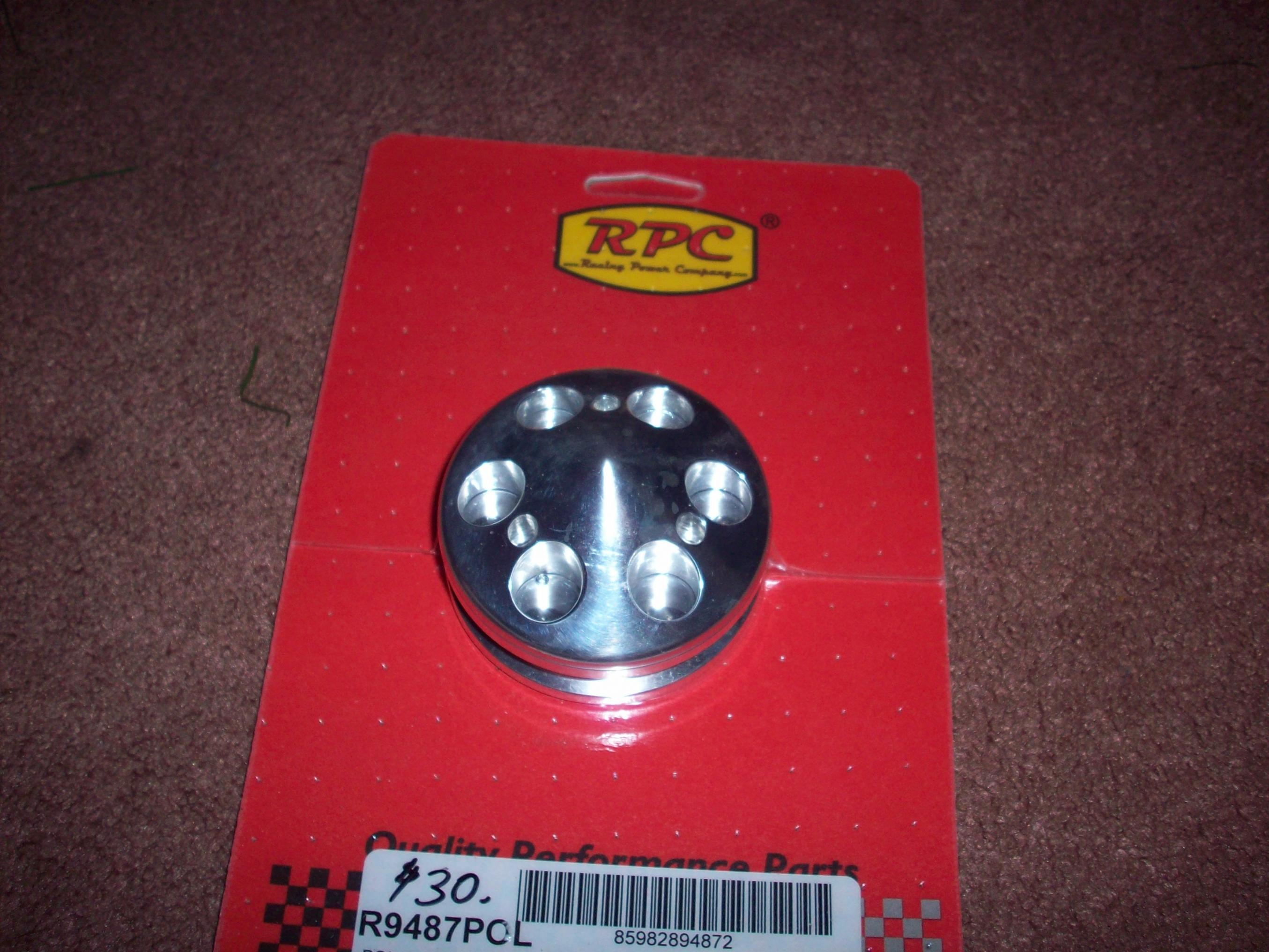

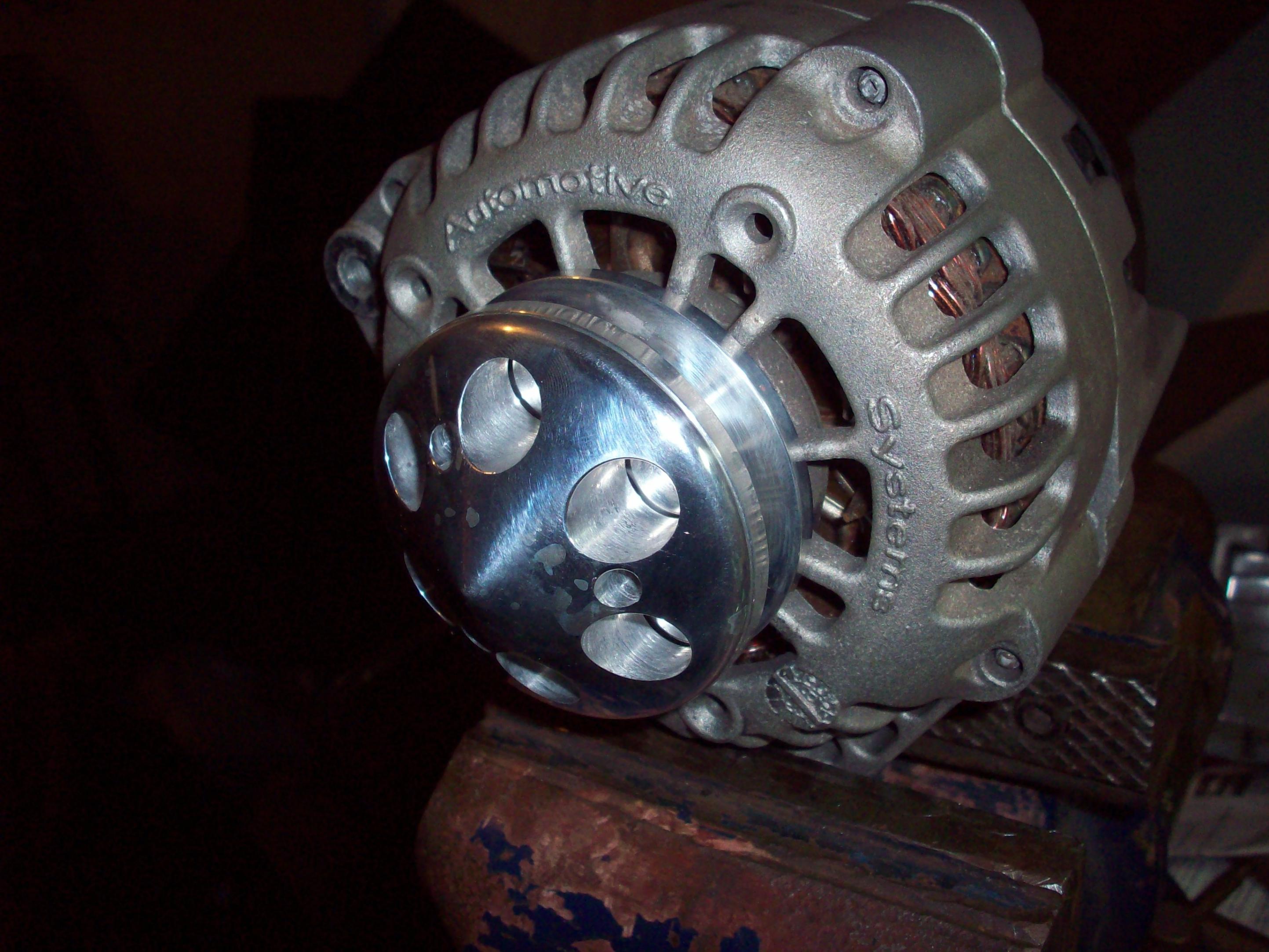

    I went to the swap meet early and scoured the place and finally found a set of people that would be willing to barter instead of having their set price and not budging. Really nice guys if you ask me.
    I got my V belt pulley setup to replace the serpentine belt setup in the truck since I am not worried about room and it doesn't fit the build I am doing. I like the vintage look, so that is what I am going to try and go for. Here are some pictures of the parts. I chewed the guy waaay down on all of this stuff, so I got a pretty good deal. I got the power steering bracket ***embly for $10 bucks from a different guy, but pretty much everything else for the Plymouth and the truck came from the same guy, so I wound up under $170 spent for all of this stuff, plus most of the plymouth stuff.

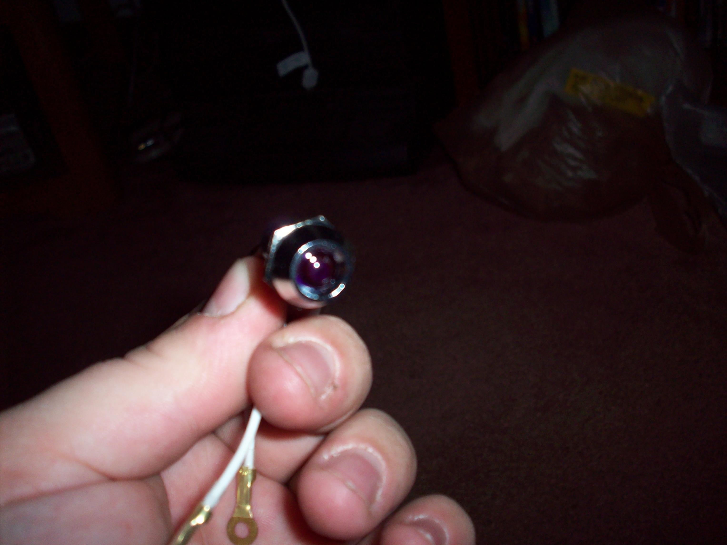

    I got a couple other things too. I will replace the current light for the brights with this stylish LED light and will also replace the current fuel pressure gauge with this good quality gauge to ensure I am getting an accurate reading so I can fine tune the carb. I am probably going to take a break for the rest of the day, 4-5 hrs at a swap meet walking around takes it out of you ;). Thanks again Dave for all of the help locating parts! I want to hear those cherry bombs pretty soon!
  12. 1959apache
    Posts: 2,635
    1959apache
    Well I have been working a lot on getting some of the new parts I bought installed on the pickup. I installed the LED light, fuel pressure gauge (now it gives me a correct reading so I can tune the carb). I am in the process of installing my V belt setup on the truck too. Here are some pictures.
