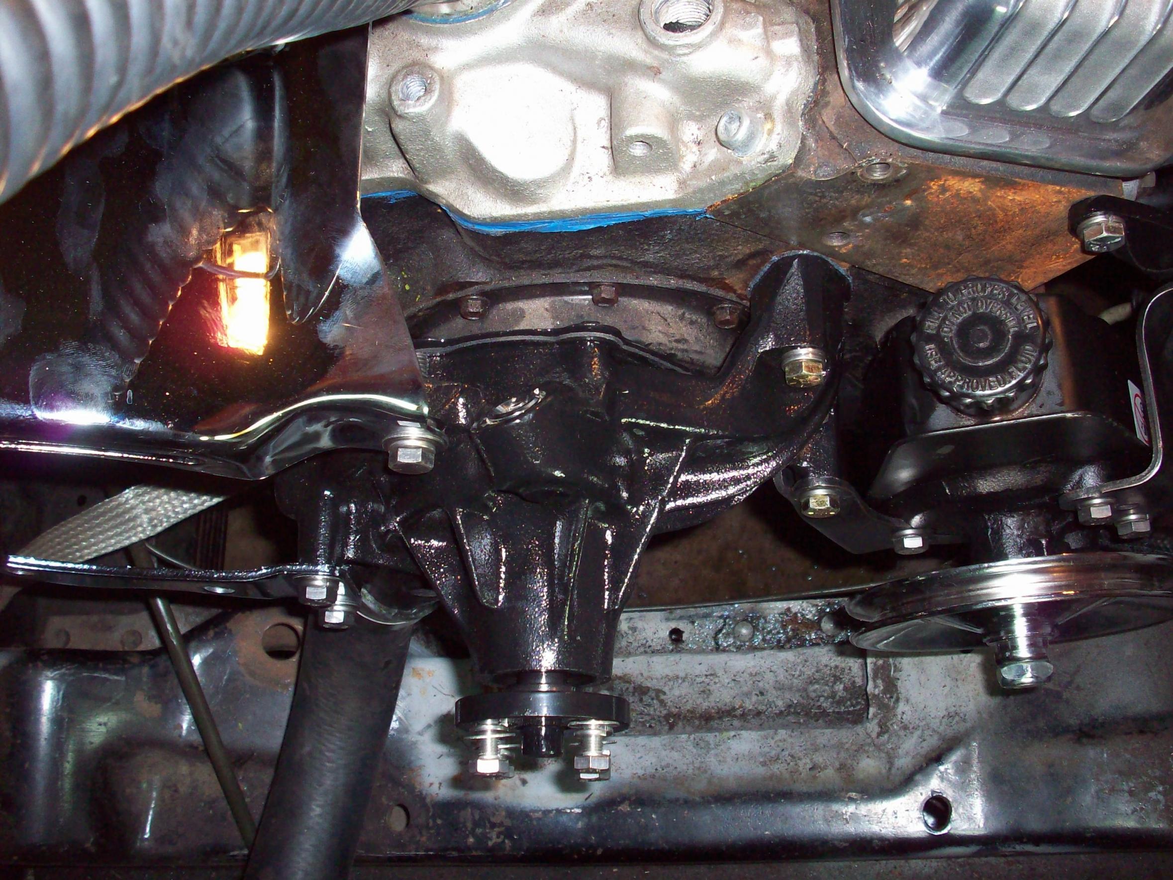

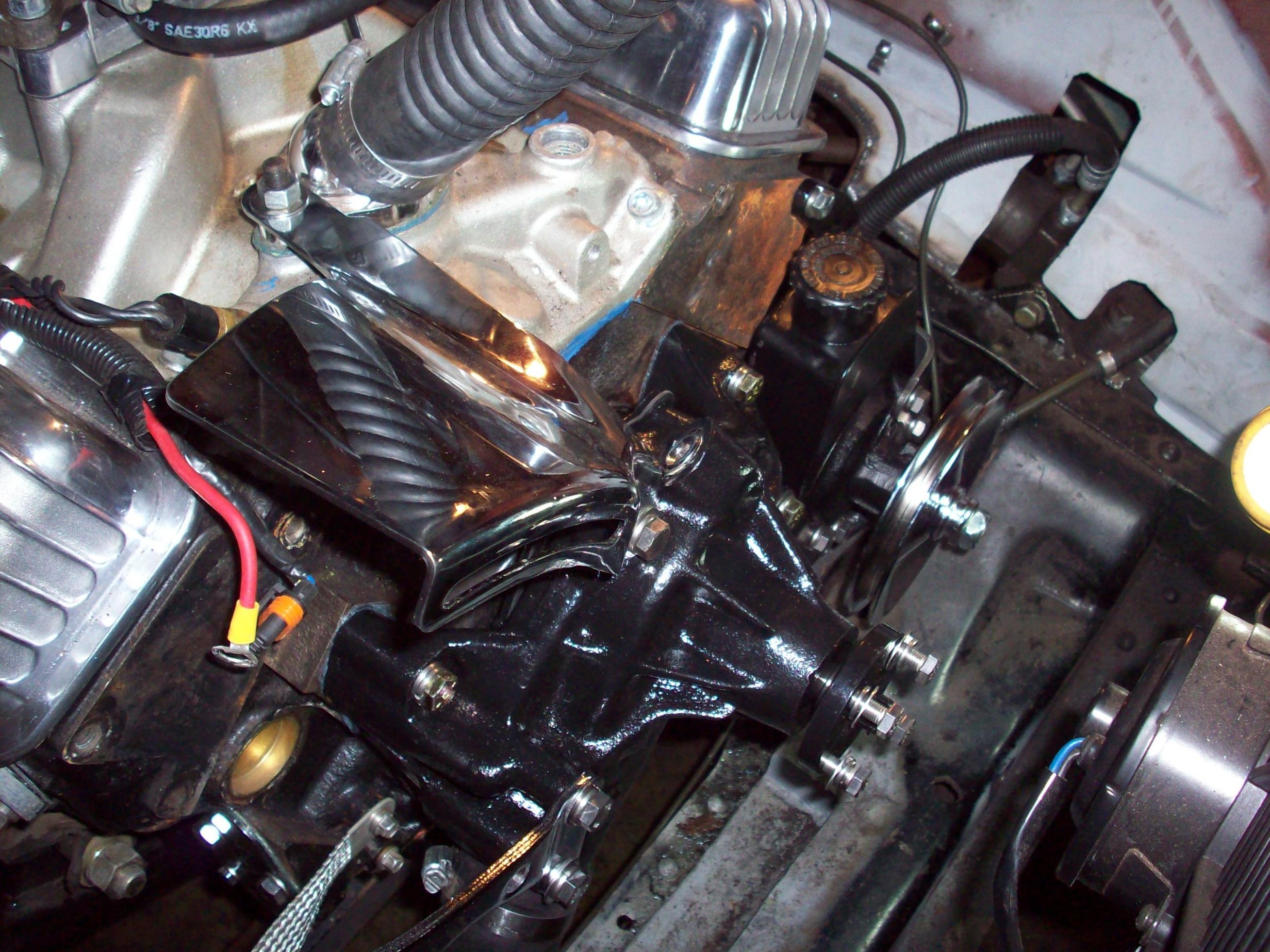

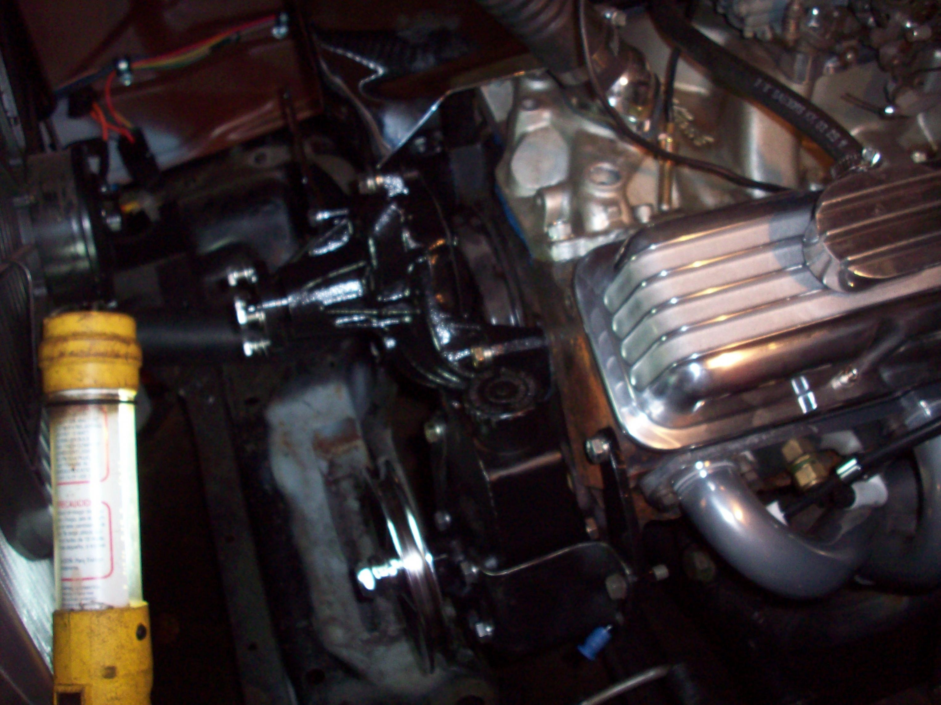

    Here are some pictures of where I am at right now. I had to order a crank and water pump pulley. I am probably going to have to get an alternator and will have to reroute my fuel line. I am going to remove the seal of the crank and replace since I removed the balancer and it wasn't on there right in the first place. I cleaned the balancer up and once I get the seal out I will clean up the nose of the crank and slide this ****er back on. Then I just have to make sure everything is connected and I am off to the races.
    Once I get everything installed and tuned in then I will start working on making the engine pretty

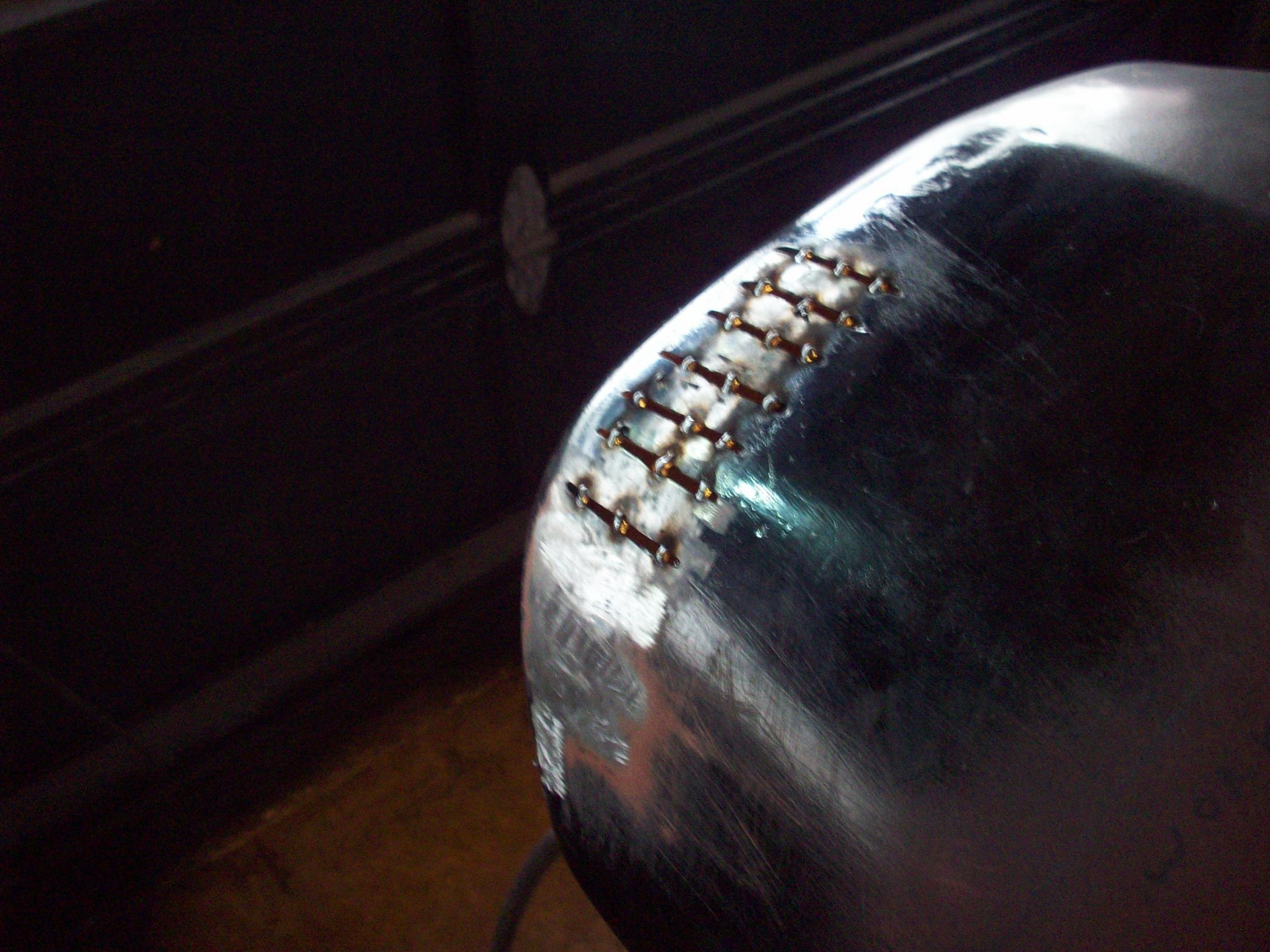

    Also I welded up the fender and will start grinding on it soon to see where I need to do some work. :D

    Well I went out and did a couple little things, I just cranked down the temp gauge and hopefully that will seal. If not, then I may be in trouble :p
    I hooked up a couple hoses and got a couple other things set and ready to go too.

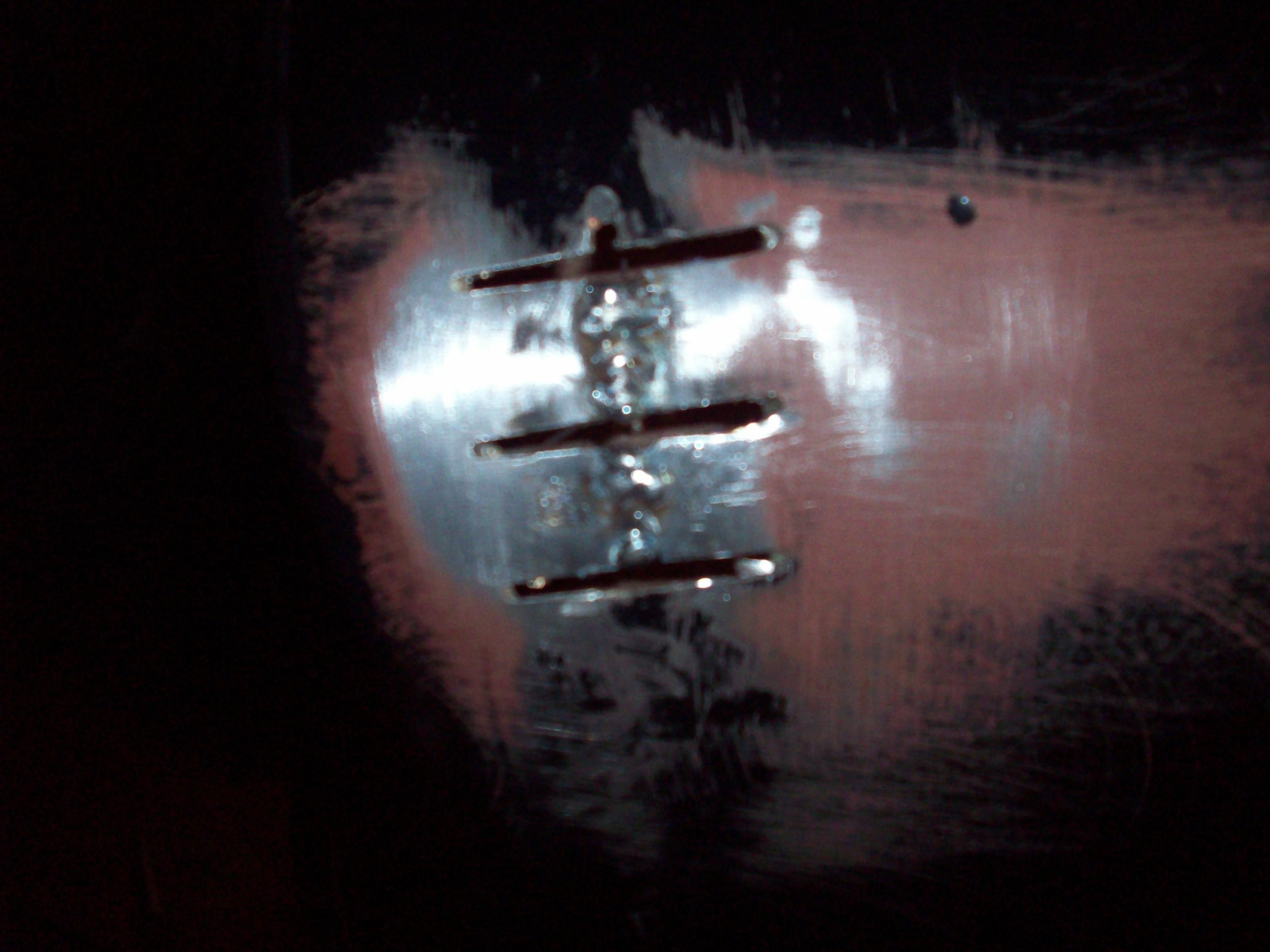

    I went ahead and ground down my welds as well... More on that tomorrow and my fixes. It will be a lot easier since I filled the void if I need to do some more work in straightening out that part of the panel too, its pretty good as far as ballparking it goes.
    I am going to go pick up another crank seal and hopefully get that harmonic balancer installed as well. Here are some pictures.

    Well I got the front crank seal pulled after battling that for an hour or two because of clearance. I got that back on, polished the end of the crank and slipped the harmonic balancer on. I went ahead and shot some gloss black on my patch panel to see how close I was and there is like a 4 to 6 inch section that needs a little work, but the rest of it is spot on. I am getting better at this day by day, soon I will be able to really do some nice work on the plymouth. Here are some pictures. I will post some more soon.

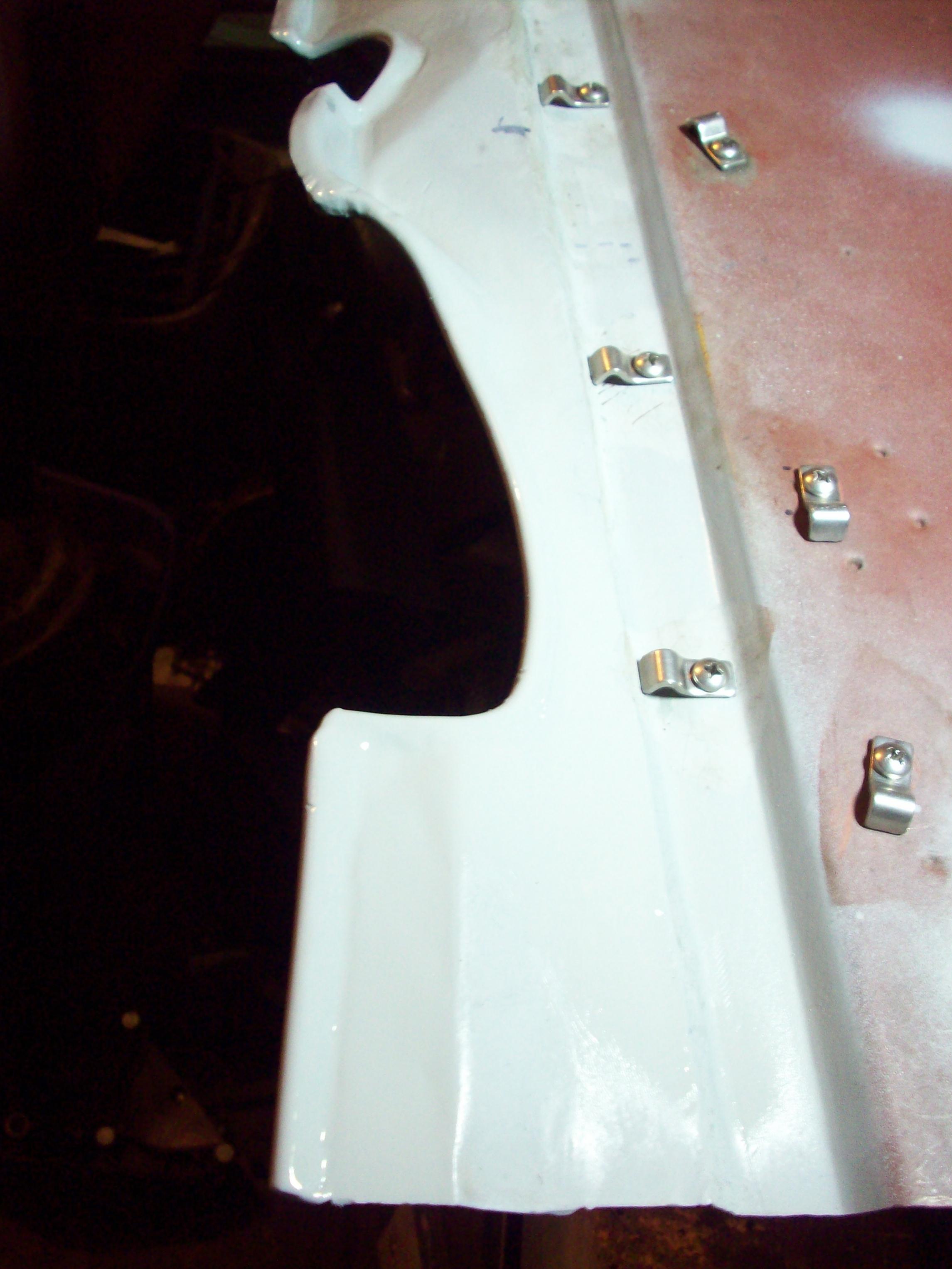

    Well I cut the rest of the problem area up, shot it with some gloss and tweaked everything so all I have to do is weld it. I will finish it up tomorrow and start working on another area of the eyebrow. While the paint was drying I also started working on the brake pedal, to get that finished. I welded that up and drilled my hole for my return spring. Here are some pictures.

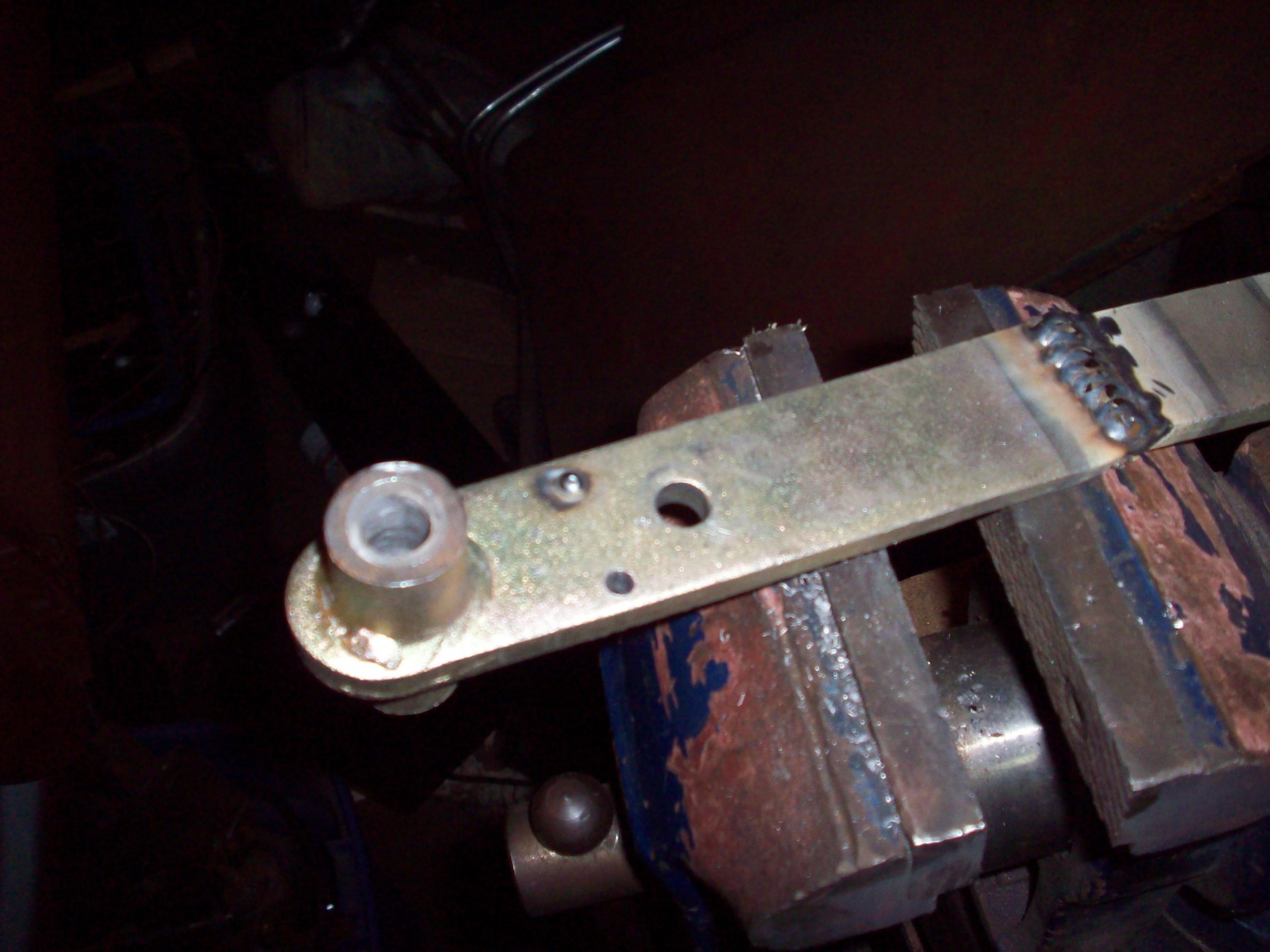

    Here are some more pictures. While the pedal was cooling down I started welding a little.

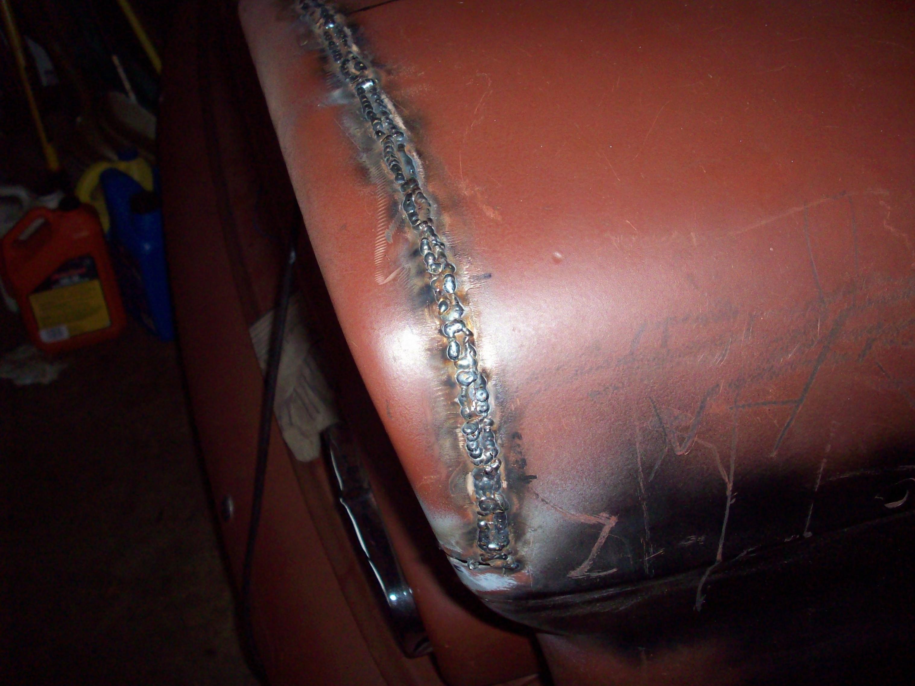

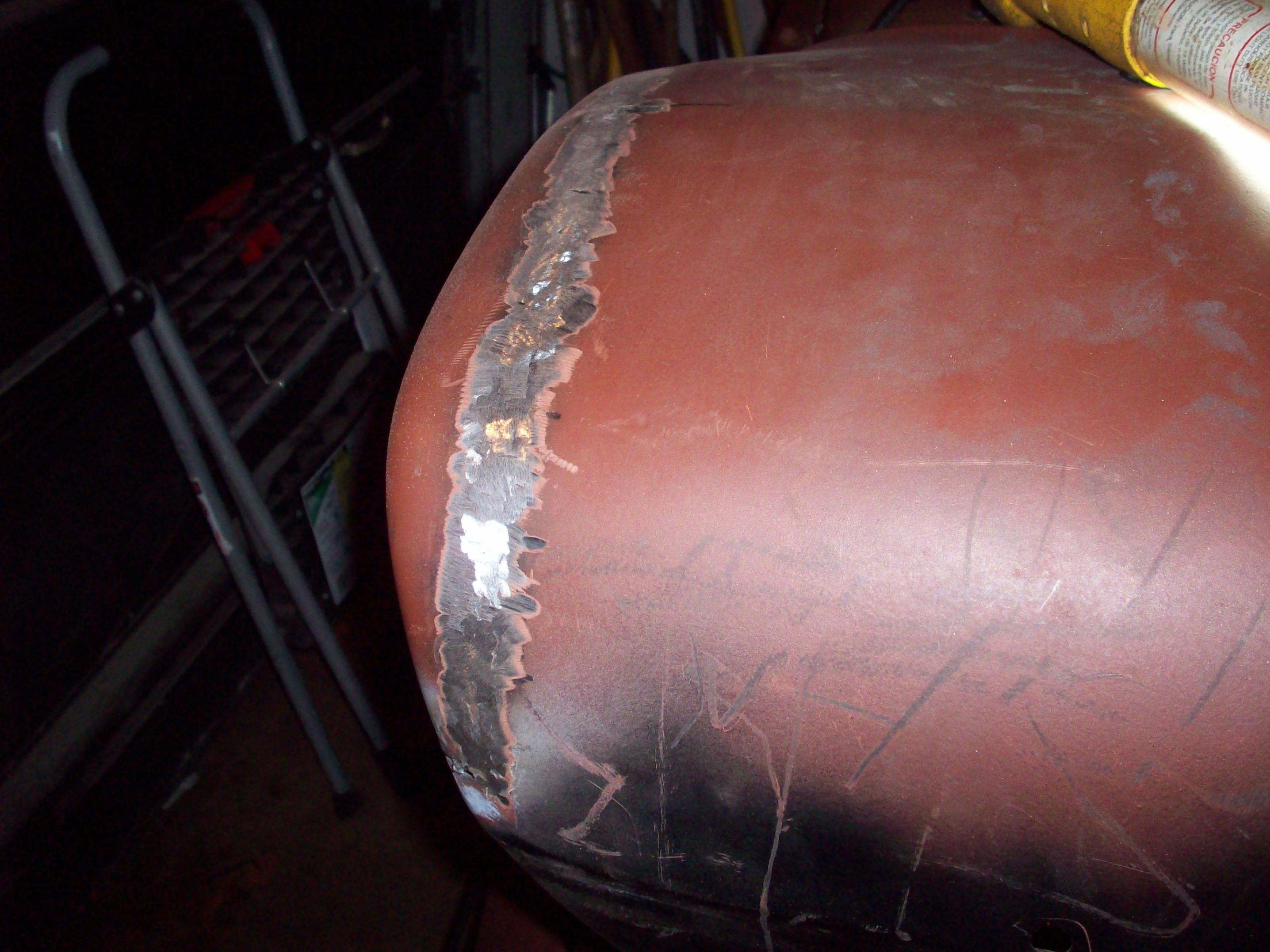

    Well I ground down what I started with yesterday. I m***aged that back out to where it is supposed to be. I also went through and welded the rest of it up, but still got a little warpage, so I am in the process of working that back out so it is like everything else. My aim is to get it as close as possible. Hopefully I get complete it tomorrow and move on to another part of the eyebrow. By the weekend I hope to have the hood back on, seems to be a reasonable goal to me. :D

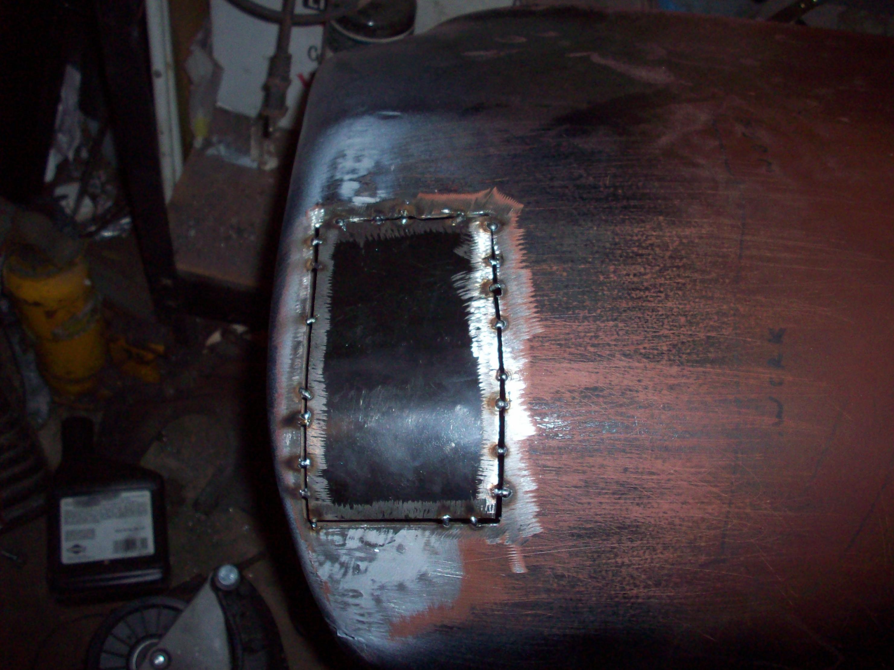

    Since I didnt feel like battling this thing for days I just decided to cut it off and weld in a nice new piece, so I did and I am sure it cut my time down on this fender quite a bit. I will weld it up and grind it down tomorrow, but more or less this is a perfect fit. With any luck tomorrow I may get the fender finished and move on to installing the hood again. :D

    Well another 6 hour day out on the truck and I pretty much finished up the fender and got the inner fender ground down and primered to reinstall tomorrow.

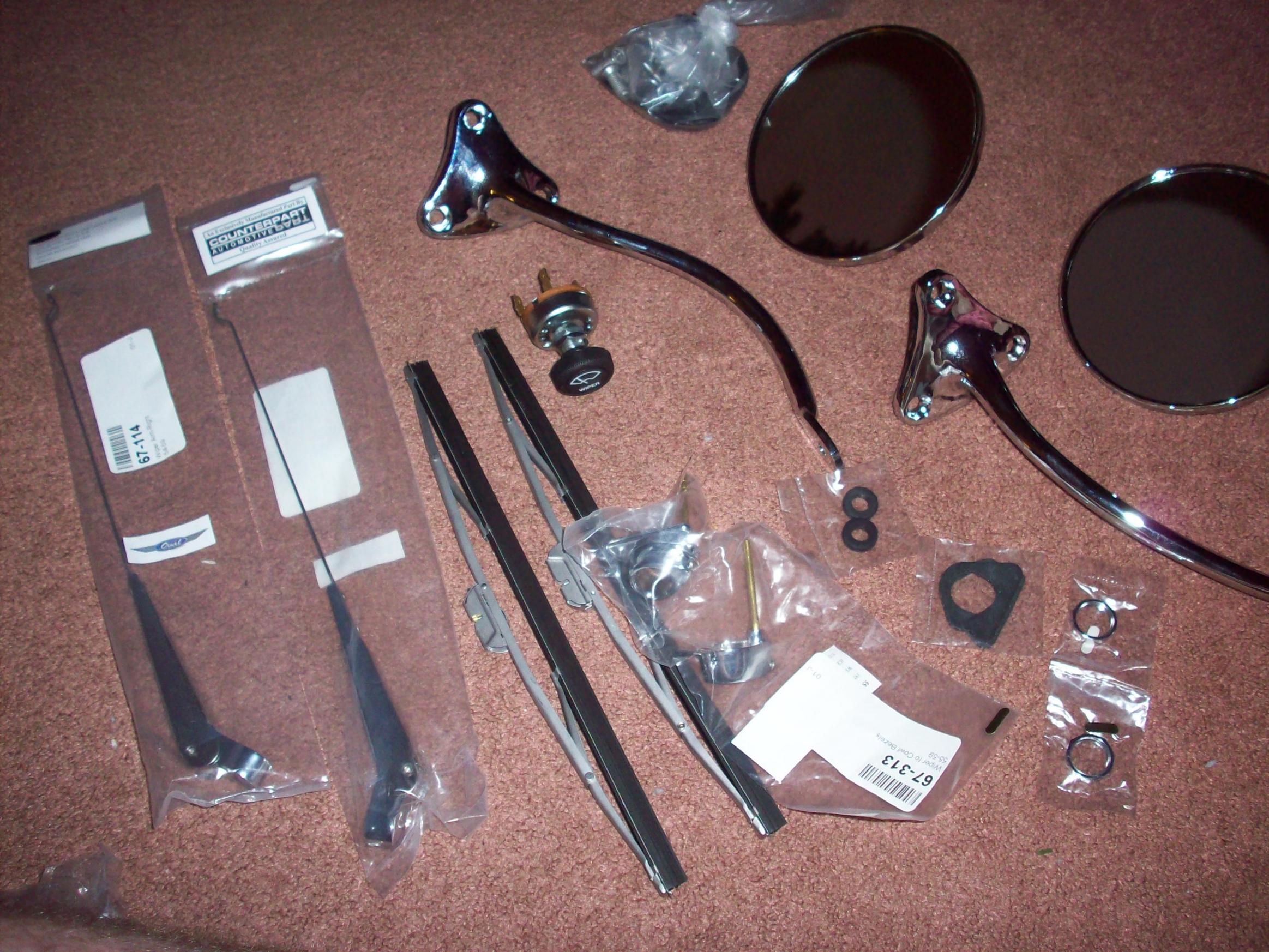

    Well I got an early Christmas from my girlfriend, she was so excited to give them to me she couldn't wait. So she got me a pair of side mirrors and windshield wiper parts and a very cool Aviation video collection from the National Archives. Those are pretty much all I need at this point, short of the wood bed that would make this truck complete.
    And that's why I love her
    Here are some pictures of the loot :D:D

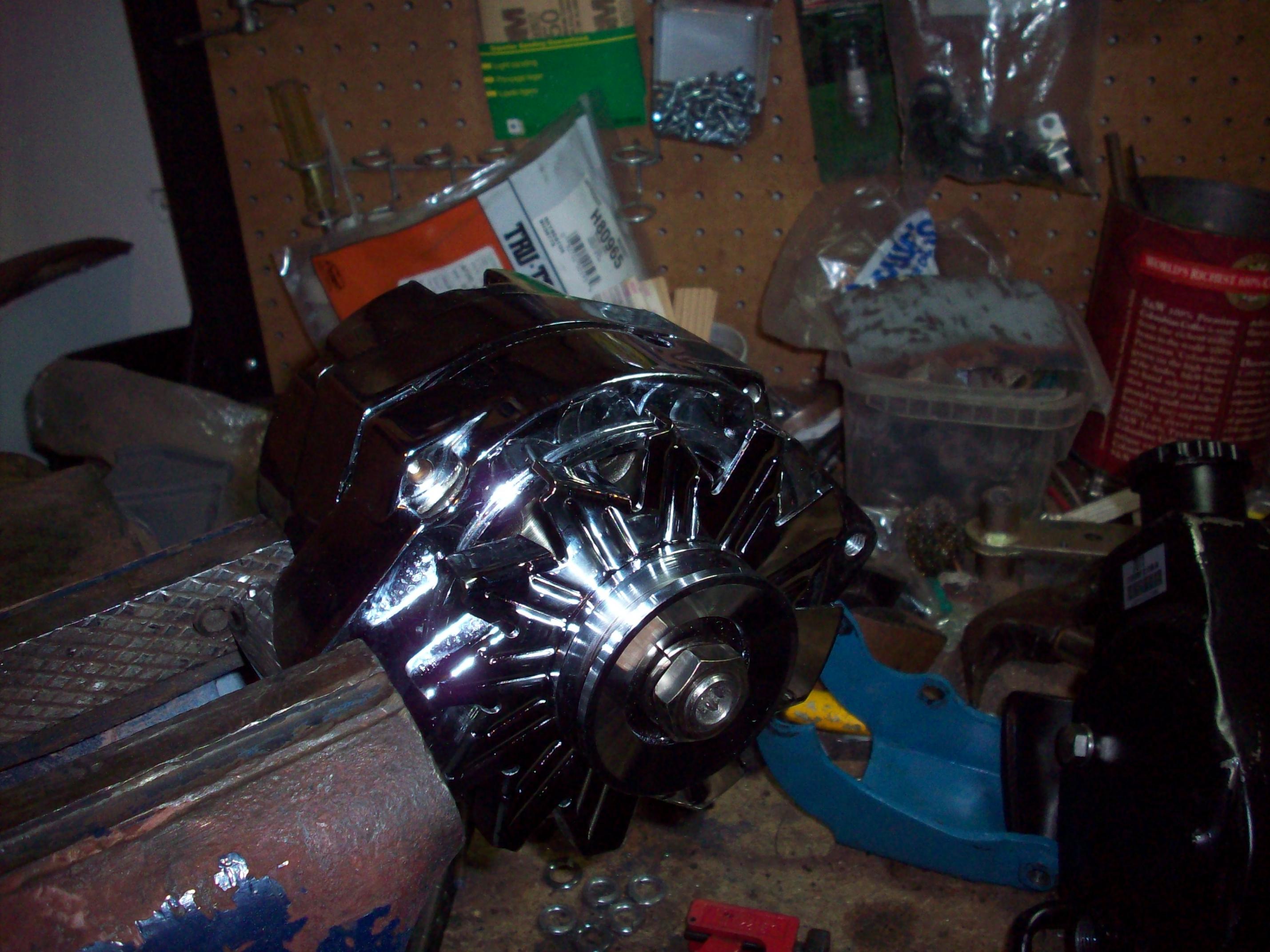

    I got a lot of work done on the truck today, even with the limited time I had. I rerouted the fuel line, sized up a power steering line that I am taking down to get made tomorrow, got the fan swapped on the alternator (because the big plastic one was really lame), got all my pulleys aligned, and measured my length for my power steering belt. If all goes well I should have this thing up and running tomorrow :D. But...... we will see.
