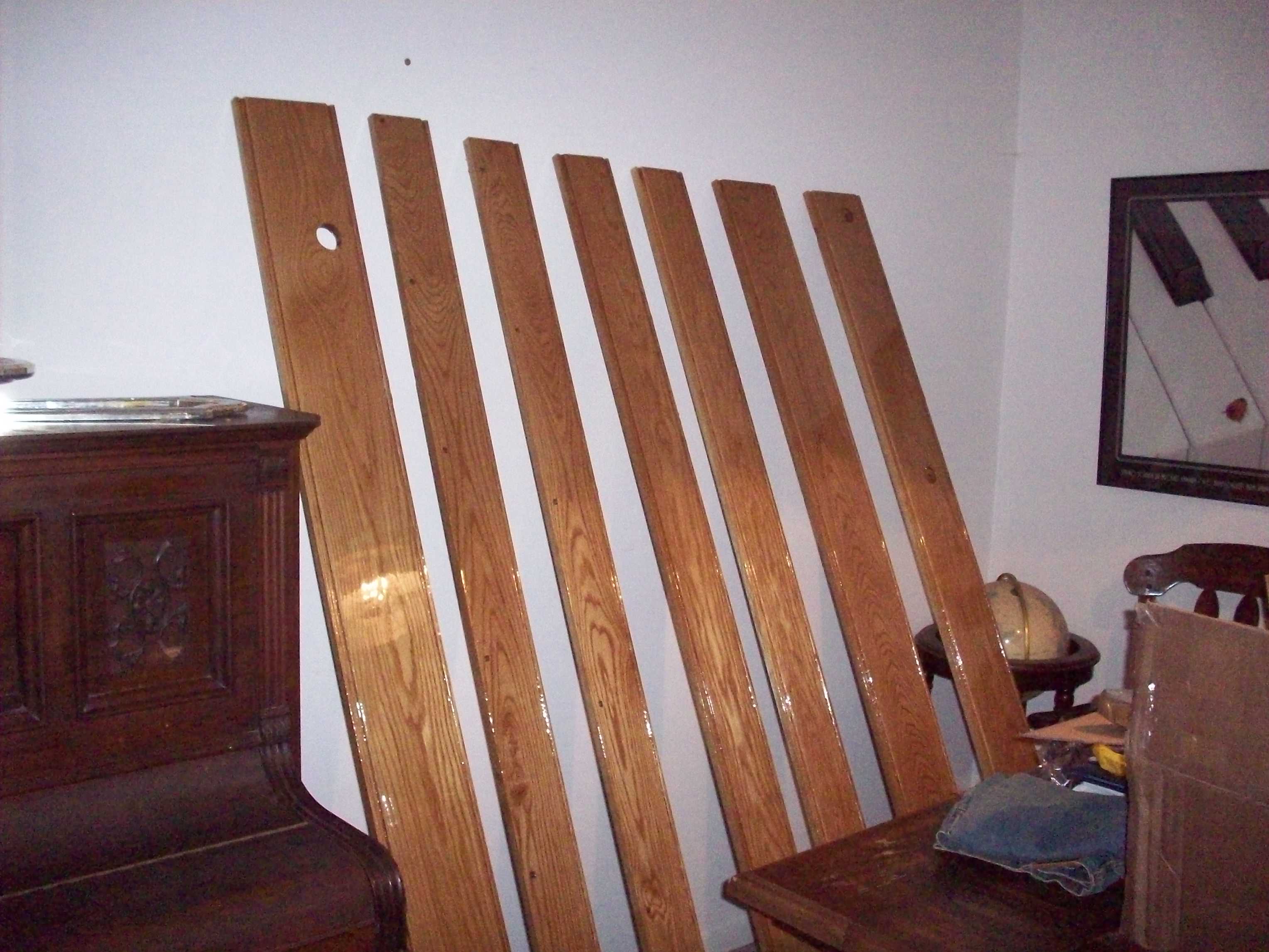

    I also did a lot of work on this wood bed, got the FLA (fat lady ***) out of the top coat, got a couple nice thin coats on it and it should be ready to install this week. I will more than likely take this time to get the cab corner replaced again on the p***enger side, get the rear of the cab in epoxy, and get my bed sides stripped of this lousy acrylic primer that was put on it.

    Well tonight I decided the bed was as good as it was going to get (I may work on a couple of the boards later, but I am getting hung up on these because I want to be a perfectionist with it... I just can't do that, so I am going to move onto something else. I moved the dried boards inside and removed the visqueen from the frame rails. I did a little work on the rear cross member, but also put my door back together. I need to get those door panels taken care of.... the red and gray aren't doing it for me. I think next I am going to bolt the gas tank back up and get that all in one area and then work on a couple things there. I will then move onto that p***enger cab corner because the body line is way off... I hate it.. so I had to change it. I am going to see about switching gears and stripping the back of the cab down to bare metal and shooting it with some epoxy primer.
    I am going to take my bed down to the blasters this weekend and they should have this acrylic enamel primer off of it so I can put on some epoxy primer. At least it will be one color by the time I get that back. Then I am going to take the front clip down there to have it blasted again so I can get it to be one color as well.
    Here are some pictures.

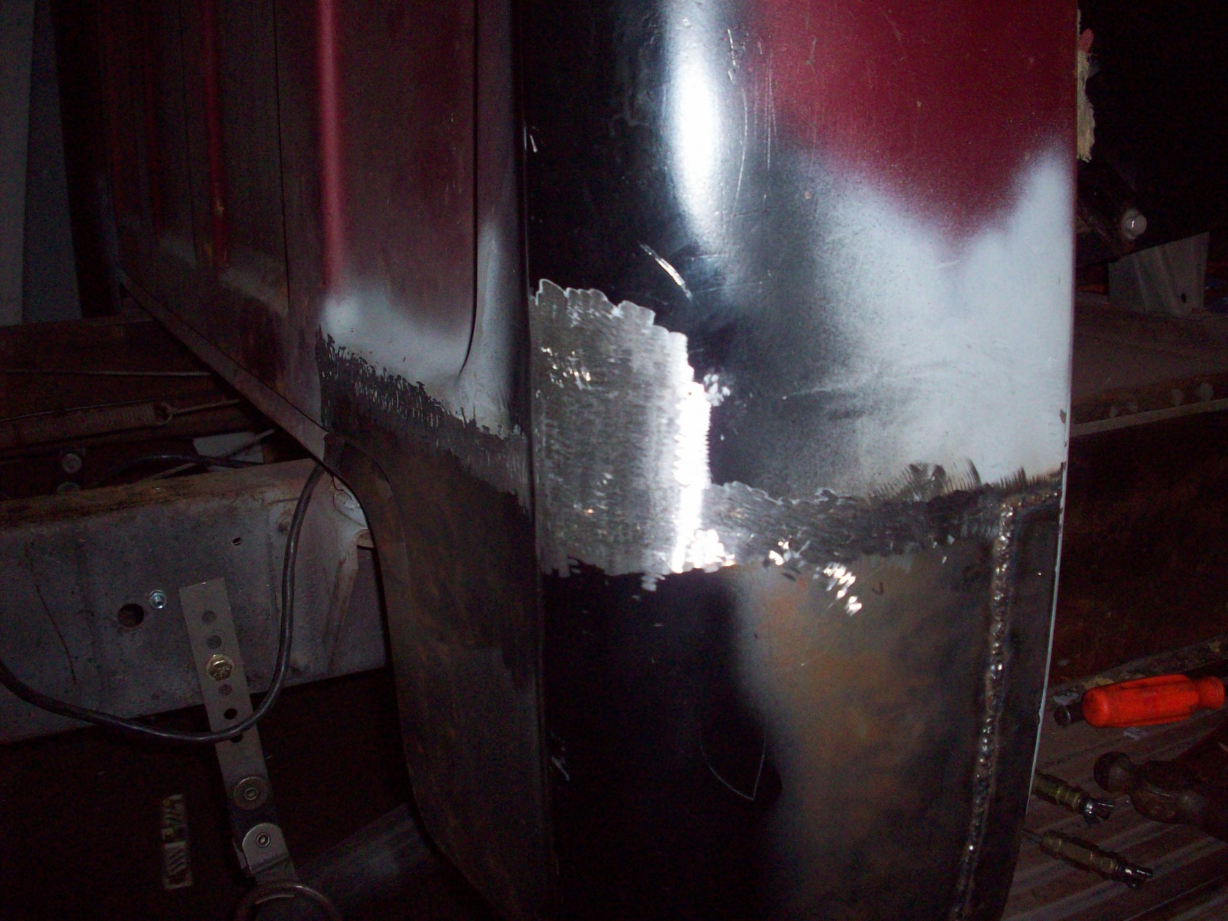

    Well I have a lot of things prepped for the new panel. I do need to modify the patch panel a little, but otherwise a great fit.. and made in AMERICA is the best part. I had to take the fender off before I could close the door (ridiculous). I painted the crease to better align the panel when I start welding it in.
    Does anyone know what I need under the radiator brace/frame to raise the front clip up? I think that is what is causing most of my problem with the door issue.

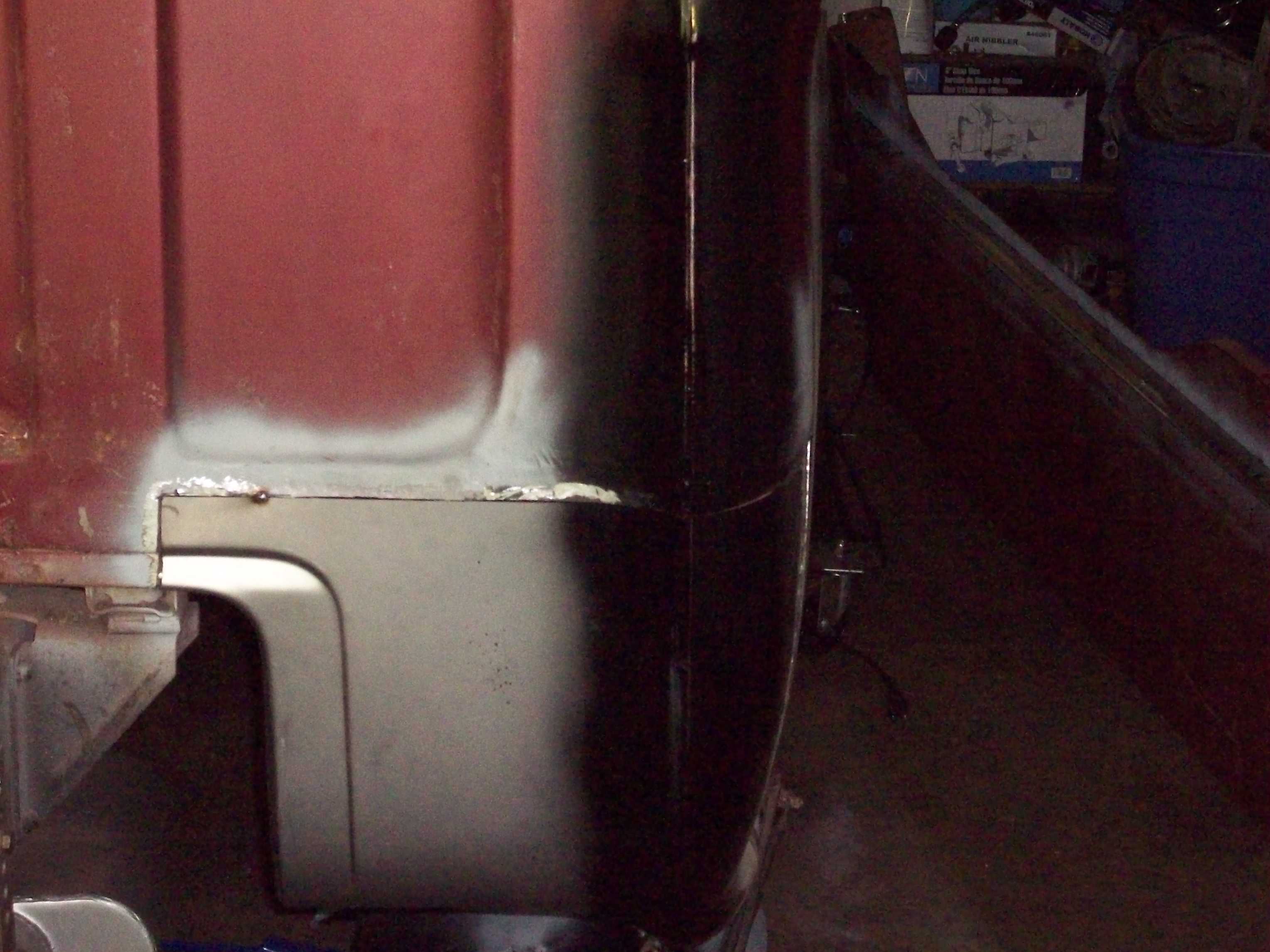

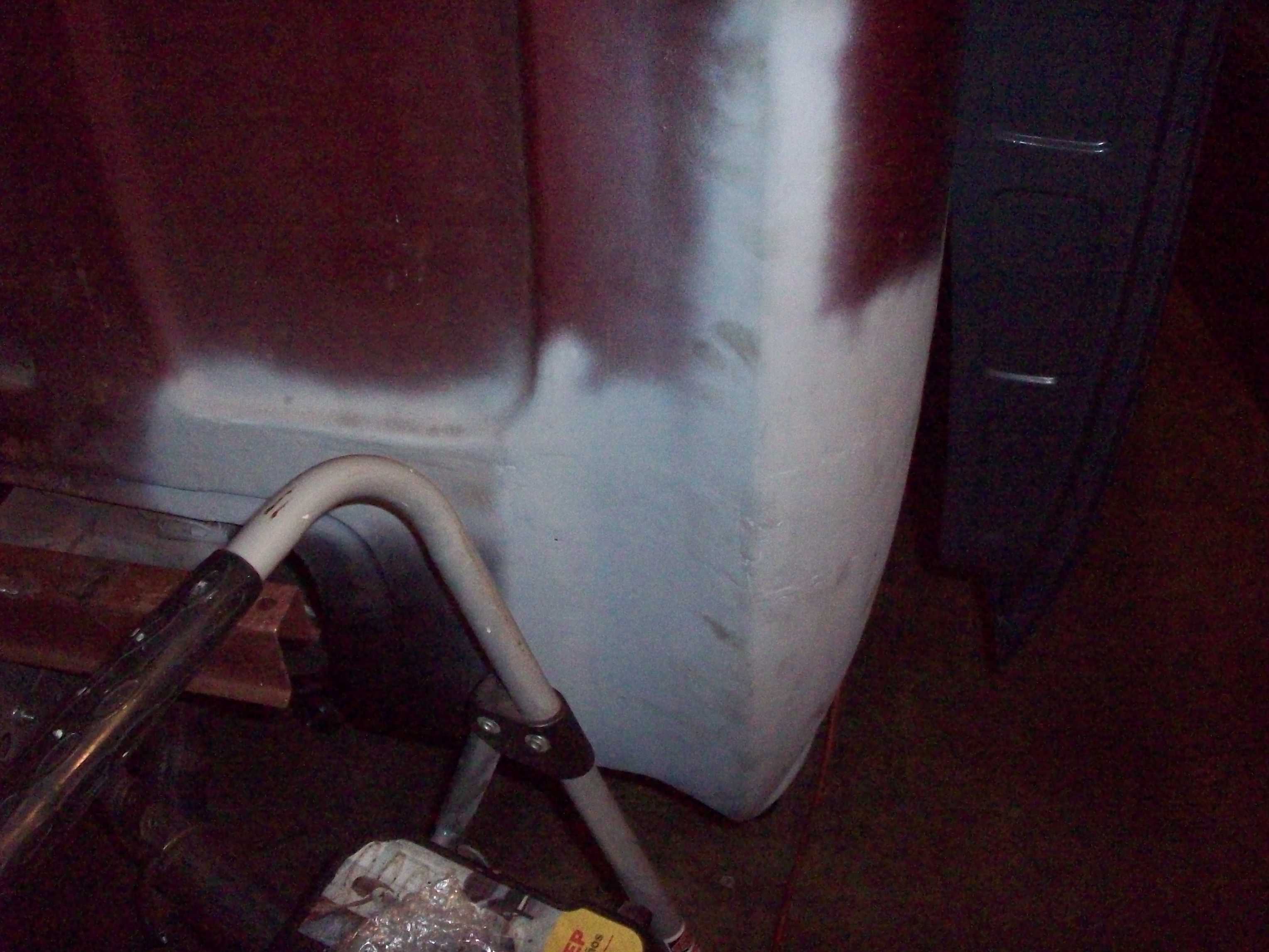

    Well its on there... I need to make some adjustments and maybe hack up the old patch panel to steal the body line in it to adjust the handmade patch I made a while back. I need to grind a little bit more and then weld the gap, but overall it is looking good.
    I probably will spend a couple more days making sure everything is lined up perfectly before completely welding it up and then I will grind, sand the paint and shoot the back of the cab in epoxy. I won't be needing but a small skim coat of filler (if any at all) to cover this, so yay! Made in America is the way to go

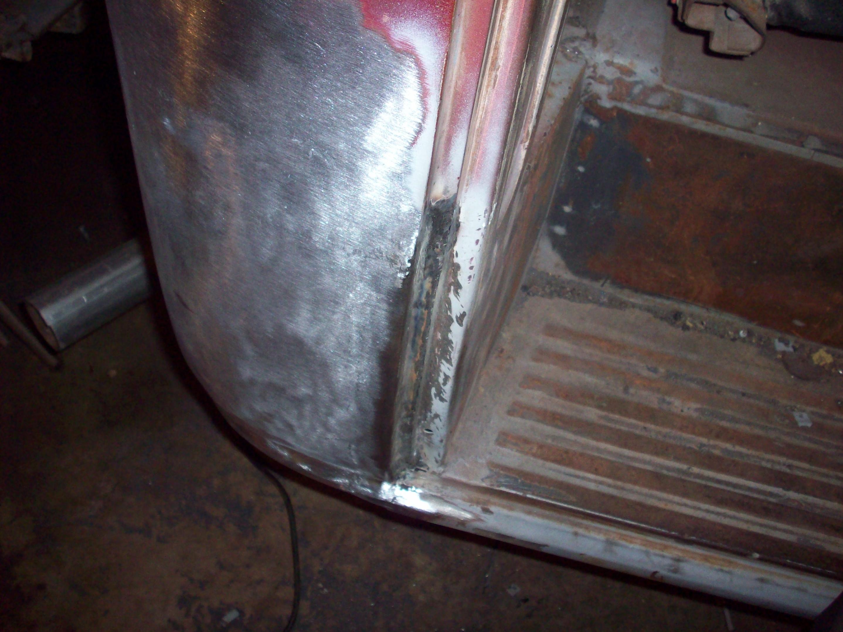

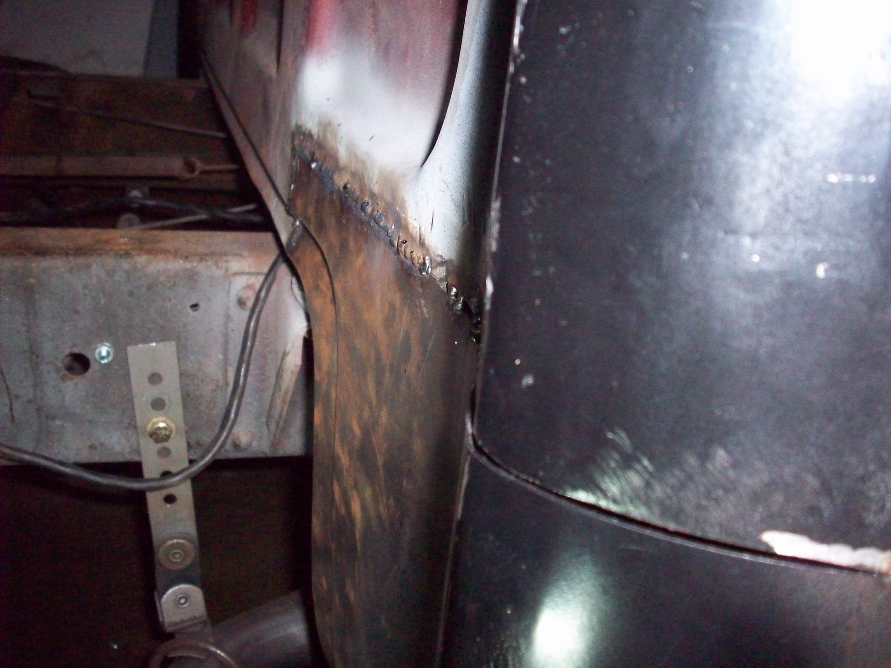

    Well I have been taking my time with my new cab corner and am amazed with how well it is made. I am barely having to do anything to it. I have the whole back half of the patch tack welded in place where it needs to be, everything else is lined up and waiting to be tacked. Once it is, it will be seam welded up, ground down and i'll be on my way.:p

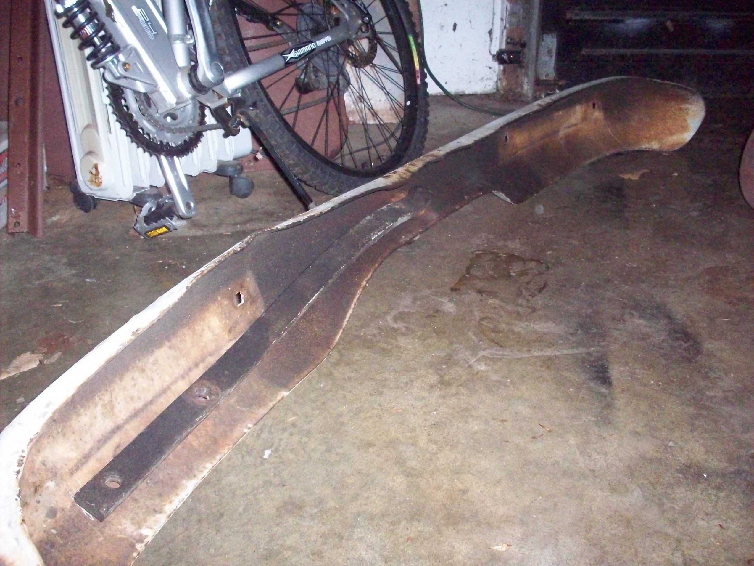

    That rear bumper looks pretty good! Those marks on the bottom edge are from where the chain was hooked, from pulling Fords back in the day:D!

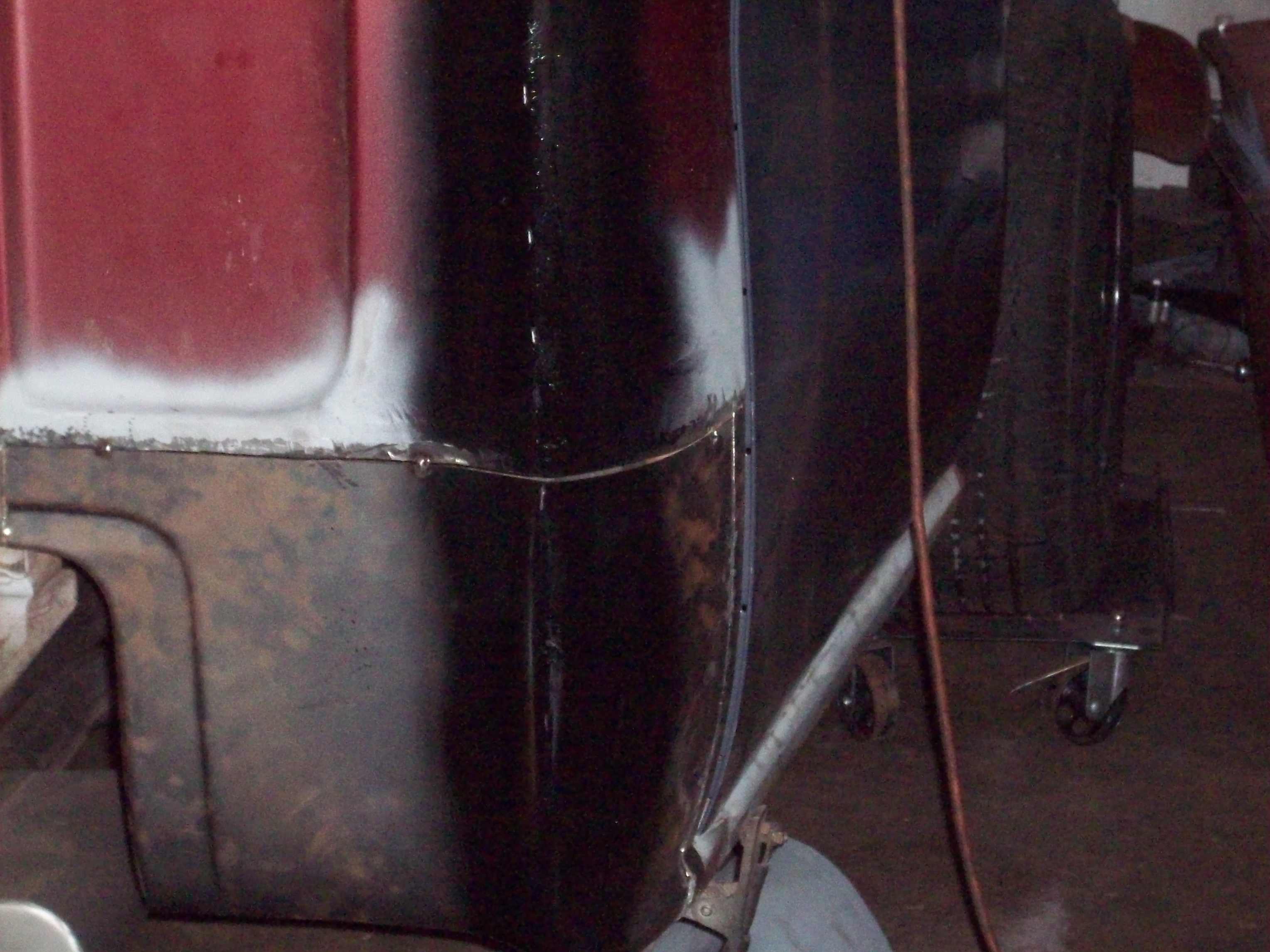

    So I went out and used some of my aviation grade tooling to get everything pinned up and in place, which made it easier to form the seam to make it even. I then welded it up little by little to not warp it. All I have to do is this point is cut out the old hand made body line of the cab corner (basically 2 inches on each side of the seam and 2 inches tall). Then this side is complete.

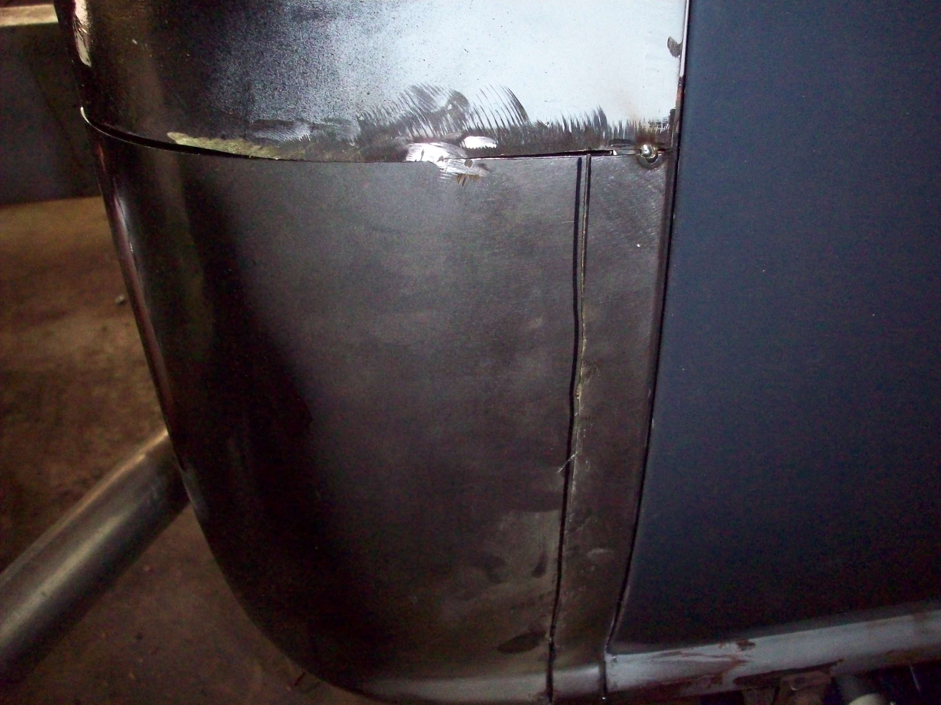

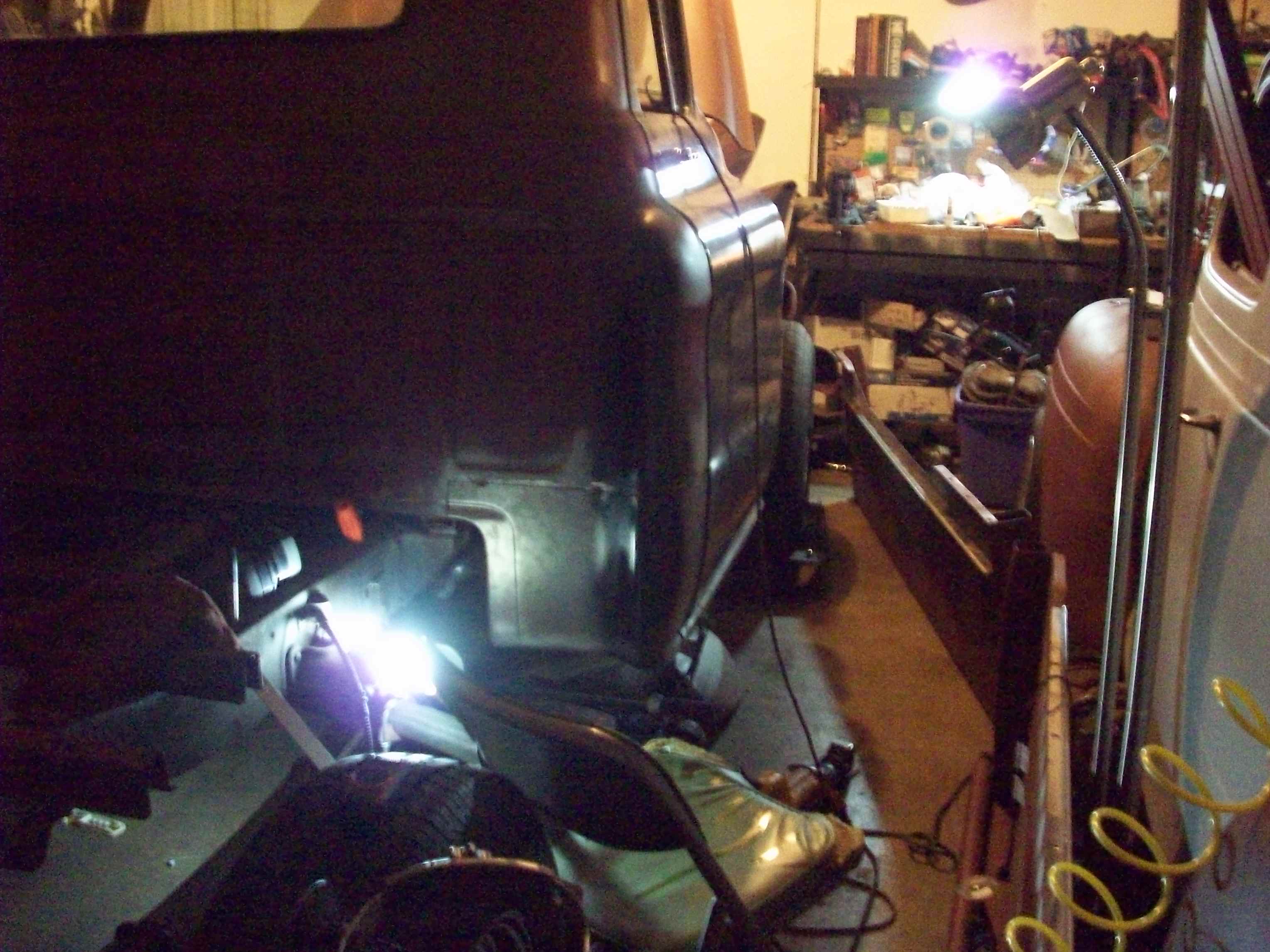

    So I got back to working on the truck after several days of trying to purchase a home close by with a BIG 4 car garage. I got the nasty part of the patch cut out and prepped the other to be cut out of the old patch panel. You can see how far off this was, but it is kind of exaggerated without the corner being there. I will tack this all together and make sure it is perfectly straight before welding the seams up.

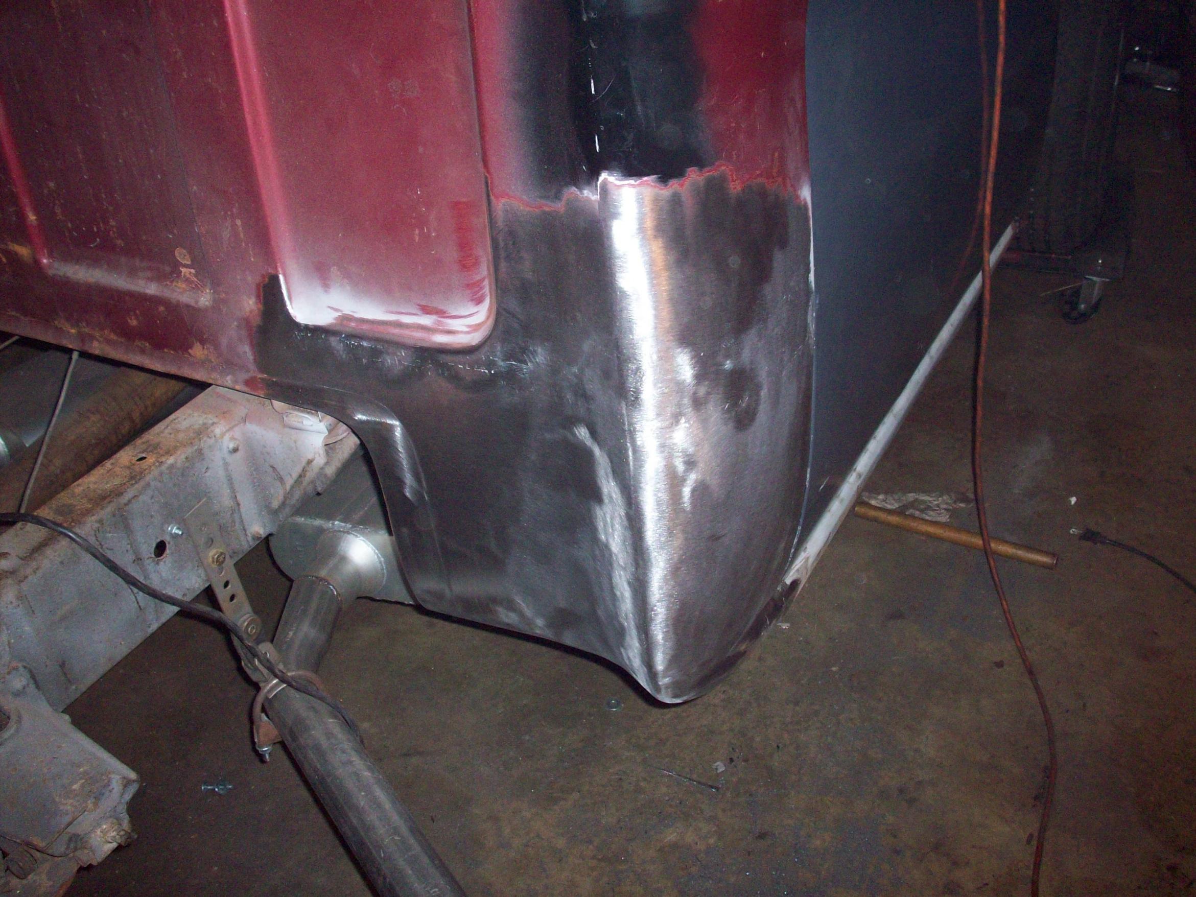

    I actually had some time to run a few errands today and finally found some time to myself so I started working on the cab corner. I hoped to finish it tonight, but I am not in any kind of hurry, but still spent 5 hours on it. Here are the pictures of what it looks like. I am proud of it. I will finish up the door jamb side of things tomorrow and then start stripping the back of the cab so I can get it in epoxy.

    Thanks! I foresee a skim coat of filler on it and that should be all. I will finish it up today and see how far I get on stripping the back of the cab. I am happy I get to work on it again.

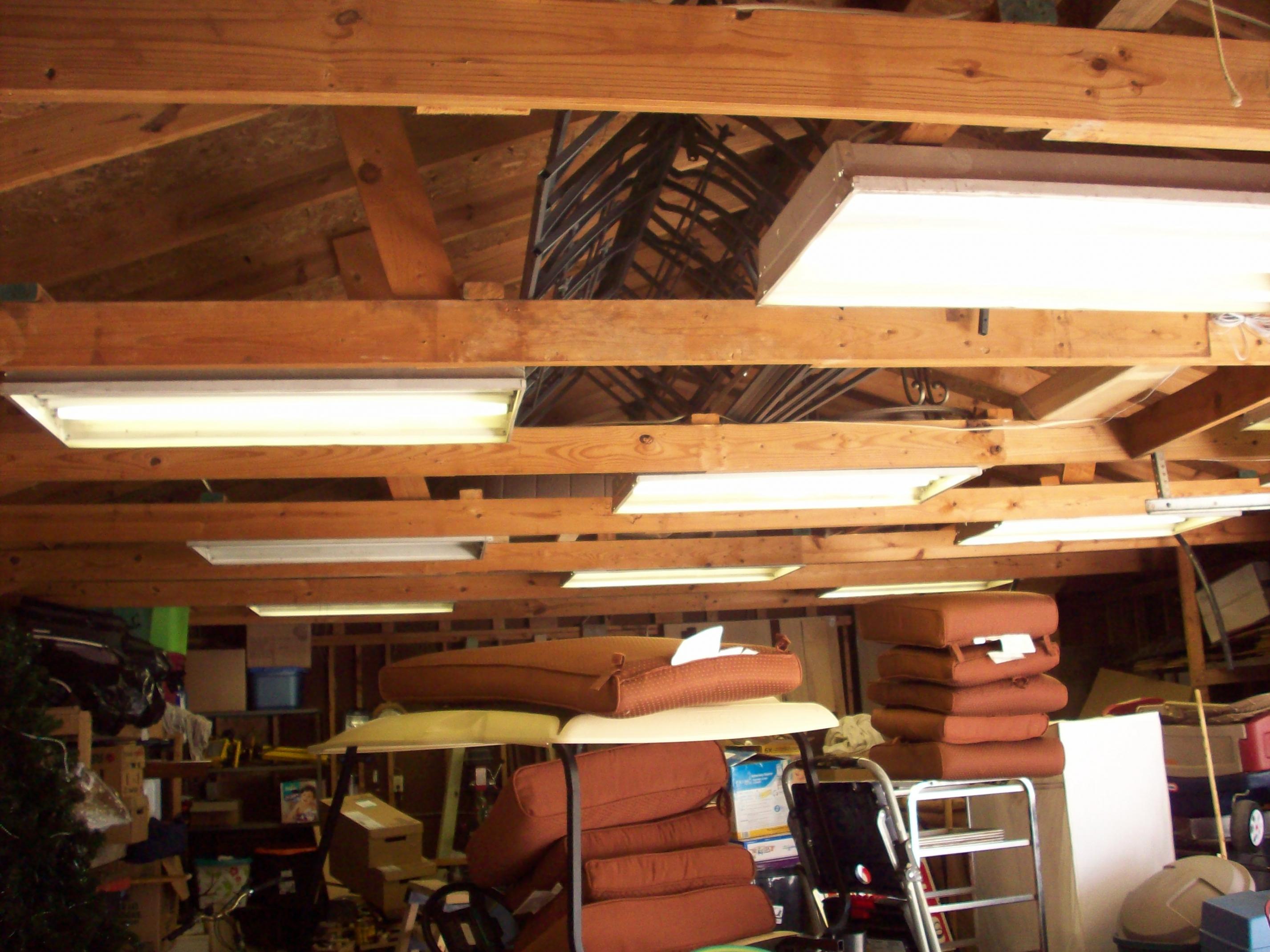

    Here are some pictures of the 4 car garage! I am standing about 15 feet away from the wall for most of these pictures. Once these owners get their **** out of the way, its hot rod time! It needs a little work, but all in all its a great buy.. Plus with all of the lighting I can get a nice tan (16 lights, 5 feet wide and 4 feet long) lol
