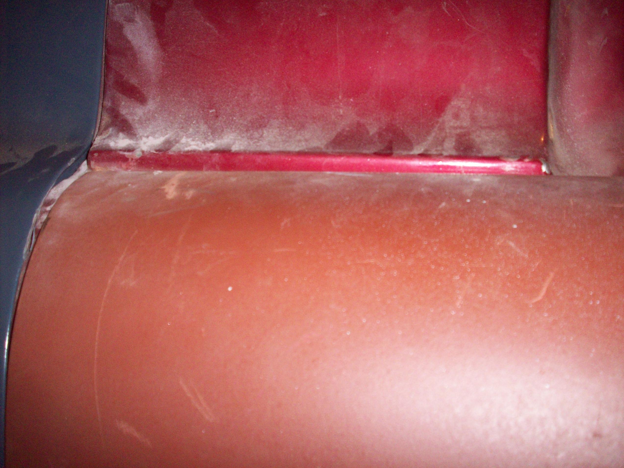

    Well I shimmed these up, but am still having a problem with body alignment. The body mounts are not rusty, the top bolts are good (no issues), and I have the front shimmed up quite a bit. Does anyone have any idea on what is going on or what I need to add to fix this? Any help is appreciated.

    The front..as in front of fender, or top of fender where it bolts onto the cowl or whatever??

    Hmm....from the pics it looks to me like the rear of the fender needs to come up some and either the door or the fender needs to move to open that gap up. I'm not sure if thats what you're trying to fix or something else that I'm not seeing.

    that is what I am trying to fix. I already know that the fender is back because of the hood springs yanking it back. My issue is the fender is sitting too low and find it ridiculous that I need to have 1/2 an inch of shims under the rear fender bolt. I am thinking something isn't correct. Too many body shims?

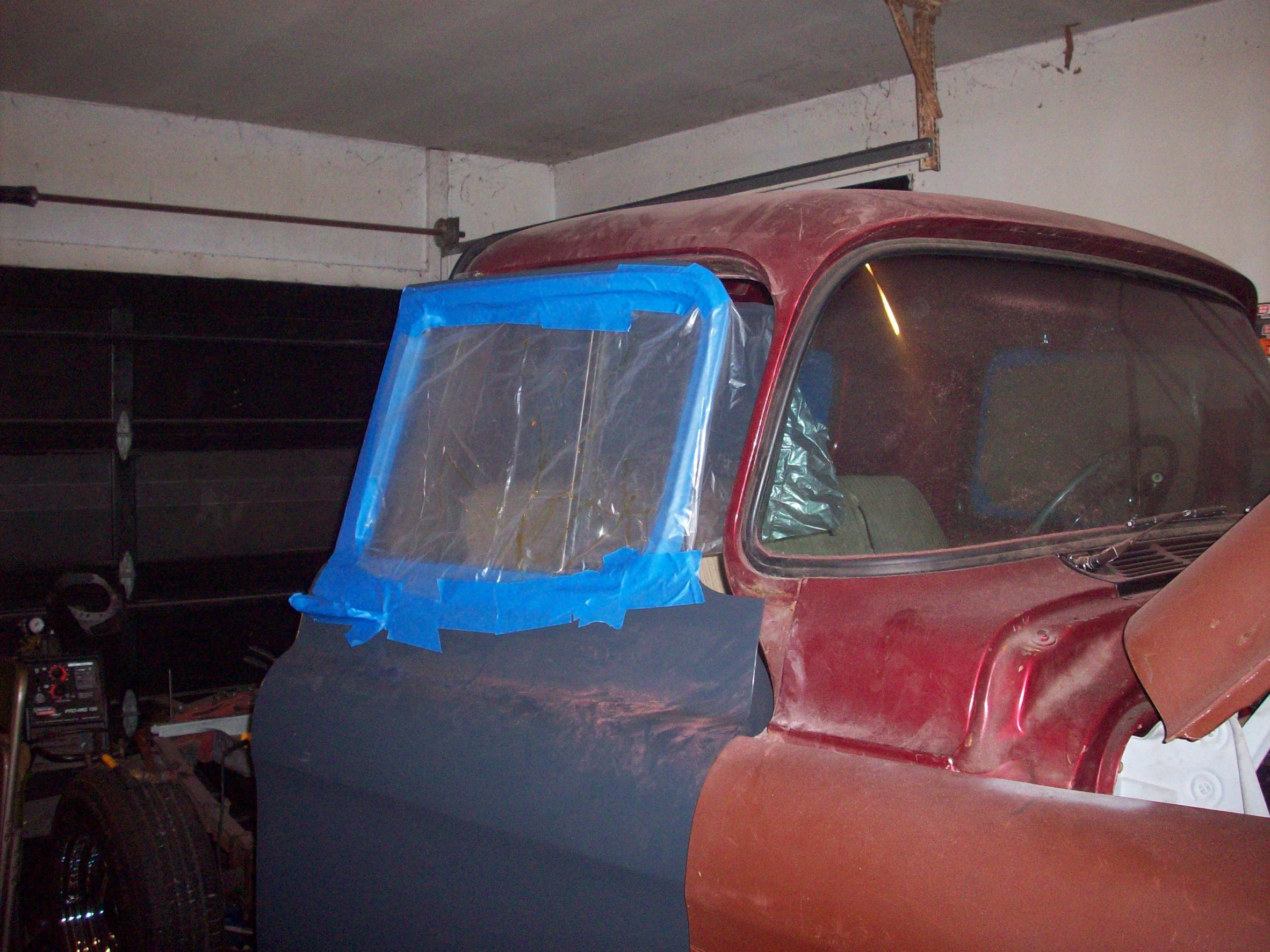

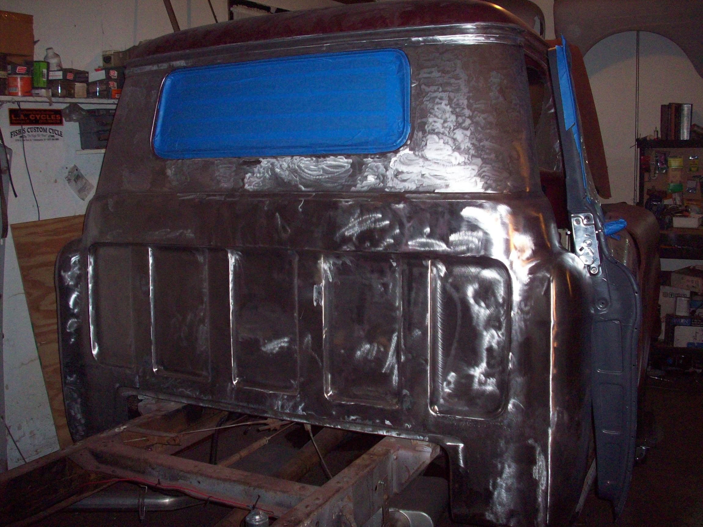

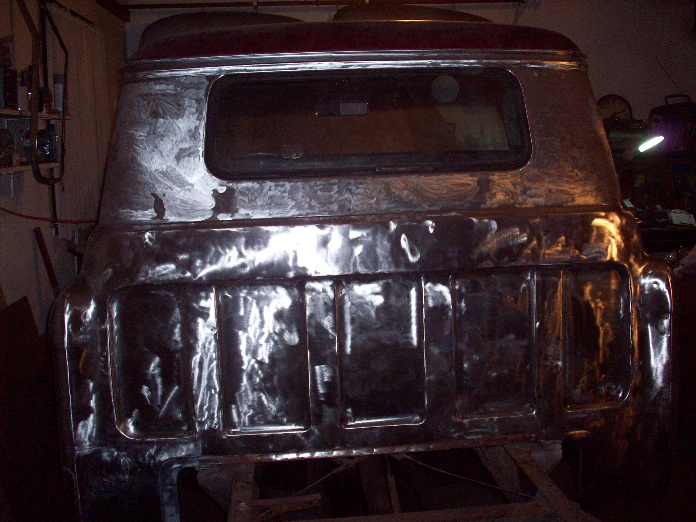

    I got the rest of the rear of the cab stripped. Here are some pictures. I just have to do a couple finishing touches to a couple areas and then go through and weld up my holes, then primer. I was debating about getting part of the roof done, but I think that will be another day.

    I finished up the rear of the cab as far as stripping, filled in all of the holes, ground them down and finished them off. I also found a couple drum sanders that were small enough to fit on my 90 degree pneumatic angle grinder to get in the tough spots. I taped off the windows, chrome and will try to get the back of this in primer tomorrow evening.

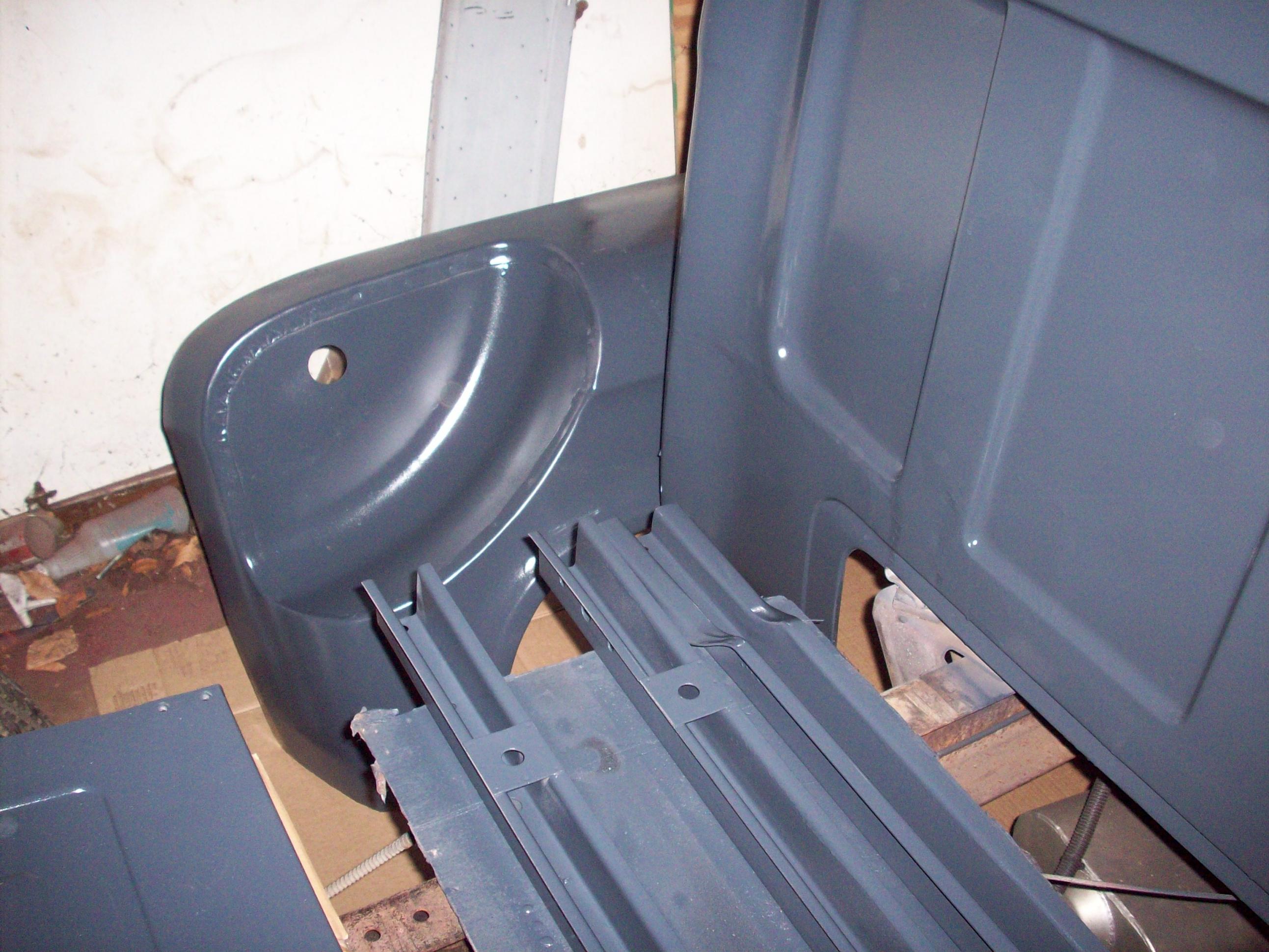

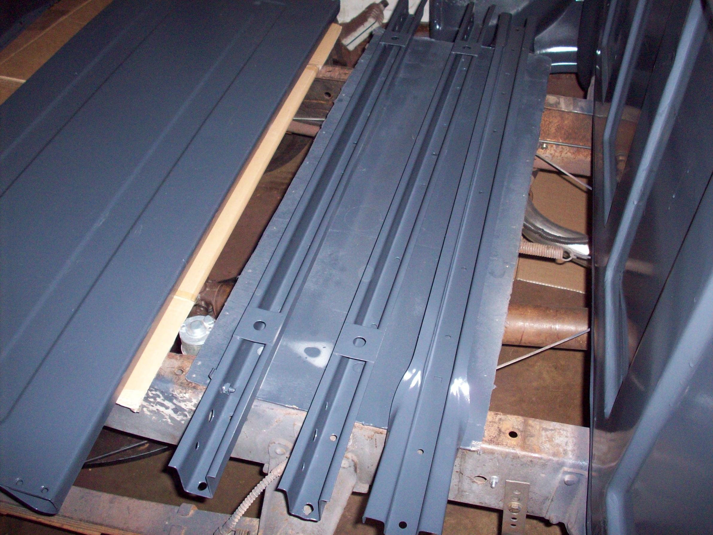

    After 2 hours of getting my bed from the blasters, 4 hours of prep work following, and 6 hours of nonstop painting I was able to get the bed, the back of the cab, and a box of misc parts in epoxy. Lordy was it a lot of work. Here are some pictures

    That looks like a pretty clean strip job, what are you using and what's your technique?

    Well I had two things that I was doing. First I was using the 3M mesh paint and rust remover wheels. That took about 4 hours to strip the bottom half of the cab. My black and decker drill took a dump for the 2nd time so I just bought a dewalt 7 amp wrist breaking drill. This drill is worth the money and frankly cut my stripping time in half. The wire wheel had the top part of the cab stripped in 1 hour and 45 minutes, way faster. Just take your time and do the hard stuff first, like all the contours. Then for the hard to reach places I used my dremel tool with a round sanding drum (very small 1/4 inch drum) and that took care of it.
    The epoxy is a dark gray Dupont epoxy 2570S and 2505S activator. It looks green and this epoxy is non tintable. The high build that goes over it is tintable, so that is fine. I am going to have to probably scuff and shoot more epoxy on all of this stuff before doing any of the body work (filler, etc.) because I have a couple dry spots and used an entire gallon of this primer for both sides of everything. I tried to put some thicker coats on stuff when I got close to the end when I realized I did not have enough. You will need 1 gallon and 2 quarts of the activator since it is a 2:1 mix. Your total for this stuff should be about $400

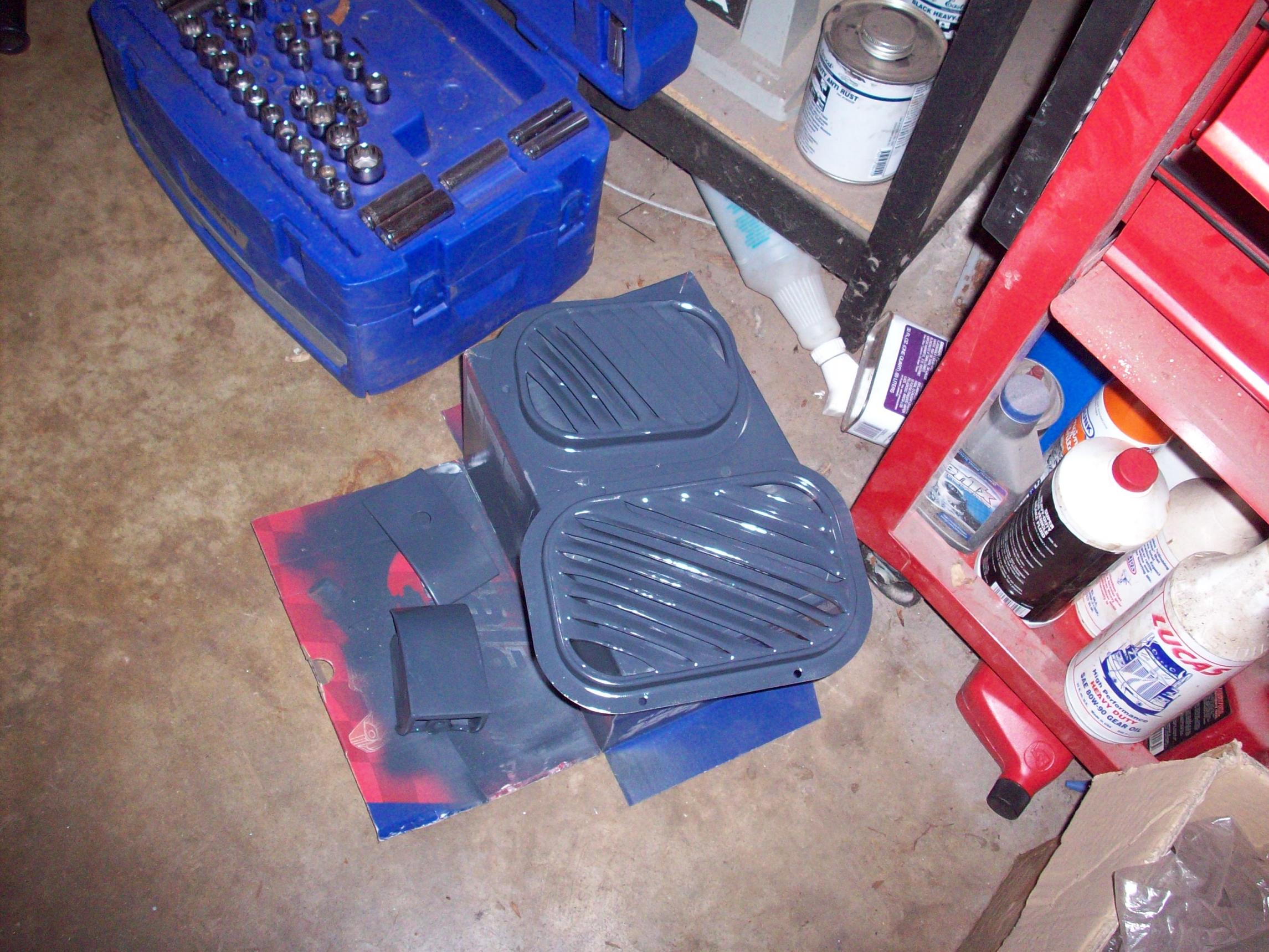

    What are these?

    Covers for the kick panel air vents, you can see the right side vent in this pic...

    Ah........P.O. replaced the oem kick panels with diamond plate....never new they existed.
