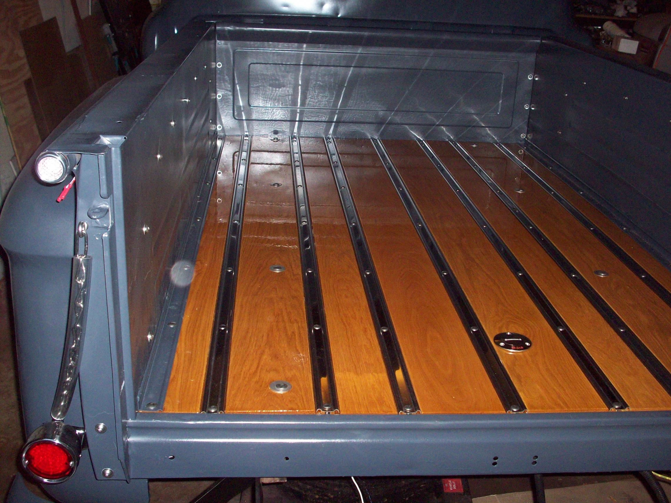

    Well I had to modify my fill neck to incorporate a vent so the tank can breathe (pictures to come soon). I will cap it off when the truck is in the garage. I also cleaned a bunch of stuff up, worked on figuring out where fender braces went and what I am missing and put my wood bed in and cleaned all of the stainless strips. I will bolt it down tonight or tomorrow and hopefully move on from there in a hurry. I need to go buy some more hardware for the fender braces and new hose clamps for the filler neck (the two I bought were too small). I think I am going to have to drill into the side of the bed too to get the rear fender brace to work correctly. I decided to hook up my tail lights too to see if they work (yup!) the right blinker doesn't work though (something in the column)

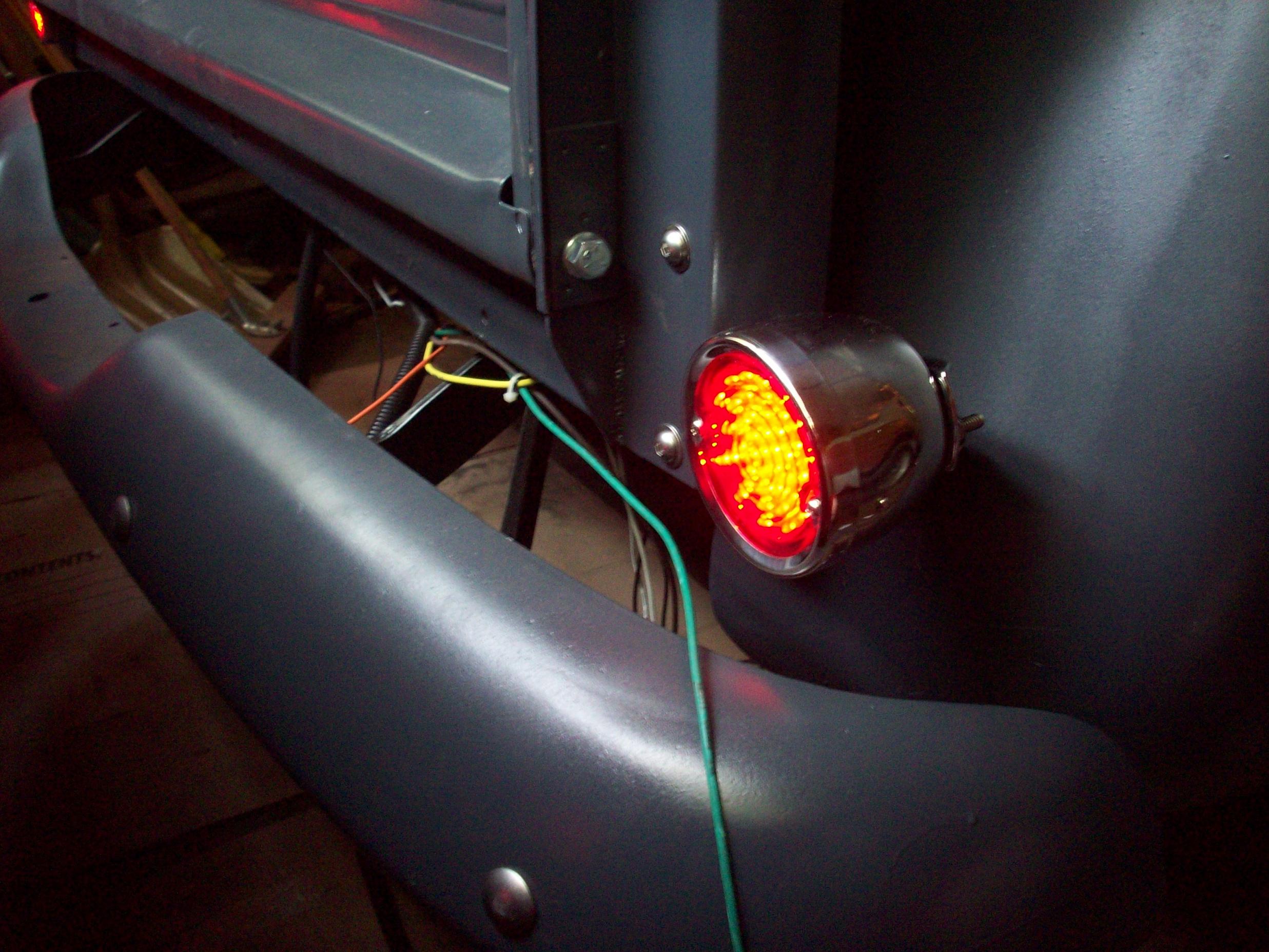

    Here are the pictures of the tail lights and Shannon's approval of the truck so far

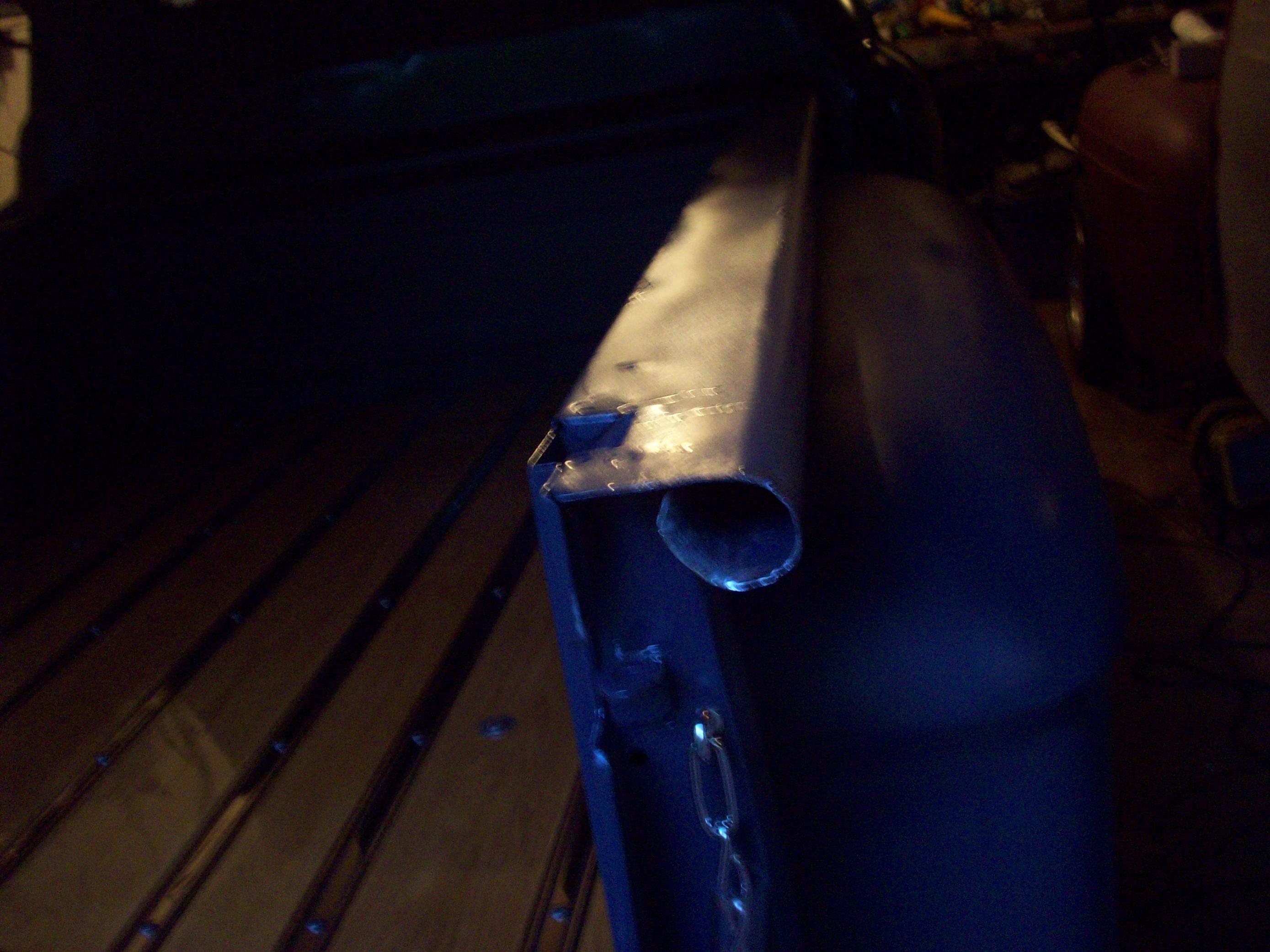

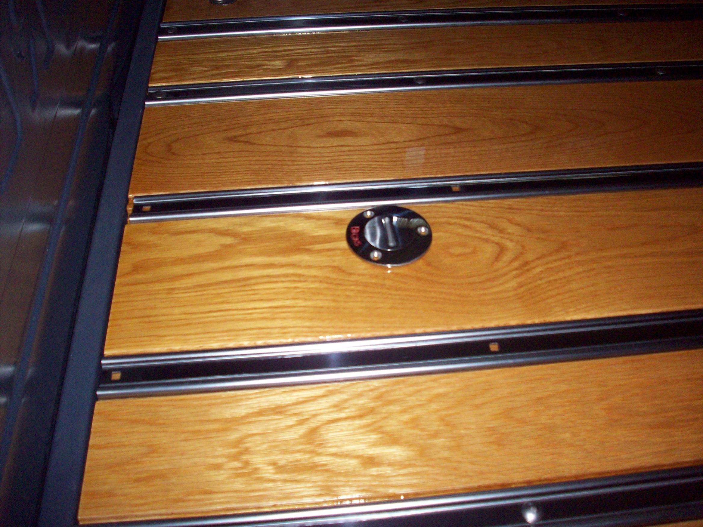

    Well I spent all day putting the nuts on the bottom of the carriage bolts. over 100 different bolts, but I didn't tighten them down yet until I have everything square. Eegad, 12 hours worth of work = no fun. I also hammered out the bed hole for one of the bed LED's since it was out of round. I started working on the p***enger side one, which is far worse. Once I get that done I will hook them up to see how they work. Here are some pictures with the garage up. It has been 85-95 degrees out the past 3 or 4 days with high humidity. It is like working in a sauna, but that hasn't stopped me so far.

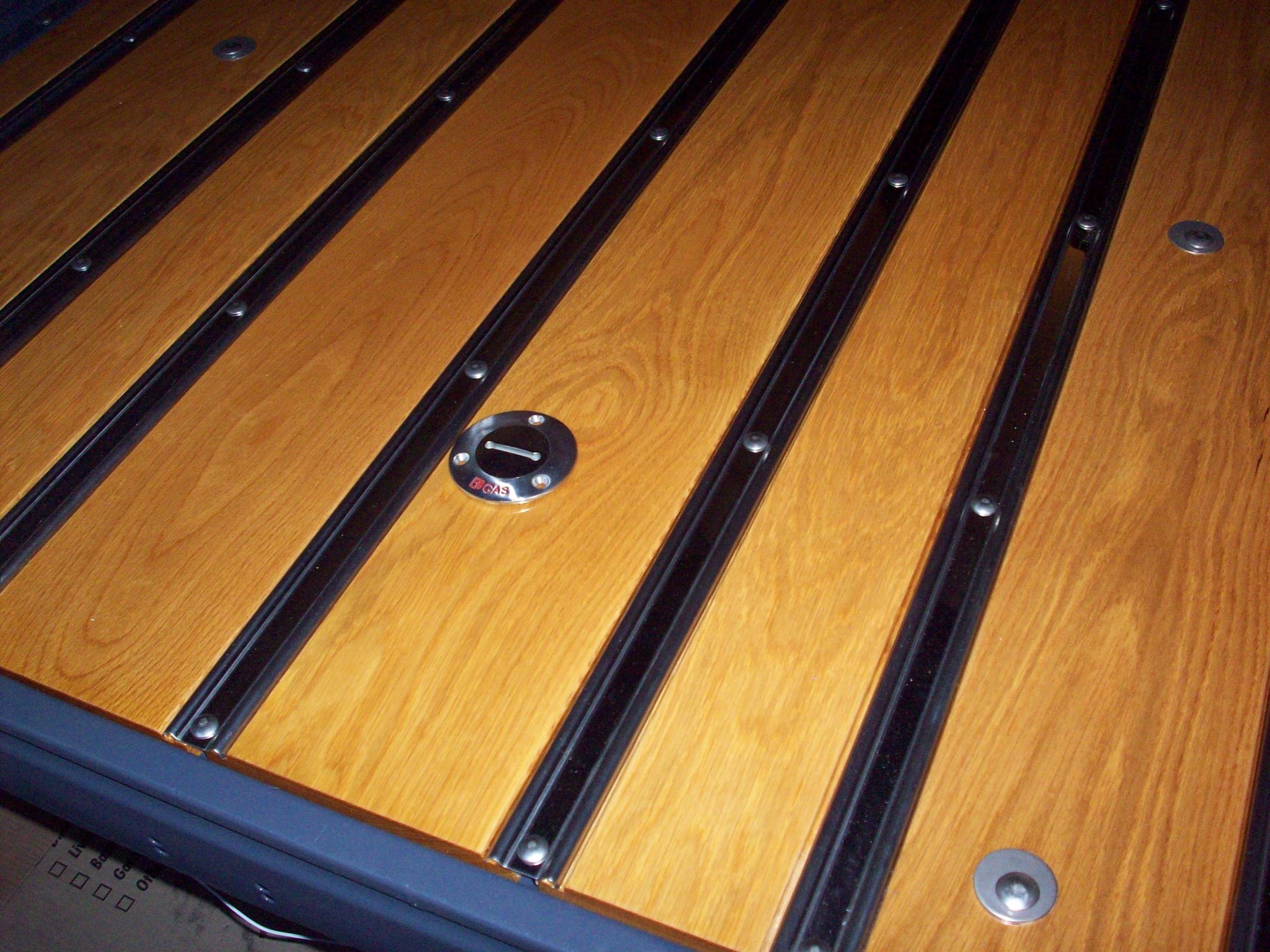

    Here is a shot of that other bed hole, which was almost square when I started. Hopefully I can get it where it needs to be soon so I can hook these lights up :D

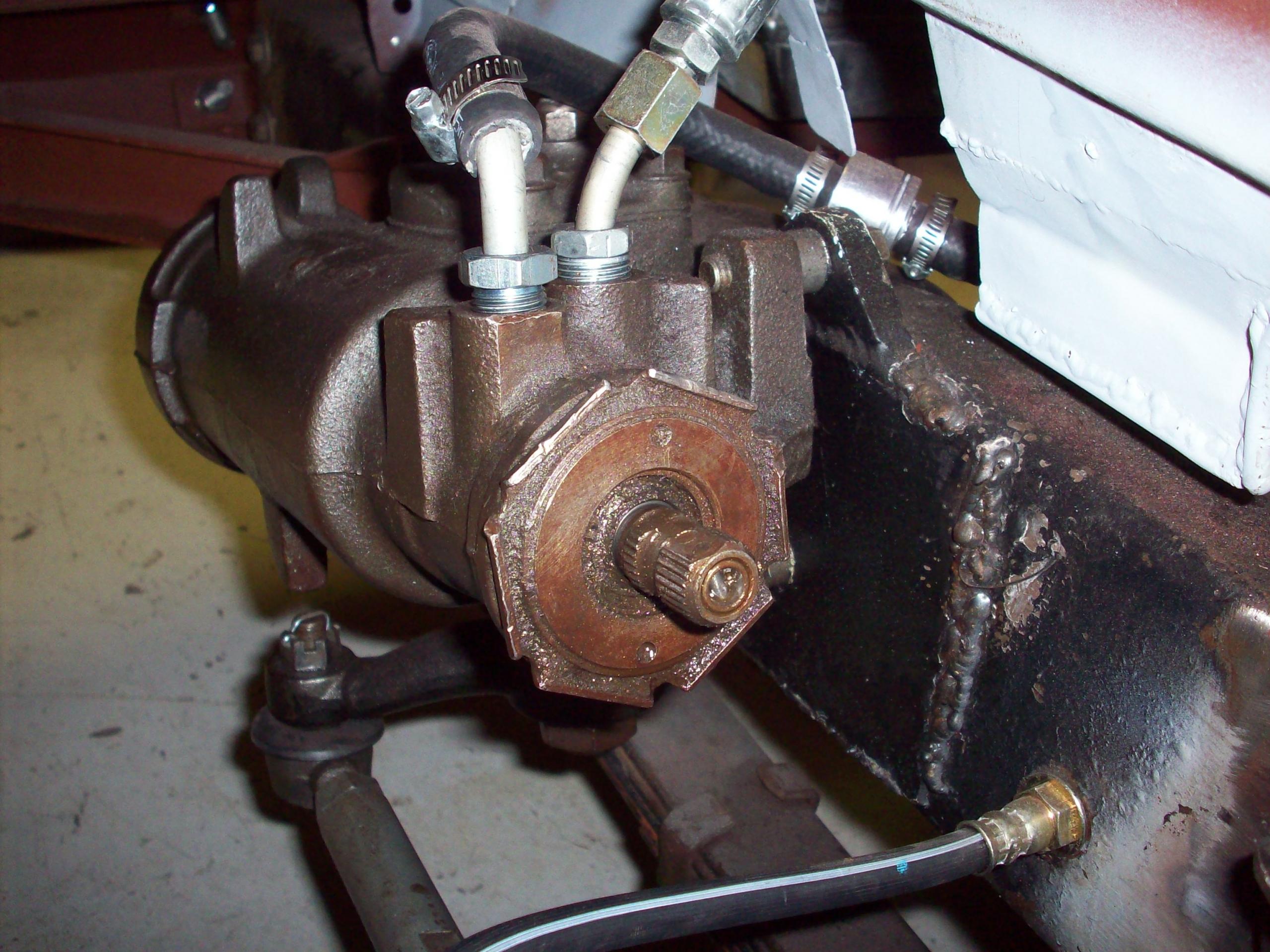

    Alright, so I got this thing tuned in and running sweet. Hell, I even did a burnout around the back half of the block. I got in after about 4 times around the block and go to back out of the driveway and I hear, what sounded like a gunshot and my steering wheel started spinning.
    I am thinking that one of these control arms were a little bent/weakened from the wreck this truck was in (drivers side of the truck was damaged). So it bent the **** out of the tie rods, the gear box couldn't keep up, exploded, snapped a couple pieces off the splined end, and the steering column sheared off completely in one place. Pretty scary ****.
    Long story short, someone is watching out for me because it could have happened on the highway, which I was about 2 minutes from. The steering locked up turning hard left so it would have been a head on collision at best.
    Here a couple pictures:

    I'm trying to figure out what happened here. I know that style of power steering is not very good, the pitman arm and drag link are way too short to have the right geometry, and the box fits where the tire has to go when you steer to the right. Also the box is no where near where the column is, so you have to use a couple Ujoints that have quite a bit of angle on them.
    If I were you I'd be looking into some other way to steer the truck. Consider this event (whatever it was that happened) as a warning.
    I still have manual steering on mine. It's not like I haven't thought about power steering over the past 35 years, I have....I just haven't found a good enough way to do it.

    The steering u joints I was using were not in a bind, but yes they had a weird angle (had that set up correctly). I had to pull the steering shaft out of the truck to unlock the wheels a little so we could turn them to try to get it on the trailer. When the tires turn full right they do not come close to rubbing on the gear box, so that seems to be okay for now and the turning radius seem to be decent. I totally agree with you about the steering so that is why I am going to start over with new stuff or stuff I know will work. Its hard to determine a root cause on this one since all this happened all at once (checked it before going around the block). Once getting it up on the trailer I could see the extent of the damage... I can't really do manual steering, what would you suggest instead Jim?

    Why not? do you not have the strength? The steering effort is not bad if you run skinny tires, a full size steering wheel, and rebuild all the parts. Or maybe I'm just used to it, and I don't know my own strength.

    Shock mounts have changed location, power steering bracket is over old location, the list goes on. To top that off I would not be able to run headers because of the engine sitting as low as it is (would interfere with the gear box location.

    Glad it happened at home! You have mentioned several times you never felt good about the steering setup, good gut feeling there. You have to listen to yourself first when building rods, you were right about that steering being unsafe. It will be better with your second design, I'm sure!

    I'm right there with you on this Squirrel, I have manual steering in mine for the same reason.
    Had one with 80's Toyota power steering, one with a fatman front clip and one with late 70's Blazer power steering. The only one that didn't give me geometry issues, or stress cracks, bends and failures is the fatman set-up. Mainly because the power steering on the fatman was designed to work with that front-end.
    Hate to say it, but adapting power steering to these trucks is never efficient or effective unless you go with front steer and fabricate special-purpose steering arms with correct geometry....and THAT takes bucks.
