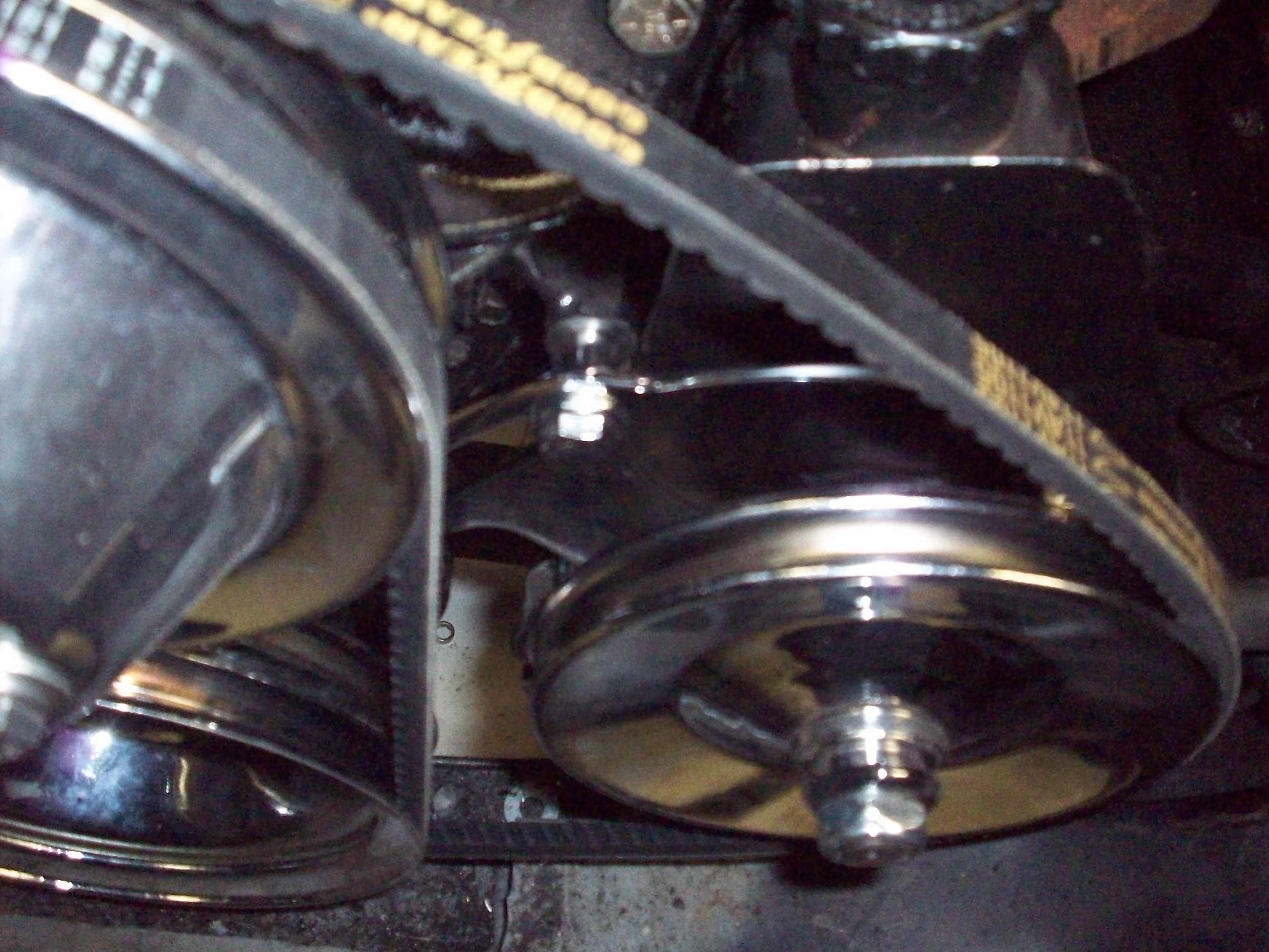

    Well I went through and installed my new power steering bracket ***embly on the truck, but didn't tighten it down yet. I don't have all of my tools over here yet, so it was just installed finger tight.... I can tell there is a difference and I am pretty happy with it. I also removed the tie rod and the drivers side tie rod end/steering arm. I should be getting a couple things in the mail soon, so that will be nice. I will post some more pictures as I start rolling on this more.

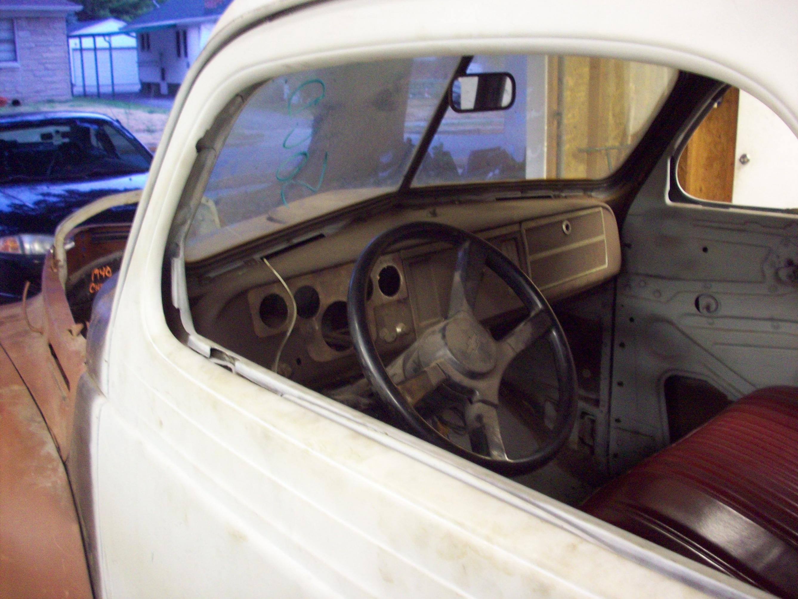

    Well I got all of my parts in, just waiting to get all my tools together and the garage cleaned up before I start really taring into the pickup. I did however remove the tie rod and the left steering arm (both bent). I installed the newer column and will be shortening it 4 inches total and shortening the actual shaft 6 inches. Then I will have enough room to play with and make sure everything is done correctly. The Borgeson U joint has some issue with it connecting with the power steering gear box, so I will have to figure something out with it. Anyway, I got the plymouth over and picked up a goodie from a hot rodder here in town that saw the coupe.

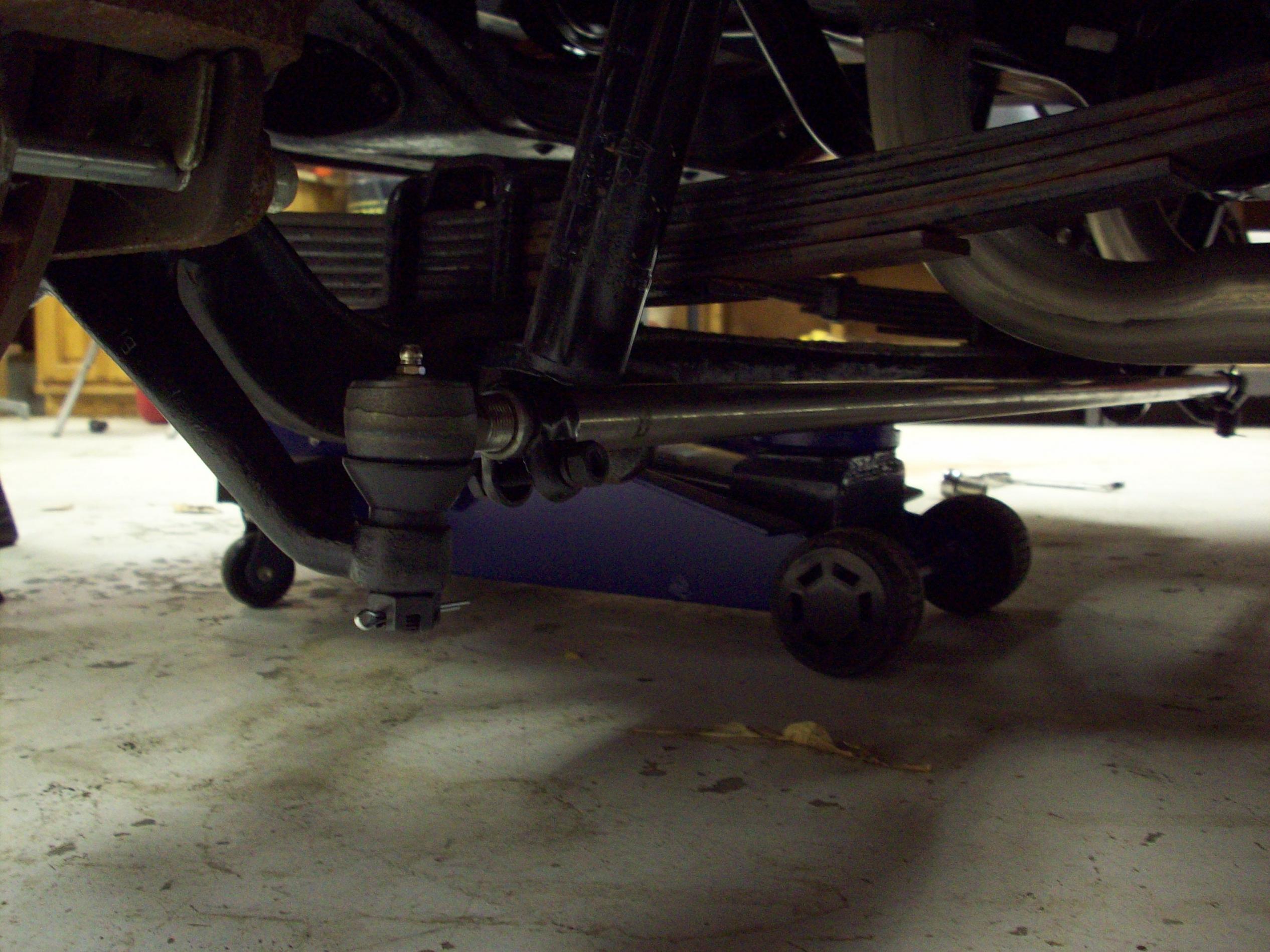

    Well I decided to start on the truck even though everything isn't cleaned up yet. You can see I have a lot of little work to do. But I had several small victories tonight, one of which being the input shaft of the gear box. I had to buy a couple very small files to basically make the grooves of the teeth sharper so the Borgeson u-joint could actually engage it. I had to do this a little on the u-joint itself too, basically to make some guides so it could line up and install easier. It still needs a lot more work, but at least it engages the first set of teeth! I will need to adjust my design for the exhaust too to be used with the tie rod (needs to be raised about 4 inches). I also need to find out of someone makes lower shock mounts for these trucks that do not interfere with the tie rod as much, other than that it will be ready for the road again!

    correct me if I'm wrong, but doesn't the newer style tie rod mount through the bottom and not the top? All the installs I've seen have the tie rod end coming up through the bottom. It looks like it would solve your shock mount clearance issue too.

    On the p*** side you can relocate the shock back to the front where it belongs, can't you? I don't know what to do about the driver side, maybe make your own lower shock mount bracket.
    You have the correct Ujoint for that steering box? They changed the size and spline count in the late 70s.

    No on the shock mounts because in order for me to swap them to the back I have to flip the p***enger to the drivers side and vice versa. I wish I could swap them. Here are the shock mounts that I am talking about (they sell them cheaper at the truck and car shop):
    http://www.brotherstrucks.com/prodin...number=5559FSM
    The splines are correct for the one I purchased. Its just the borgeson doesnt want to fit on there right. I had to use the file to basically make a groove to lead the teeth into the correct area. It is a 30 spline 3/4 inch spline on the GM gear box and a 3/4" by 36 spline off of the column. The column slides right on.. This one didnt, but now after a little work does.

    It would solve it, but you can only do that with a drop axle from what I am being told by a lot of people better at this than I am (Squirrel). An issue that I have if I do it the way I had it before (the way you suggested) is that the tie rod now has the ability to drag on the ground or get caught on something without the front axle protecting it.

    I was just wondering why you mounted the shocks in the rear? Did you have clearance issues in front? Weren't the upper shock mounts riveted to the frame in the front?

    When he added power steering, the gearbox mounts outside the frame in front of the axle...right where the shock used to be.

    Oh, I got it. What a mess to have to figure out. Maybe the shocks could be mounted inside the frame rails in the front...unless you have engine side mounts.

    Actually, after looking at it, if those brackets draw the bottom of the shocks closer to the axle by an inch or more, I would agree that they would be the right solution. That new power steering and box really do rob a lot of room.
