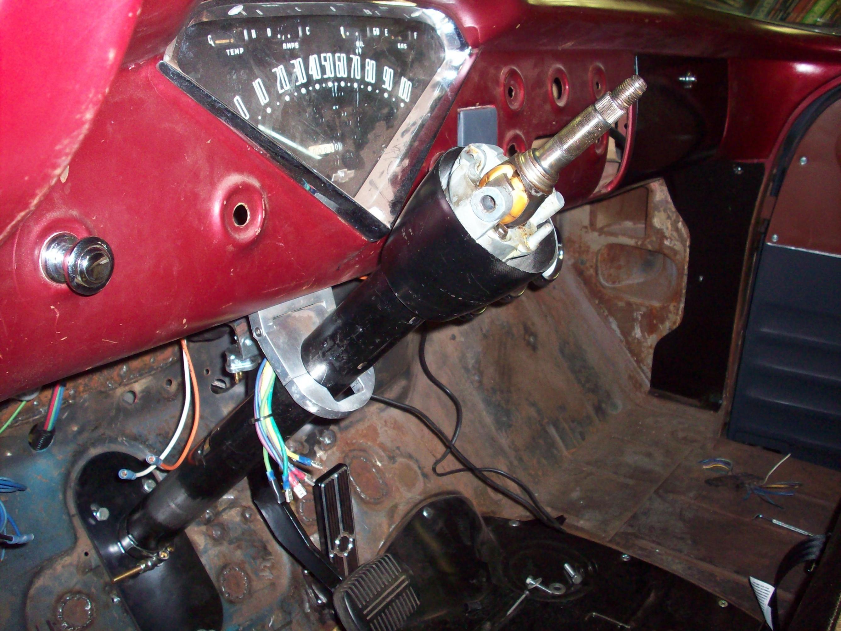

    I just got my steering column from the machine shop at work, everything looks good. I just need to sleeve everything. and put her back together. I am feeling a lot better so I may work on the truck tonight.

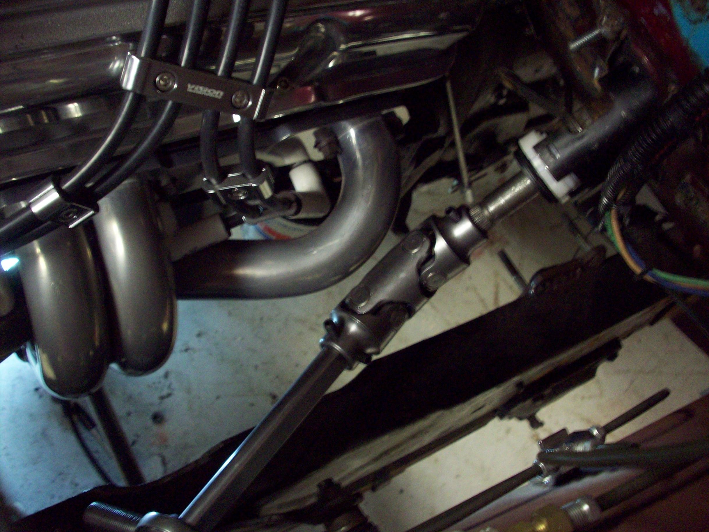

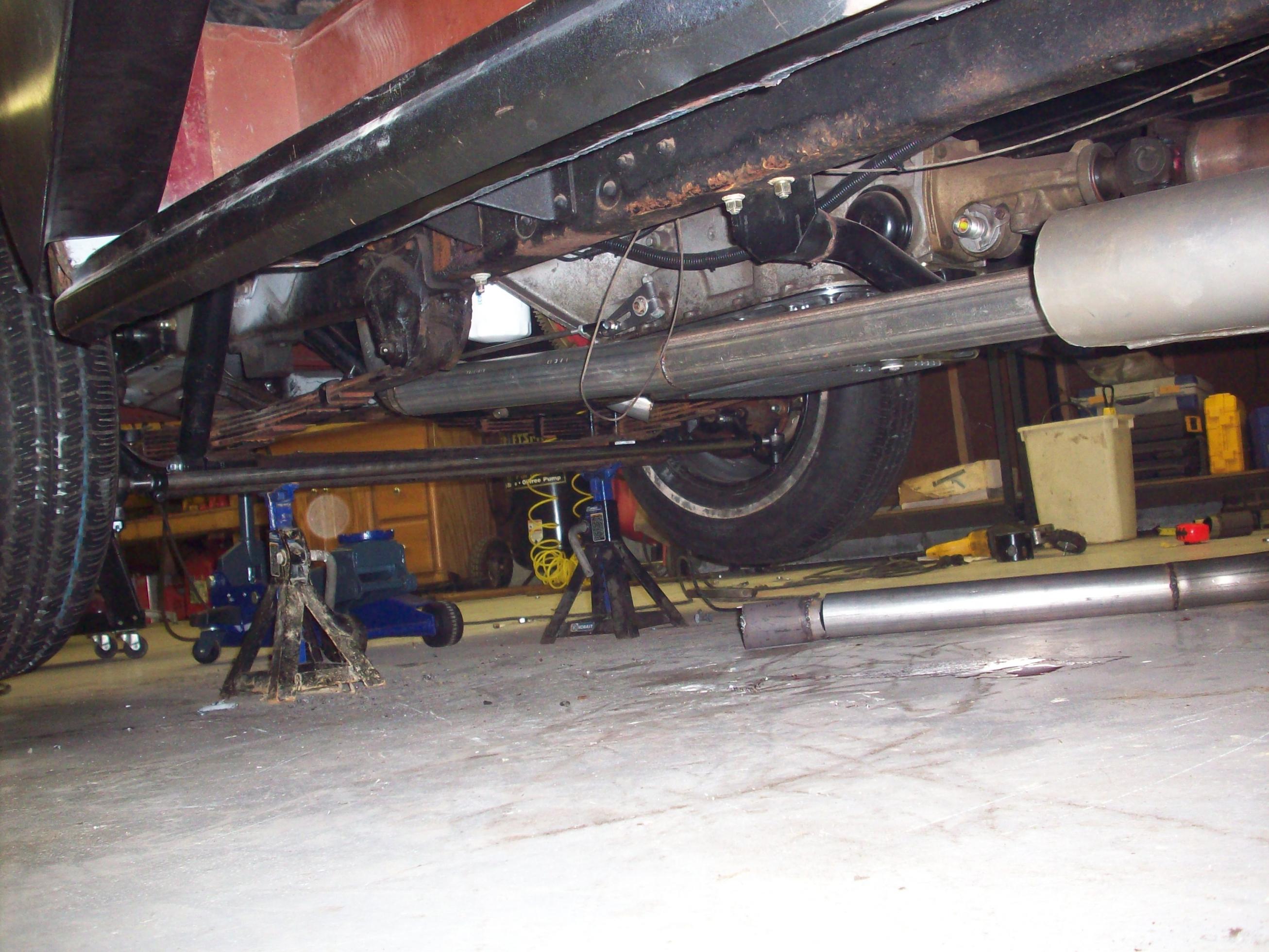

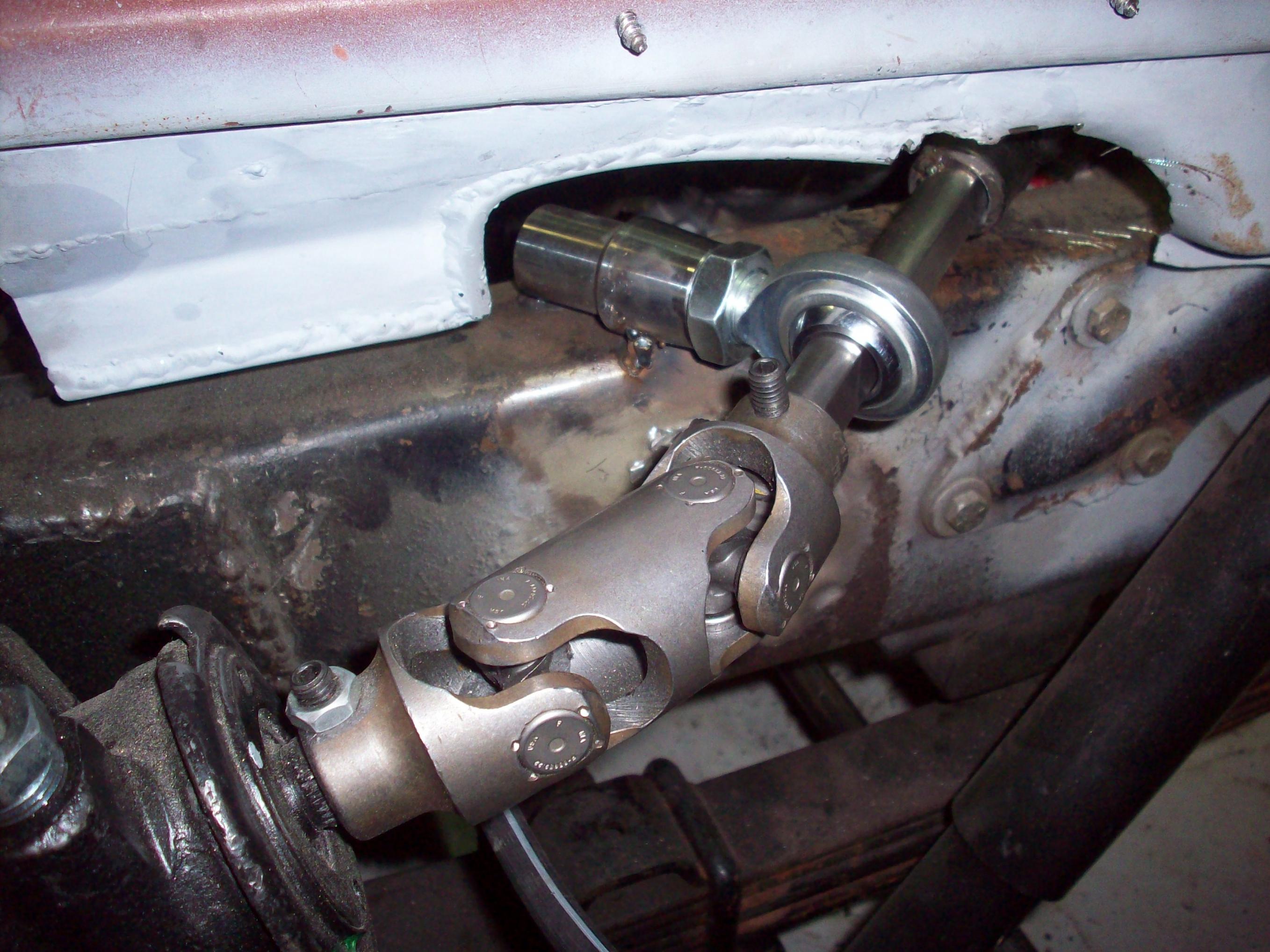

    Well I got a lot accomplished on the truck today. I mocked up the driver's side exhaust, have it partially welded, but ran out of welding gas when I started to get it finished. I didn't get a chance to get to the p***enger side, which is the harder side to do.
    I also installed the steering column to mock up the steering shaft and get it cut to the correct length. I will need to drill a hole in the frame for the tie rod end to support the steering shaft and then after that is accomplished everything just gets easier from there.
    Here are some pictures

    Great progress! On a funny note, kinda, I can see that I'm not the only one having issues welding up the firewall. That sheetmetal is just a ***** to get clean welds on. I'm like you, I see how clean your welds are on the steering shaft...mine are clean on heavier gauge metal too, but the thin, lite stuff...just a bear to weld.

    alright I got my mig tank filled at airgas up the road about 15 minutes, so that was good. 24 bucks out the door isnt bad for a 3 foot tank. I welded up my drivers side exhaust and need to grind a couple things down and reinstall that side. I have to start on the p***enger side here shortly. I fixed the issue with the steering column, a minor hiccup that turned into me tearing the whole column back apart, fixing a couple things and putting everything back together. I currently have my steering column installed, need to bolt it to the firewall, need to fix one bolt hole, I am waiting on one steering u joint to fix my steering shaft, need to finish up my p***enger side exhaust and then I am driving. I plan on knocking a majority of this out today. Pictures to come

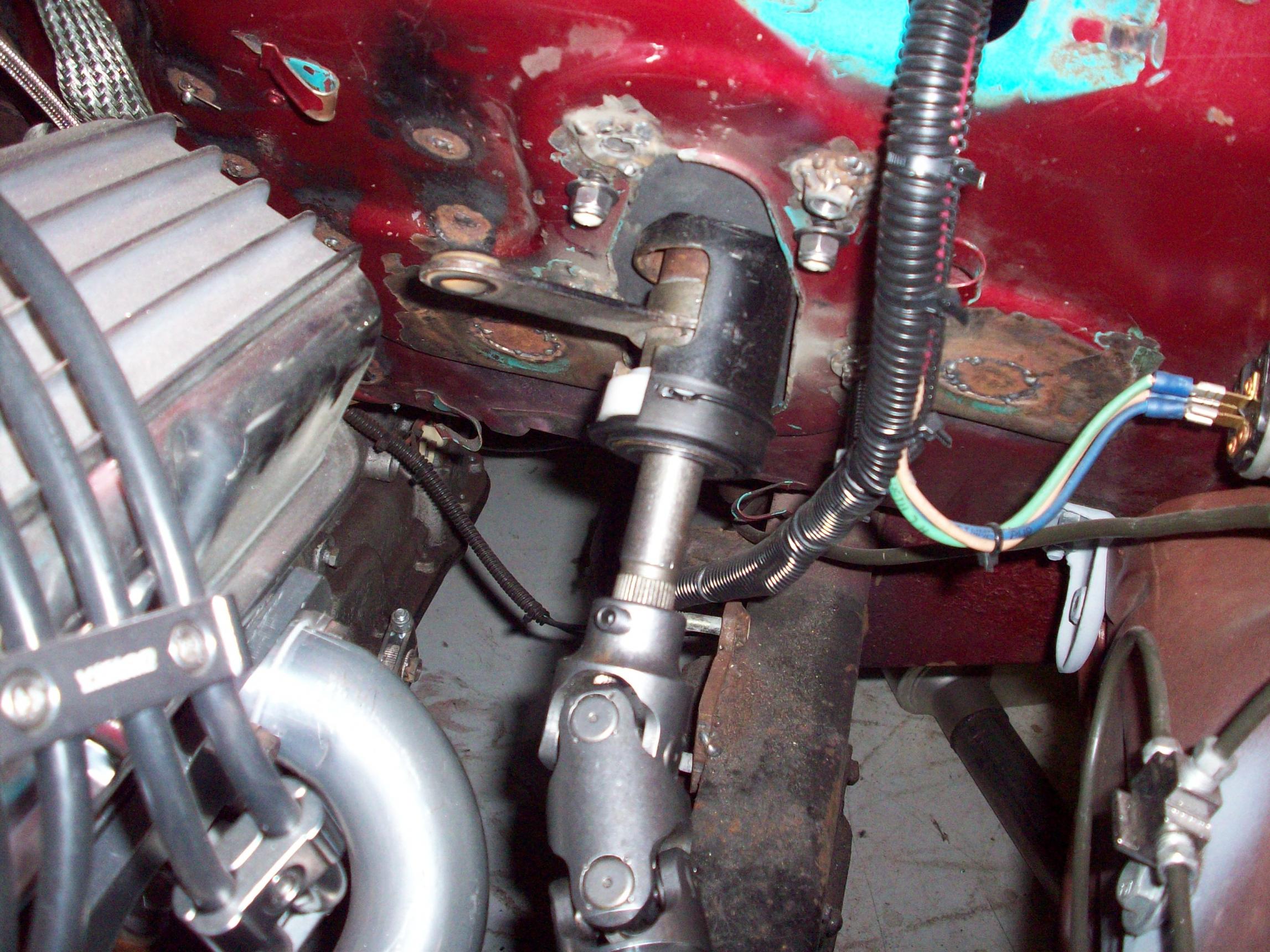

    Well I have found how I am going to fix my steering shaft. I mocked it up with some of my old parts and some new parts. I went through and welded up my drivers side exhaust and bolted it up, worked on the p***enger side, and got tired of working on it so I went in. Here are some pictures

    Well I finished my design and it works great. I need to weld everything else together and she is read to drive. More to come.

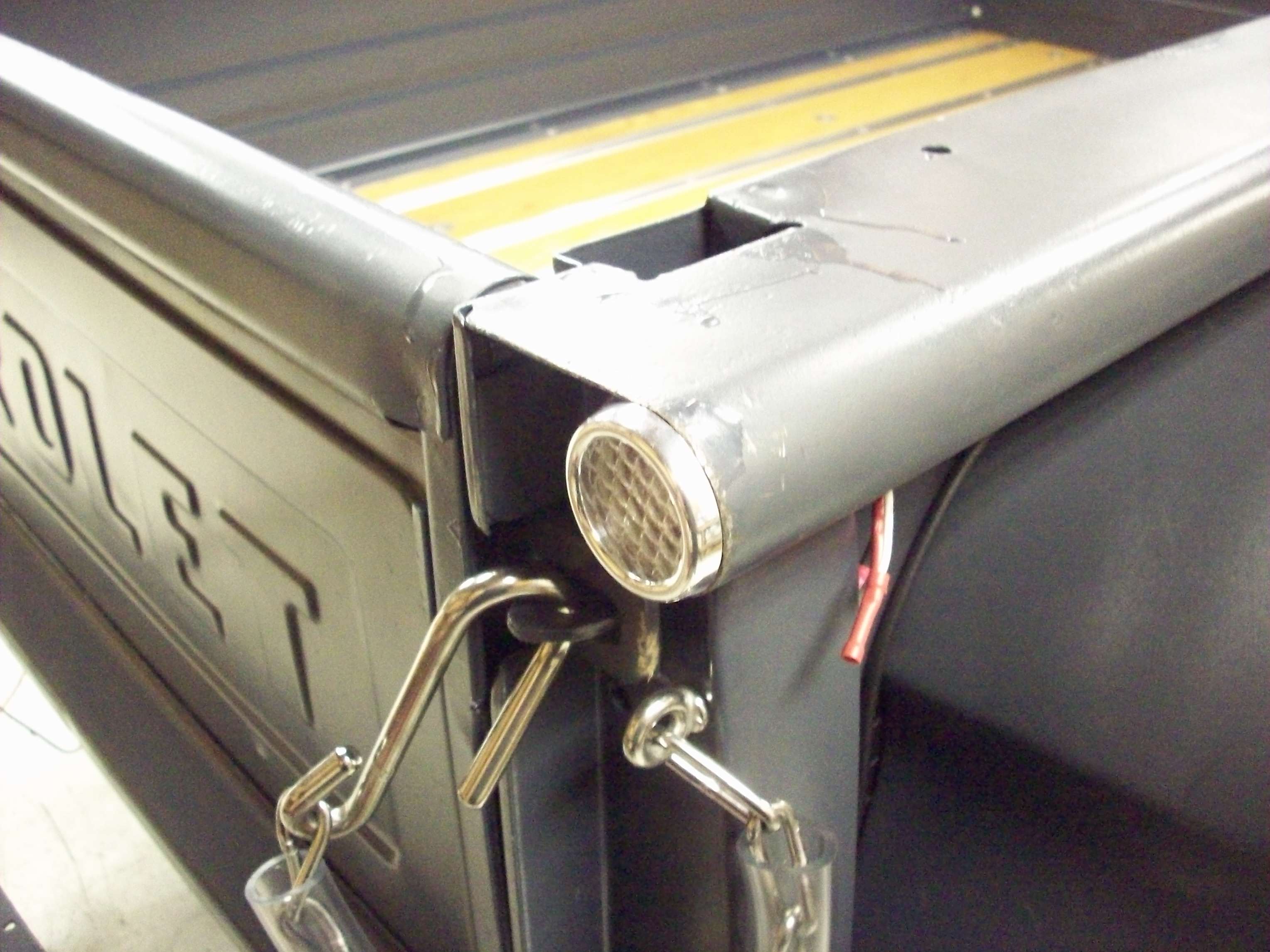

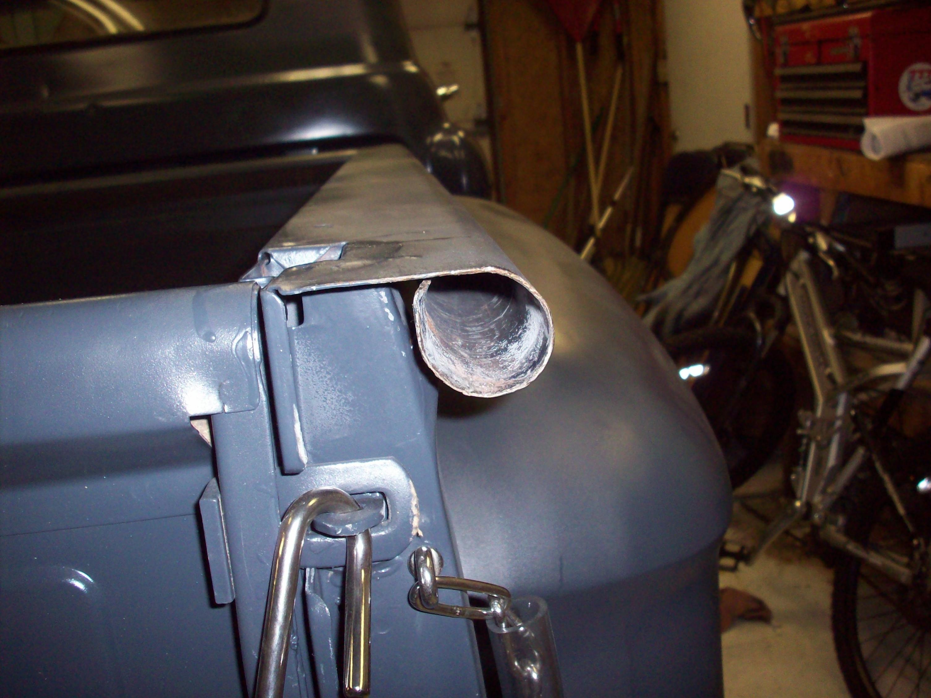

    okay after several weeks of not working on the truck I decided I was in the mood to take some **** from it. I went out and just wanted to start on something small so I finished up the tach wiring and tried to start the
    Apache and now it doesn't want to start..... booo.... so at least the tach wiring works. I then decided to work on getting the other bed LED installed for the third brake light since I didn't want to open that back of snakes regarding the engine not firing. I worked it around with a br*** rod and a body hammer and then took an adjustable wrench to straighten things back out since the hole was previously closed up (or waaaaay out of shape). I have it now to the point where I can almost slide this bed LED in and start on the wiring. Here are some pictures

    I straightened the holes out on mine by rolling a piece of pipe, with a slightly smaller diameter, around the edge of the hole. If you do this long enough to heat up the metal, you can stretch it ever so slightly to fit your tail lights. Or, if you have a socket that's big enough, but it on a 6" extension and give it a couple taps with a hammer to round everything back out

    Here are a couple shots of the bed LED, I think it turned out better than I was expecting; just some hit marks that chipped the epoxy primer. More to come soon. The truck warms up at about 1000 RPM, but I need to tweak a couple things to make sure it is correct before going through and using the timing light.

    All good points, I couldn't do any of them because of the way it was pinched off originally, However, this is good advice. Thanks!
