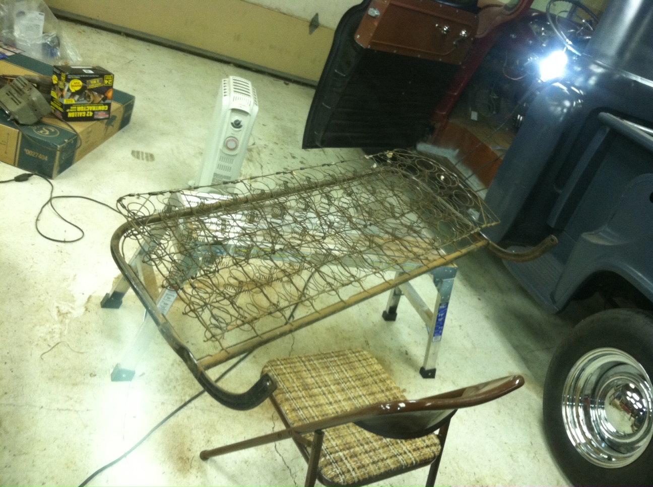

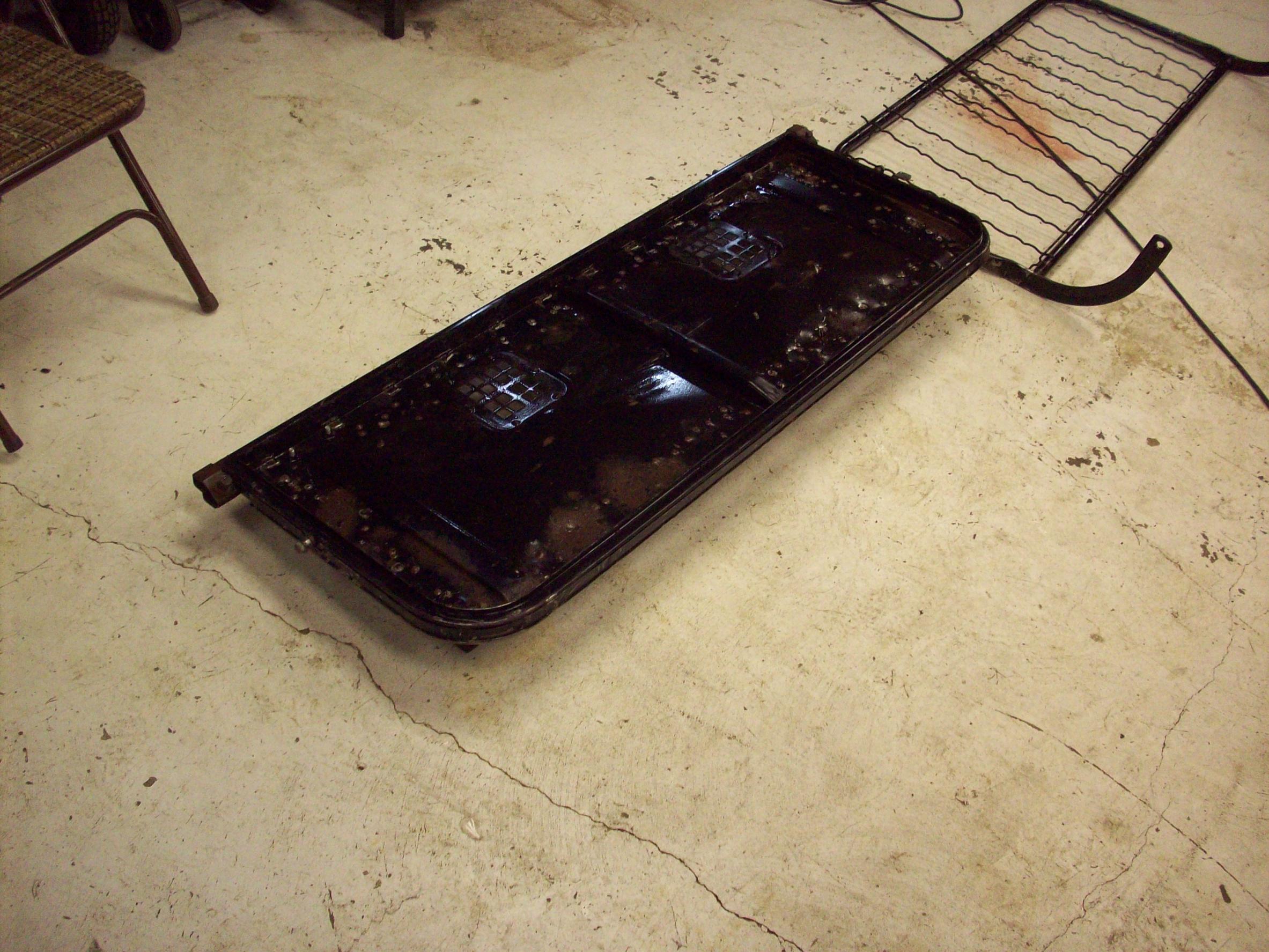

    Well I started to tear apart the seats. The upper half is far better (as usual), but I found out why that part of the seat was sunk in. I fixed the springs and the clips and got it taken care of. It was only recovered twice, but the seat foam was trashed AND all that dust covered everything inside the top of the seat. No big deal, I can get it fixed pretty easily.
  2. 1959apache
    Joined: Nov 22, 2009
    Posts: 2,635
    1959apache

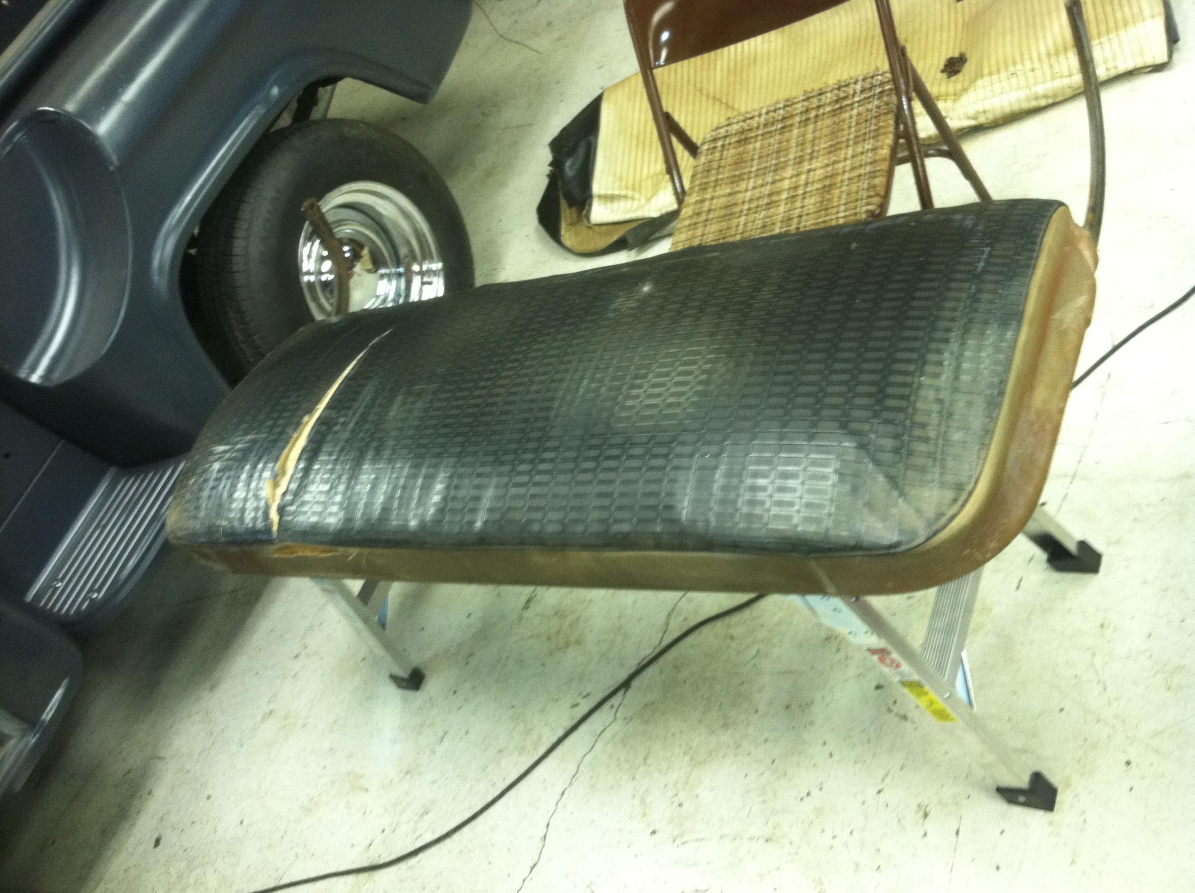

    The bottom of the seat is trashed. I can still try to fix it and frankly it would be okay, but I am sure it wouldn't be a permanent fix. I am all about not doing something twice if I can avoid it. To top that off the ***** who covered the bottom half of the seat for the third time went though and used roofing nails and pounded them through the steel, so I would have had to weld and fix all of that up, fix the dents. then fix the top half of the seat... So instead I will salvage the rails off the bottom of the seat and everything else I can. Here are some pictures.

    and I flipped it over and made this face :eek::eek::eek::eek:
    Yeah they tried to use staples on 16 gage steel, which didnt really work... so I guess the nails were the next best thing... the problem is that they wouldnt stay in so they swiss cheesed the bottom before finally getting one of them to stick....

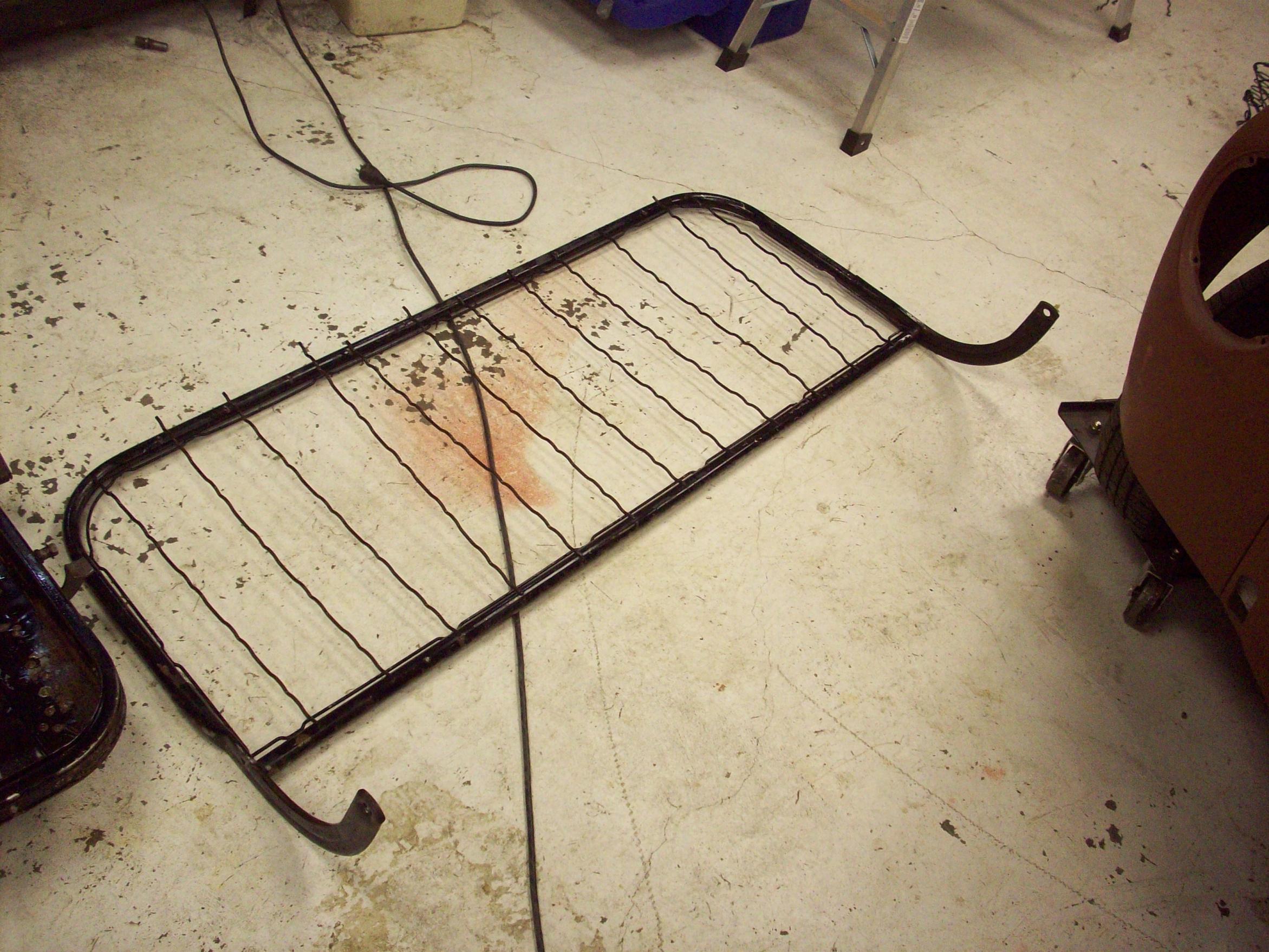

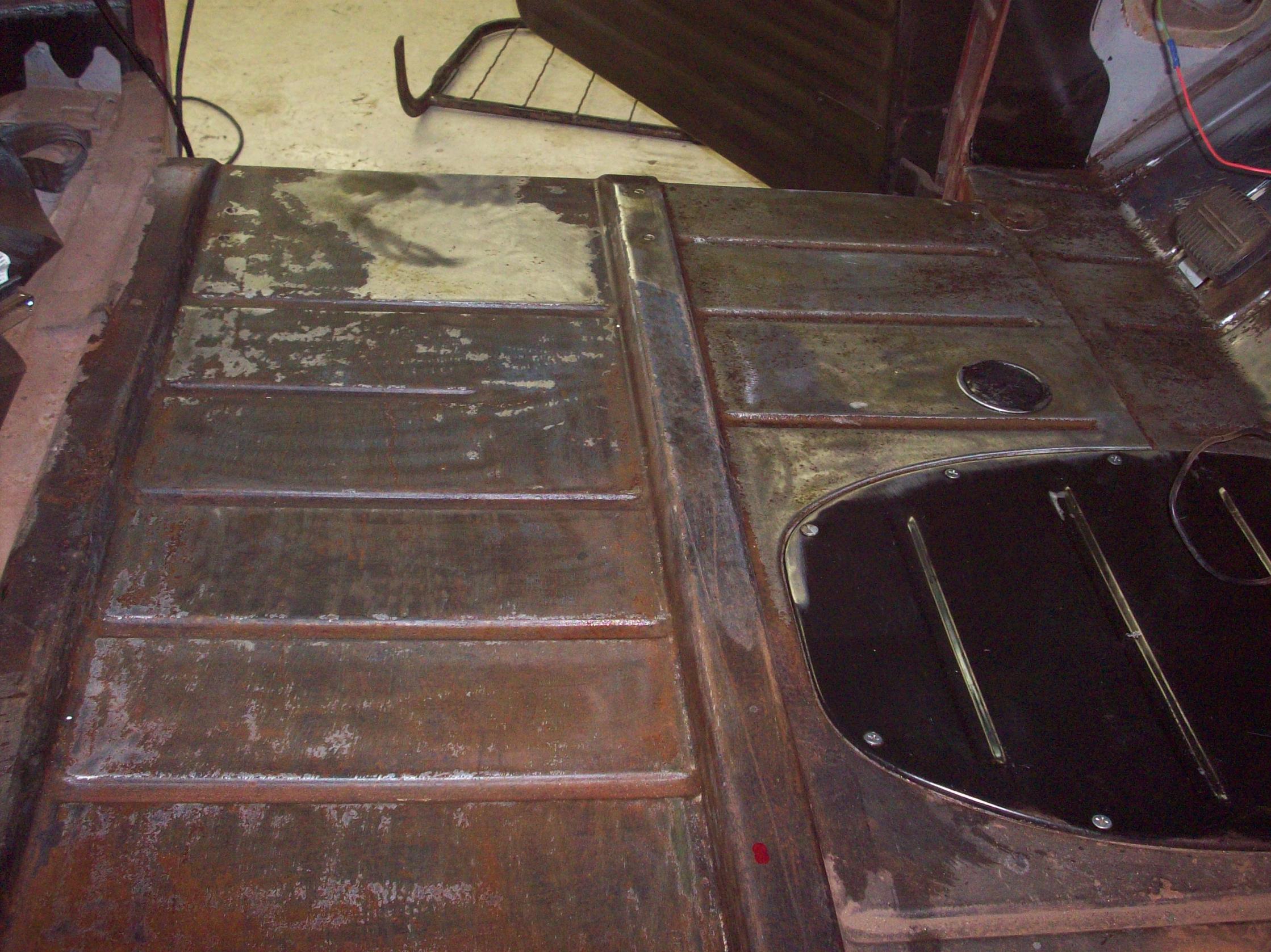

    Well I stripped the springs off of both sides of the seat and will go ahead and put the plywood down on the top half, but not the bottom (i don't know for sure though). I hosed everything down because it is like 60 degrees out right now, which is nice. Also I started stripping the floors where it is heavily surface rusted and on the p***enger side used CLR and water to see how bad everything really is... I was hoping to not have to strip that side, but it looks like I am just going to have to. I may tackle it again tomorrow with CLR and a scotch brite.
    Anyway, here it is.

  24. 1959apache
    Posts: 2,635
    1959apache

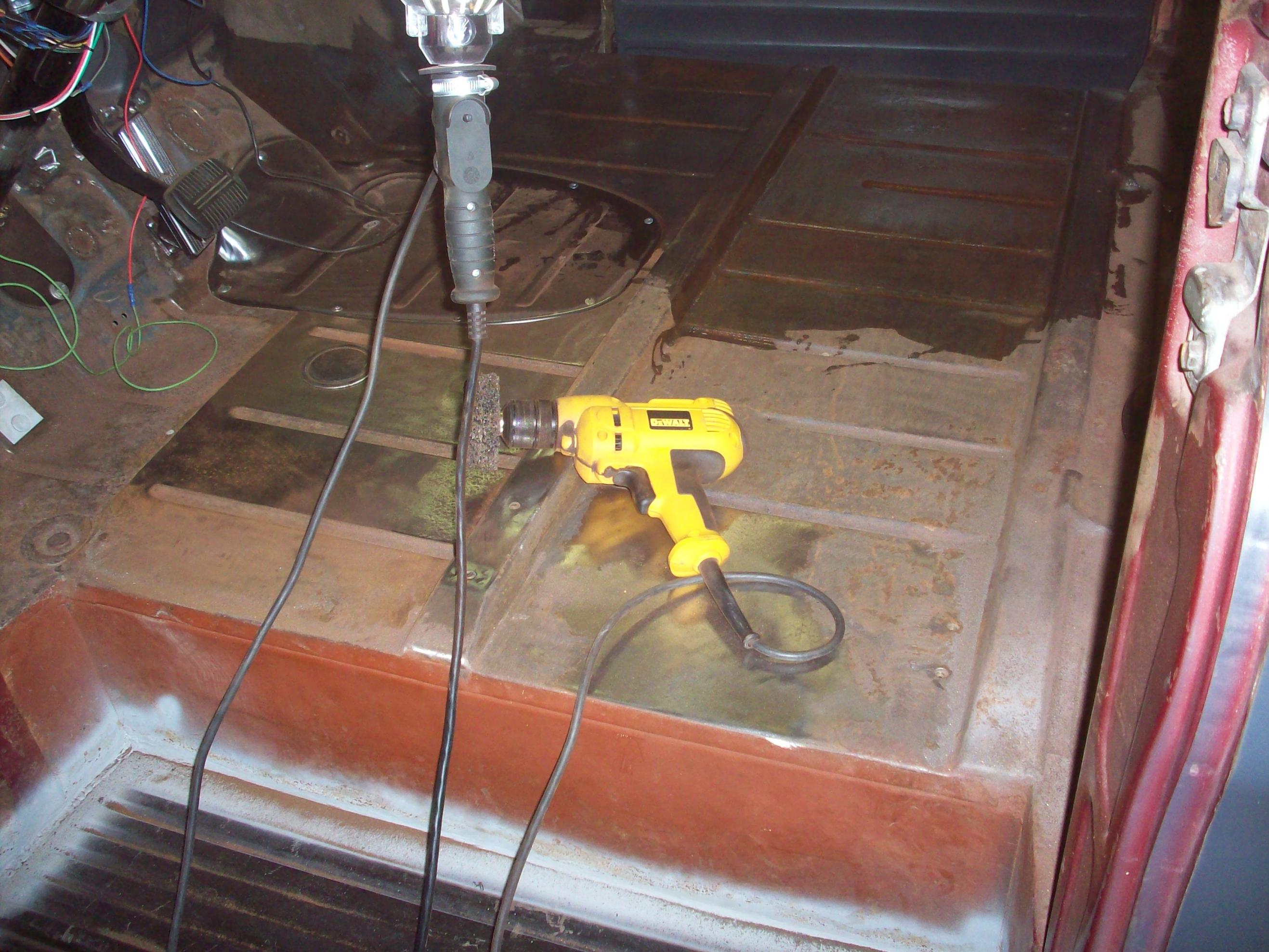

    I started with 50/50, but after waiting and not seeing a decent result I just put 100% on there and let it sit for several minutes and that seemed to work really well. I need to work on it some more, but it really turned out nice and way cheap compared to blasting it and the time cleaning everything up.

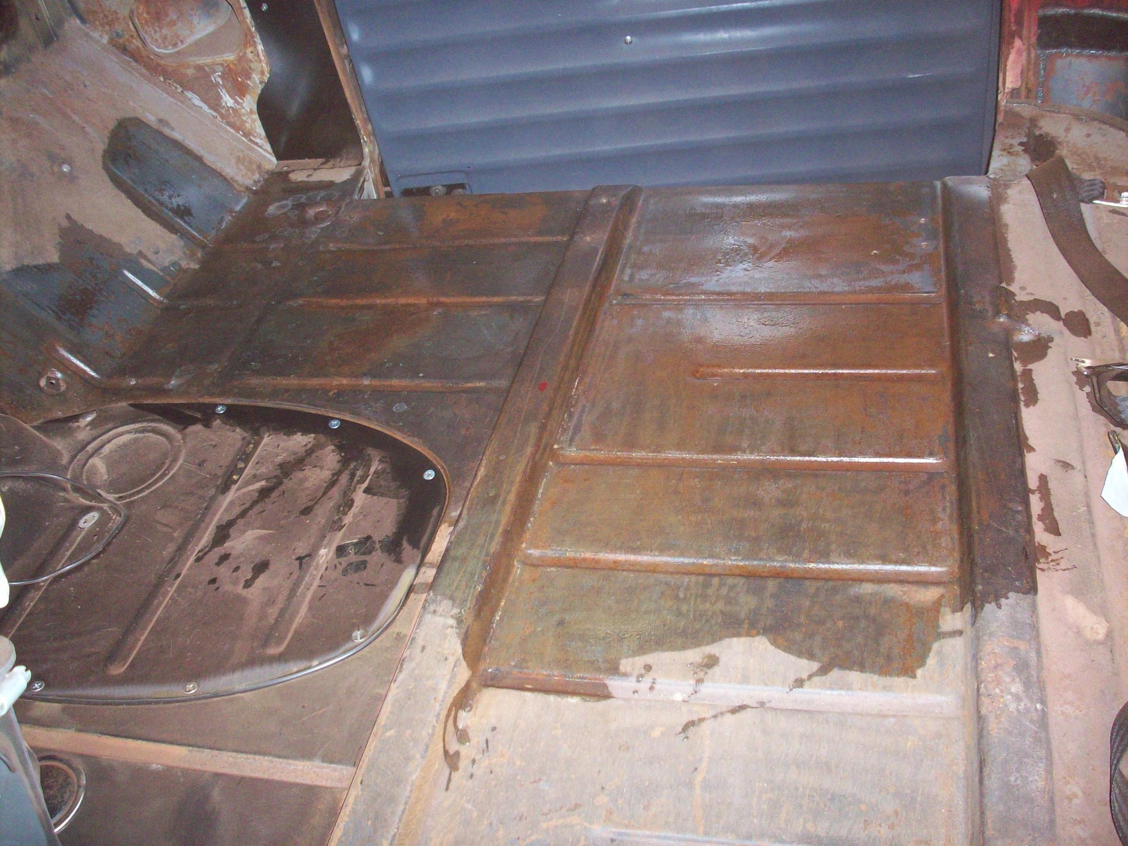

    Well I spent 4 hours today at the upholstery shop and got the top part of the seat cushion cut, some pattern finished for the headliner, and other little ****.

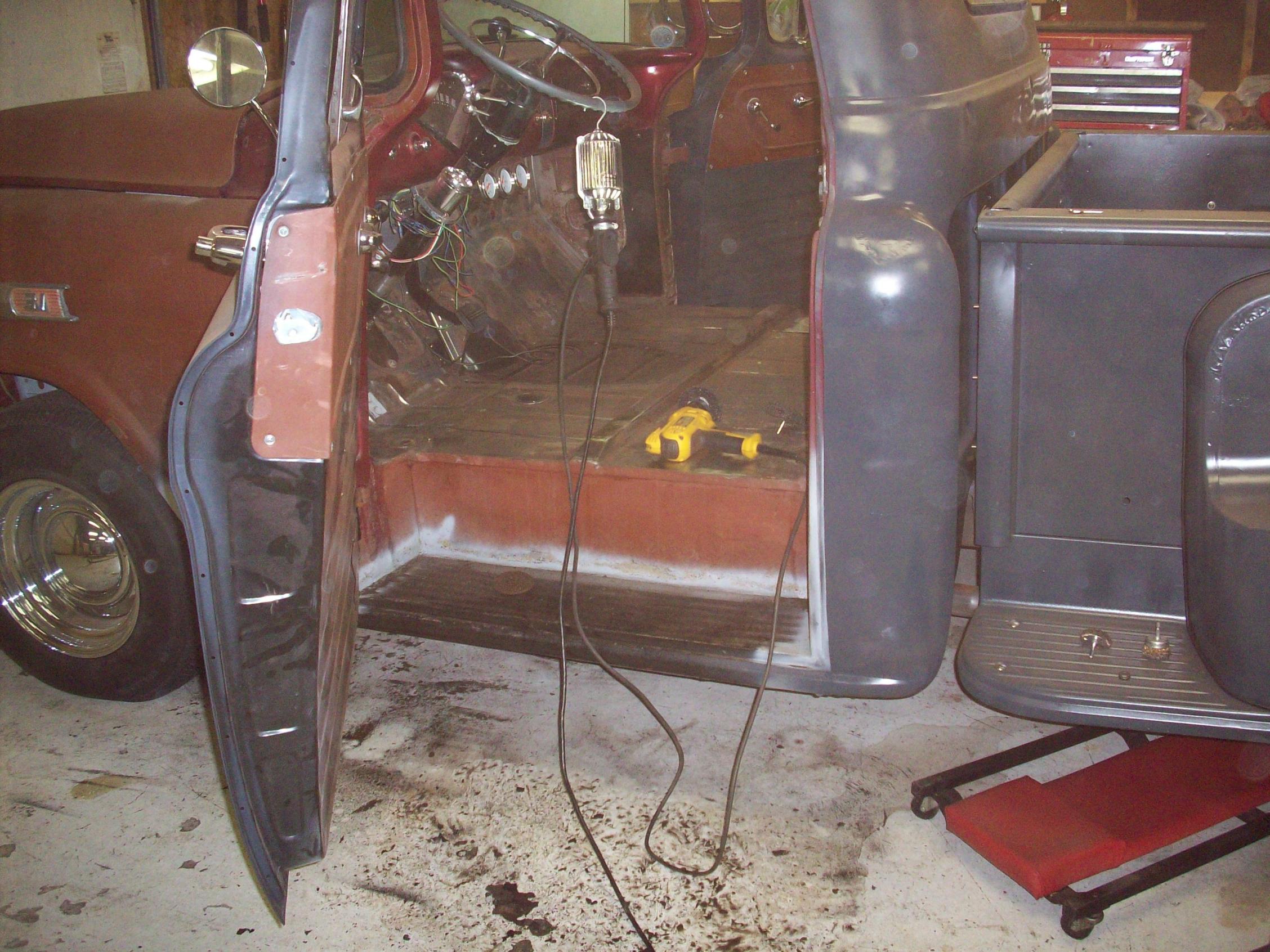

    I then came home and worked on the floor of the truck and started to tackle the drivers side floorboard, which is by far the worst with surface rust/holes. I cleaned it up with a wire wheel and some 3M pads and started hitting most of the floor to break up any large rust and remove as much surface rust as I could. I then let the CLR do its work for about 20 minutes with me scrubbing it with a red scotchbrite... It worked really well and actually made my job a thousand times easier by removing whatever surface rust was left.
    I also was able to clean up the snapped off bolts from the front part of the drivers seat that was probably broken since the accident. Anyway, its coming along.

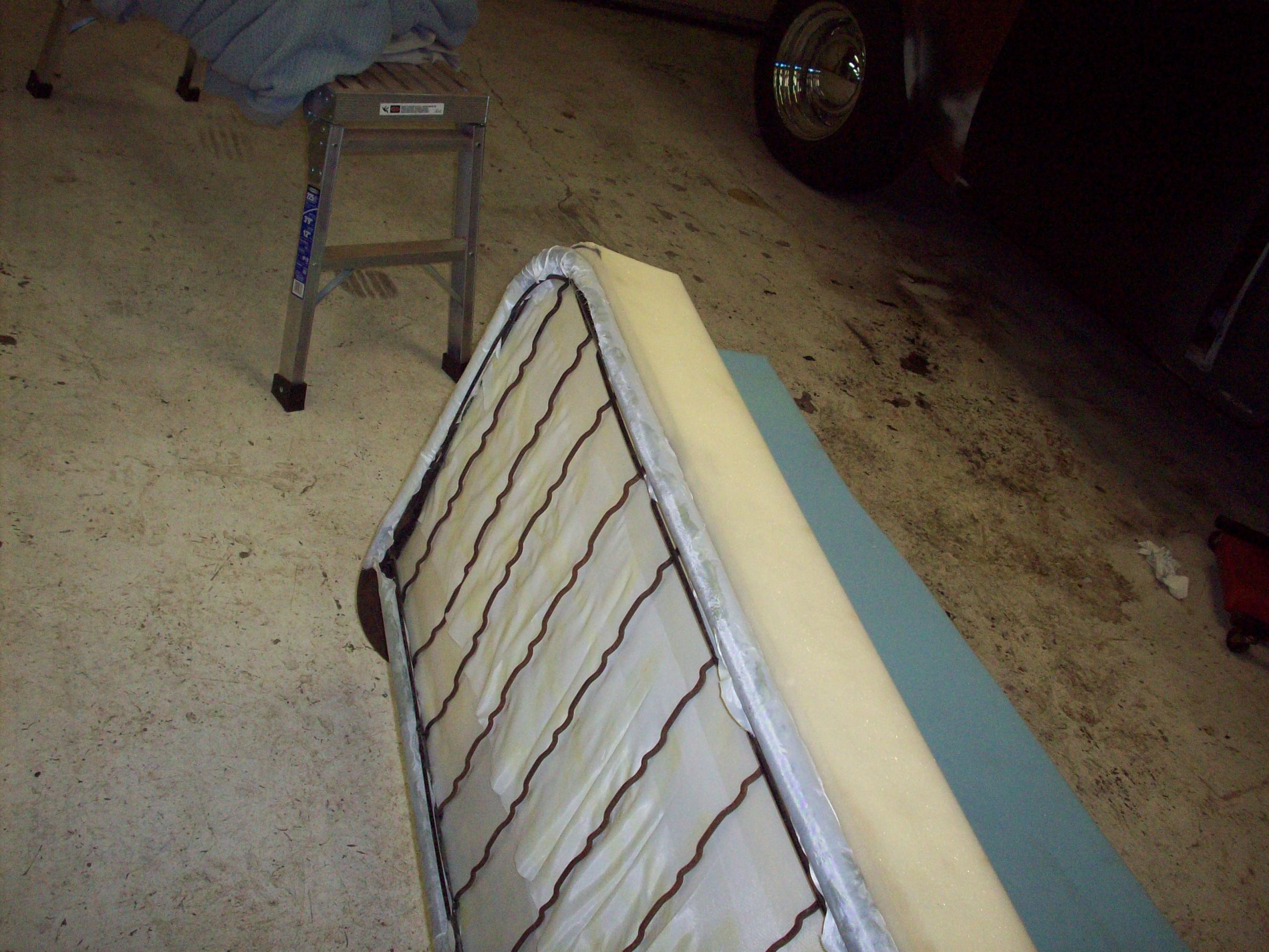

    Good news... my cushions were finally delivered after a week......
    Original seat back had 7 inches of springs and the cushion had 7 inches as well.
    I did a lot with a few hours at the upholstery shop. I decided against using a wood bottom for my seat because it would be too time consuming. I went through and put 1 inch high density foam on the bottom part of the seat and then put my 5 inch high density foam on top of that. All I need to do at this point is reshape it to how I want it and I will be ready to go.
    I also put a backing onto the top of the seat that acts more like shrink wrap than cloth.. I will have to find out the name of it, but I got that done today too. I went through and got the 4 inch top cushion on there as well. I will need to shape that too...
    I am sick to death of smelling upholstery glue... so I am going to call it quits tonight. I will bolt the two seats together and sit them in the truck to see how I like the ride height and extra leg room. I actually fell asleep on the bottom cushion today at the shop :rolleyes:

    floors look sick dude, those spongy disc things work wonders on the drill. cant wait to see the seat. will you use a turkey knife to cut the foam ?
