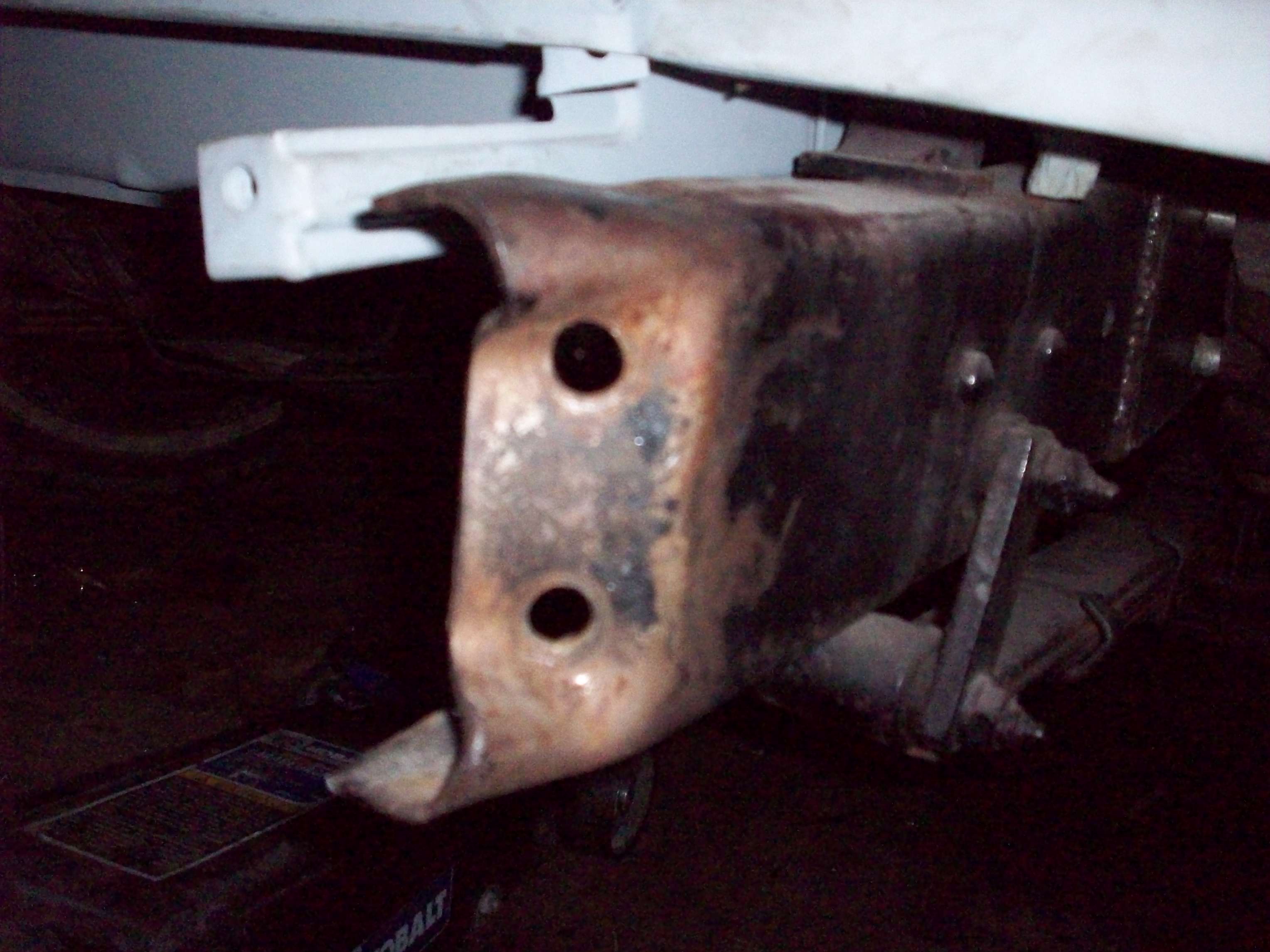

    So I didnt feel like getting into brake work anymore because I have been screwing with it for like a week and a half. So I decided I wanted to get the bumper out of the way for the time being and get the frame rails straightened out on the front so I can mount it up. The following pictures are what you can do with just a torch, a hammer, and a piece of wood. Keep in mind both sides looked the same and the one I straightened out isnt completed, but is close.:cool:

    I got the truck plated! So all I need to do is get the rest of the truck in order to be drivable and street legal and then I can take a cruise in it! I also straightened out the frame rails so the bumper can now mount without any h***les. Some pics attached of that. Also, I got my cab corner patch panels in and started working on them since the bed is down at the blasters for 2 weeks. I have that long to get both of them done. Also, I have had a problem with the ignition module not working so I have to troubleshoot that too. Attached are a couple pictures of what the cab corners are now with hunks of bondo going at least and inch thick in some places. Soon after the bed is back in and I get to working on that I will go ahead and take the entire front clip and doors down to be blasted and primed and then the body work resumes!

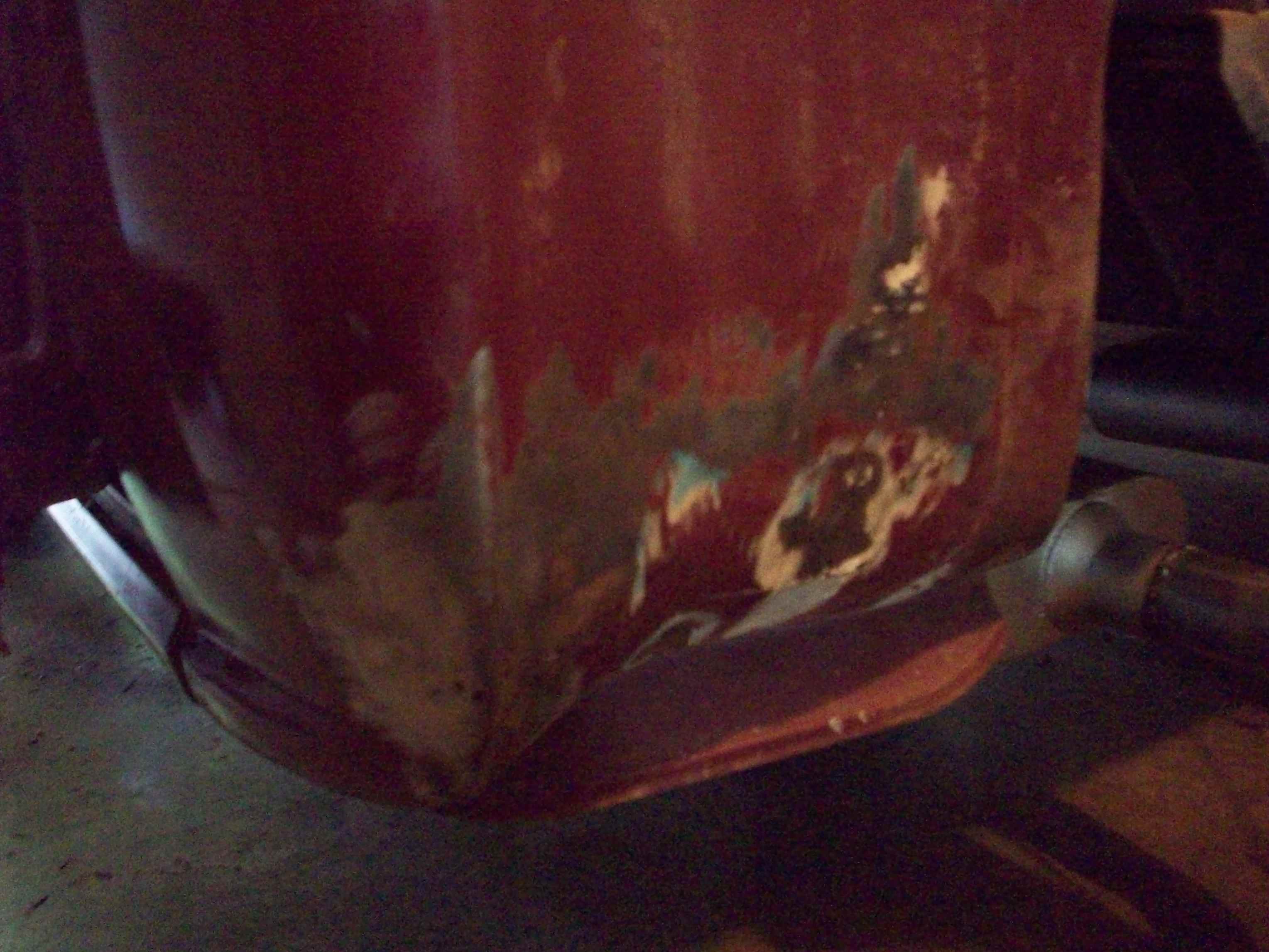

    I think I have been going at this whole body work thing all wrong.... If I were to just pour bondo down the nook's and cranny's I dont think I would need to buy any patch panels.
    I guess I will just have to continue finding gems in there. I did find a 22 bullet in the mess... interesting if I do say so myself.:cool:

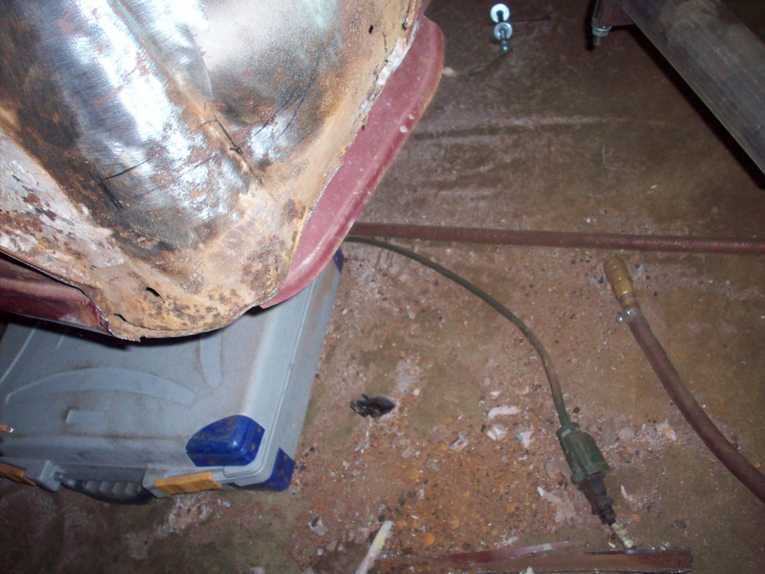

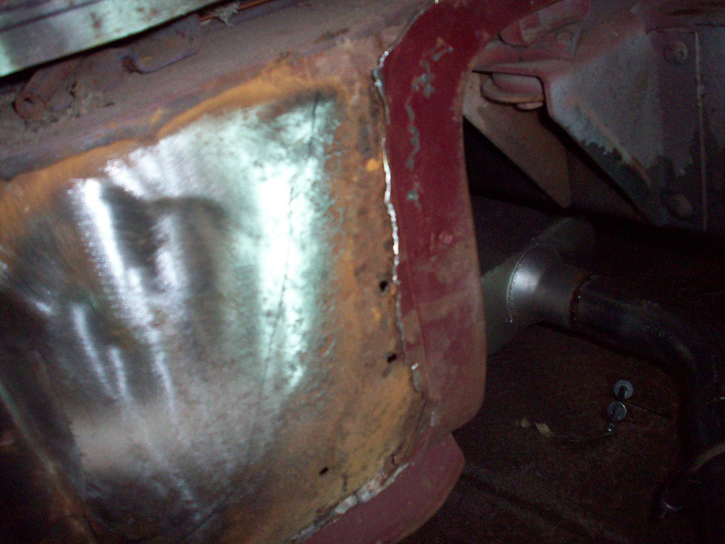

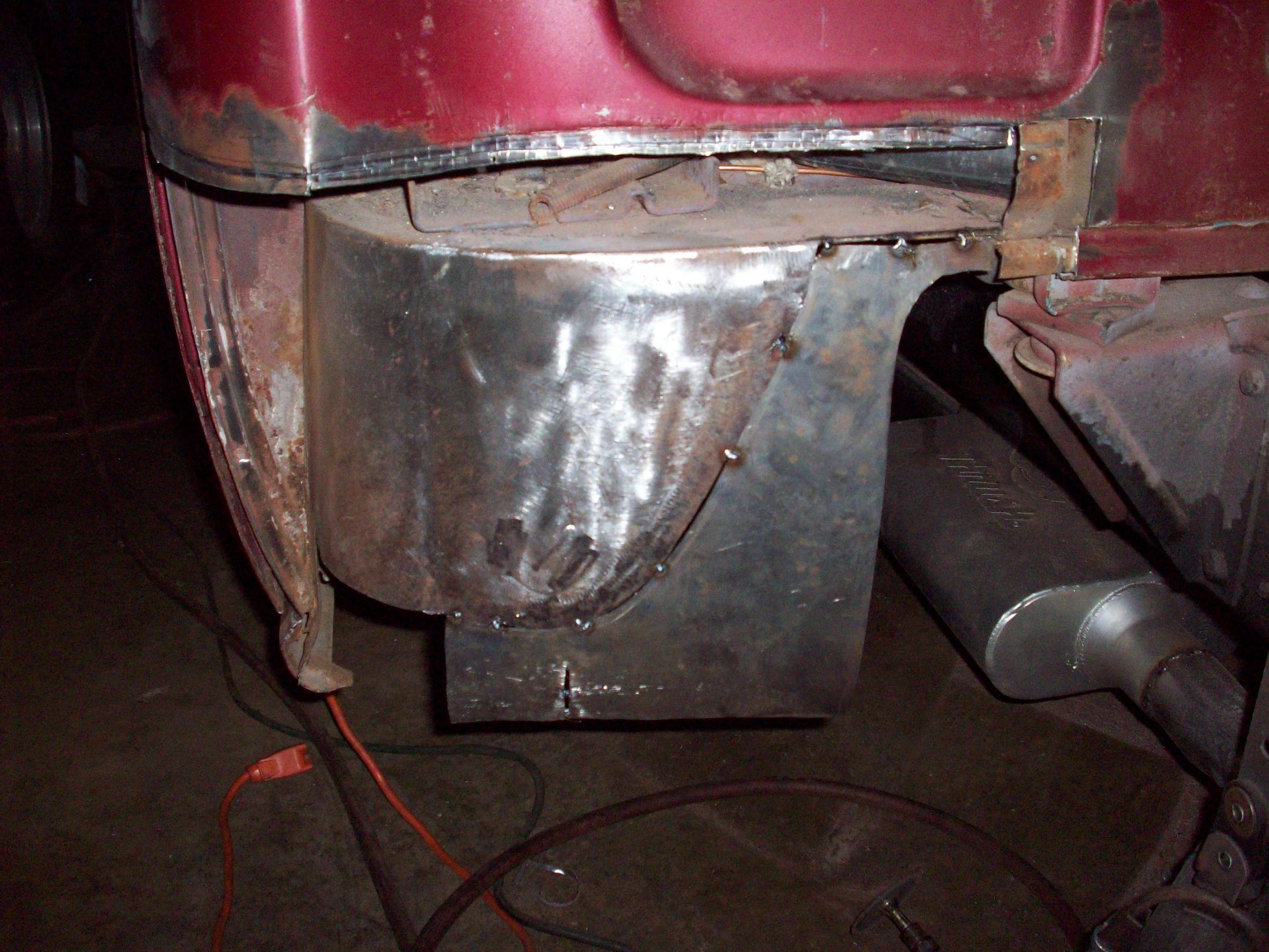

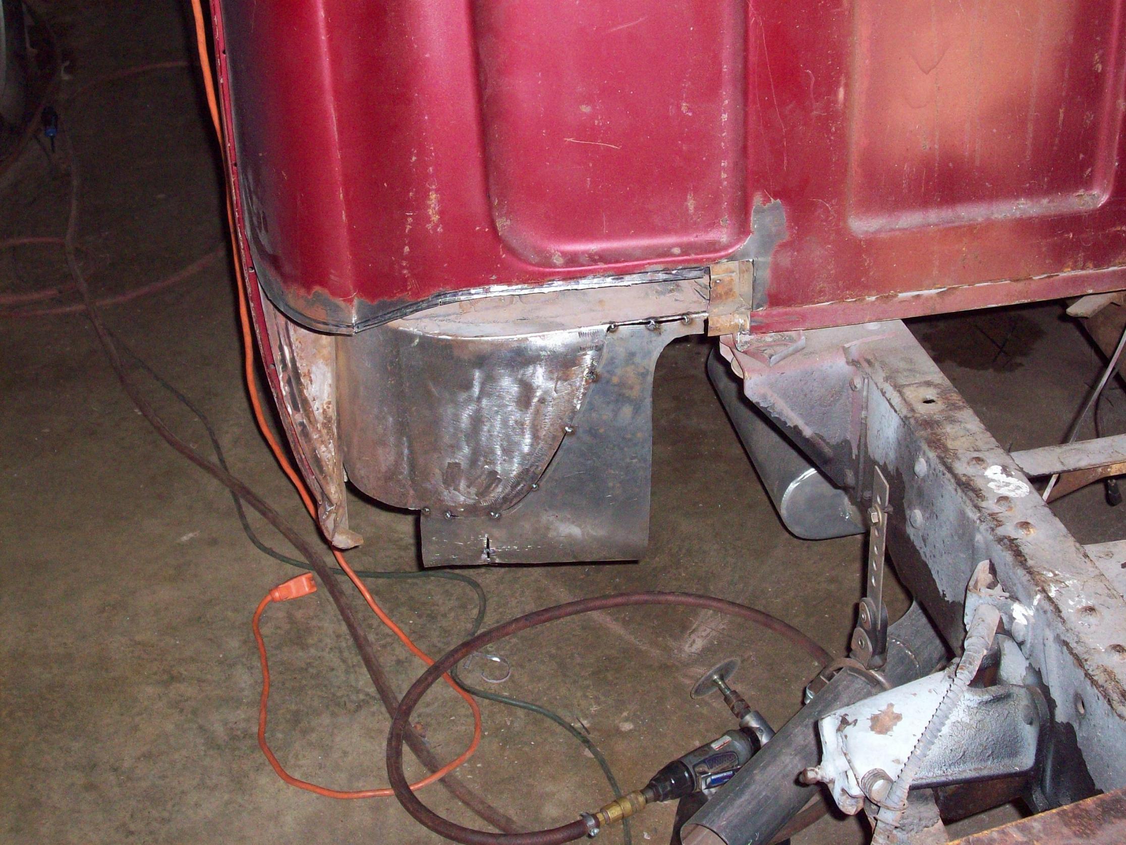

    I got most of the bad metal cut out. I need to do a little bit more work and then put on my patch panels for the inner cab corner and then I slap on my outer cab corner and she's done... I will need to sand blast this puppy on this side before putting it all back together however. :cool:

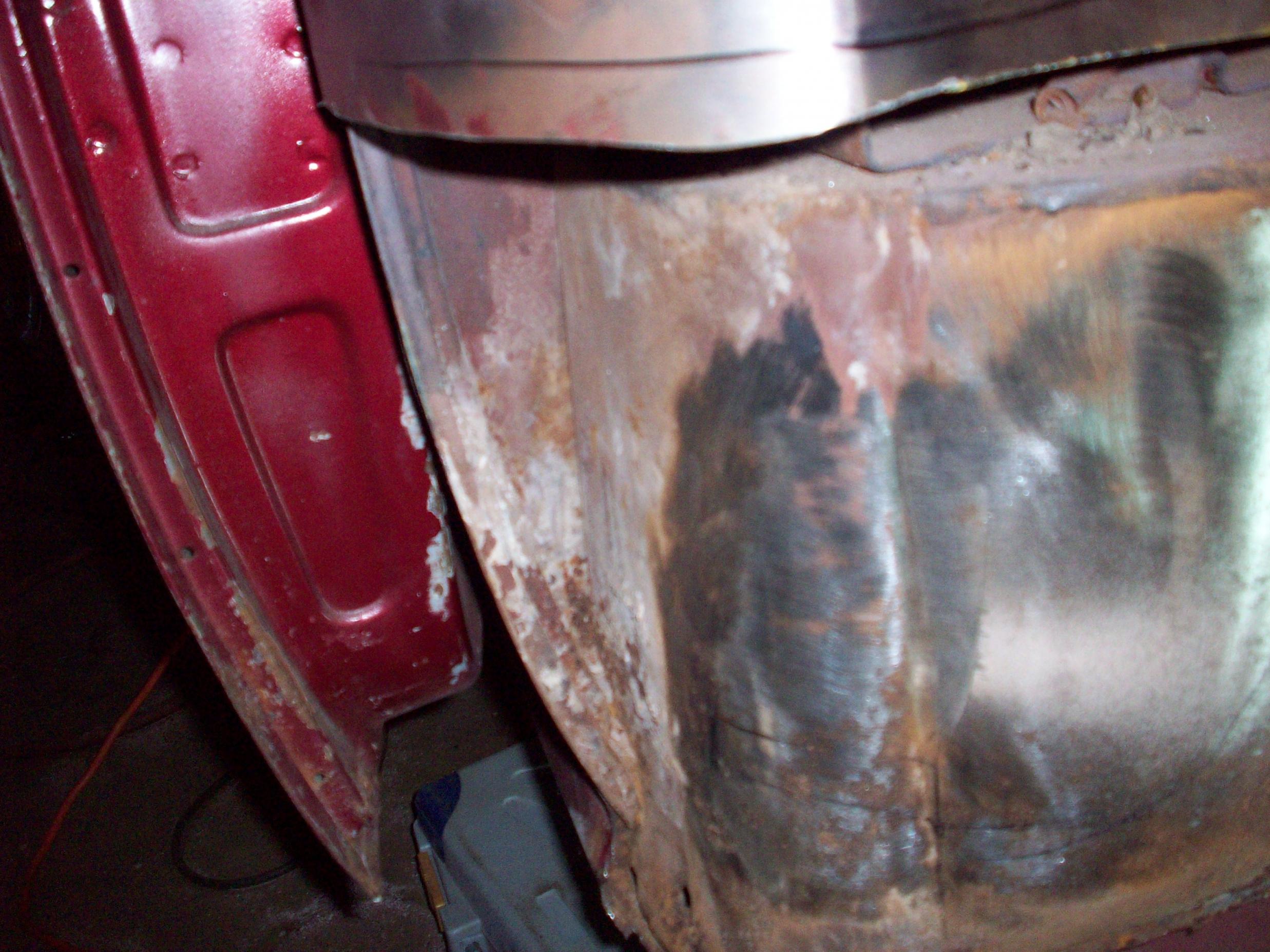

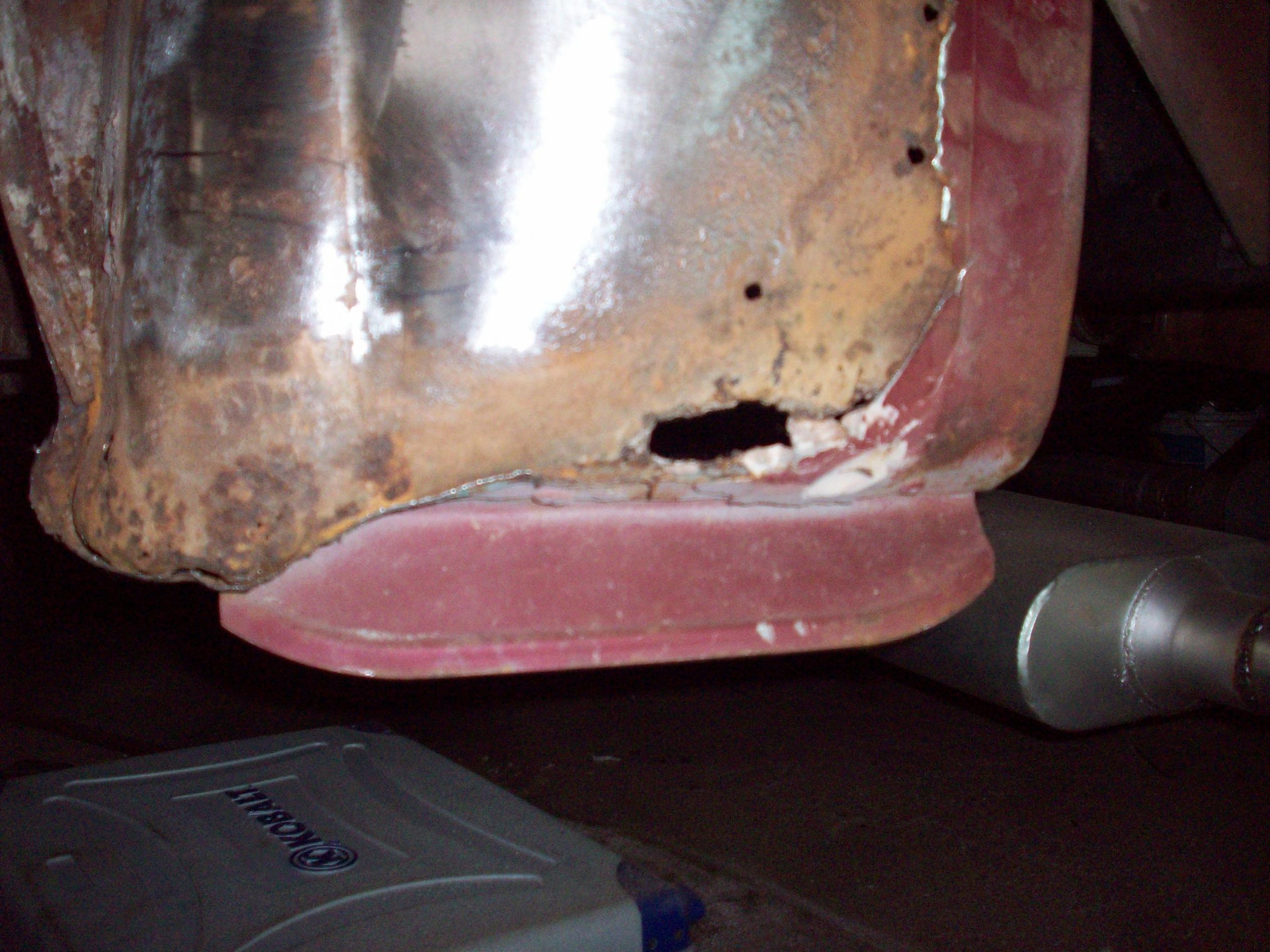

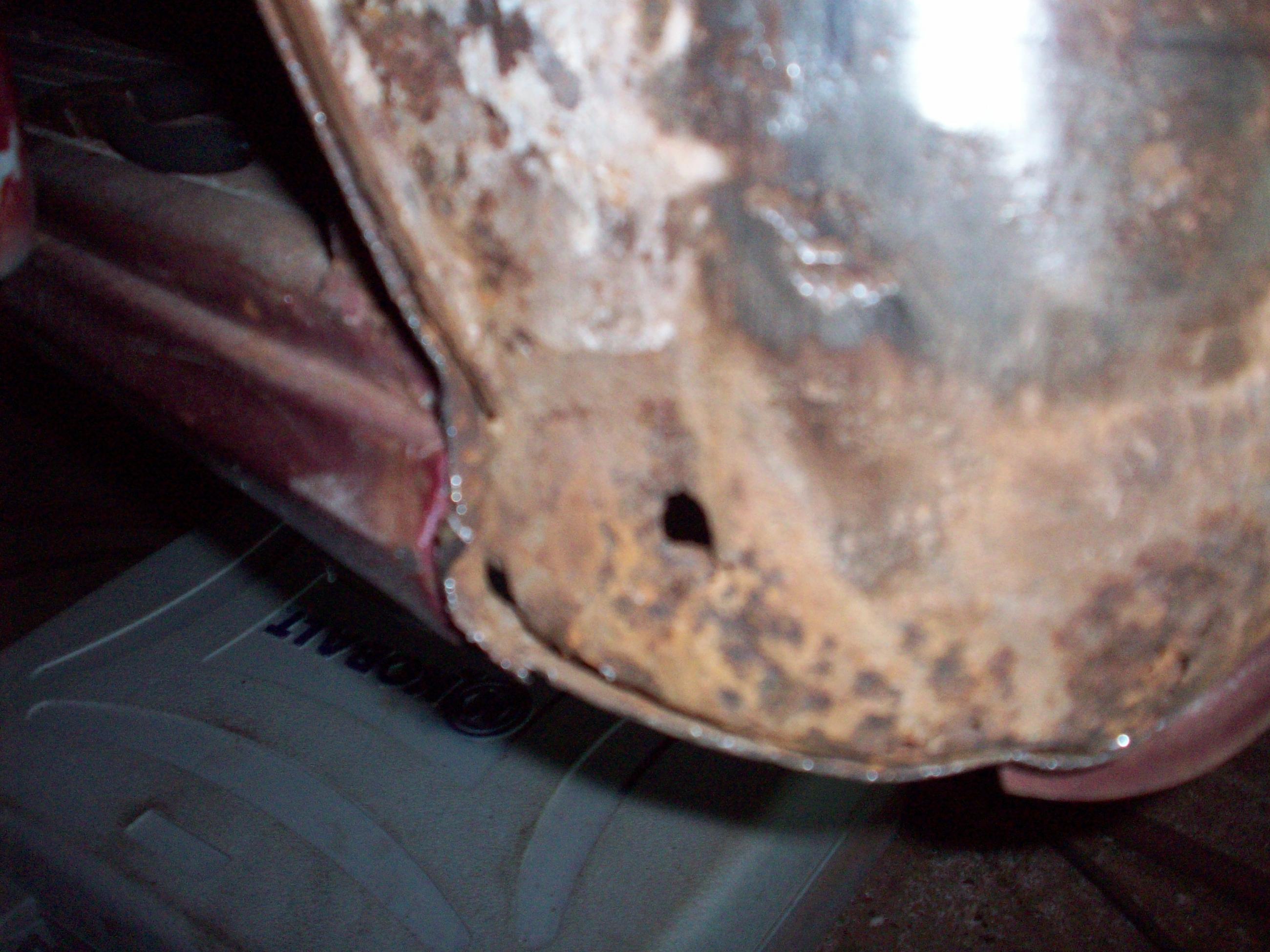

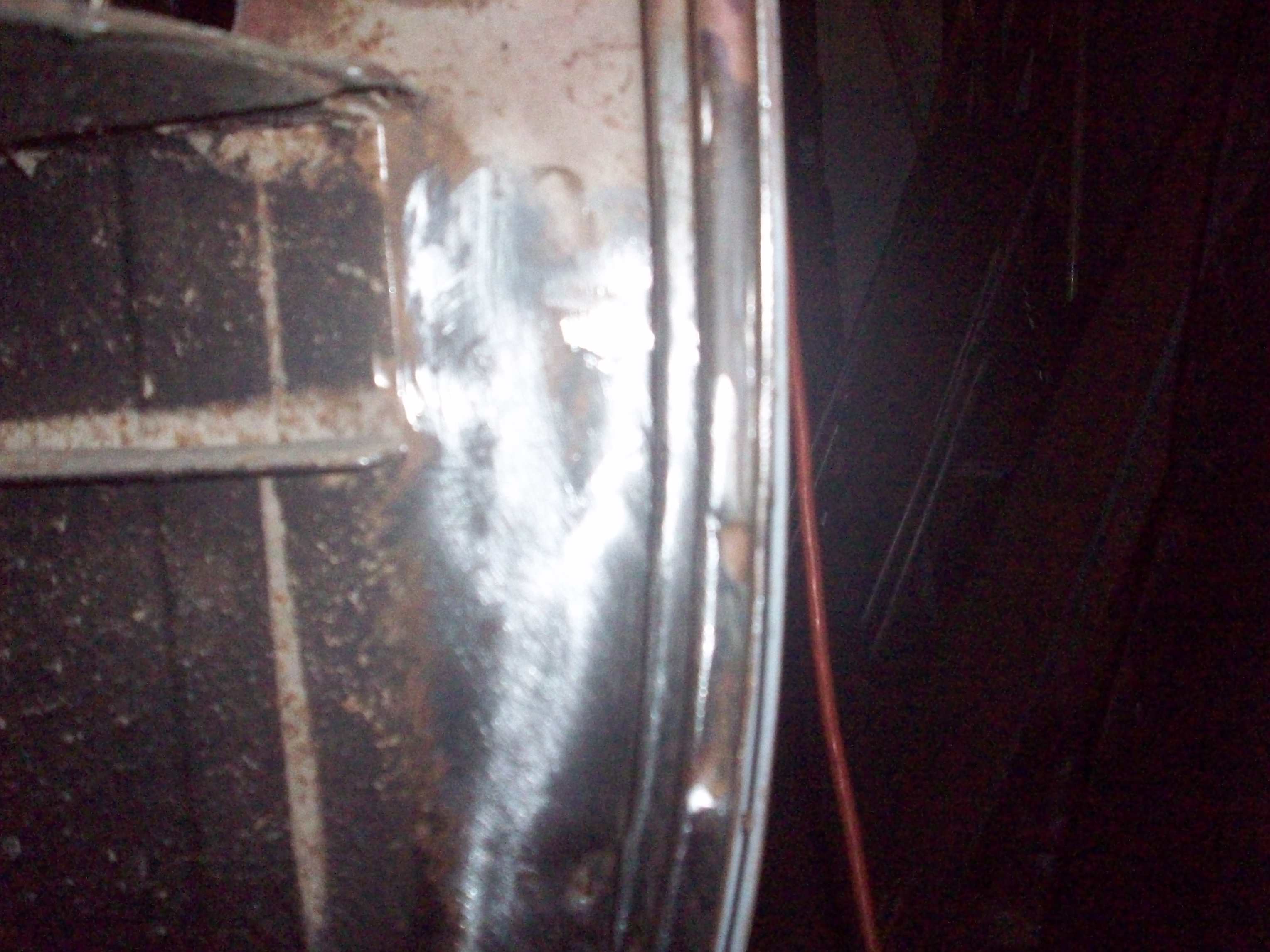

    Well It looks like the p***enger side isnt nearly as bad as far as the cab corner. I went ahead and butchered the other side to see what I had to deal with and it looks like the bondo work was a little less. So I will go ahead and tear that side apart while I am at it and will finish up doing the inner cab corner on the drivers side tuesday or wednesday... then I can just slap on the outer cab corner and be done with the drivers side. I also get my entire bed back this week. Then I start on that body work.... Then I will have the truck at least in one piece for the most part!

    Inner cab corners will be finished tomorrow, rust inhibitor applied, and the outer cab corner welded on tomorrow as well. I went ahead and tore apart the other side and it looks like I will be needing to get an inner cab corner for the p***enger side. That side is too far gone to save.

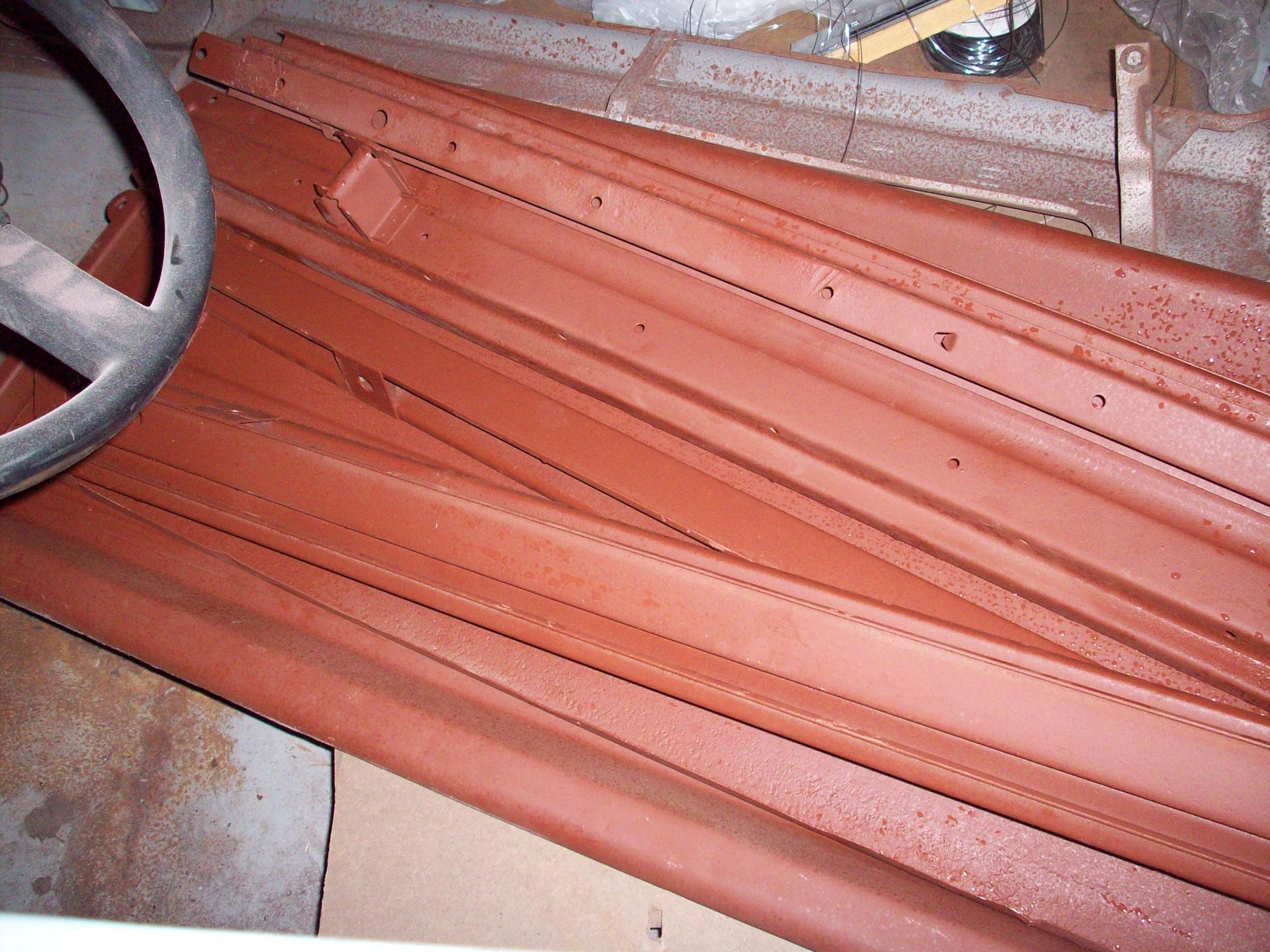

    It looks like my bed has been sandblasted and is ready to be picked up. I will be doing that tomorrow and be adding pics. Once the bed is in one piece and some of the body work finished on it then I will take the front clip and doors down to get blasted. I am getting close to getting it painted! well closer...

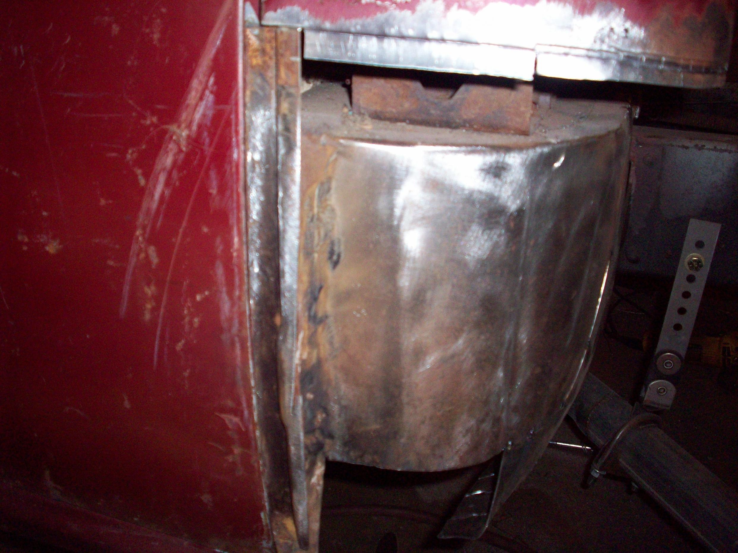

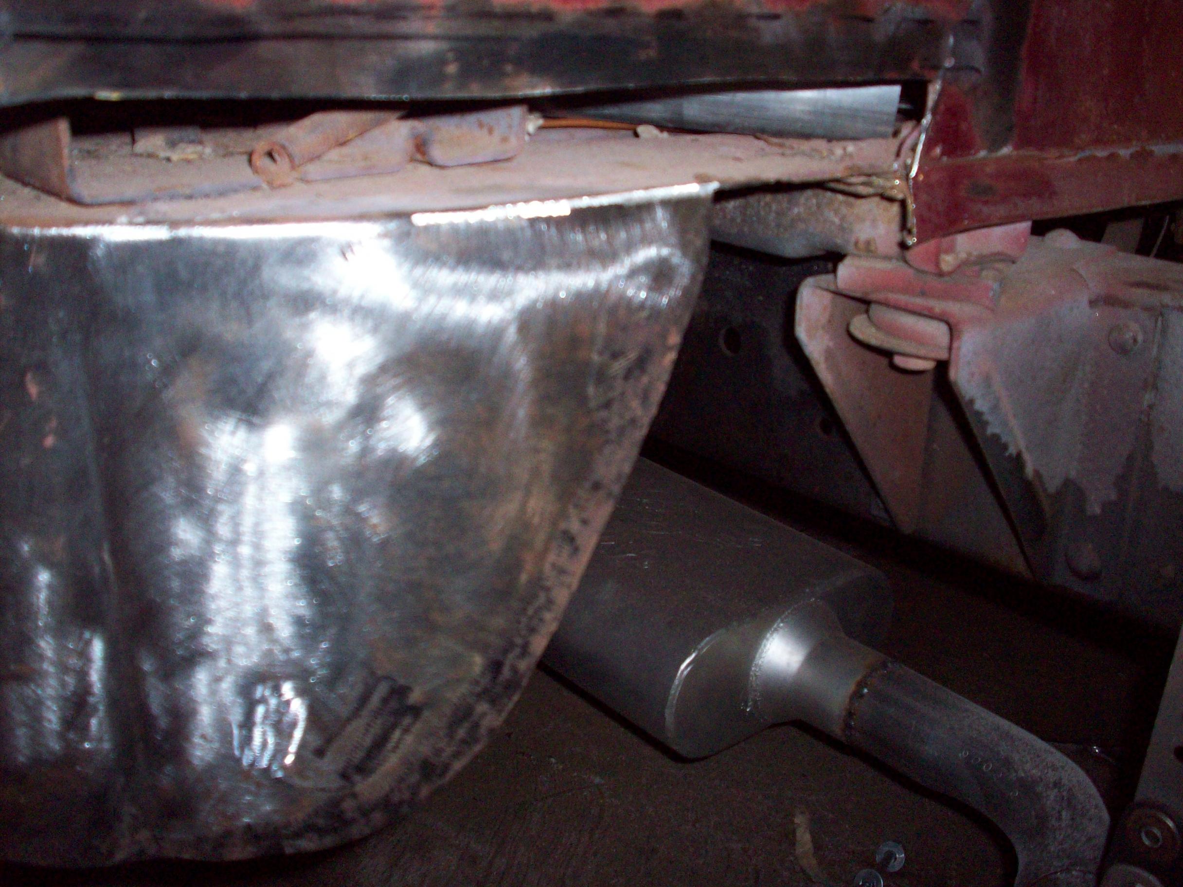

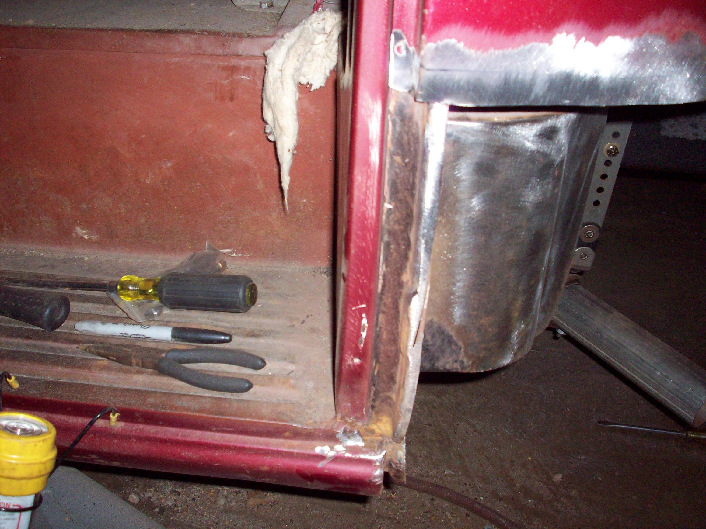

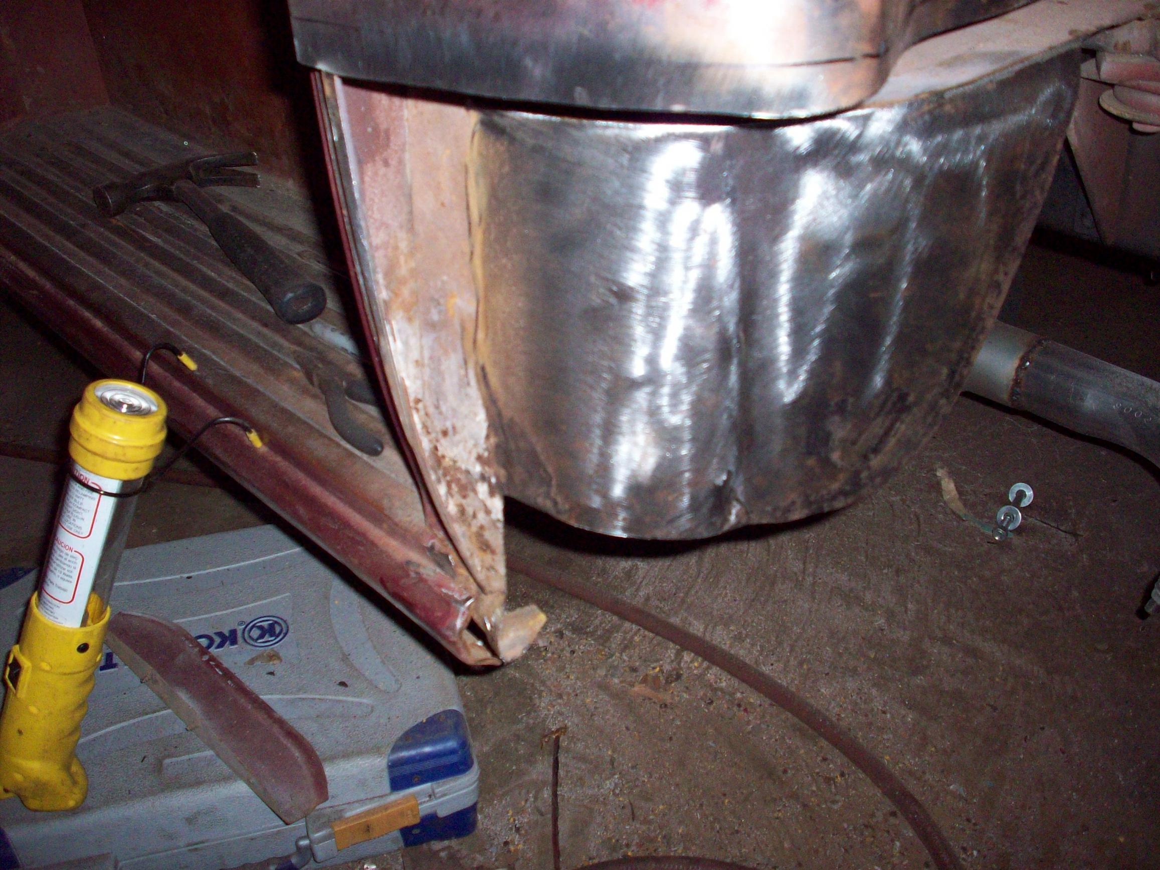

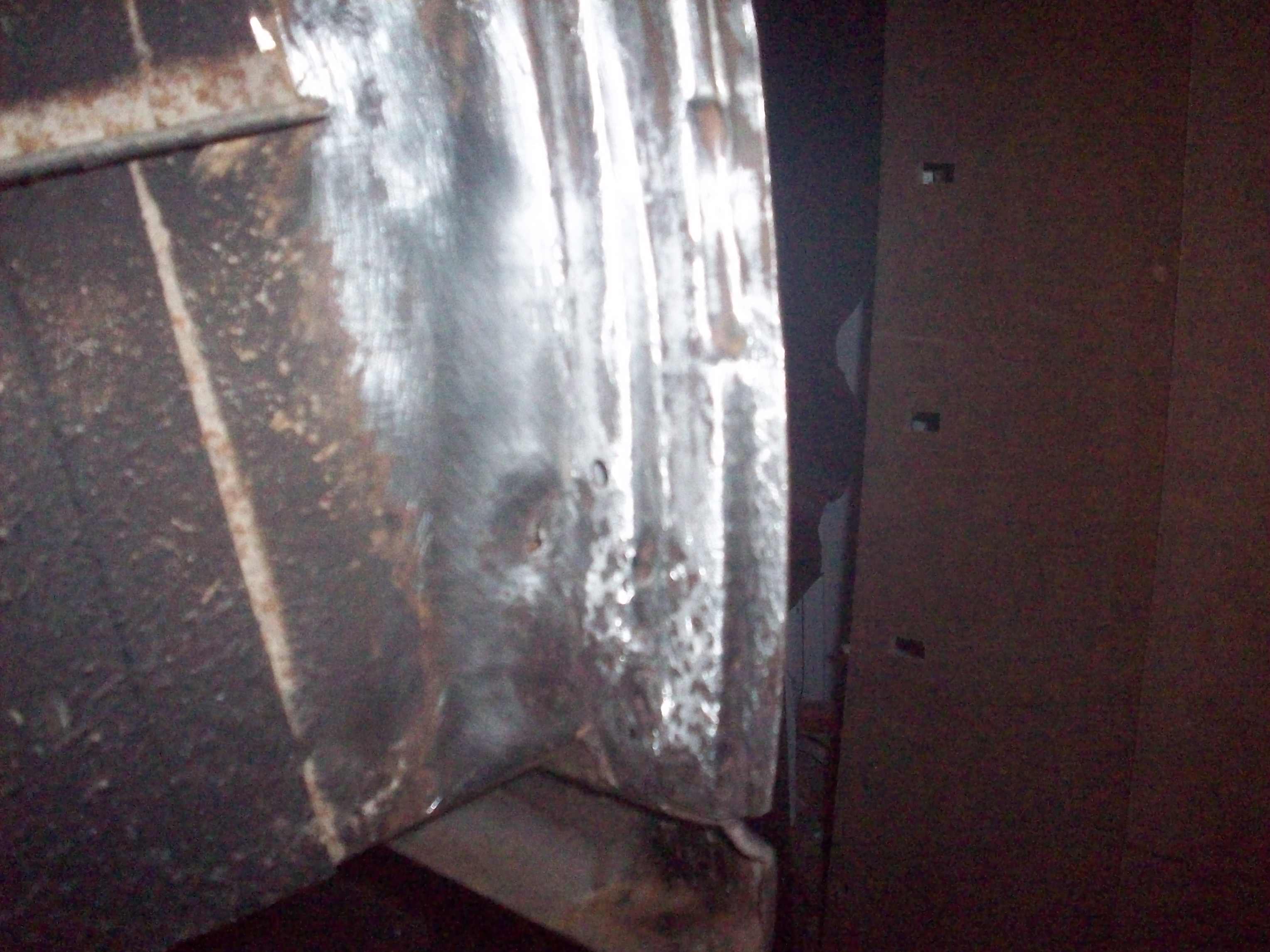

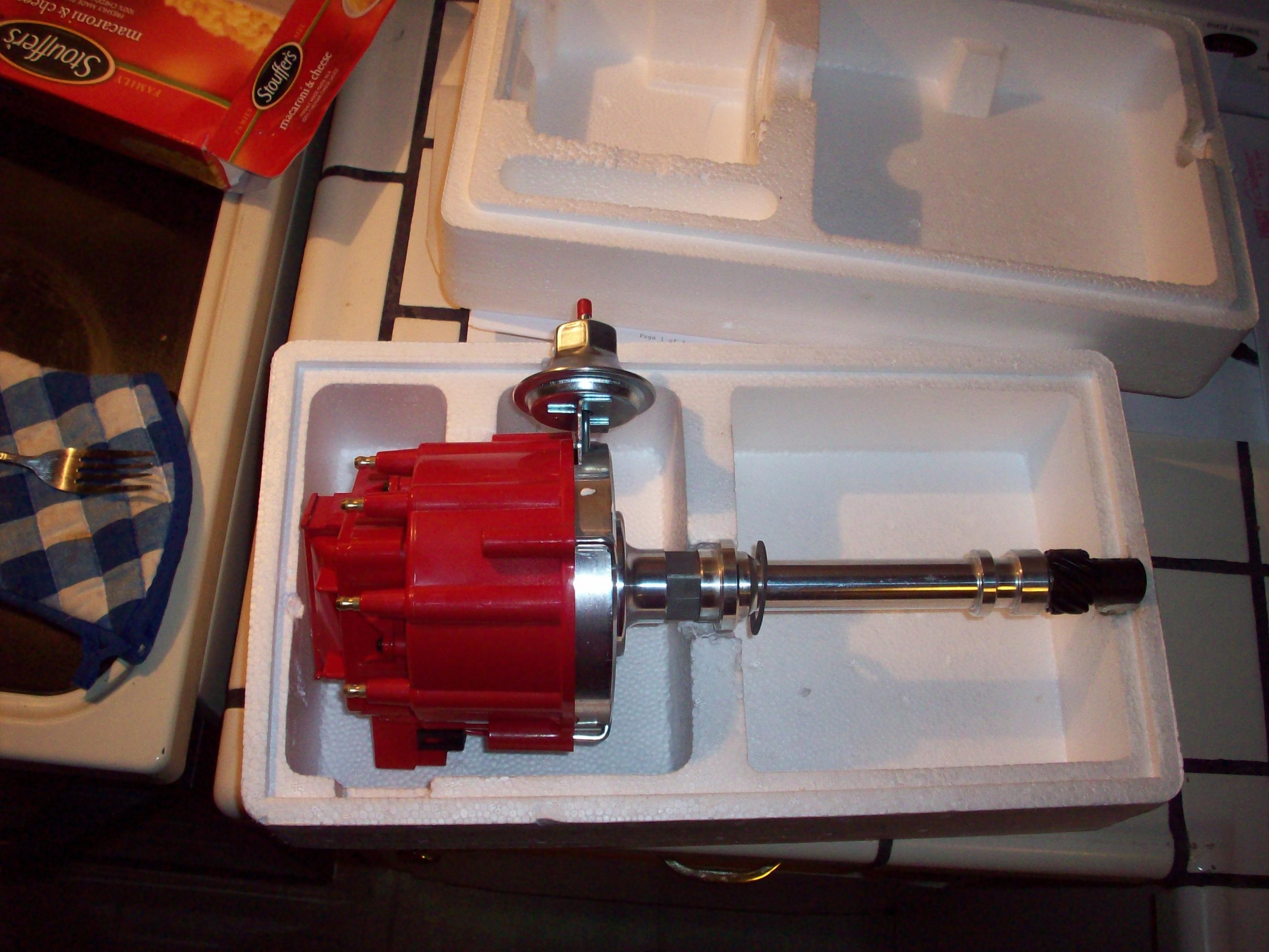

    Picture of my drivers side cab corner nearing completion. The p***enger side inner cab corner is in the mail. I got my new hei distributor too. I also got my entire bed back from the blasters and it actually didnt turn out that bad. Since I have to wait on the inner cab corner for the right side of the truck I am just going to weld my stainless corner strips on my bed sides so I can finally put the bed together and get it out of the way.:cool:

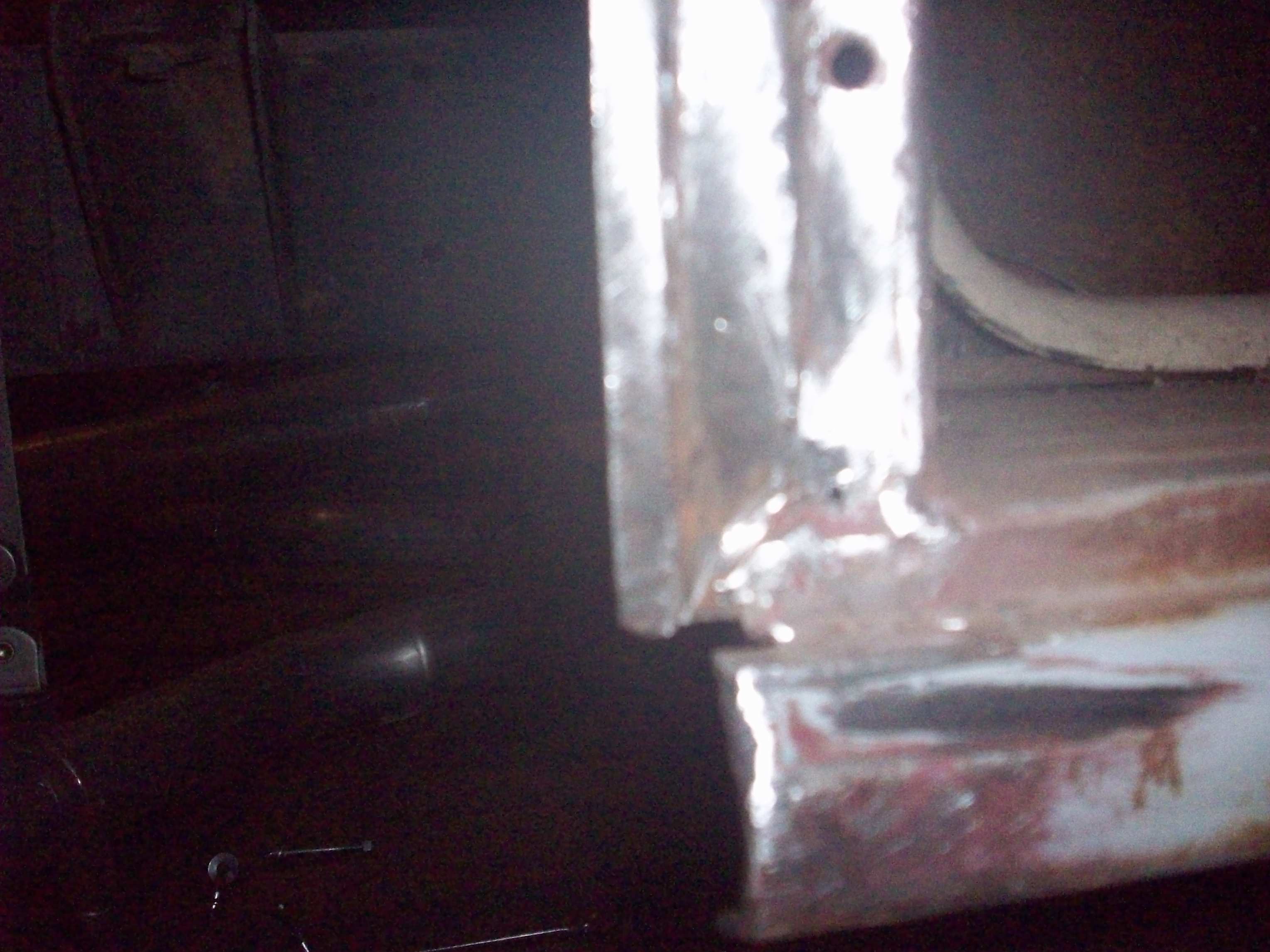

    Joined: Nov 22, 2009
