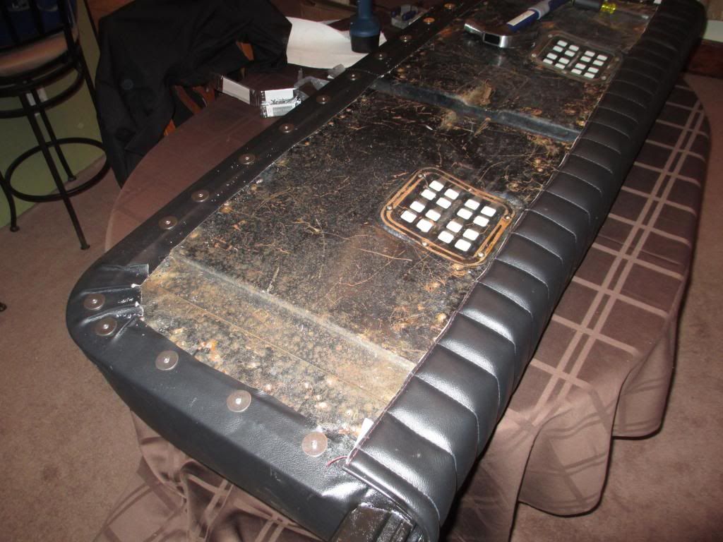

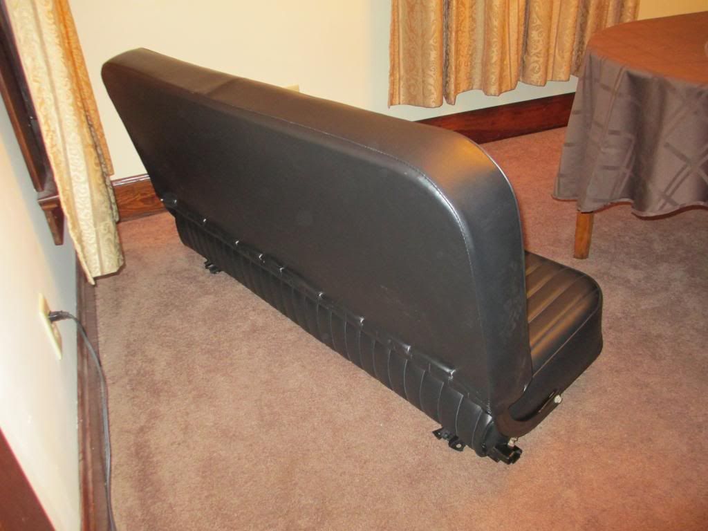

    Well I have it almost done. I need to use some rivets and some fender washers on the bottom to keep it in place... but overall I am pretty much done. I will definitely need to get a set of new seat rails that are not bent, so if anyone has the pair and the connecting rod that would be slick. Here are some pictures.. I think it came out pretty nice. I will head back down there to do the sun visors sometime too when I am ready to do the carpet (the visors will be pleated as well with some headliner foam and maybe some 1 inch pleats instead of 2.

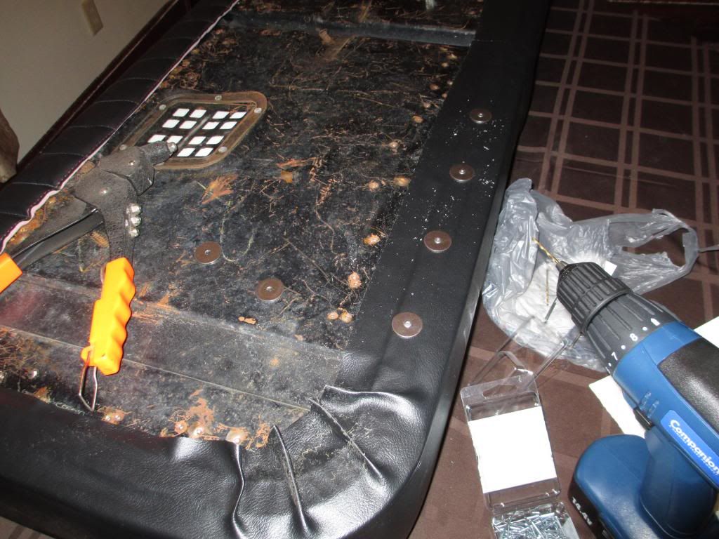

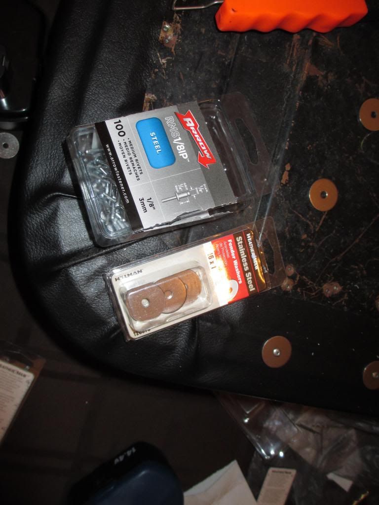

    Some of you guys were sending me multiple PM's on how I did the bottom of the seat. I just used some pop rivets and some washers every 4 inches (its overkill 6 inches would do). Here are some pictures of the underside of it. I need to go to the store tomorrow to get some more washers and maybe some longer rivets for the pleated side. I will also straighten out the rails tomorrow and figure out what I am going to do about the rod. More to come soon.

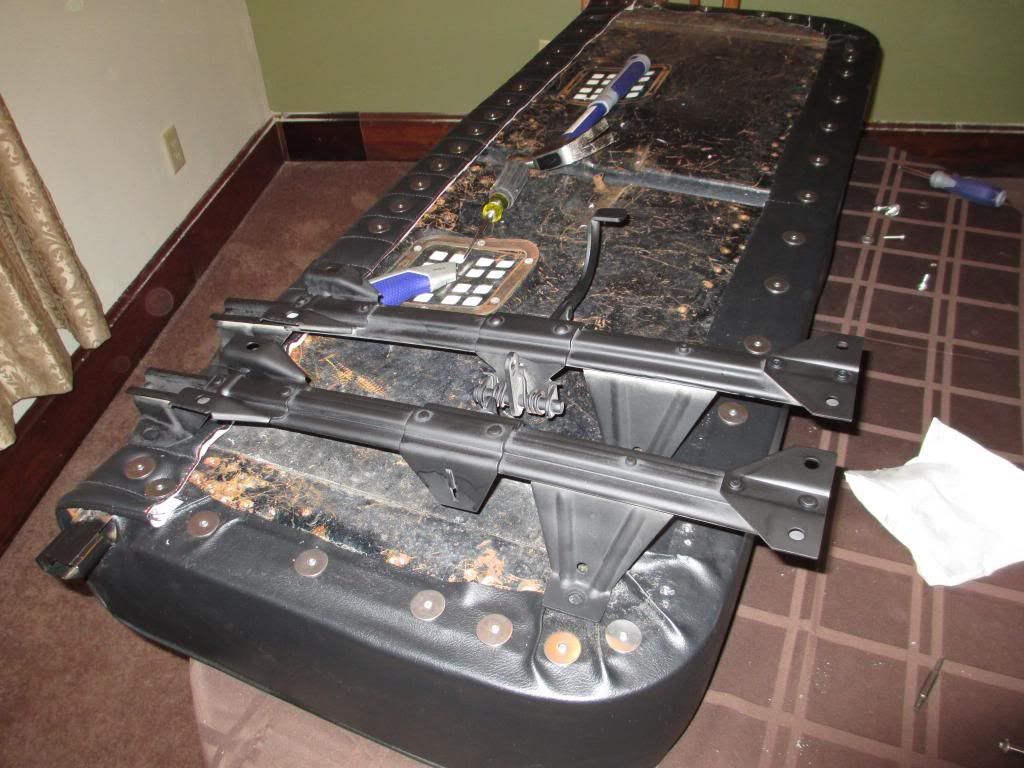

    Here is a shot of the finished bottom seat with the original rails I am going to reuse. They were covered in about 1/16 of grime and after cleaning them out they seemed to free up a bit for movement. So after I am done painting them I am going to use some good grease and make sure that ball bearing in there is properly covered.

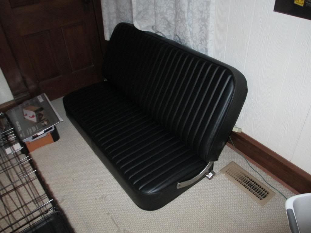

    Well it is done, minus one spring on the bottom. It is really comfy. Here are the pictures
