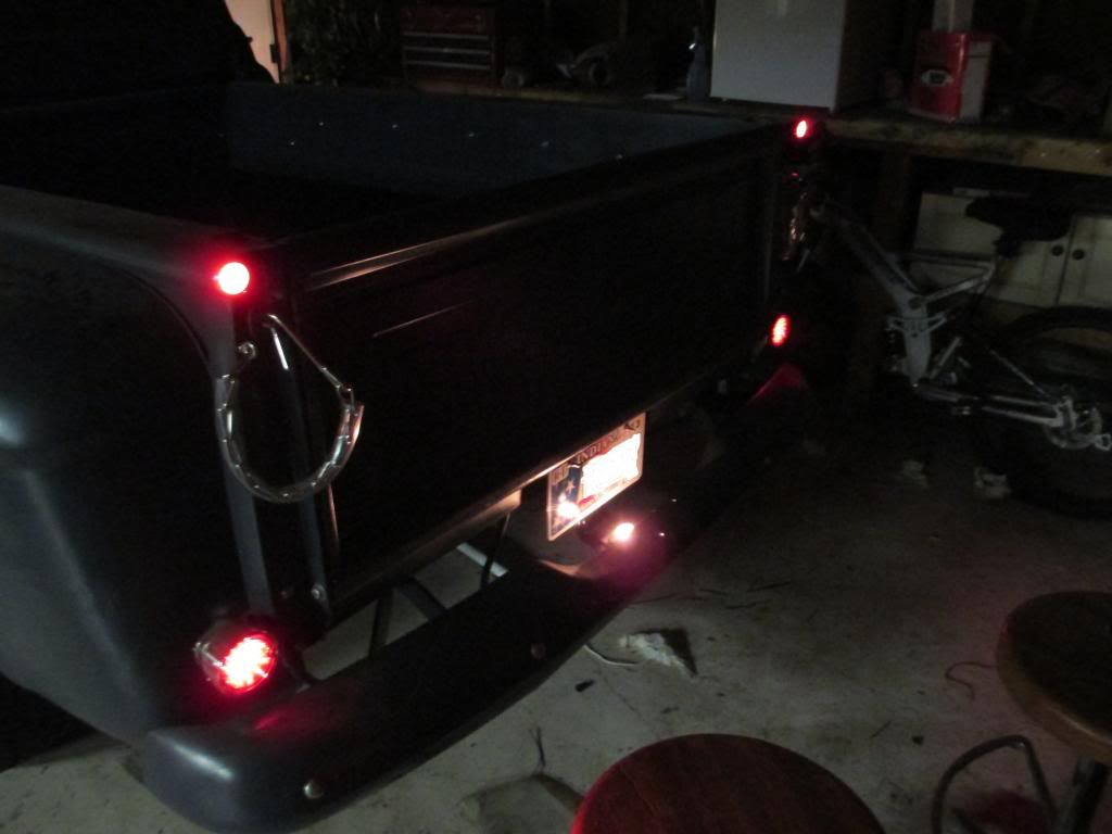

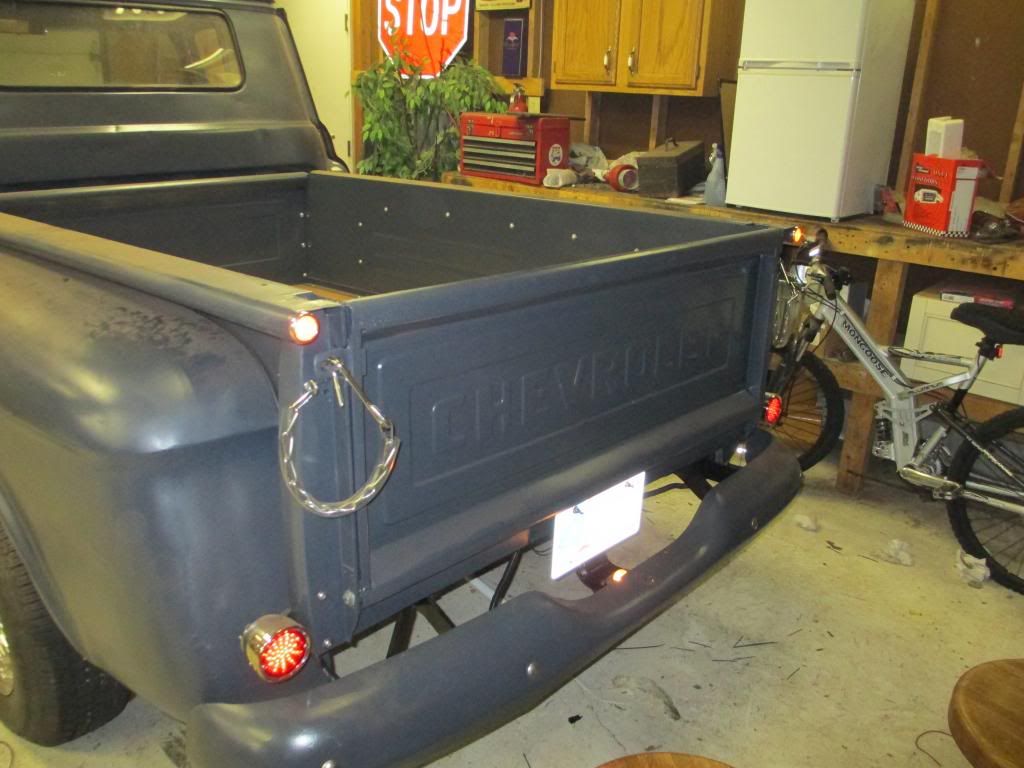

    Well I have been working on the rear tail lights and fixing some stuff on the *** end of the truck. Here are some pictures with the bed LED's. They are pretty neat. I wish I could just leave this **** stock and no have to worry about getting in an accident, but people around here drive like a bunch of *****s and don't pay attention, even more so than in other states... They are worse than orientals in California as far as driving... totally oblivious. I am sure the HAMB can make an exception for safety.
    Also, a picture of my dirty dishes... I mean the emblems.. I started polishing them when I come inside and am watching TV.. they are really oxidized and they really are starting to look pretty good. I may just go ahead and get them plated later, but we will see.

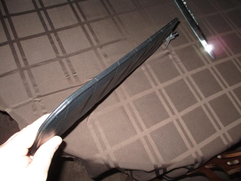

    I also got the visors done to match the seat and the headliner.
    Here's a picture or two:

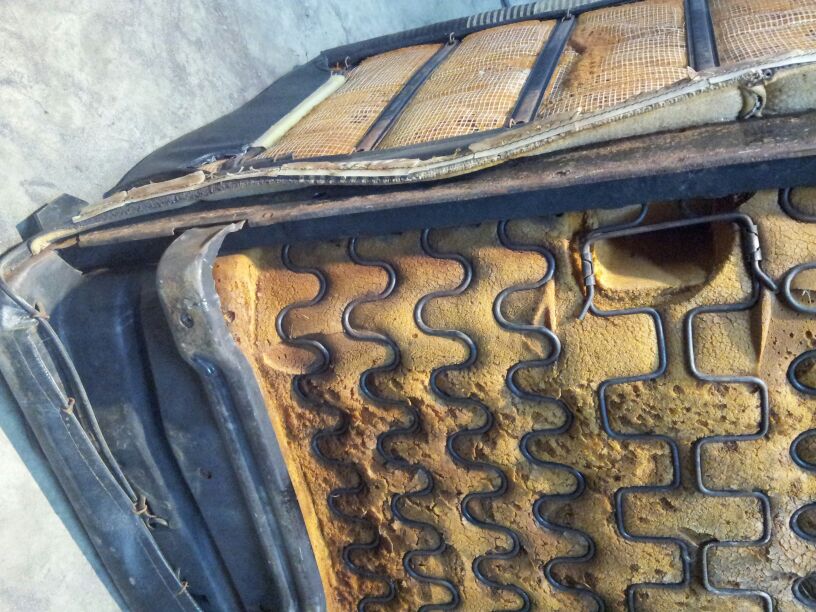

    Hey dude idk what is up with my pm on my phone app but it still aint sending ****. Heres the underside of my seat, im not exactly sure which spring ur talking about thats 8 inches...... The rectangular looking spring is 21 inches from the seat side to dead center on the spring. If thats not what your looking for lemme know and ill re measure for ya

    Ya bro, that is not a stock seat. That is something else entirely, its actually build better than most, at most I would say you would maybe have to replace the foam, other than that it may just need to be recovered.

    Really ? All the seat tracks and sliders and all that looked just like every other stock seat ive found. And the back tilt and all that looks stock as well. It came out of a 56 jimmy. Unless someone swapped in a diff seat at some point? Idk lol

    Well mine was stock and I have a pan, coil springs, and a seat spring frame in the bottom of mine, yours has updated spring support like a newer style seat. That's great that it matches up, I am just wondering what the deal is. It isn't the same as mine :(

    You know, now that you say that..... I didnt even think about the spring difference.... Maybe certain year trucks ? Ive heard that early 60's are almost identical as well in size and shape. Lol who knows. all the tracks were stock looking.... Idk lol, it fits good though hahaha. Sorry i couldnt help ya man. I re downloaded the app this mornin and my pm seems to be working better..... For now. My computers been down and out so ive had to deal with this lol

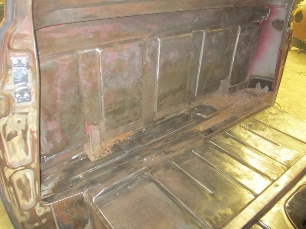

  15. 1959apache
    Joined: Nov 22, 2009
    Posts: 2,635
    1959apache

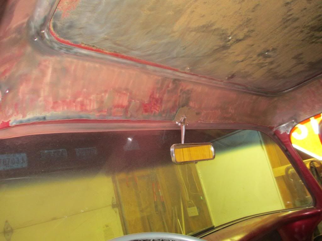

    Well I stripped the cab down last night, but my camera ran out of juice so I couldn't post until today. Surprisingly, I spent two days trying out miscellaneous paint strippers and they just would not work, thank you EPA. All three were just absolute junk, so I got onto it with my 4" grinder and braided wire wheel and knocked out a majority of the hard part of the cab in about an hour and a half. I plan on going back out there tonight and getting even more finished...

  17. 1959apache
    Posts: 2,635
    1959apache
    Well I went ahead and stripped the rear view mirror panel and started under the rear window and started making my way down. It took about two hours to do that.. a lot of contours... I am looking forward to getting this **** over with :D
    Basically what I need to do is fix all of the holes in the floor and around the rear window and the roof. After that I will use my other stripper wheel and polish everything up the shoot some primer... I am looking forward to that!

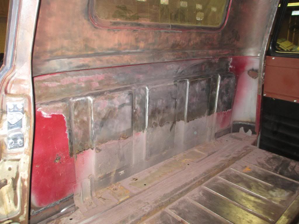

    Well I finally got back out to the garage tonight. I was going to do it over the weekend, but a HAMB friendly chevy pickup showed up locally and I took the wife to go take a look at it. This other truck would be my daily driver (low miles and a reliable powerplant. It needs some love, but is priced right and should handle what I need it for. The wife really liked it and said I would be able to get it because we need a pickup to haul stuff in anyway. Cool lady :cool:
    Anyway... Here are the pictures of the back portion of the cab... a lot of contours here, so it is slow going... I think one or two more nights like tonight and I can have the floor completed. Here are some pictures...

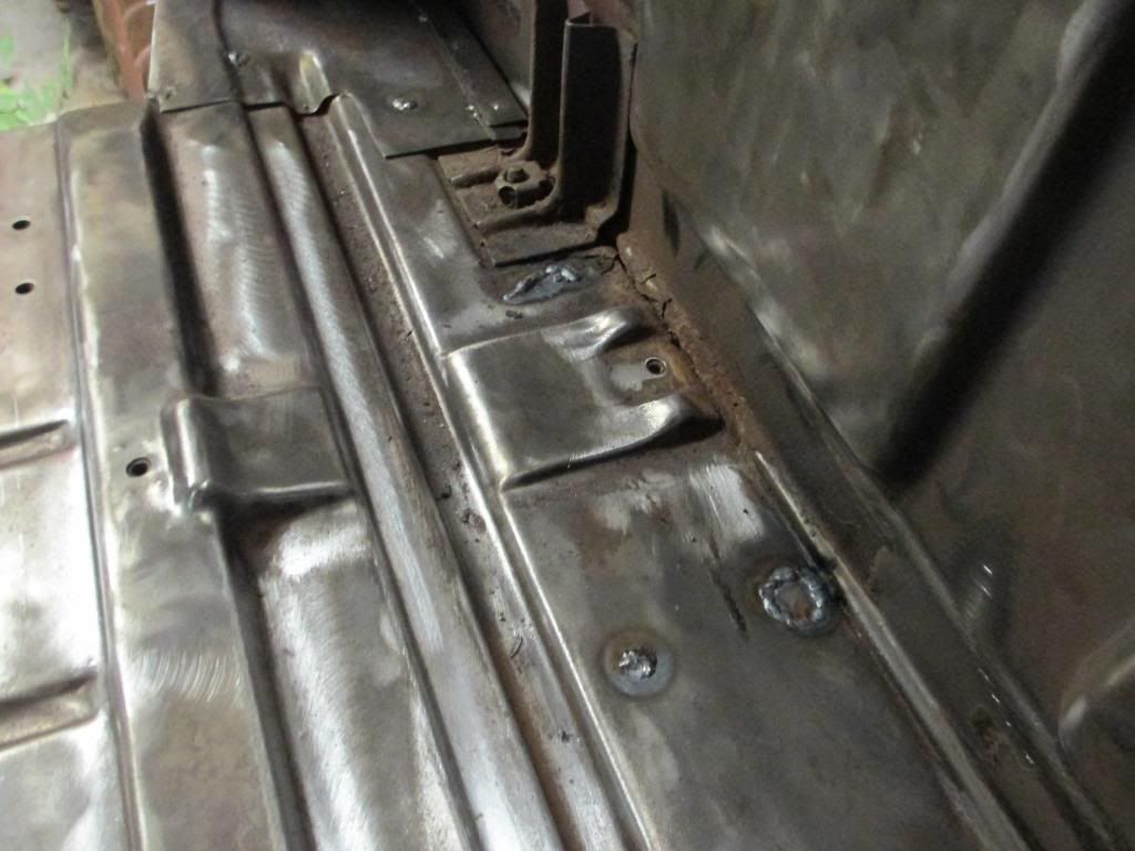

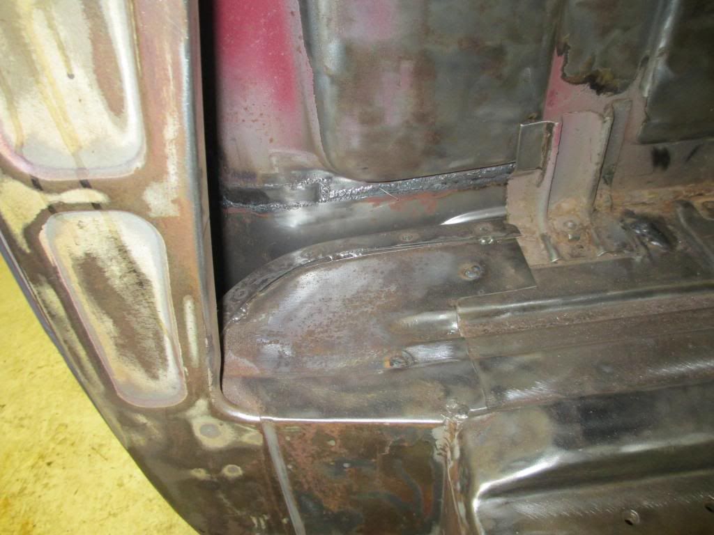

  28. 1959apache
    Posts: 2,635
    1959apache
    Well, it started snowing out and that kind of switched what I wanted to do today on the pickup. I ran out of the wire wheel on the grinder, so I need to go get another, I did what I could, but it was limited. I then decided to start welding up some holes and got the part behind the seat knocked out, which was sweet. I will need to grind down my welds tomorrow then start working on the roof and the front floor pan. Then primer time!
