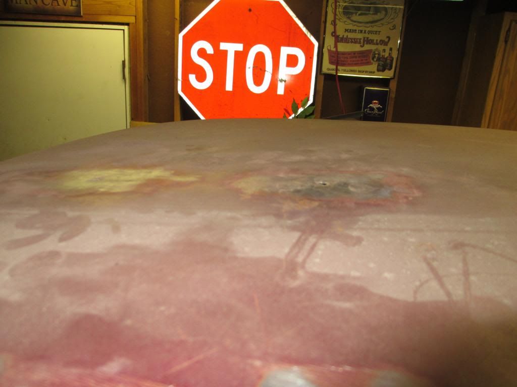

    So Ummmm... yeah... The holes in the roof were hiding 1/8" to 1/4" thick of bondo and messed up holes. I will need to flatten everything out and get it close that use the torch to fix it and get the oil can out of it... I am just going to have to grind most of it flat so I can get it done... Son of a.....
    And the wife decided to be in this one lol
    You can see how bad it is, but I roughed a lot of it out with a hammer and dolly... This will be the hardest part on the hole interior of the cab and you won't necessarily see it because of the headliner and it is on the roof... but good practice none the less. :D
    My little T-rex arms can't hammer and dolly that far apart unfortunately. So she will have to come out to help me before it is all said and done, she said she didn't mind

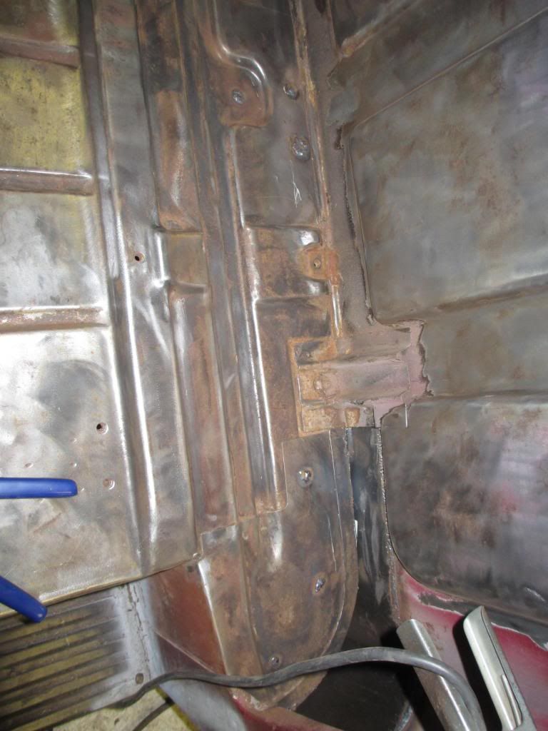

    Well I started on the truck right after work out in the garage yesterday and today... first time in about 6 months back to back. I worked several hours doing misc. little **** all over the place... not really picture worthy, but I did snap a couple shots of other stuff.
    The rotten spot on my floor just kept getting bigger despite me hitting it with a hammer and screw driver and chisel to find the soft, thin spots. So it wound up originally looking really good and then turned to **** quickly, so I will just grind it down and be done with it... it will be under carpet and no one will see it anyway.
    I then started grinding welds and taking care of the rest of the floor behind the seat.
    Then I summed up the night with working on the roof and I actually got the p***enger side holes (since they are closer where I can reach using a hammer and dolly) really close. I even got the oil canning out of that side of the roof and got it stiffened up enough that I will finish it up and weld that area. The drivers side is still being a pain, but I got that closer. Tomorrow the wife is going to help me get it so I can weld those holes up and start prepping for paint. :D
