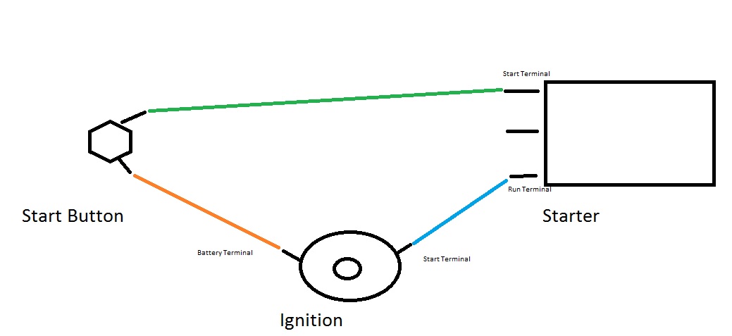

  21. 59Apachegail
    Joined: Apr 30, 2011
    Posts: 1,508
    59Apachegail
    from New York
    Nice wiring job,
    I have original wiring schematics and a repro ones from when I re-did mine. If you guys are interested pm me and ill send it to you. Or I can just scan and post it here.
    I can also make a drawing of how I have my push to start ****on set up on my dash.

    dubie
    that would be awesome Gail. I was planning on putting a push ****on in mine as well

  27. 59Apachegail
    Posts: 1,508
    59Apachegail
    from New York
    Thanks guys I will post here and add to my album as pictures as well. My wiring was scary I was starting off a "hot" in my head lights and I had splices everywhere. I picked up a kit from cl***ic parts of America because I needed a solid harness to start from. Not bad for 250 but I needed to tweak it a bit.
    Push to start was very easy to set up. I don't have access to a scanner today but will scan and post tomorrow.

  29. 59Apachegail
    Posts: 1,508
    59Apachegail
    from New York
    Very simple to setup push to start.
    The way I have it the ignition switch is what provides the "hot" cable to the ****on. If my key is in the off my starter will spin but she wont fire up. Key needs to be in run for juice to engine.
  30. 1959apache
    Joined: Nov 22, 2009
    Posts: 2,635
    1959apache
    So you don't have a spring loaded start switch right?
