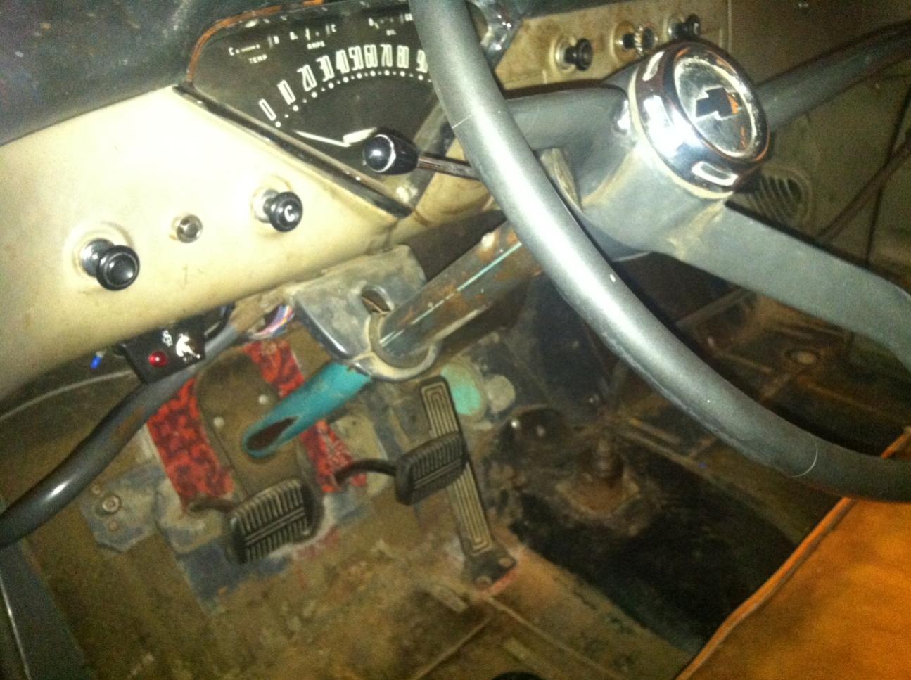

    Nope, she came from the factory with one but that is long gone. I have a start ****on on the dash next to my headlight switch. Our trucks came with two types of ignition switches. 8 cyl was just like a car start, run, off. 6 cyl was on/off with the foot pedal to start.
    The light blue plate on the floor is where the start pedal lived. you can see a terminal hanging behind my fog light switch. My wiring is 95% done I need to fix some gremlins in my radio and wipers.

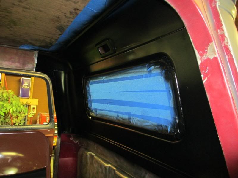

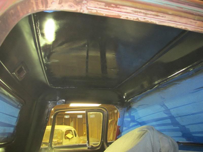

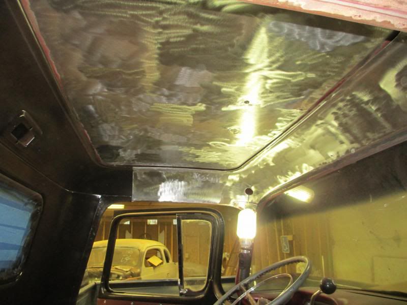

    Well I haven't been out in the garage really for a couple weeks, other than to do required maintenance on my wifes car and the C10. I am beat right now. I just spent two hours out in the garage getting a lot of the ceiling of the cab in some epoxy. I had to restrip everything to get the surface rust off of the steel, used acetone to clean it, then masked everything off and shot some primer. I spent some of Saturday getting around the rear window and spent tonight for the sides and the roof. This week I will try to get the door jambs done and then move to the dash. When all of that is finished then I will finally take care of the floor.
    Here are some pictures:
