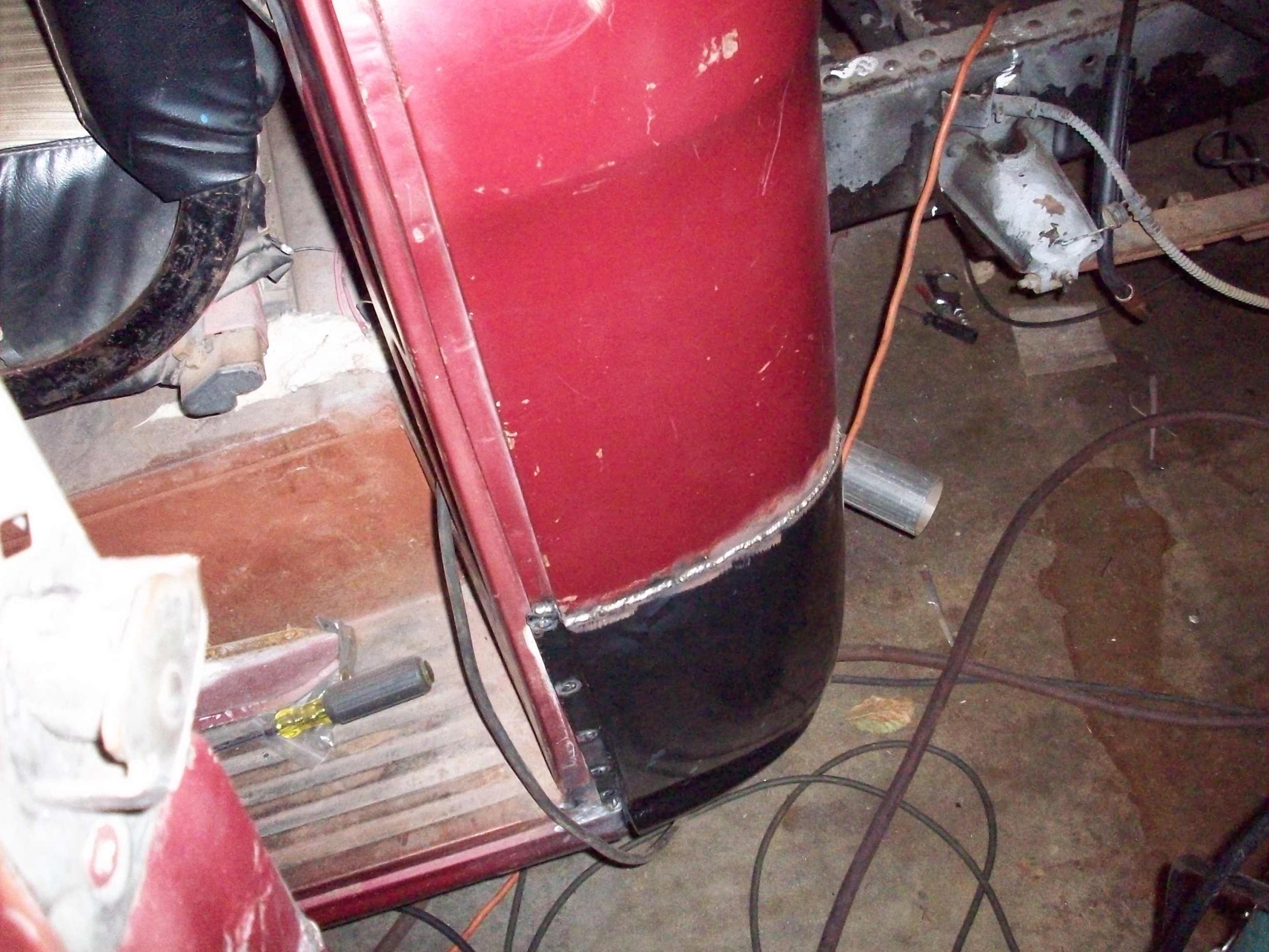

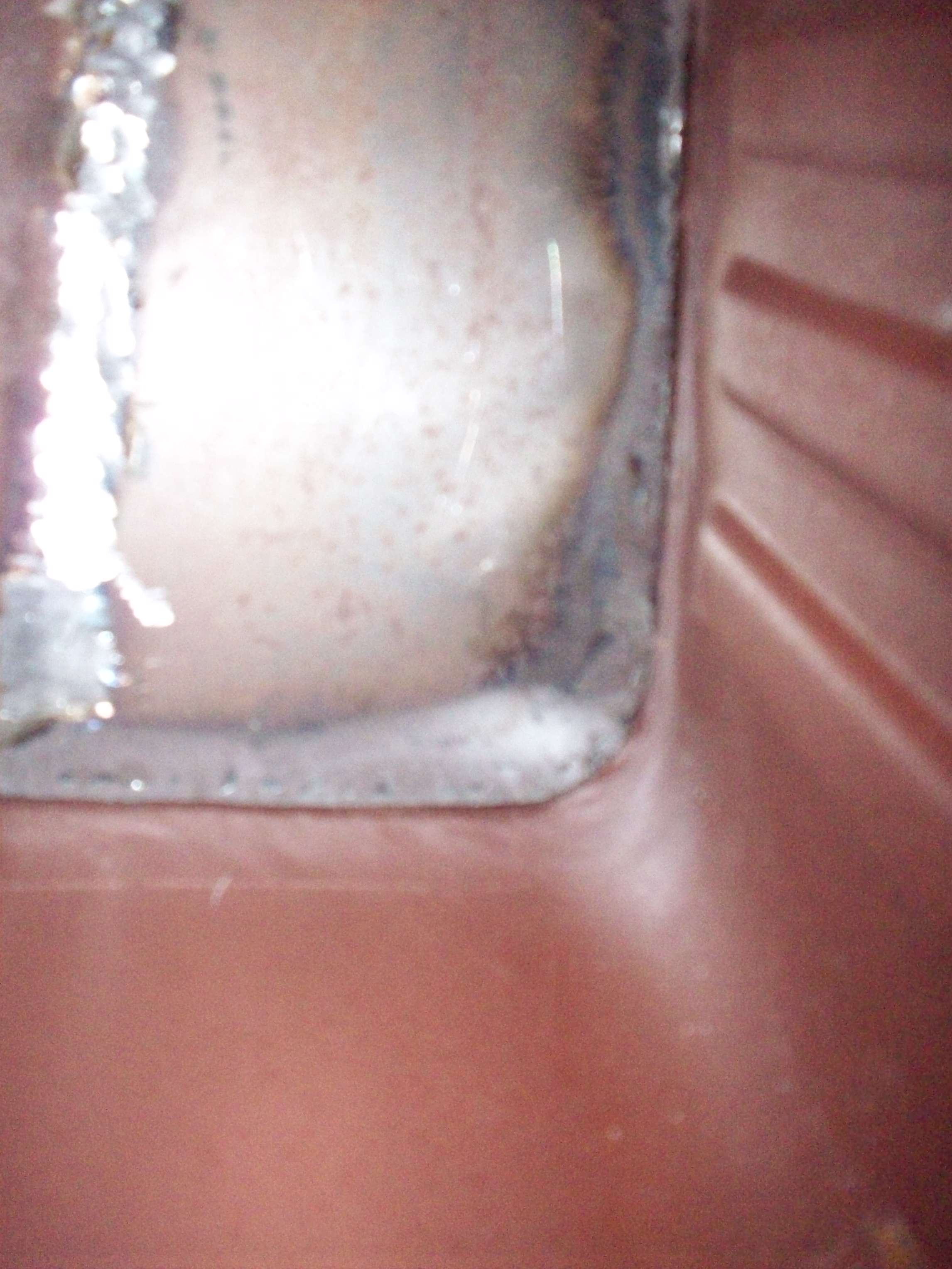

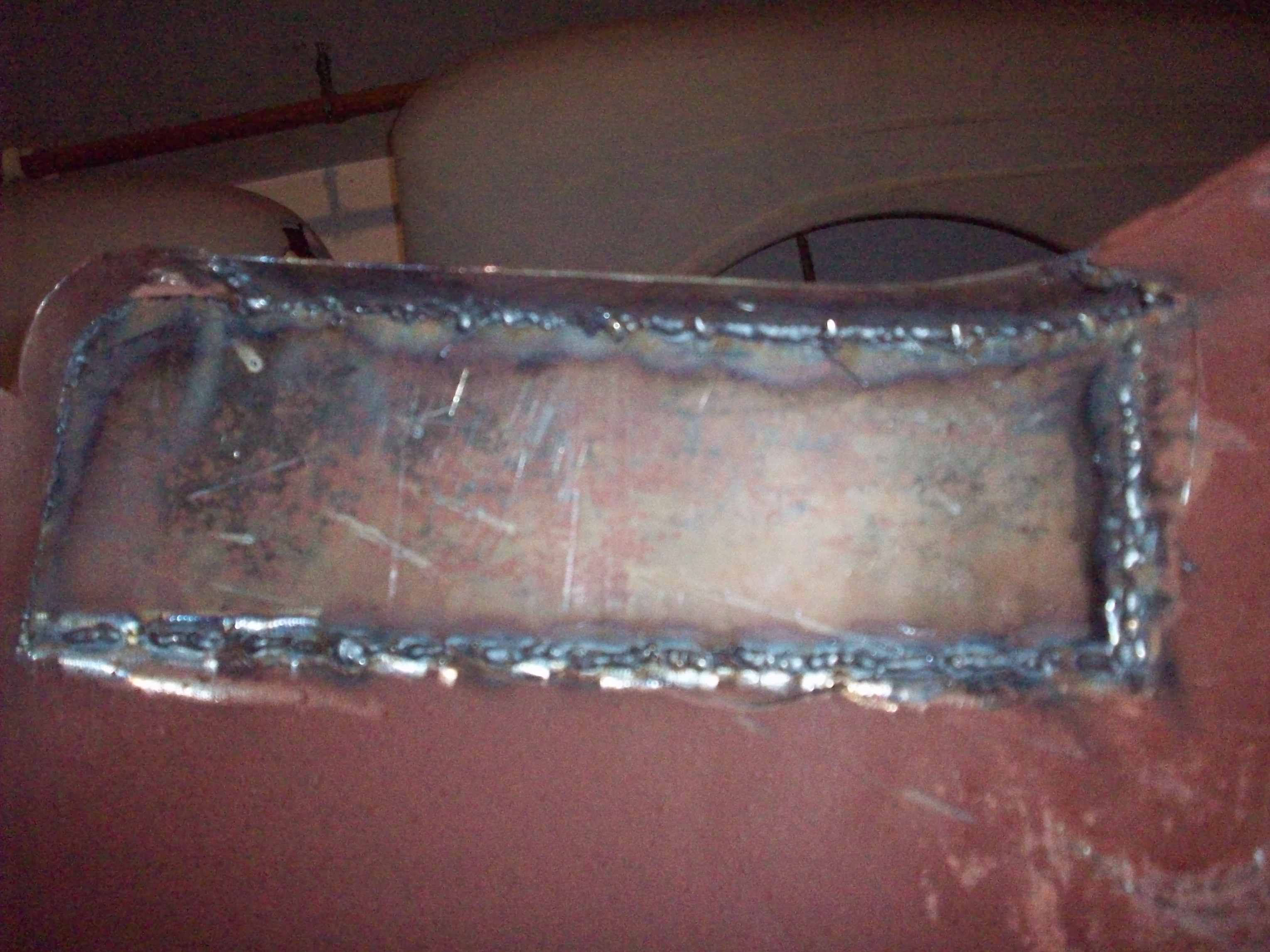

    Just finished up the welding on the drivers side cab corner. Then moved on prepping the p***enger side cab corner. I got the inner cab corner replaced and tomorrow I will put the outer skin on. Then I will tear into the body work on the bed a little more. I starting pounding out dents on the rear fenders. :p

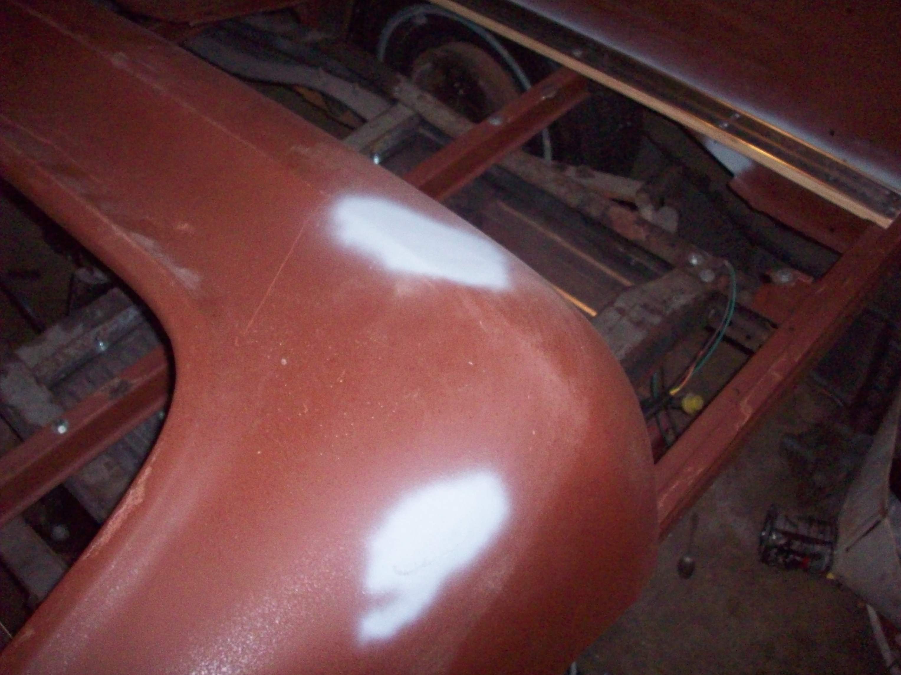

    1959apache

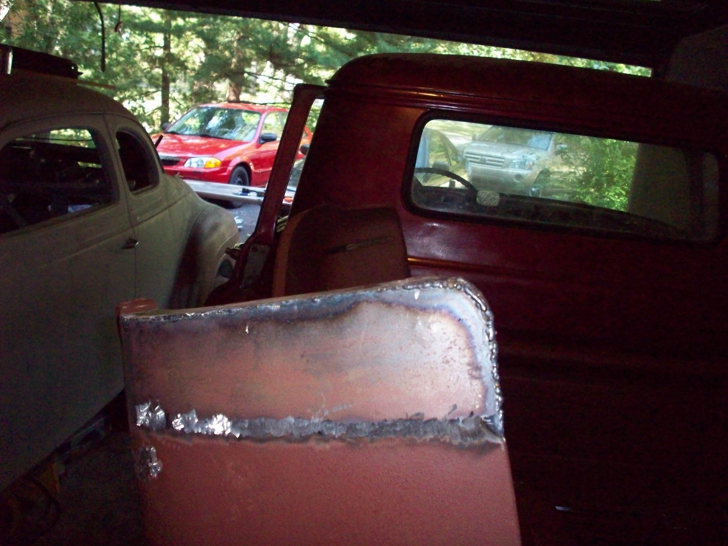

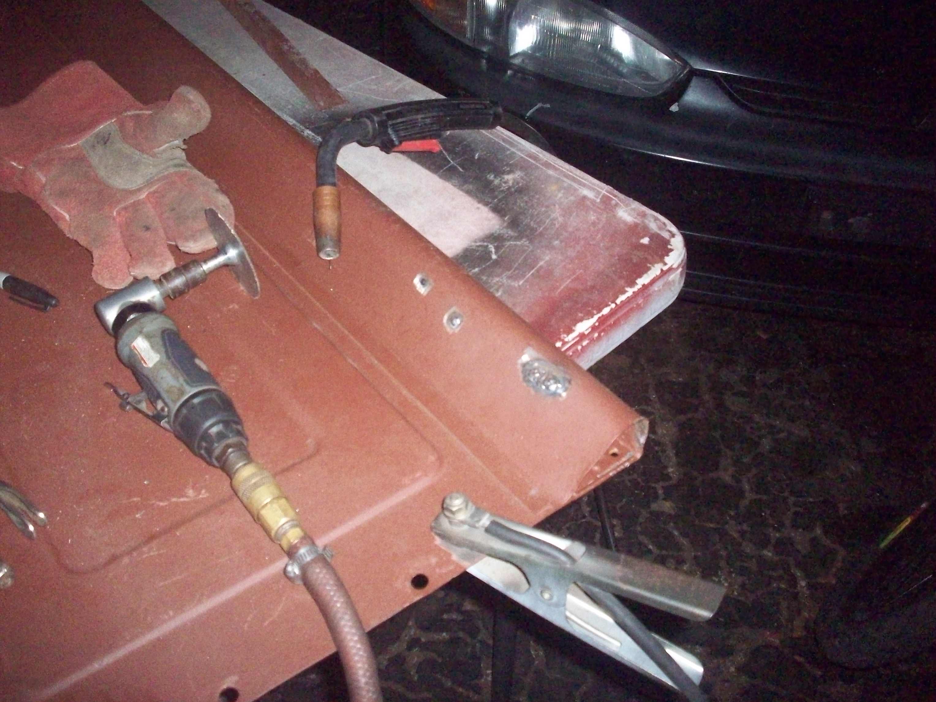

    Well I got the p***enger side skin on, welds kind of **** on A, but I cant get this metal too hot or it will warp. I am just going to grind down these welds and go from there. Ive knocked multiple dents out of both fenders and will be working on the bed cross sills and bed sides.:eek:

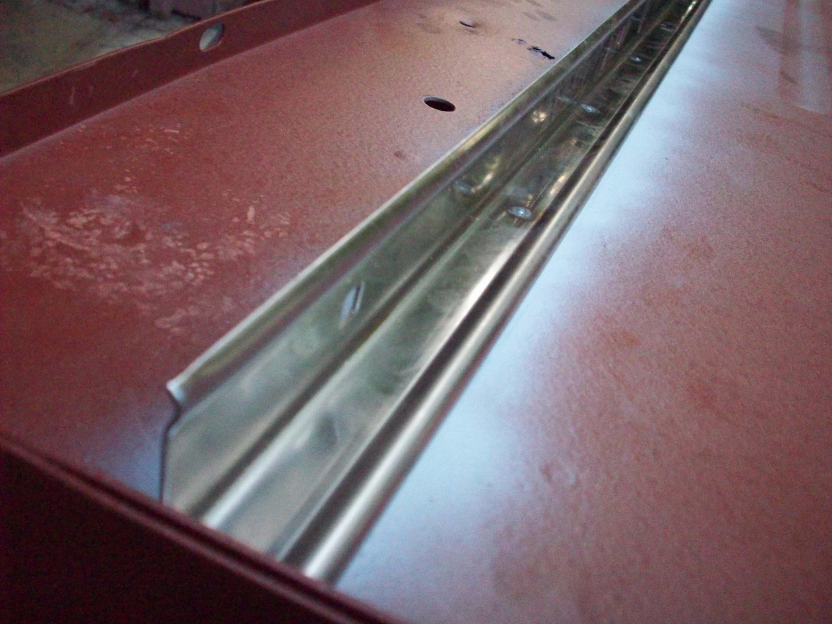

    Well, I got the cab corners close enough that I can finish up the body work on them later. I started removing the nasty, old, bent angle strips and finished welding my new angle strips on my bed sides. Tomorrow I will start doing a little body work on the rear bed cross sill and maybe the front bed panel. Then she goes together in 1 piece.:D

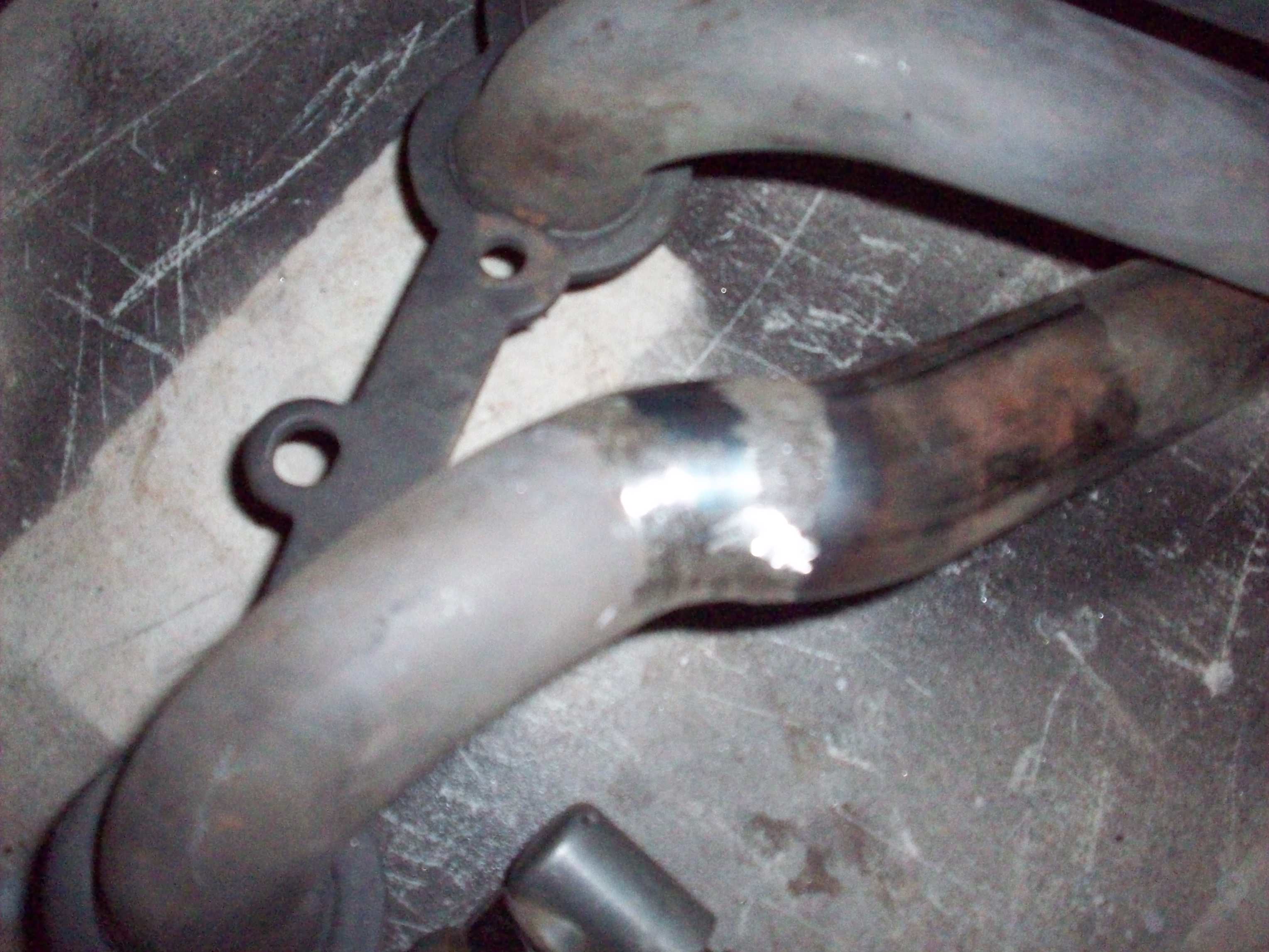

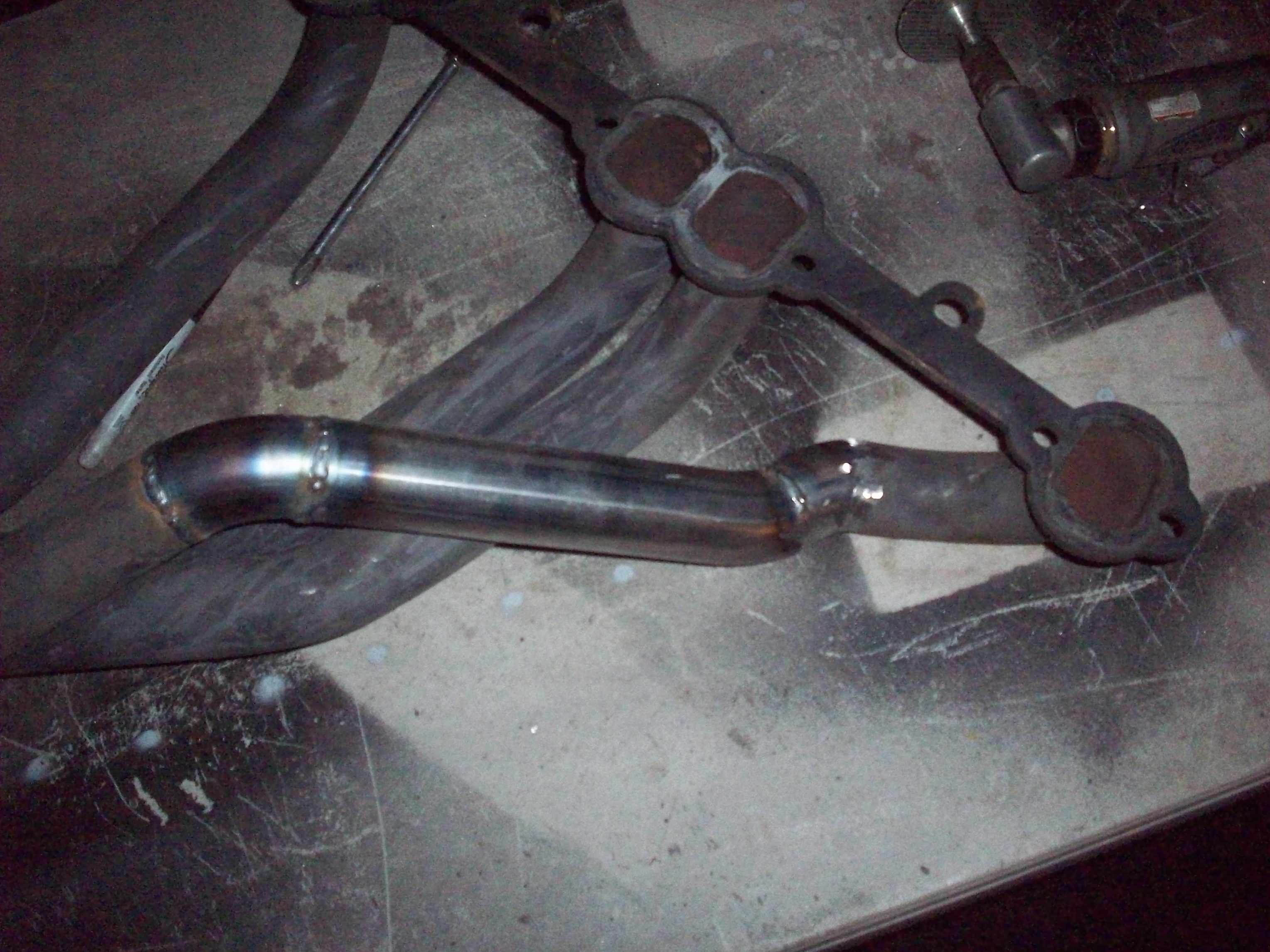

    Just pulled the header to work on #1 piping to move it farther south of the #3 spark plug. I will begin work on that tonight. I am waiting for a buddy of mine to give me apiece of sheet metal back that he took to make a pattern because he wanted to try and do it. Biggest mistake ever. lol. He has had it hostage for 4 days now and isn't answering his phone. I will try and post some pics tonight or tomorrow

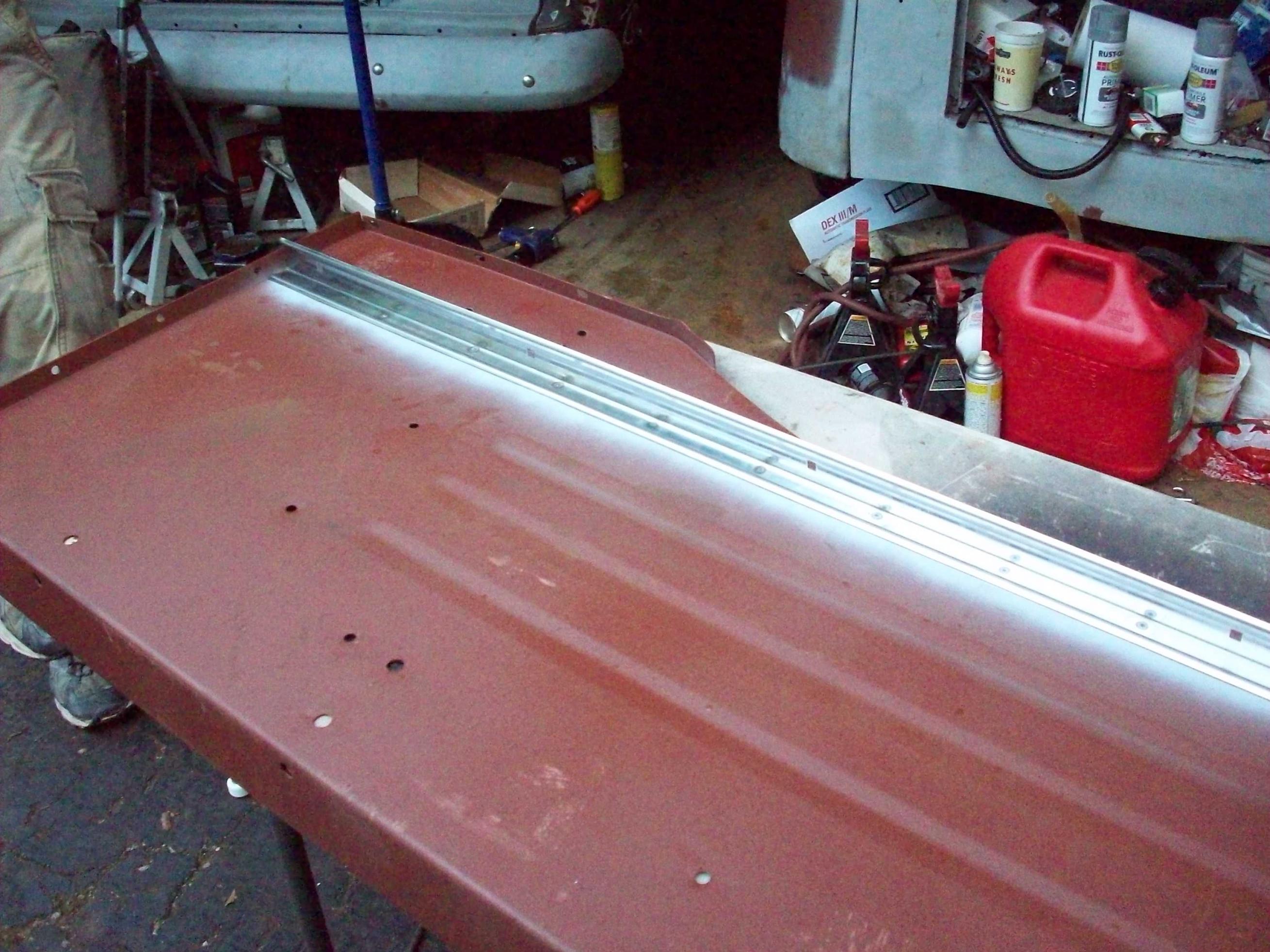

    1959apache
    Well I did a lot of work on the front bed panel. I cut out and replaced the sheet metal that was bad on the bottom lip. I will finish it up tomorrow. I will also put the bed together tomorrow once I get it done and primered. :D

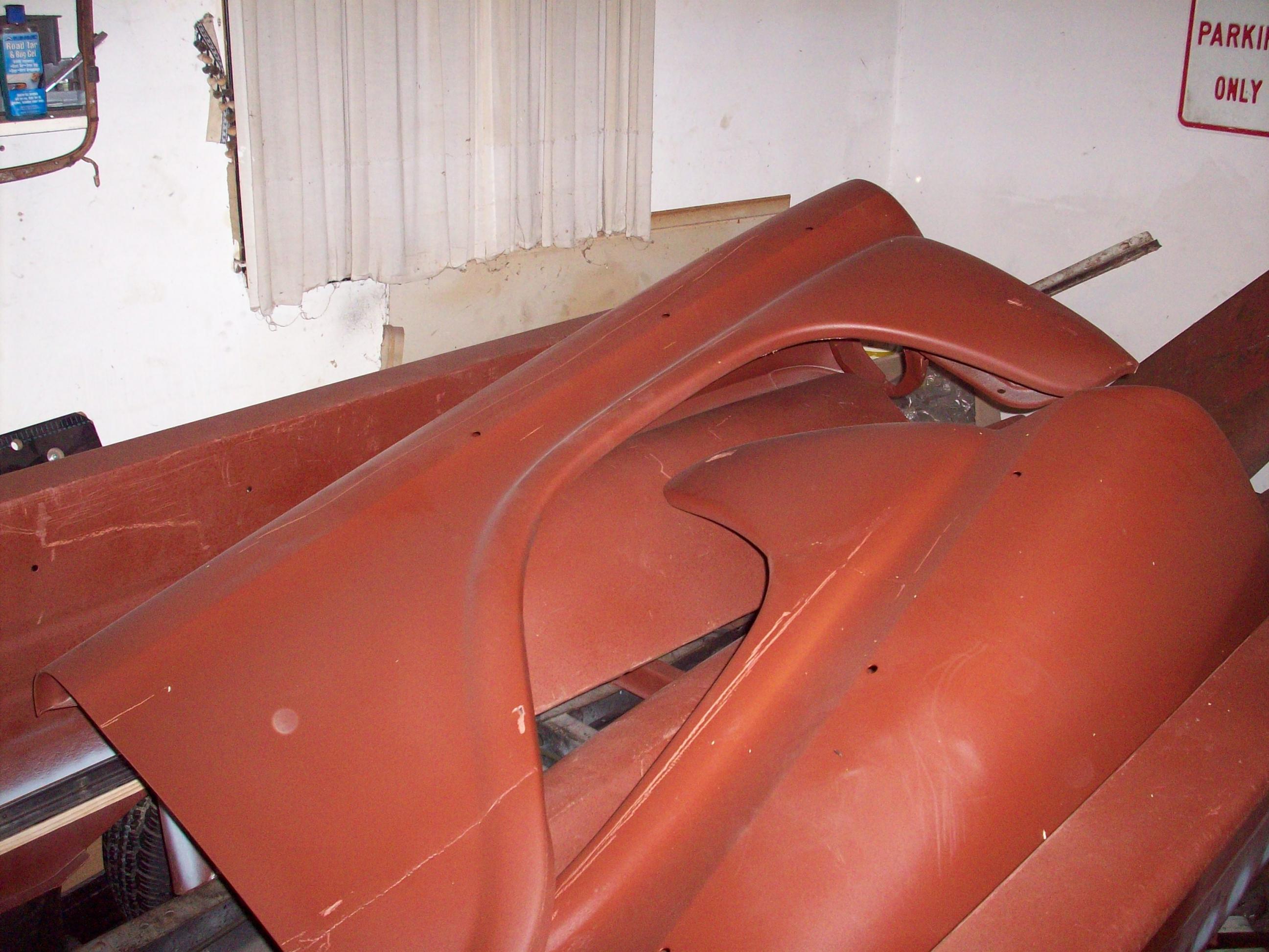

    1959apache

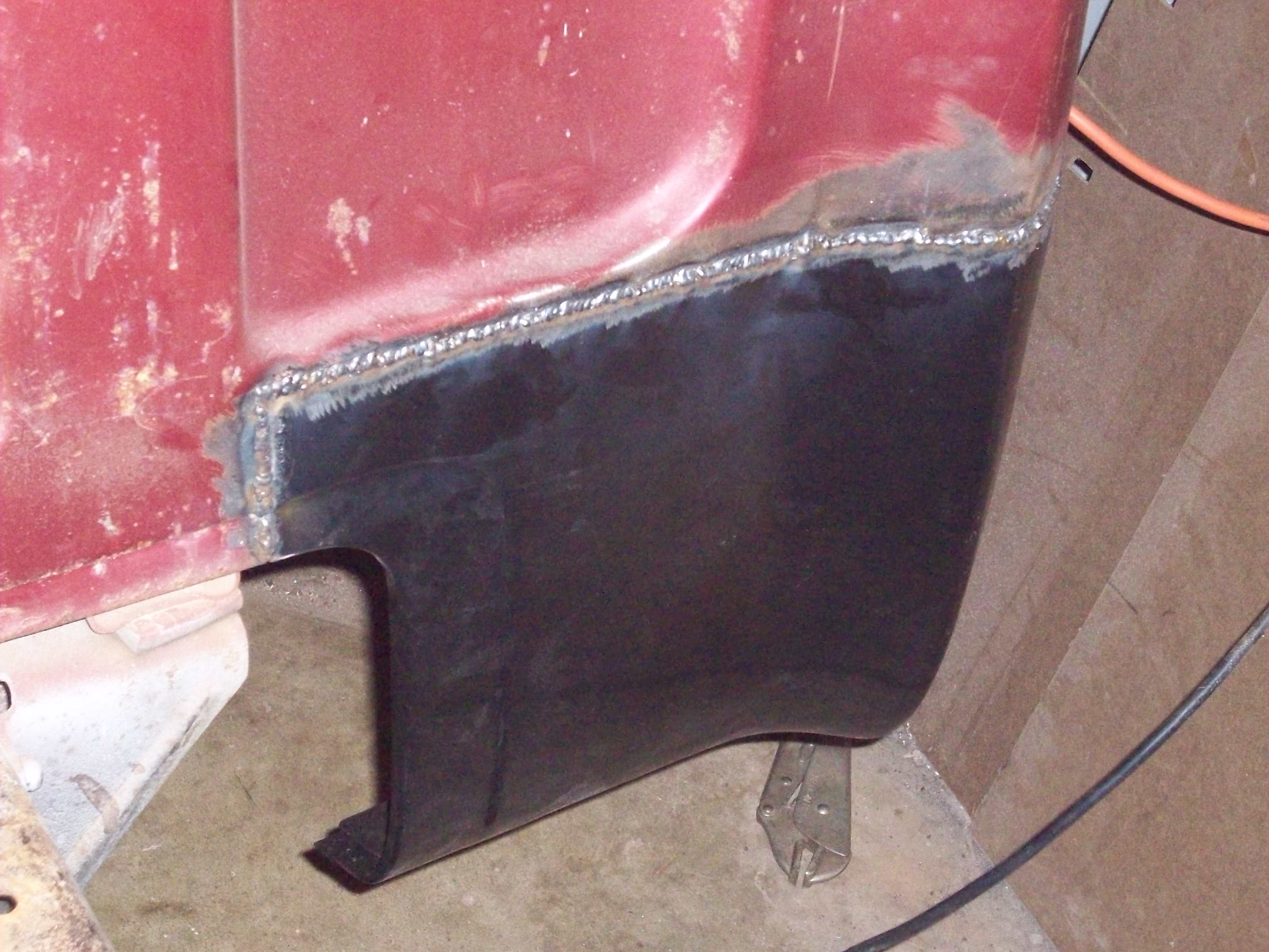

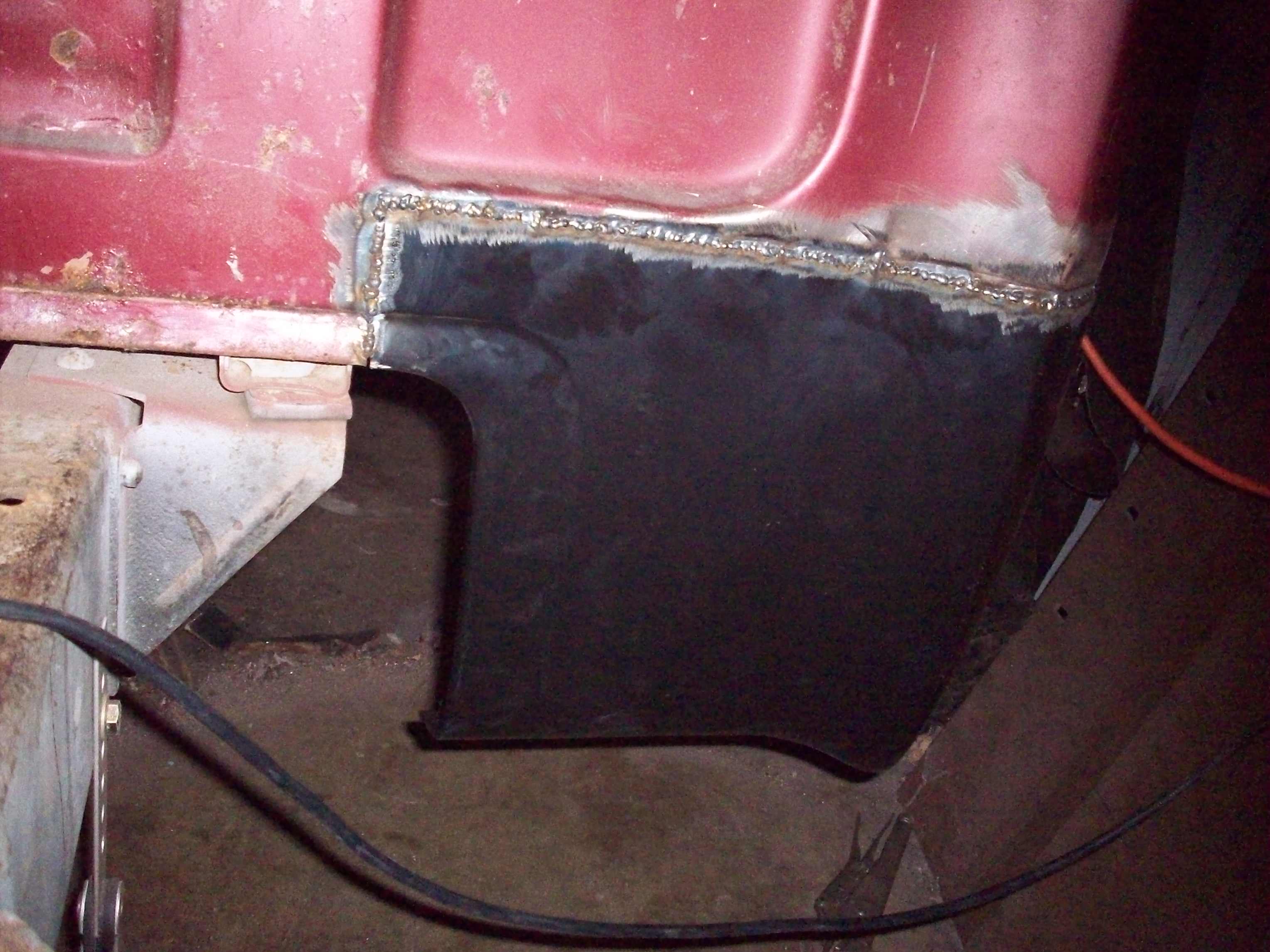

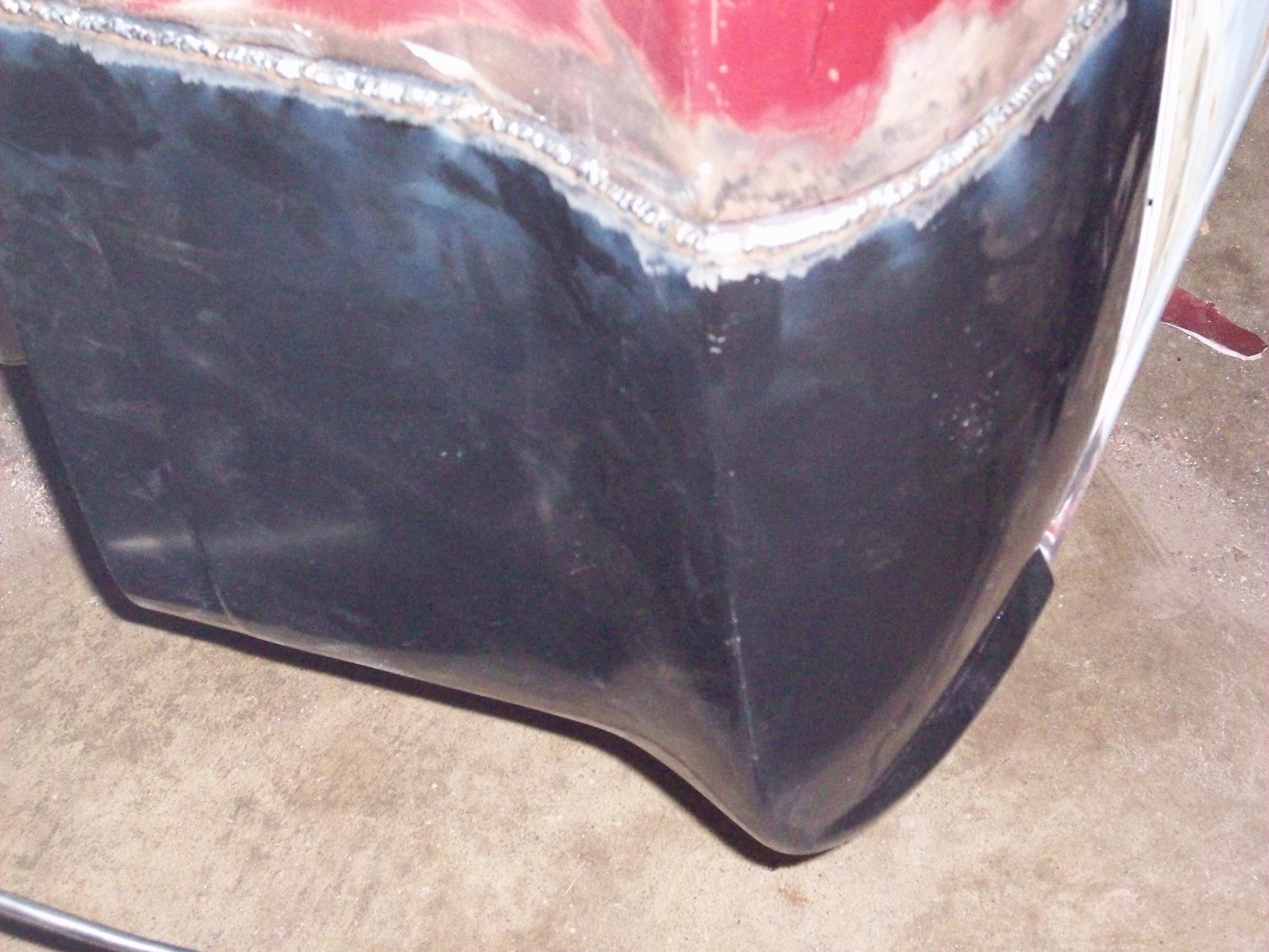

    I also worked on the front bottom of the rear driver's side fender. It was pretty nasty after the sandblasting. Here are some of the pictures. I will finish that up tomorrow or try too as well.. We will see though.;)

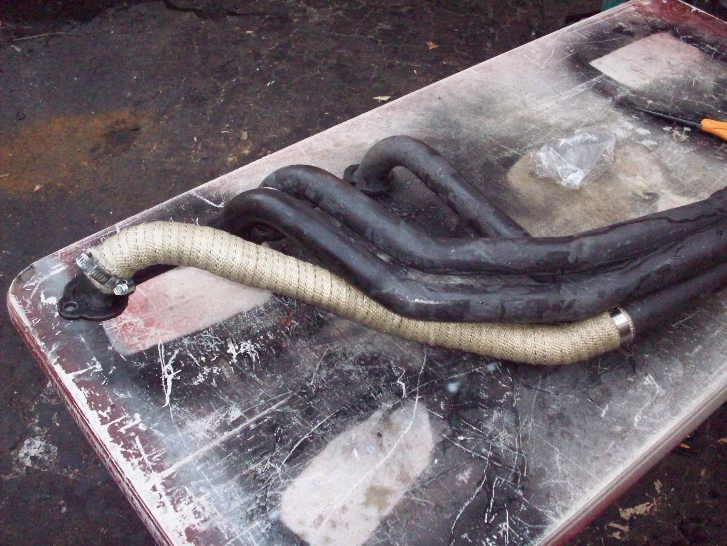

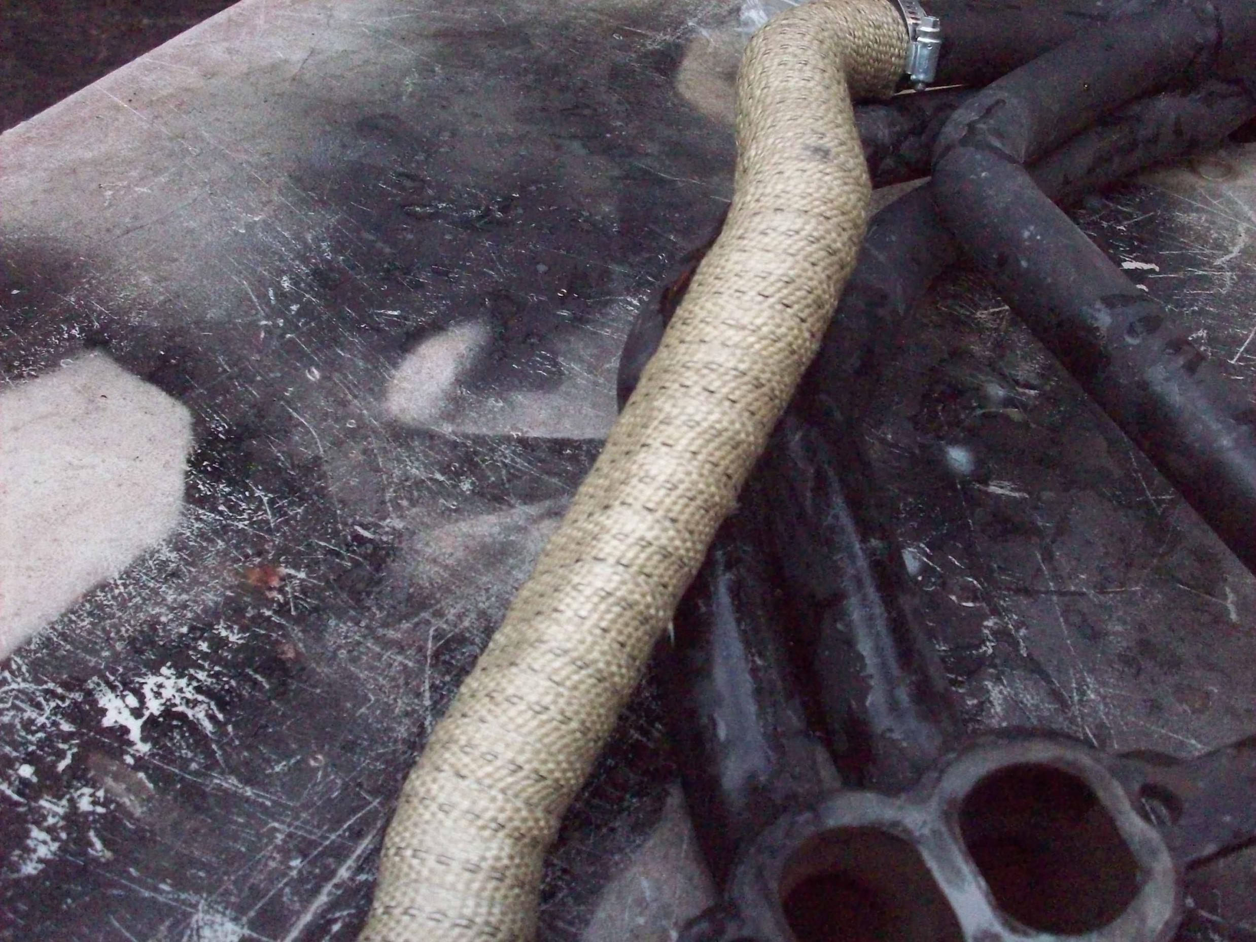

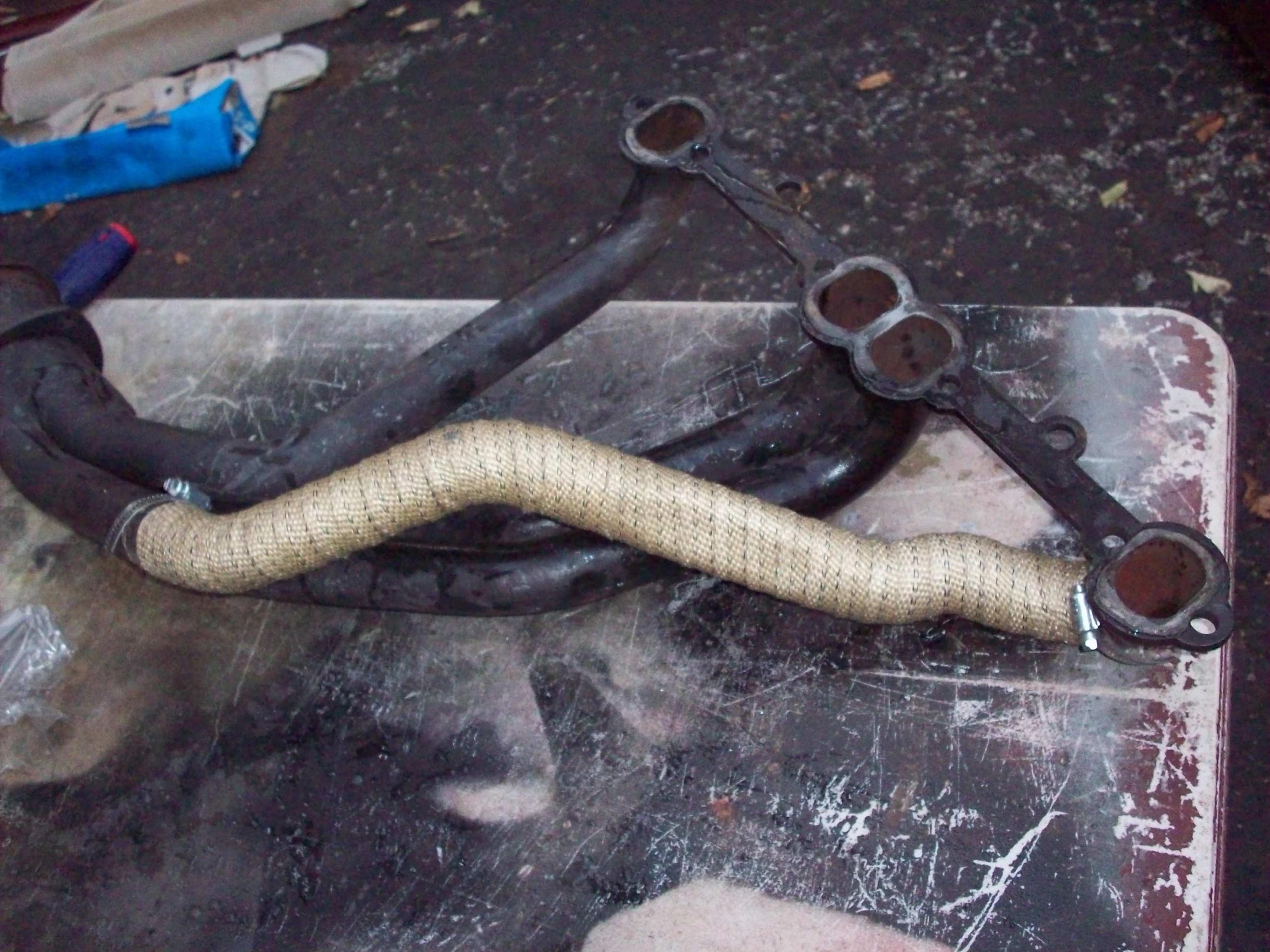

    Well I got the header done, need to grind some welds on it and paint it up. I also finished welding on the front bed panel. I need to grind those welds too. Here are some pictures!:D

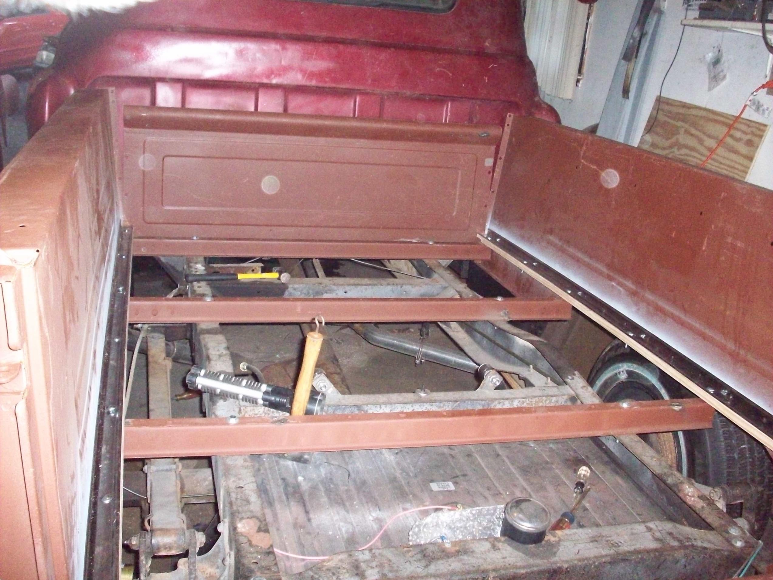

    I cut up some wood and starting mocking up the bed. I got tired of the pieces laying around. Here are some pictures!

    Well I mounted the front of the bed all together and have begun tightening the rest of the bed down so it at lease will not flop all over the place and get damaged. Next on the list is to finish a heat shield or using a little bit of asbestos cloth to ensure that my motor mount wont get roasted from heat coming from the header. Once that is done I can fix my front p***enger side header and get it started again.

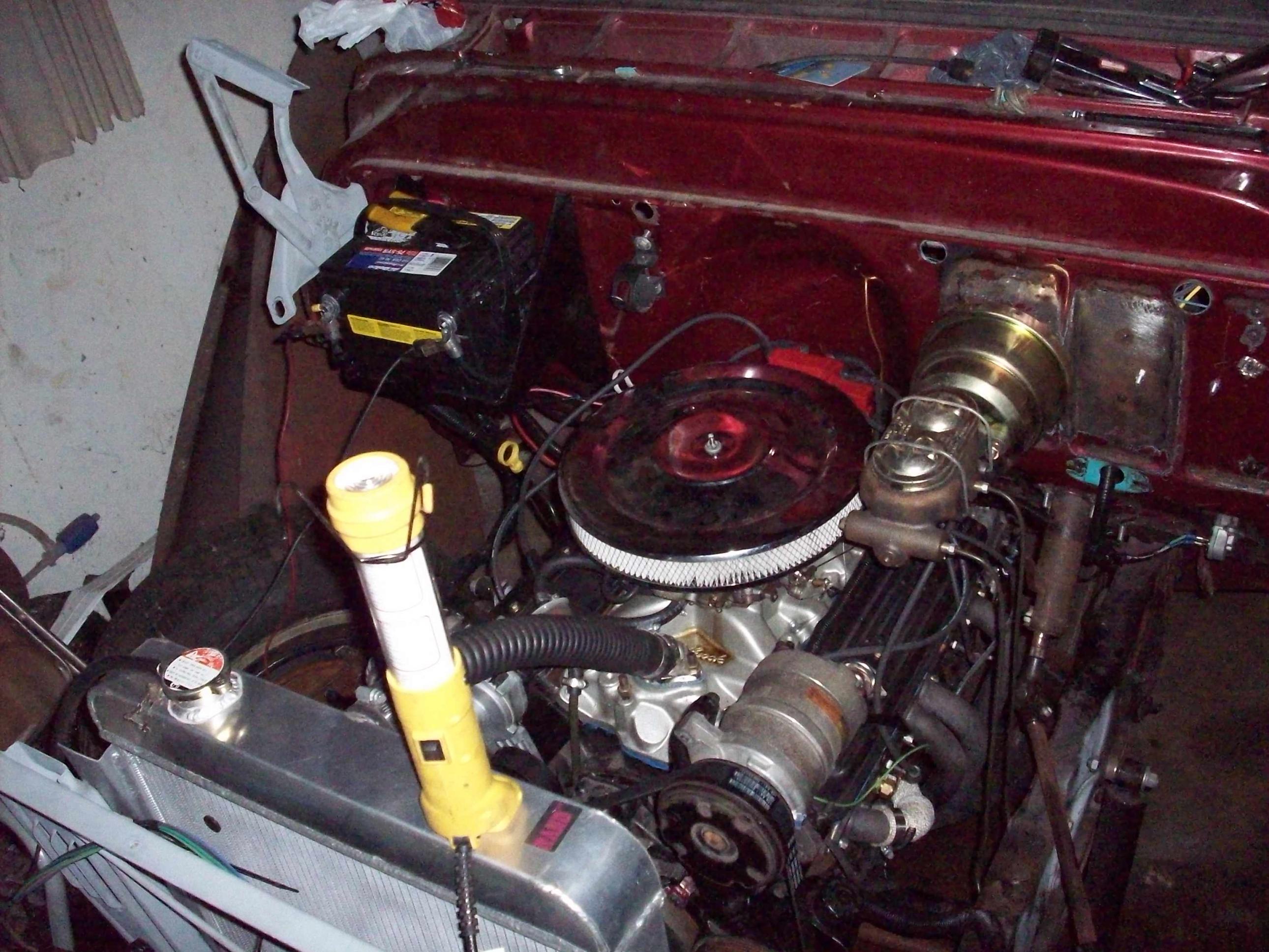

    Okay, pictures will be coming tomorrow. I cut out the left inner front A-Pillar of the cab and have begun trying to prep it to complete sometime later this week. I have to tweak that aftermarket sheet metal (that stuff is never right). I also got everything back from the blasters and boy does it look nice. I am excited because this thing is sooo close to the body work stage... I can taste the paint already......
    Anyways, I also got the truck running with the new HEI distributor. I finally got my sweet wire separators in and man that engine looks stellar. I will post pics of that tomorrow too.

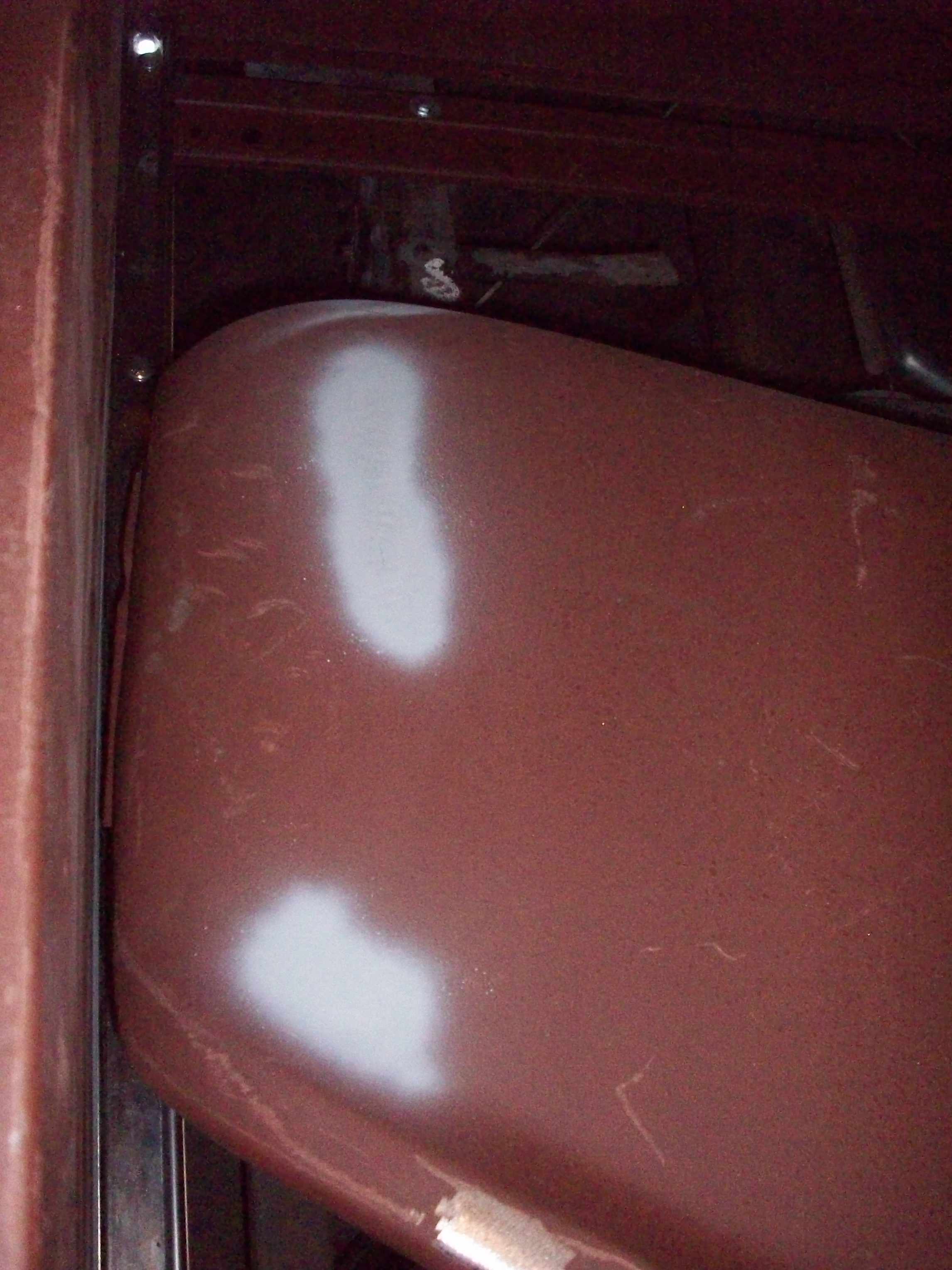

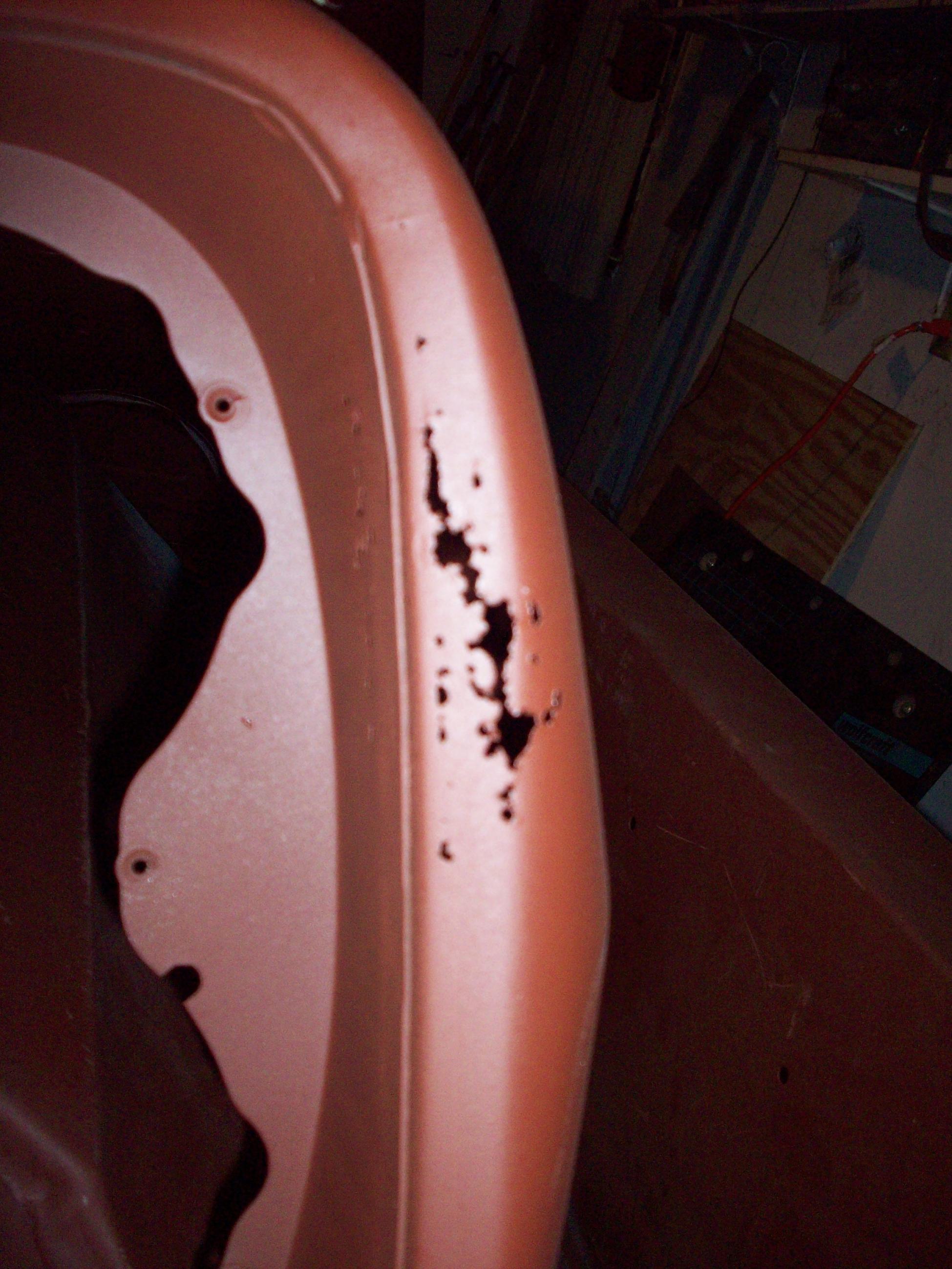

    Here are the pictures I promised of some of the sandblasted stuff I got shot in primer. Some of it needs work.:(

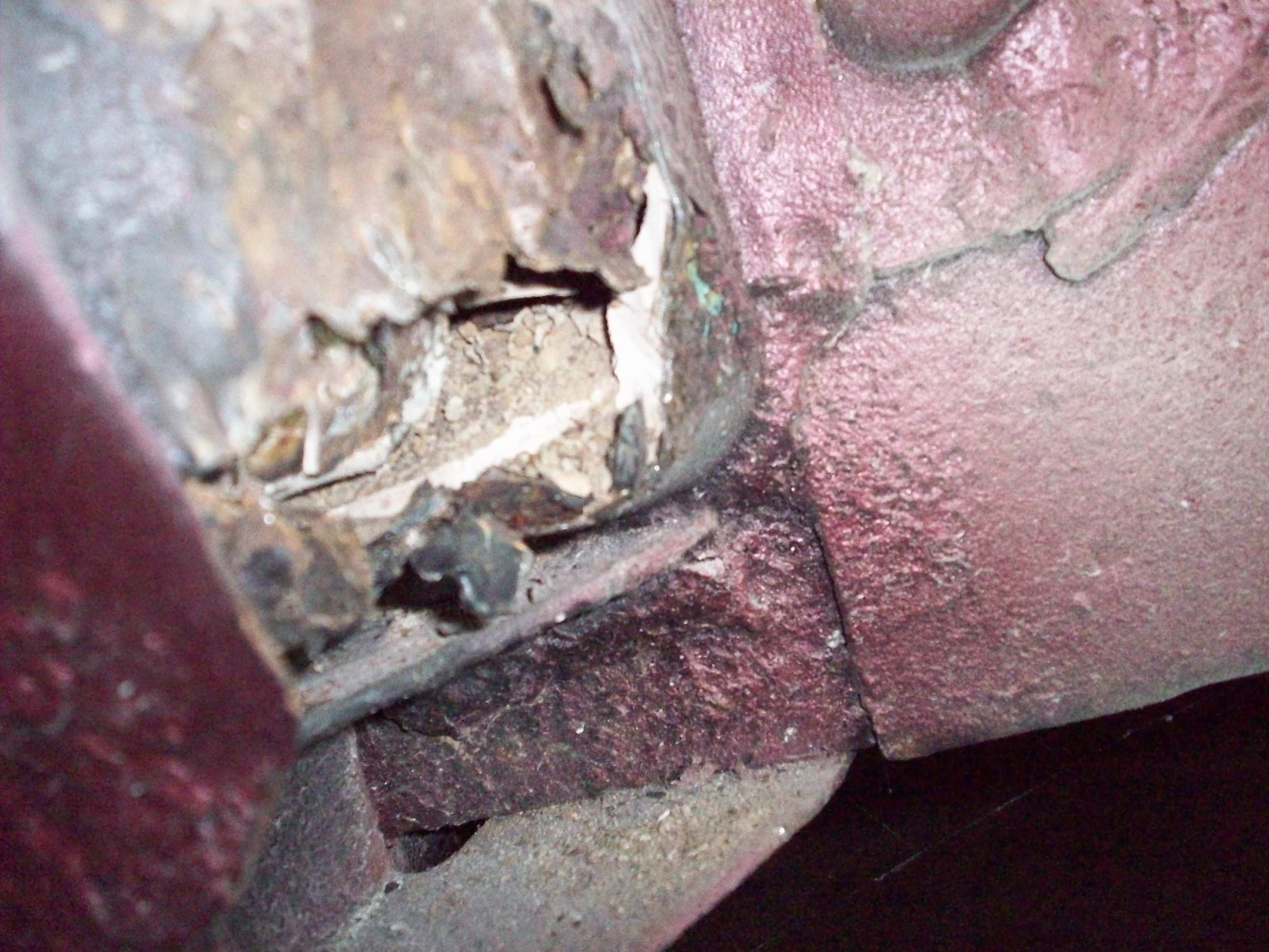

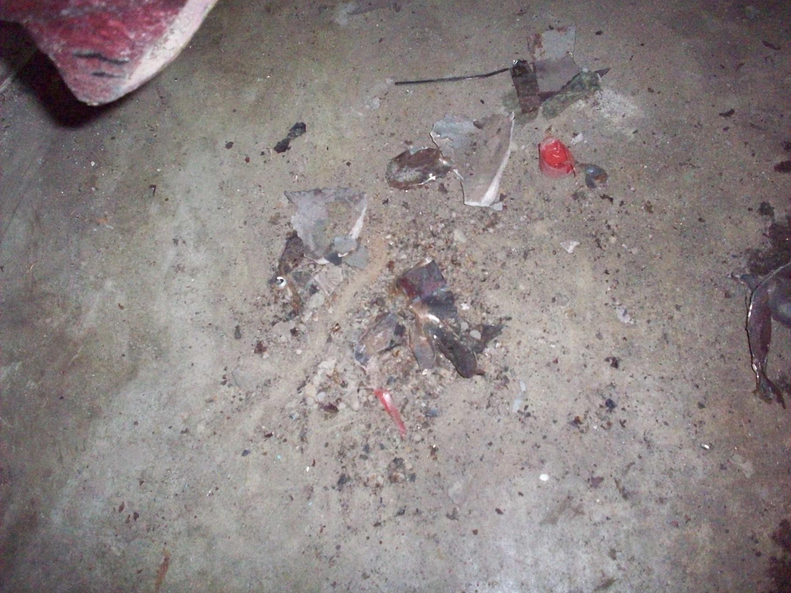

    1959apache

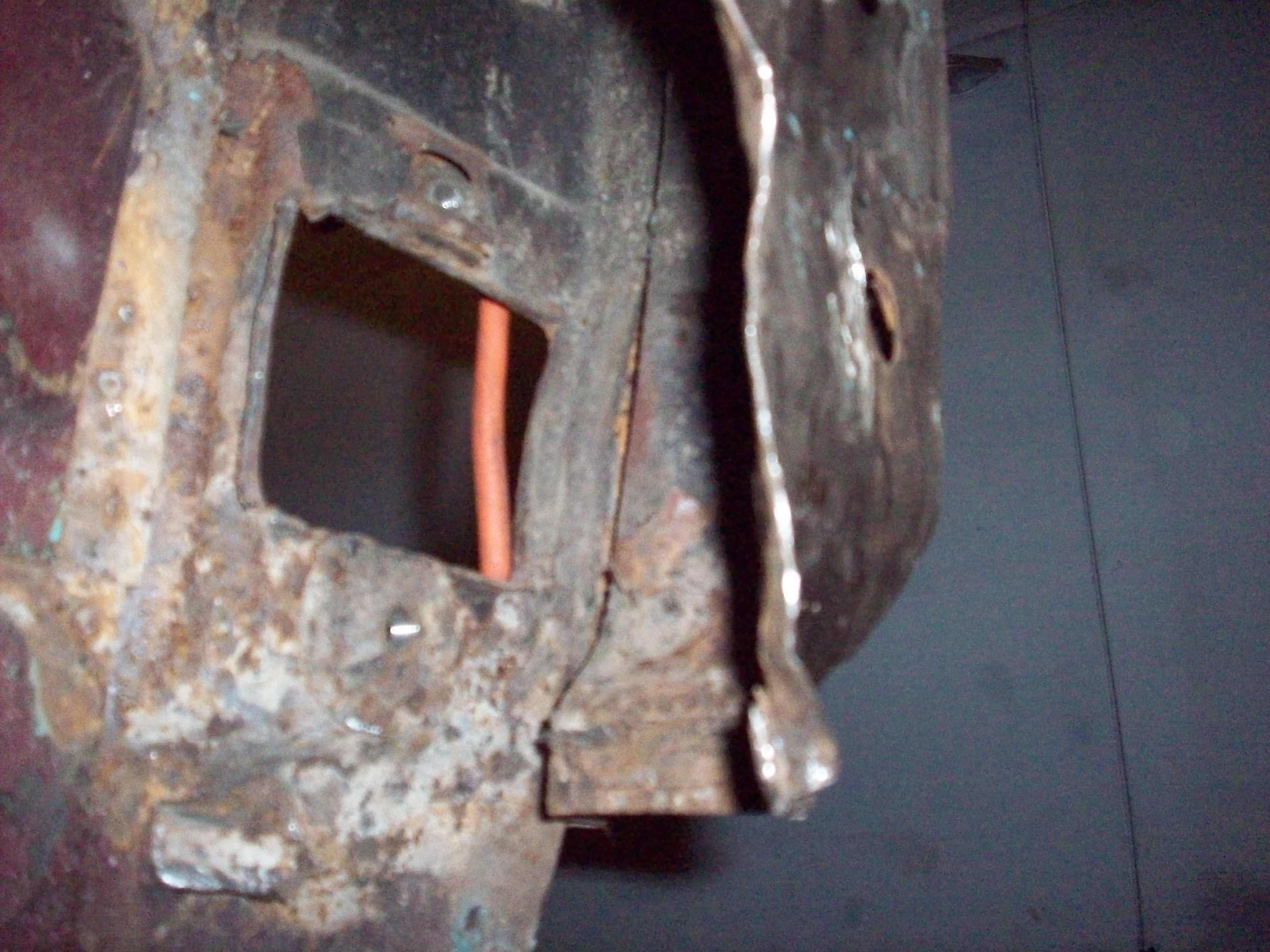

    Here is the p***enger and drivers side front A pillar.... not one shred of metal.. it was ALL bondo and rust inhibitor/tar, both are equally bad..:eek:
    What slays me is the guy that I traded for the truck claimed to be an expert in body work... WEB OF LIES!:D
    First 5 are of the p***enger side the last two pictures are the drivers side. What is on the floor are the solid pieces that fell out of the p***enger side.. notice barely any metal on the ground.
