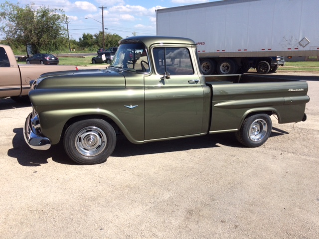

    I have been busy since the last time I posted... New exhaust done by a shop here locally. Now I can hear without going deaf. This was done back in 2015

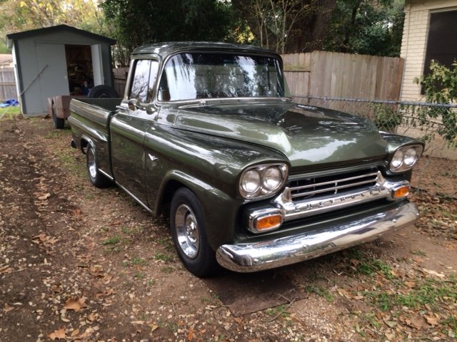

    It was then decided that I would make the truck my daily after a back injury because I couldn't drive my '95 lifted Wrangler anymore and can no longer drive a stick. So I sold it and used the money on the truck. New front fenders, installed all new hardware on the front end, new body panels for the bed (front bed panel, new tailgate, rear bed sill), decided to get the radio working, so I had new speakers with kick panels, installed an electric wiper conversion, new fuel pressure regulator, fixed all the wiring and added cannon plugs and other connectors to ease my work.... and the list goes on.
