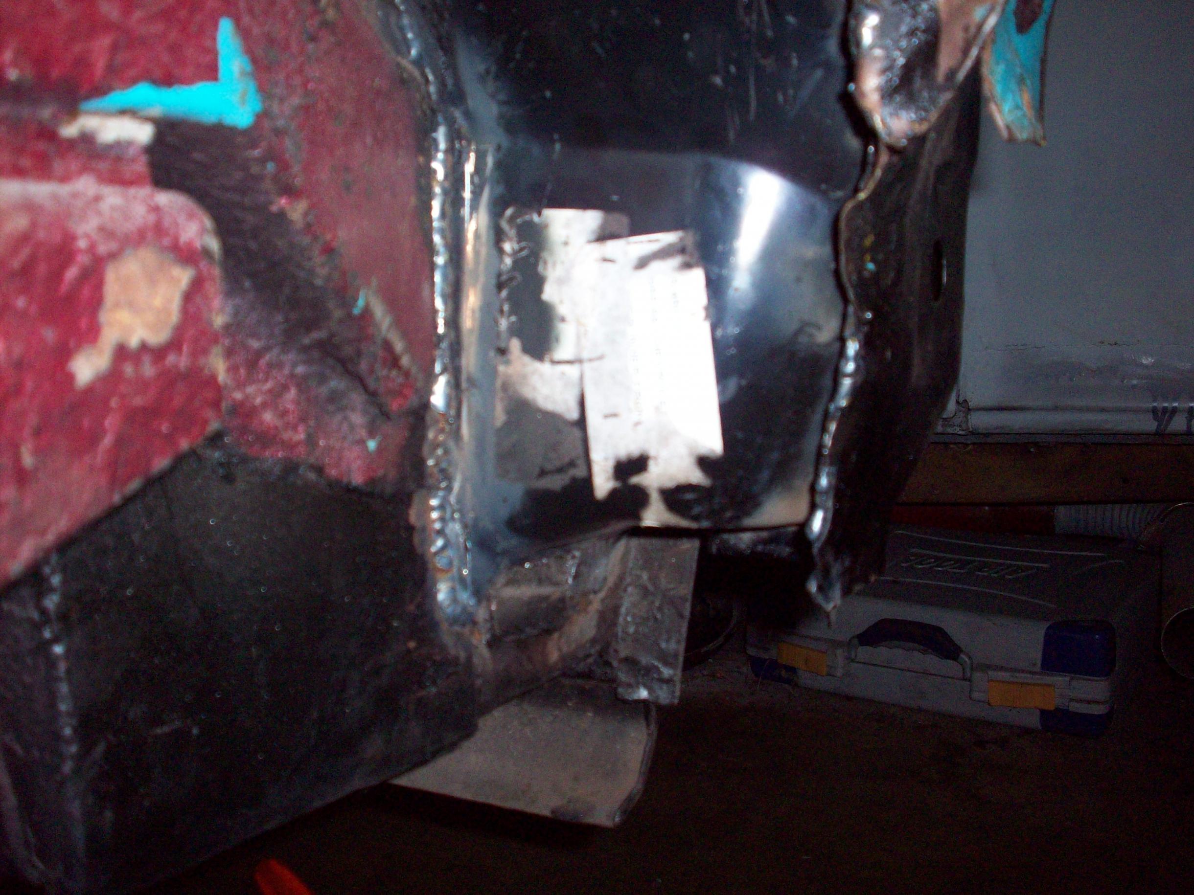

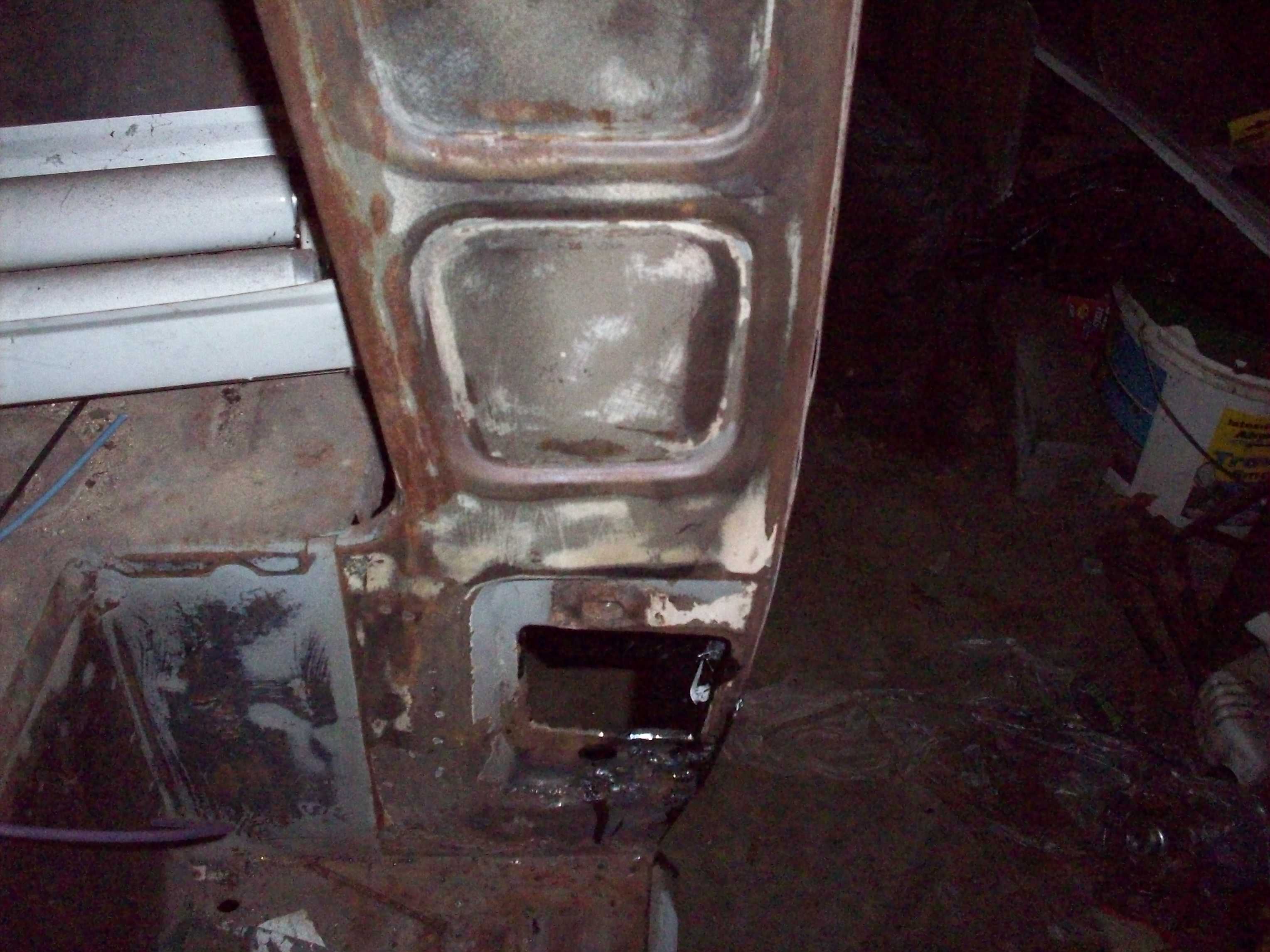

    Just finished the inner front a pillar on the drivers side. I started tearing apart what I thought was steel on the p***enger side front A-pillar, but found out it was mostly bondo. I then started taking out all of the rotten metal and will start fixing it tomorrow. Here are some pictures of the front drivers side.:D

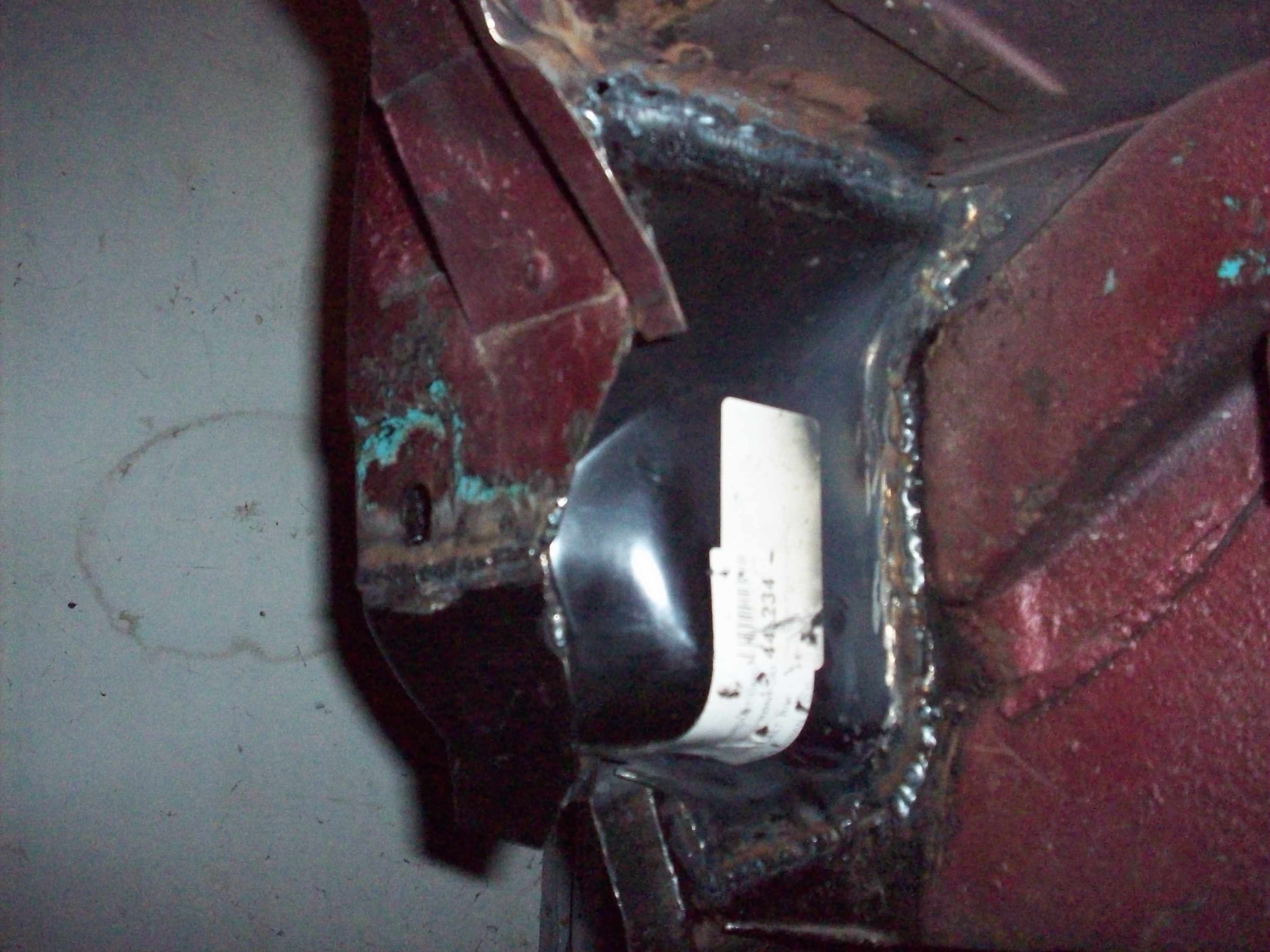

    Here is where I am with the p***enger A-pillar. It is going to be a mess....:p

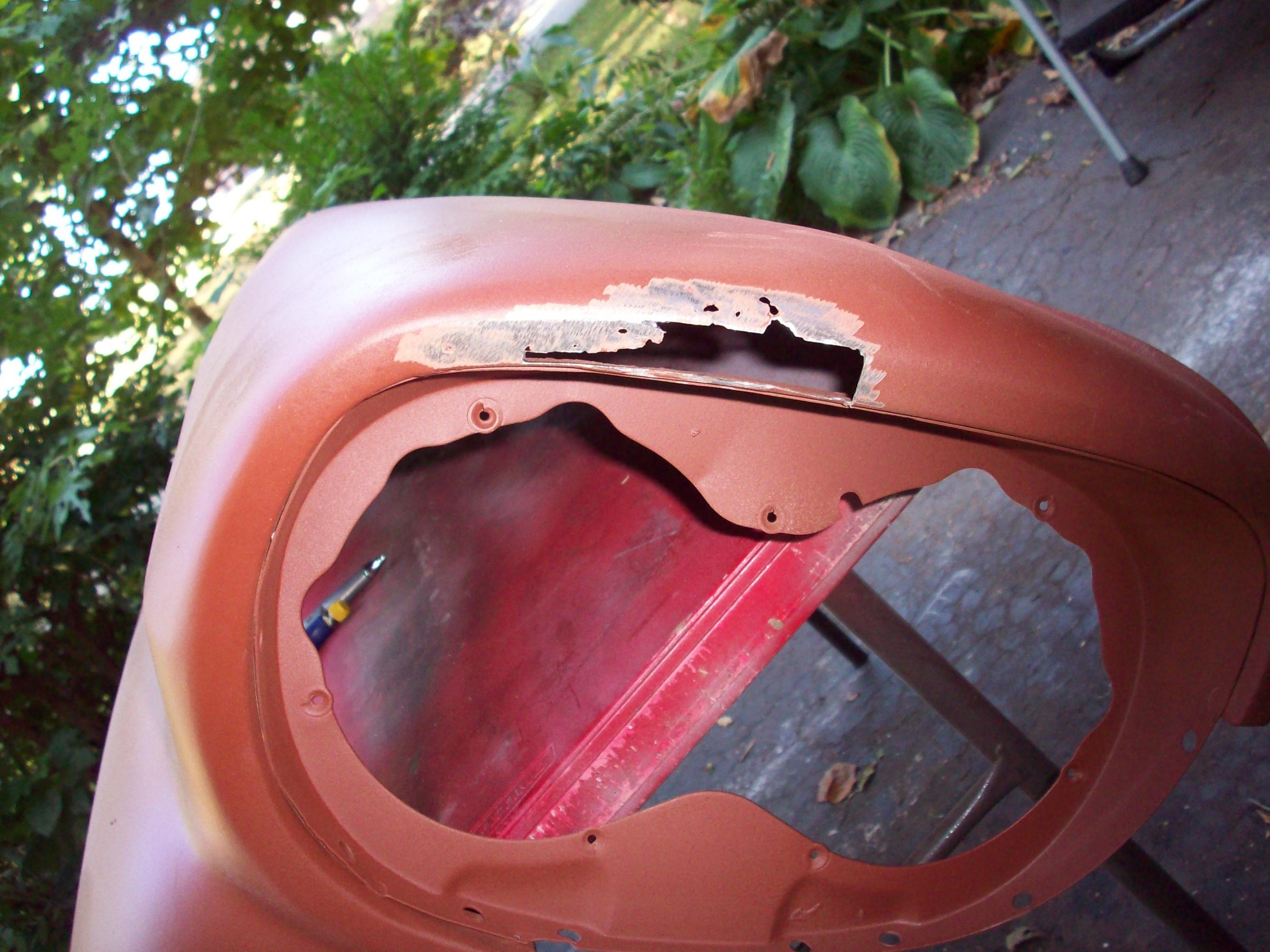

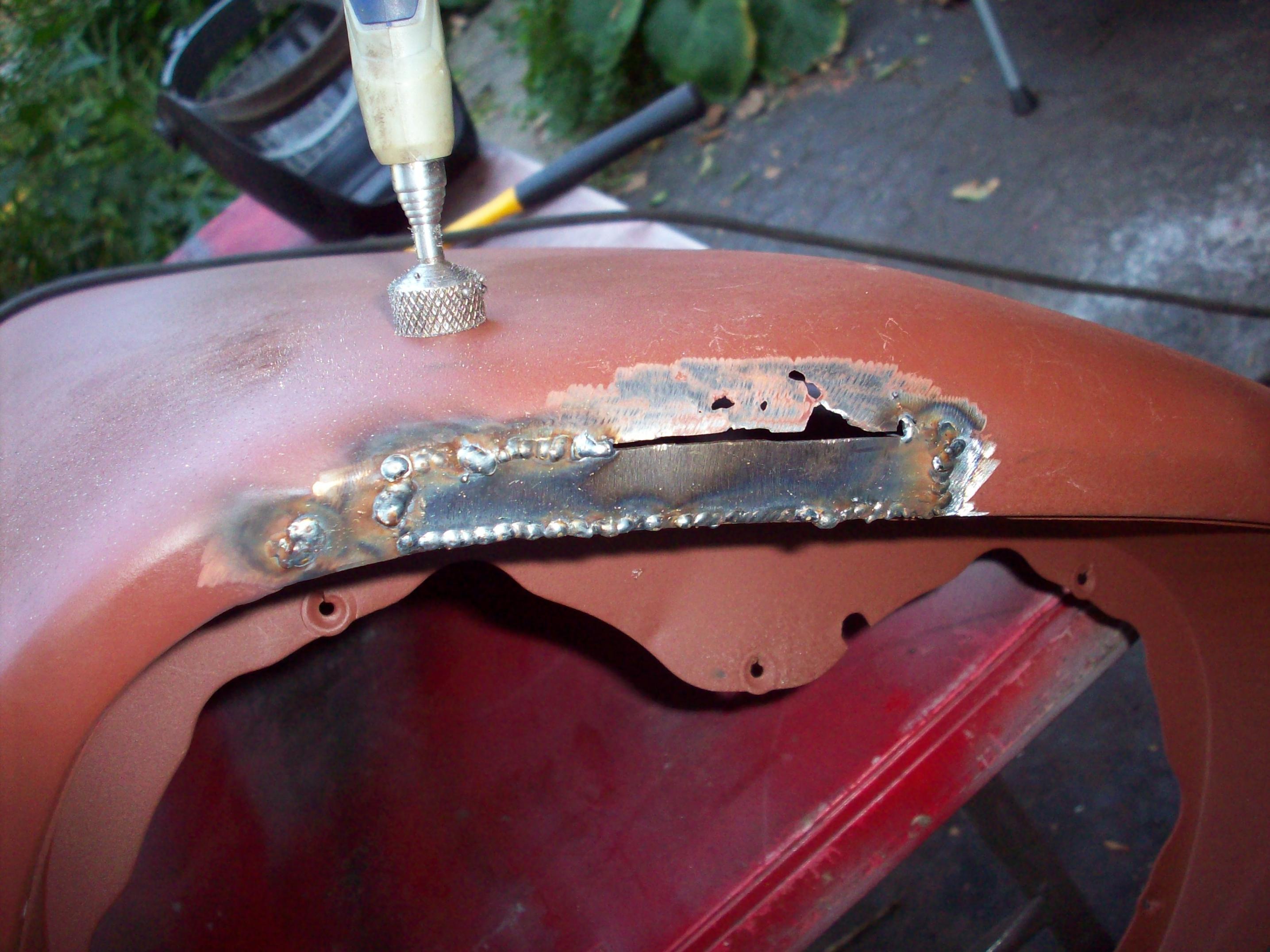

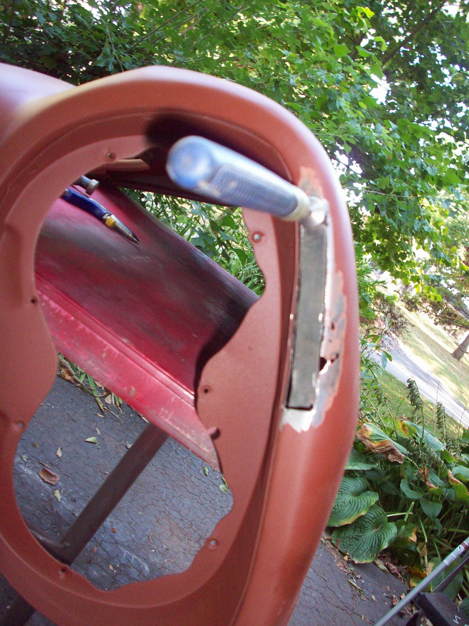

    I also did some work on the front p***enger fender. Here are those pictures.

    Done with the front of that one, now to work on grinding and fix the other rot hole opened up by blasting. :cool:

    I got the p***enger side half way done, tomorrow I will weld the nut on the back for the hinge and then I will try to get the inner front A-pillar in there and be doing something else these next couple days before my business trip for a week :(

    Here are some pictures of the finished A-pillar on the p***enger side. YAY!:D

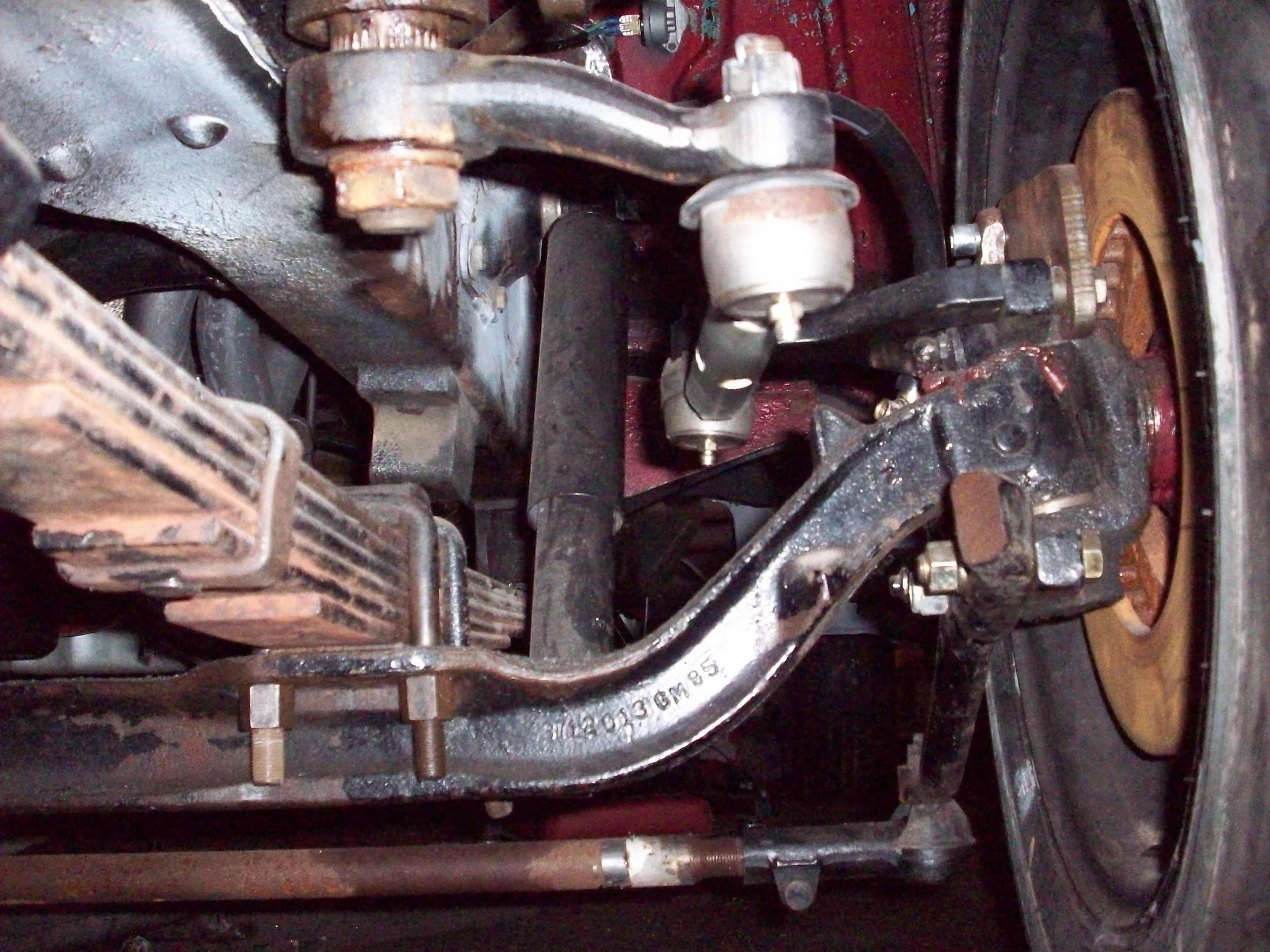

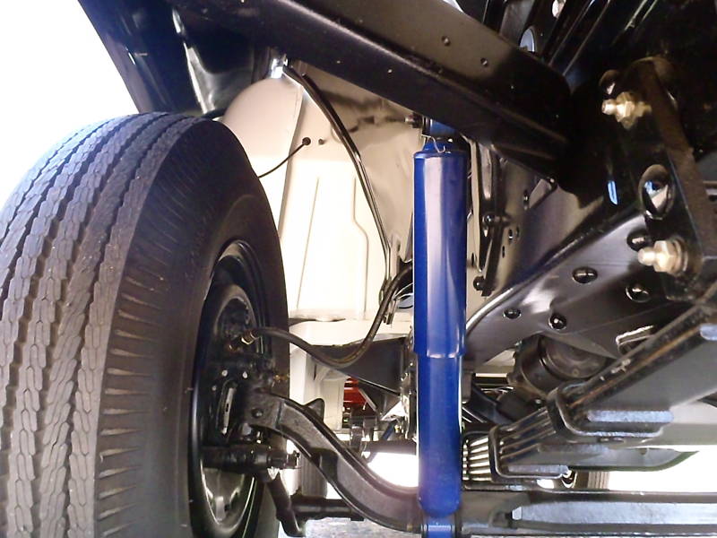

    Here are the other pictures of the front suspension for an old request. Let me know if this a drop axle.:rolleyes:

    Look like a stock drop to me - see pic below. This is on a bone stock Cameo. I have a spare axle at home I'll check too. :cool:

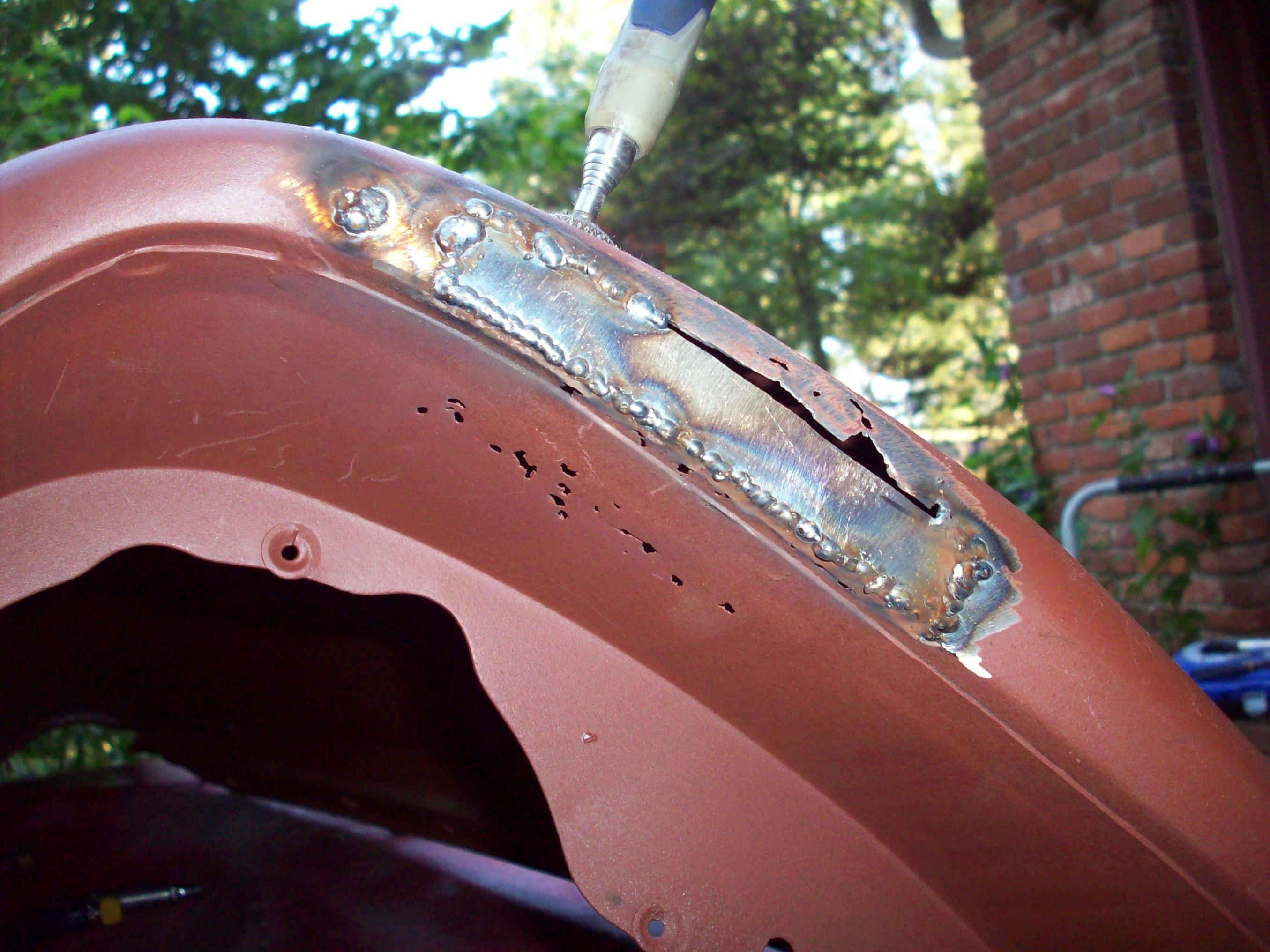

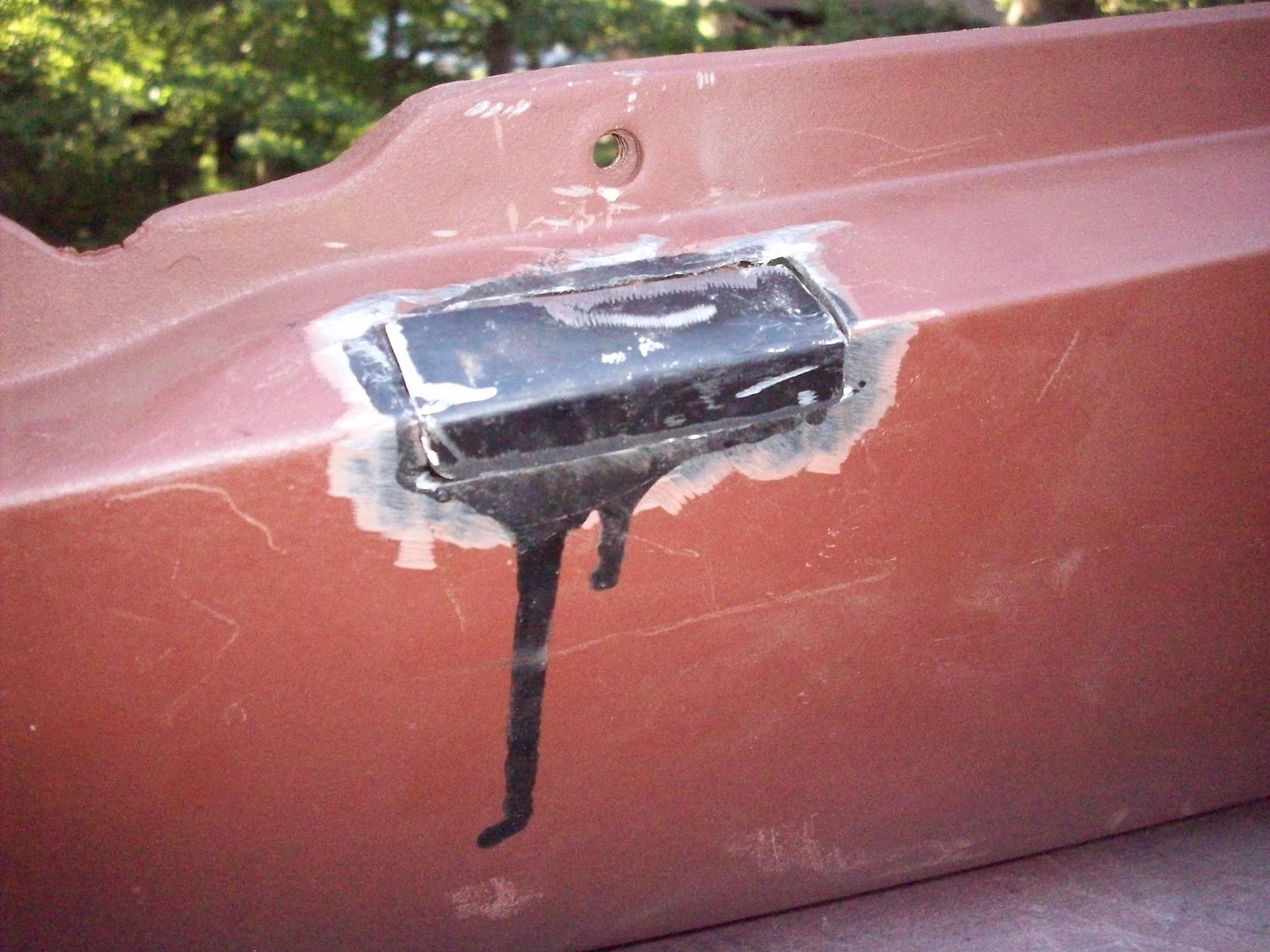

    Well I finished up the major patch on the p***enger side front fender. I also worked on the brake and gas pedal ***emblies and go them where they need to be. Next step is to get this pig down the road for the first road test for well over 30 years. I will be posting some pictures of that fairly soon as well!:cool:

    So I dropped the ****** pan and installed a new gasket... unfortunately this pan does not have a drain plug so later on down the road I will get a better quality pan that has what I need on it. This will do for now though. I also did a little patching on the p***enger front fender... not too much longer and I will get this front clip into some primer and back onto the truck! I am excited.. The days are getting shorter though so it looks like I will have to get my spotlight fixed.. hehe:D

    Is that the stock steering arm on the drivers side spindle? Thanks
