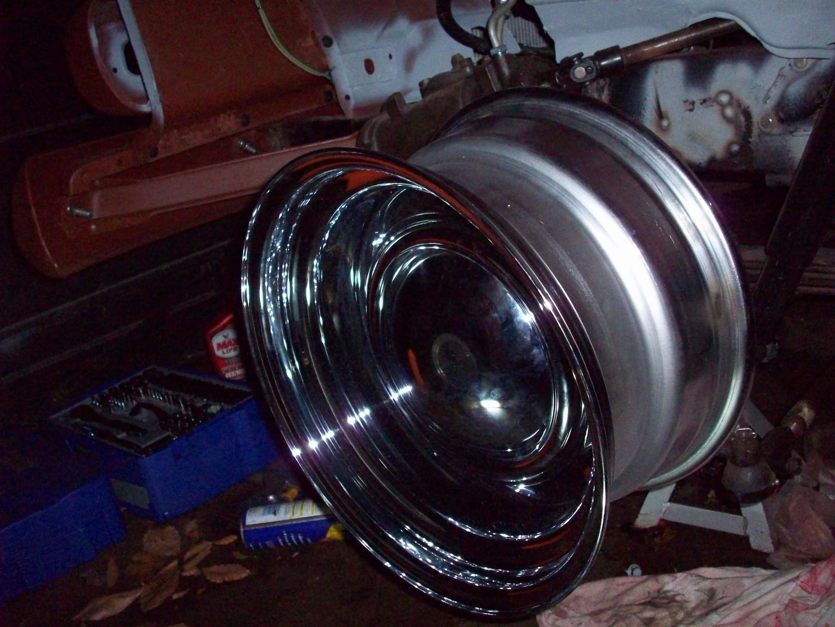

    1959apache

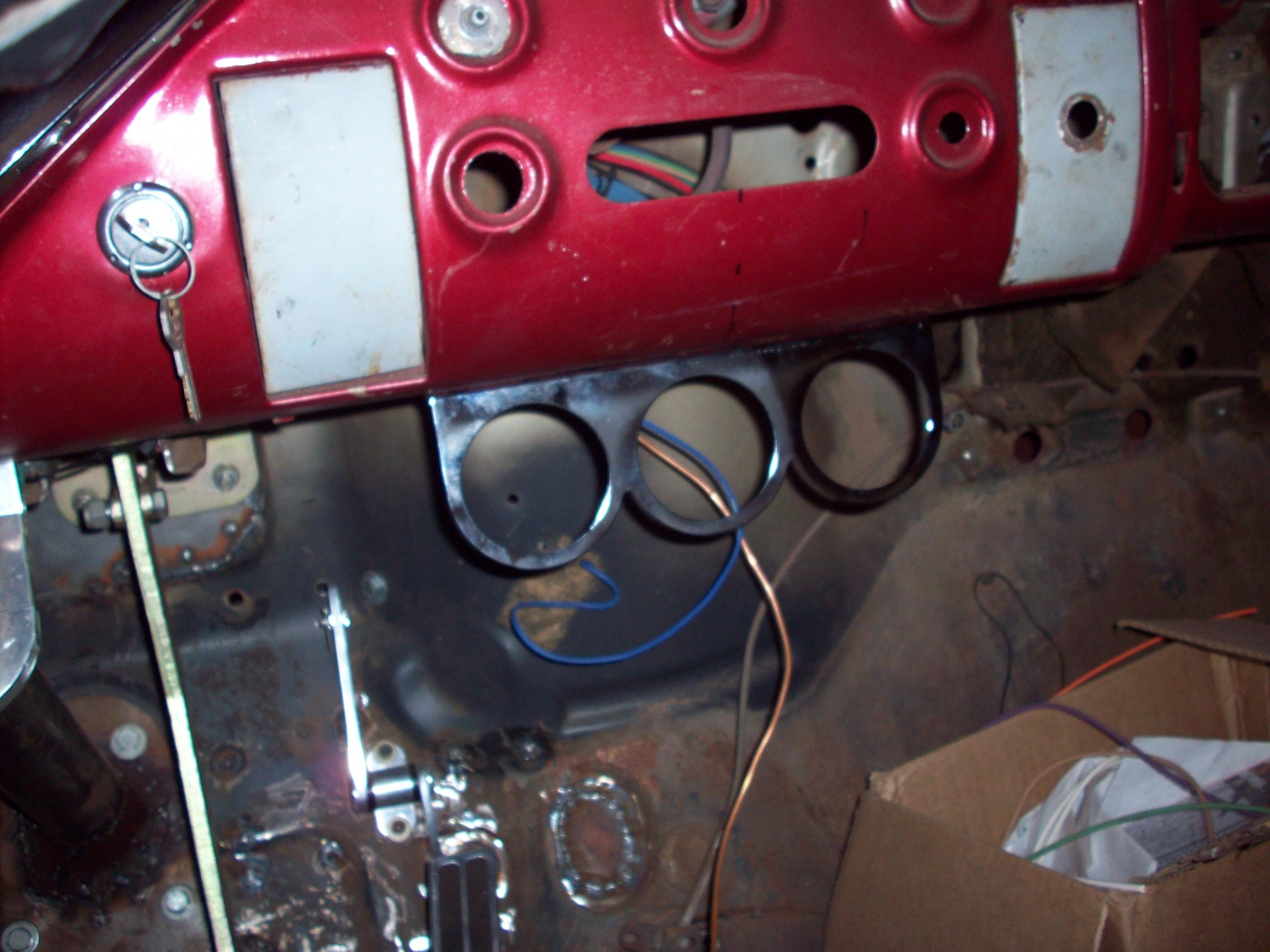

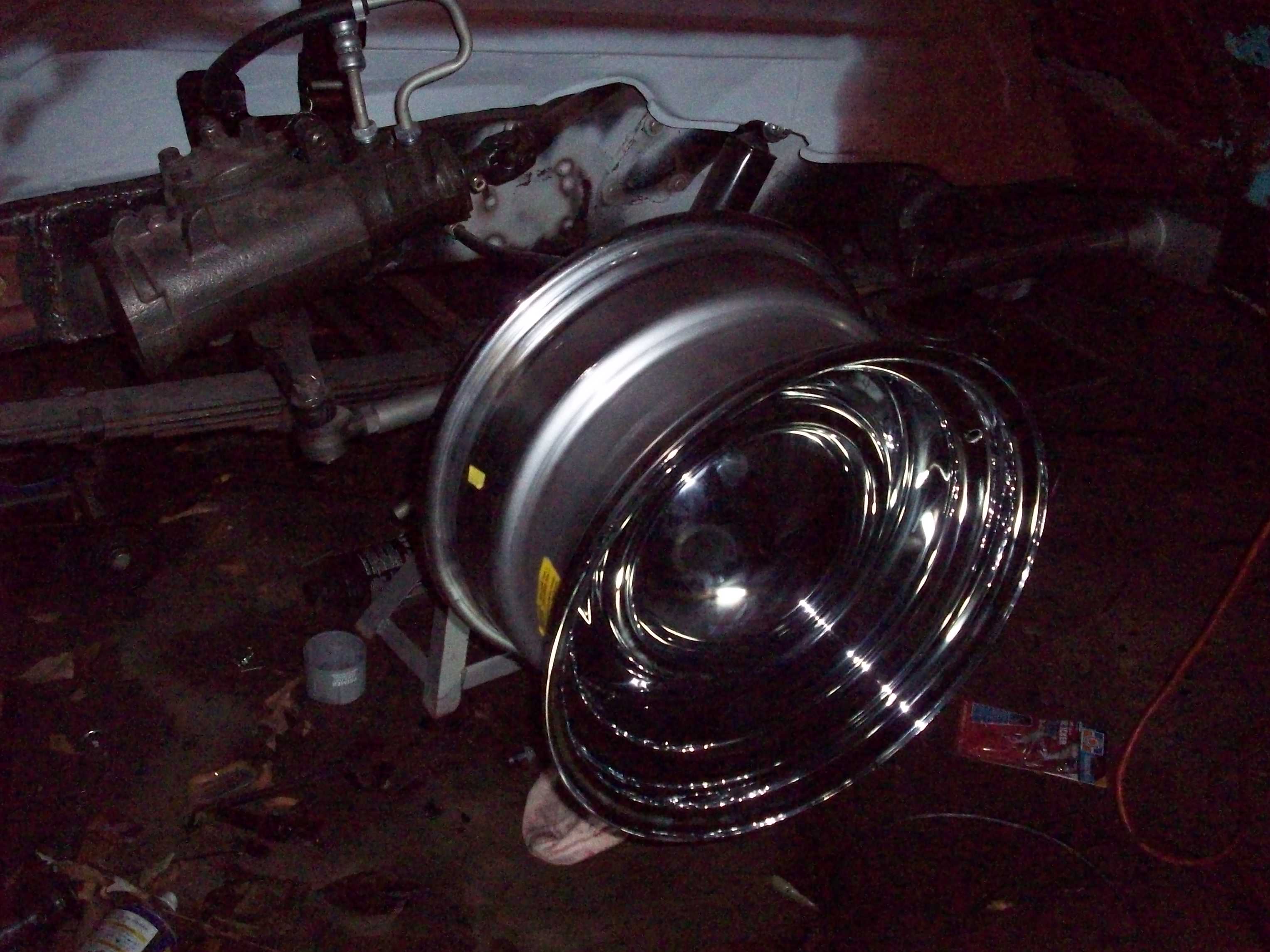

    So I got to test fit my new set of wheels... Fit like a charm.. So now I am going to put them away in a safe place that they wont get dented and wait to finish everything else up. I also drilled some of my holes to mount my gauge cluster. Its a good spot if I say so myself. I also picked up a set of tire dollies (the set that was used once for $50 bucks) since I never have room on one side of the truck or the other. So that will be nice to use. :cool: I still have to put the rear ones under the tires, but that is another day.. time for me to relax....:D

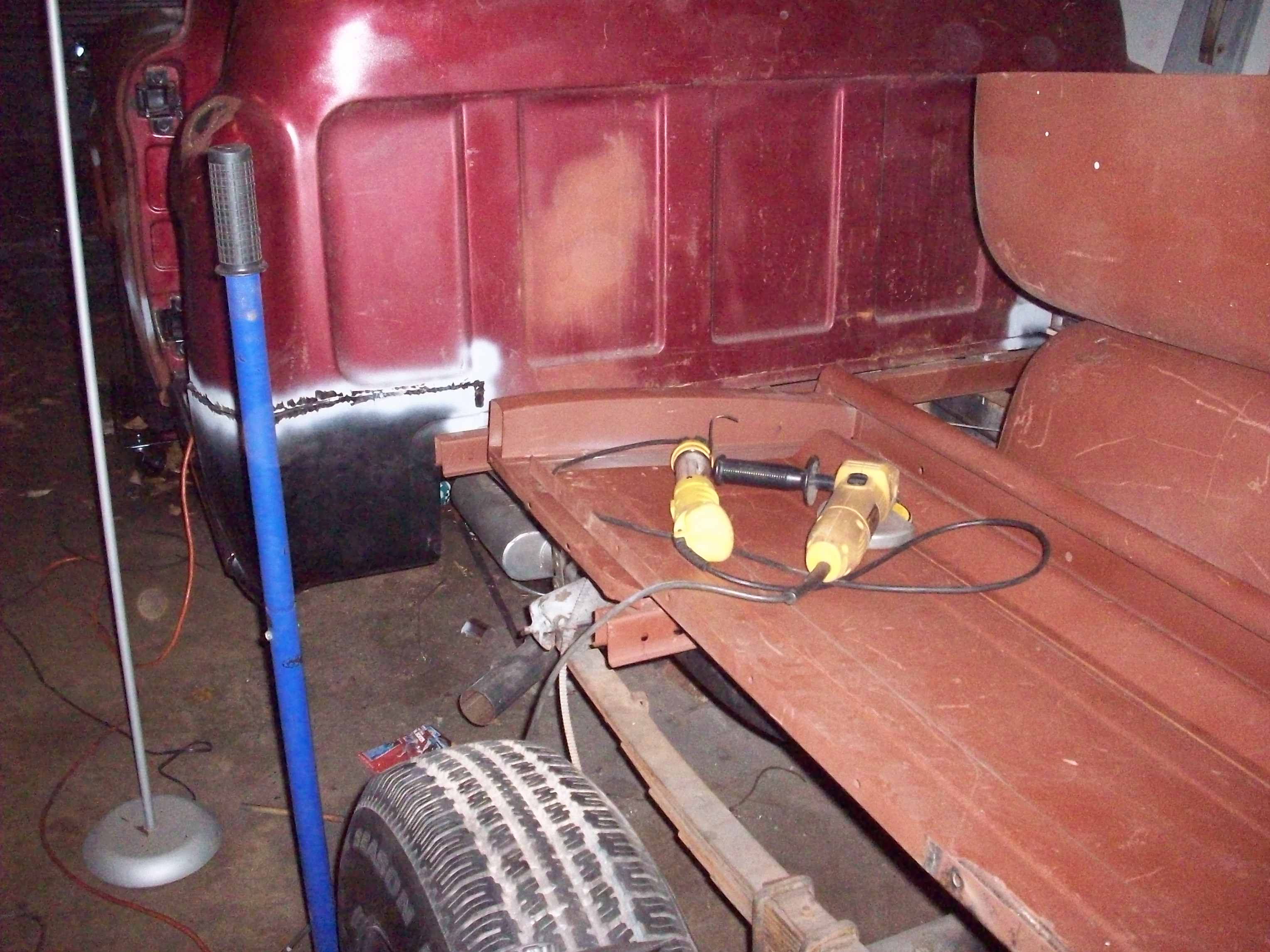

    1959apache

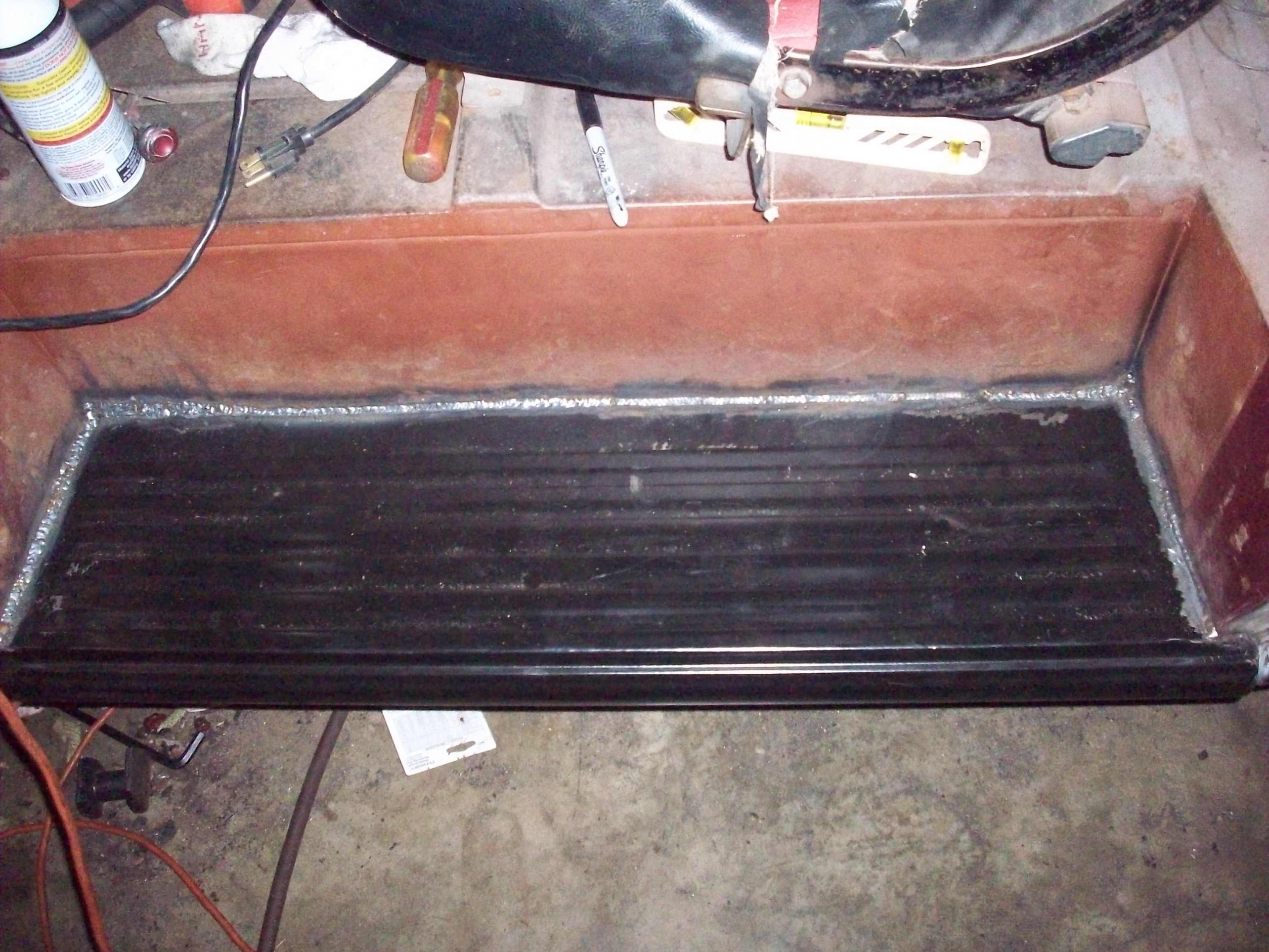

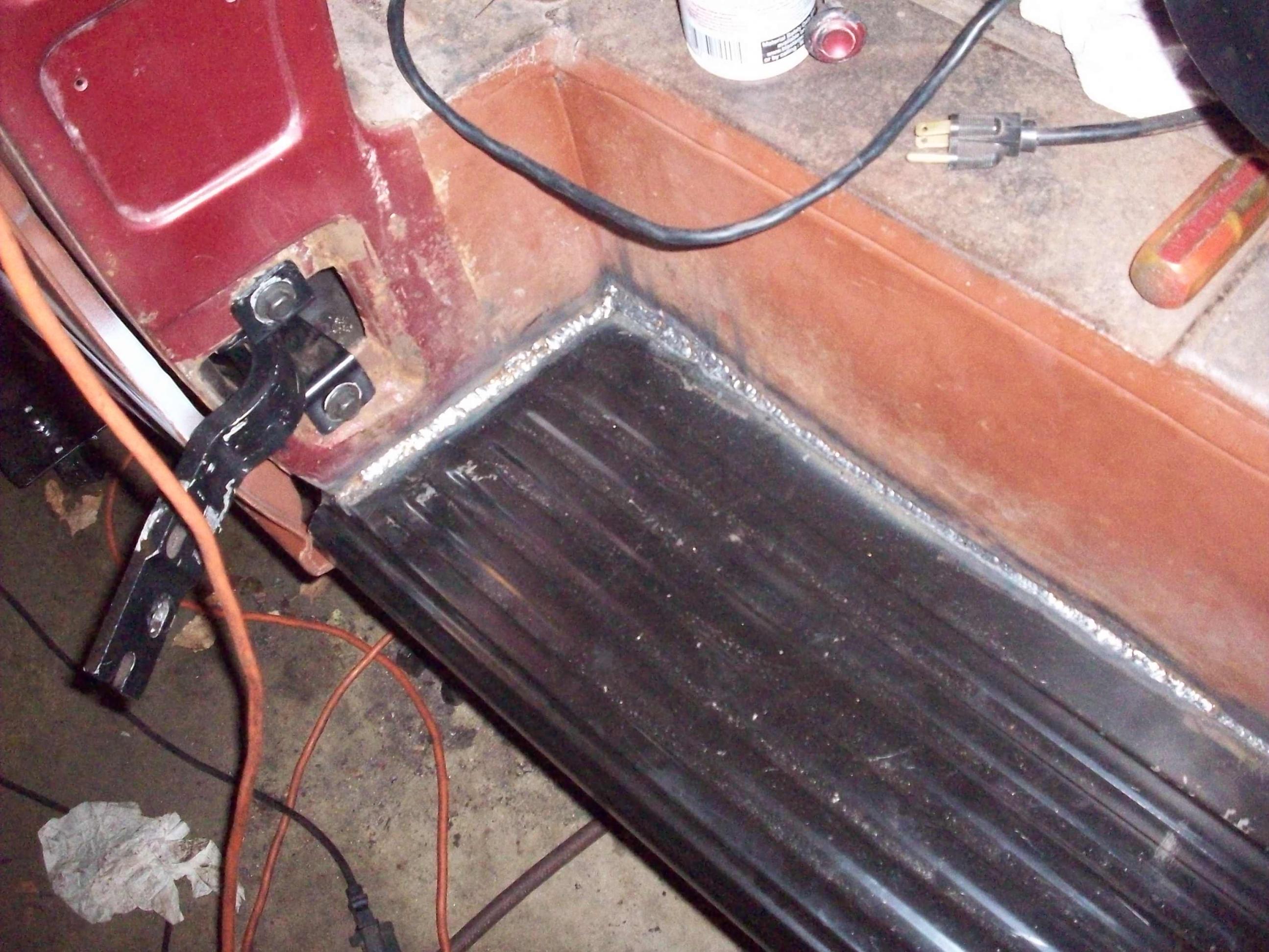

    I just got my welding gas.... thank you girlfriend for picking that up... So I got the step welded together and got the tab welded up on the front step so I could put the front fender on. So I did that and tried to connect everything, but I need to loosen up the front clip to get it together correctly. Here are some pictures :eek:

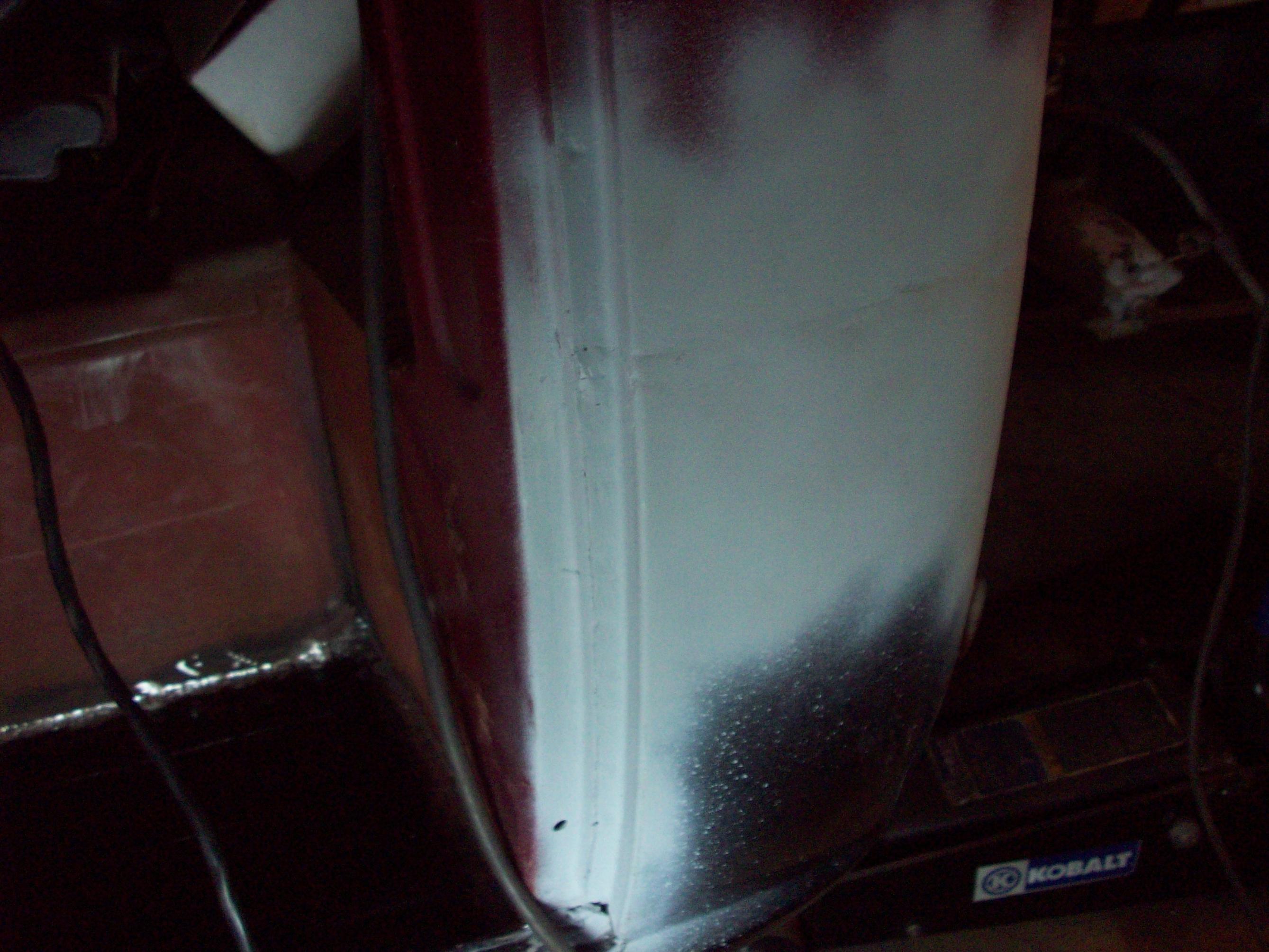

    Well I got a lot of little **** done today, but will be posting pictures tomorrow or sometime soon. I will get the front right fender on tomorrow I think. I had to do a lot of grinding on it and threw some primer on it. I also had to work on the grill and a couple other things. I am getting ready to take the bed back apart to do some metal work on that and to redo the cab corners because they look like **** and aren't right after I got the good step sheet metal in there... I will be posting pictures soon

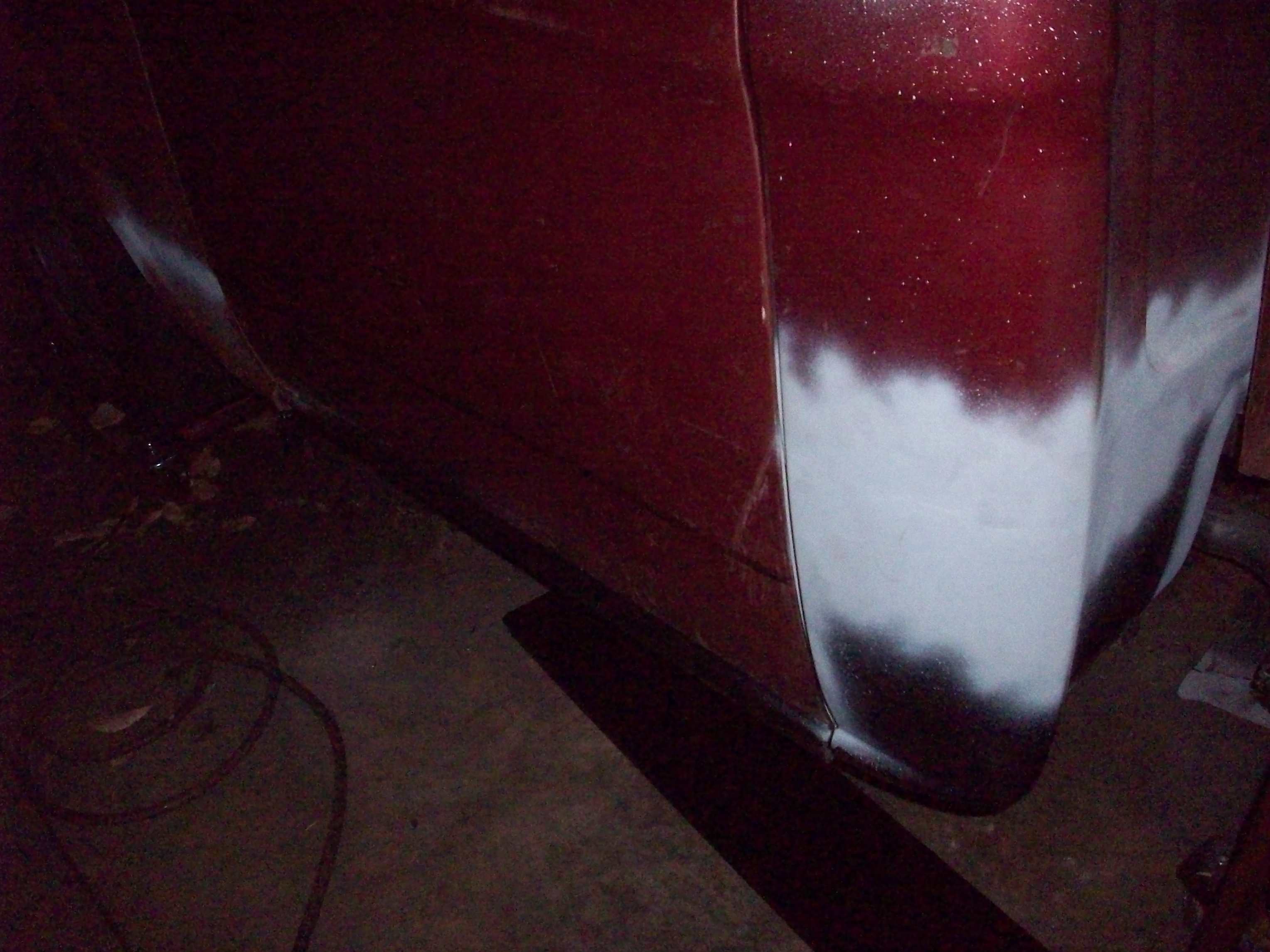

    1959apache
    Well it has been about 10 degrees out for a majority of this week so far, but that hasn't stopped me. I was out in the garage and had a little heater going and busted my hump for a couple hours (after an 11 hour day at work).

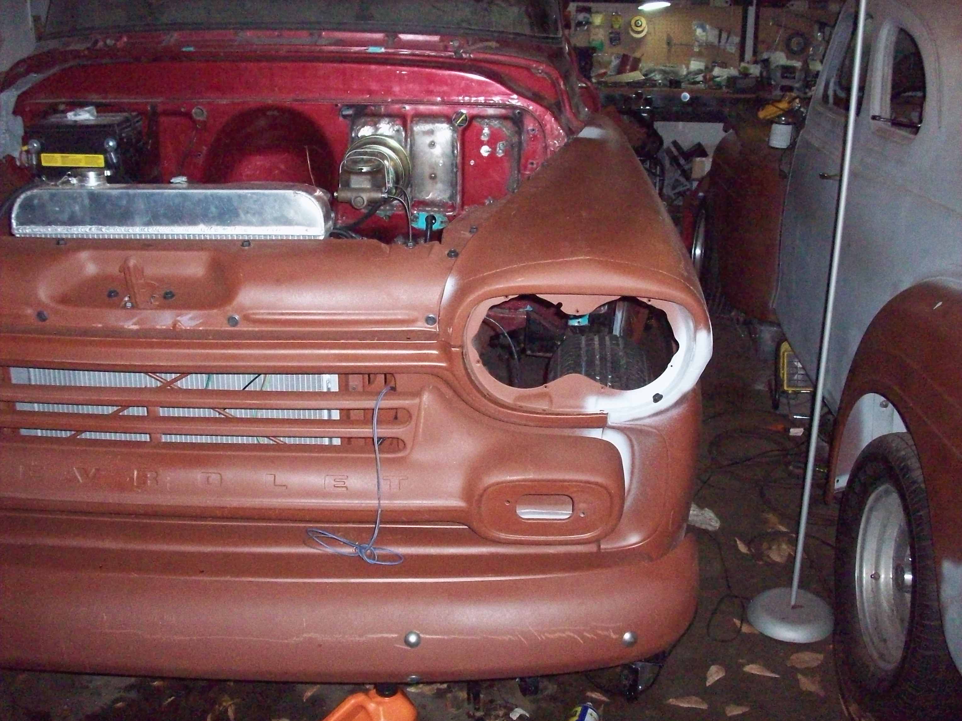

    I got the other fender test fitted and kinda bolted up. I will have to take it off here, unfortunately, because I have to fix the outer nut that is inside the wheel well for the top hinge and I will also have to weld the tab on the bottom of the truck for the bottom support bolt for the fender. I wanted to get it out of the way so I can work on a couple other things that were still bothering me about the cab corners and the step I just welded in...

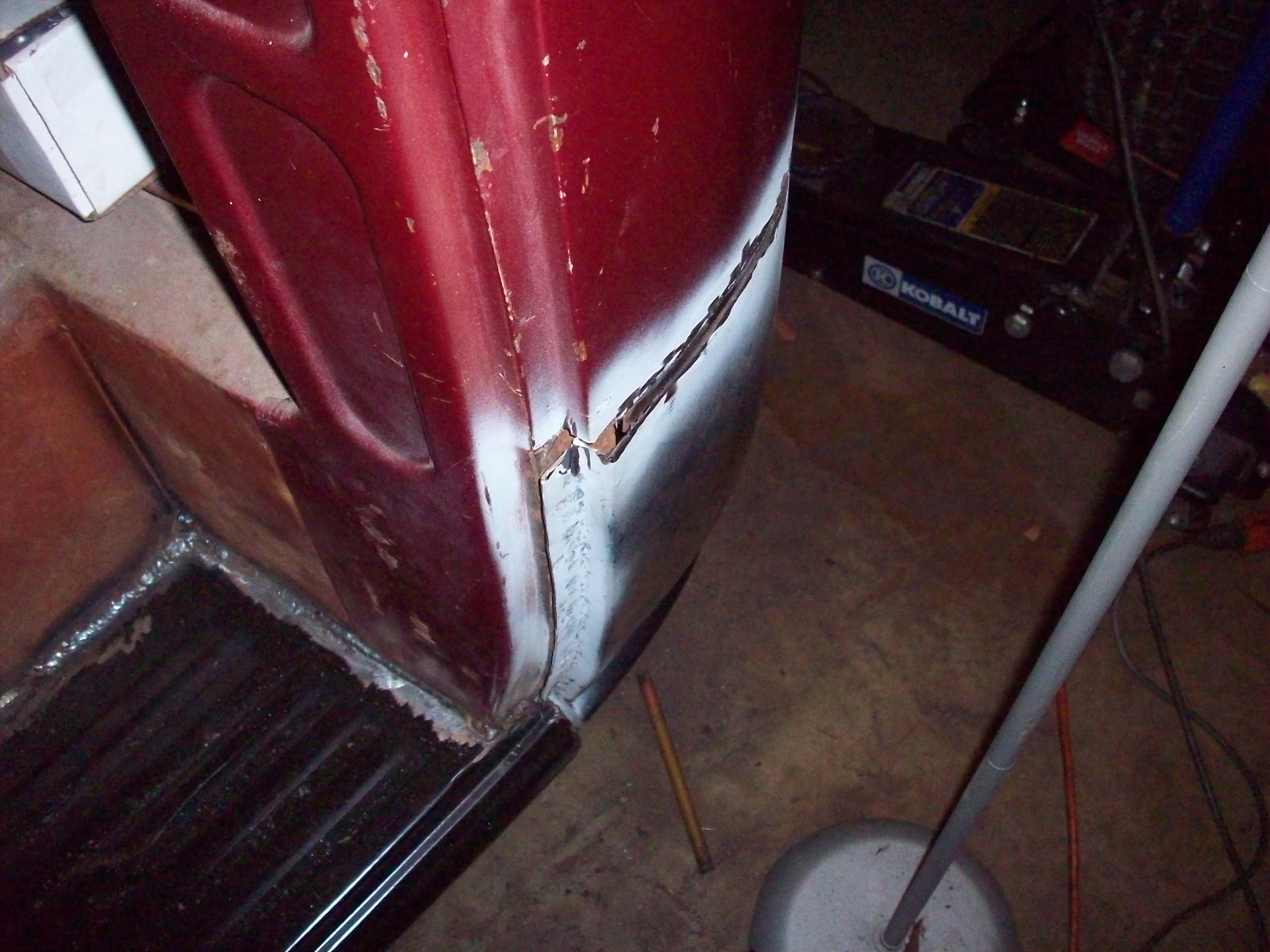

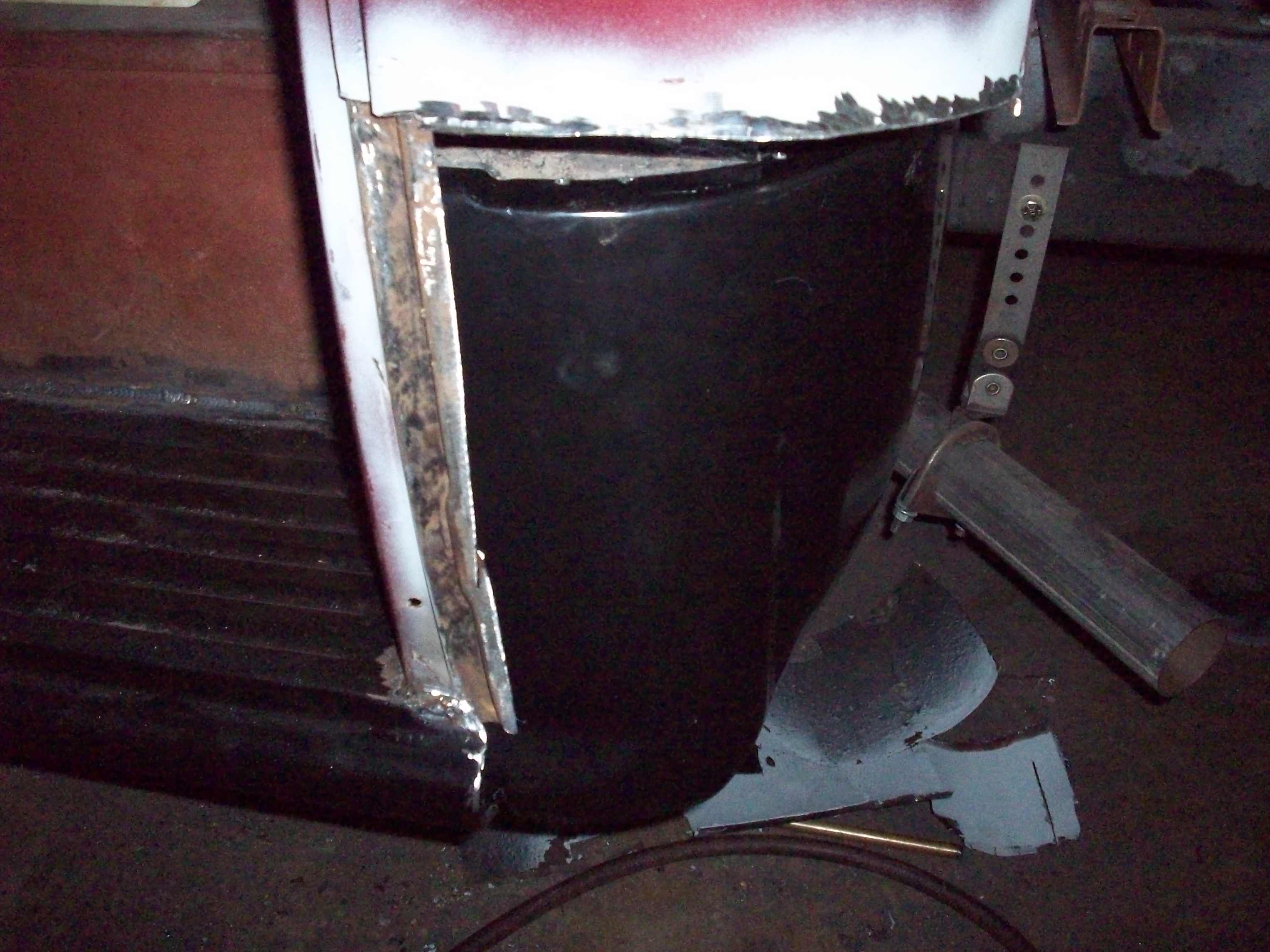

    After eyeballing the cab corner for a while with the new, not bent, step sheet metal I noticed that the cab corner did not line up correctly and that bothered the hell out of me so I have decided to grind my welds and **** weld it so it perfectly matches up the way I want it to... It may take a little more work and a lot more time because I should have done it the first time, but at least it will look nice when I am finished instead of the eyesore that it was. Here are a couple pics of my work. I feel like I am not making progress, but I guess it has to be done.

    1959apache

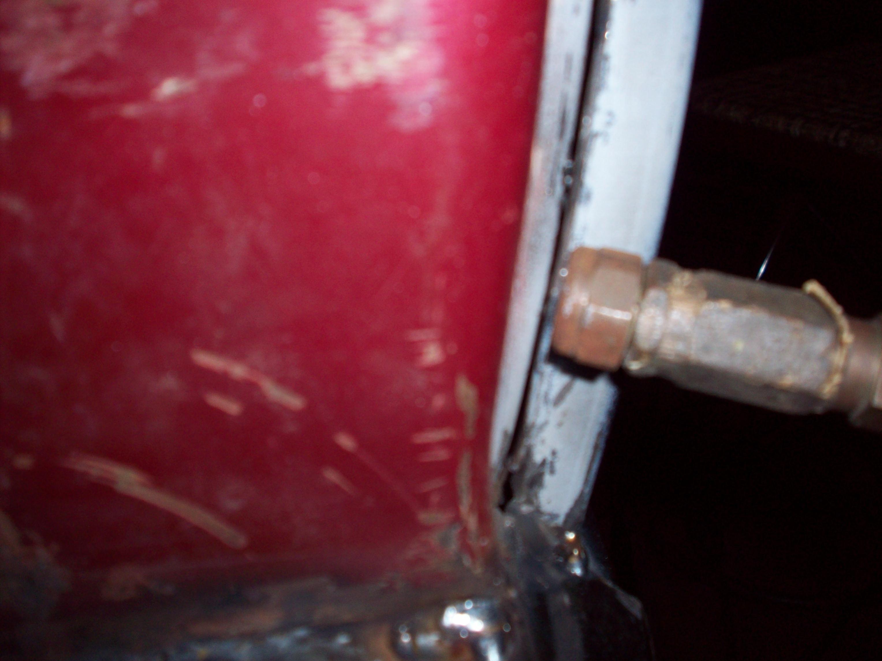

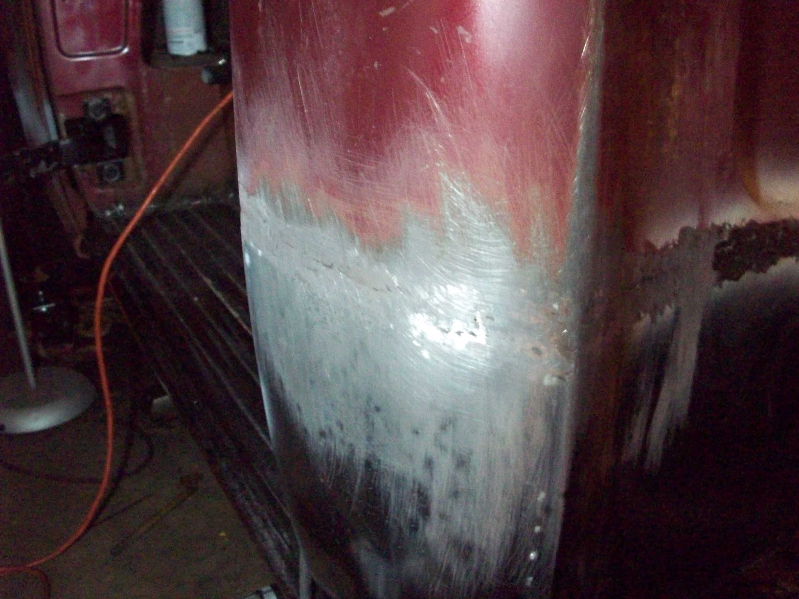

    you can look really closely at these things and can see that they dont line up with the door jamb and actually are about 1/8th an inch shifted outward at the bottom of the cab corner... man that would have ****ed to try to tweak it once it was ready for paint.... but here it is.....:(

    Well I got the cab corner removed so I can tweak it and am doing a lot of bending to get it looking right... what a pain. I also cut out the old inner cab corner and test fit it to see where it sits. I have to a lot of tweaking to get that inner cab corner right. So tomorrow I will go ahead and maybe weld the inner cab corner in and everything should be good to go.:D

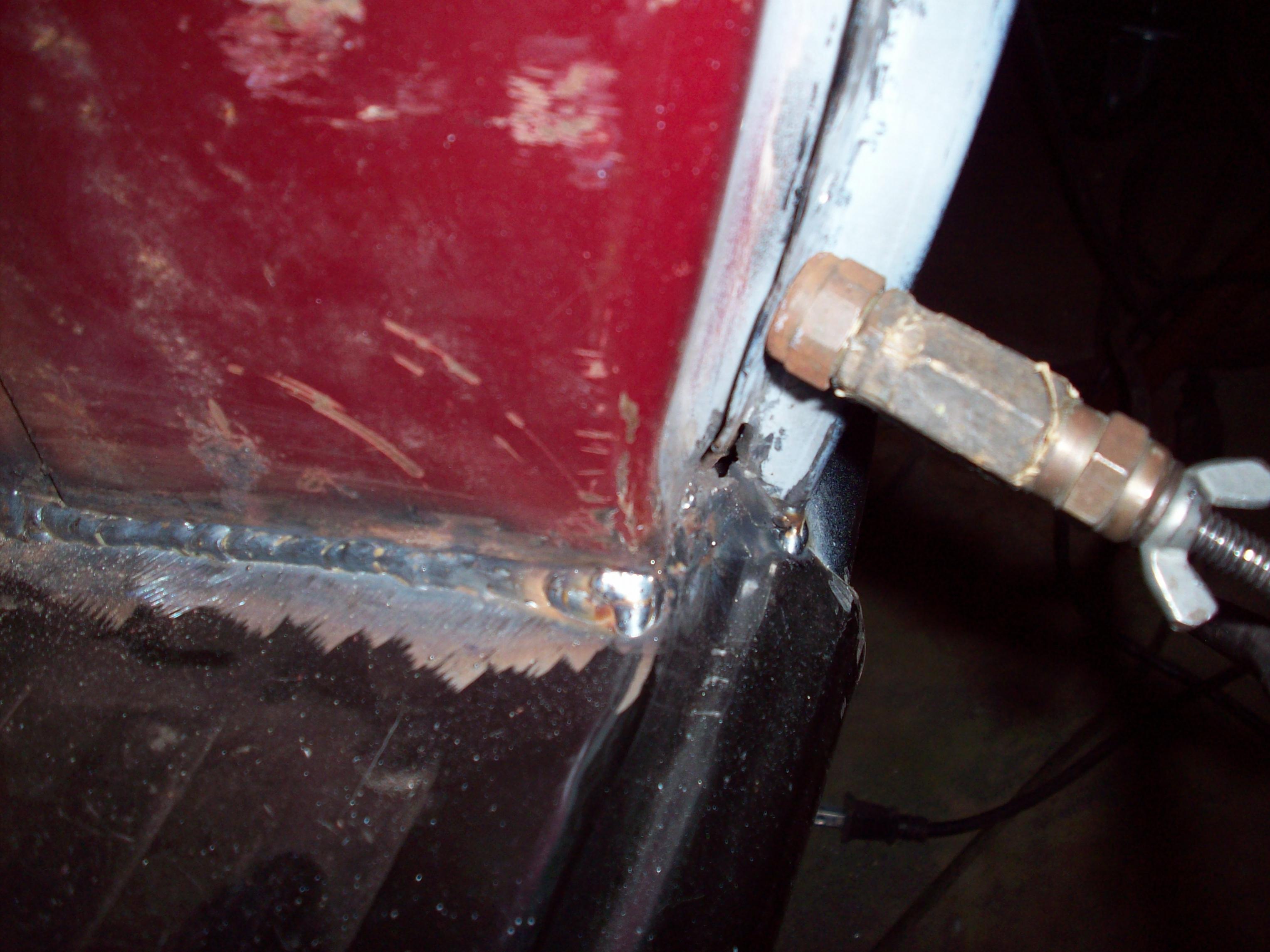

    Well I am still working on the cab corner trying to get it just right. Of course they are not perfect and are needing a lot of metal work to finish. I have the inner cab corner partially tacked in and the outer cab tacked in from the door frame back about halfway to the point of the cab corner... I have a lot of tweaking to do to get it right so I will try to at least get it together this weekend so I can throw the door back on there, which will be nice to get that off the floor. I will try to post some pictures this weekend and have it ready to go.

    here are the pictures that I promised. It is as good as I can get it, so It will just have to do. I think its close enough that I don't have to worry about it. :cool:. There are some UGGGGLY welds going on, but keep in mind that I had to use both knees, a cleco, my welding elbow, my other hand, and a shoulder to get it where it is now. Lordy... it took a while (about 4 hours). I had to weld and cut like 3 or 4 times before I got it where I liked it. :eek:

    Well I have the cab corner and the tank filler hole pretty close to finished or at least as close as I can get it without doing a million things to get it perfect. Here are some pictures.. Now I have to weld up the inner cab corner and attach it to the outer cab corner and this part of the project is complete. YAY!:D

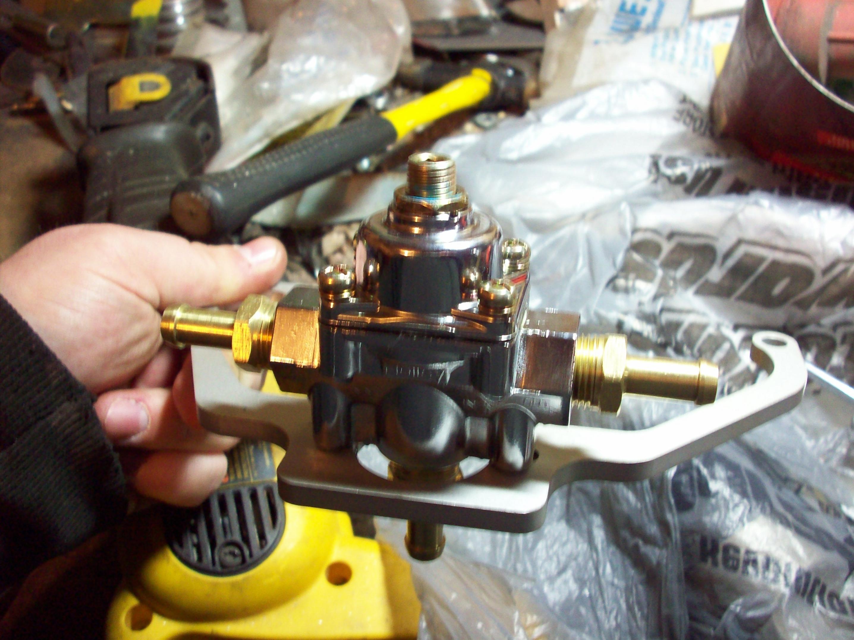

    Thanks dude, its getting there. I think I am going to name this pickup the most cliche name ever.. Geronimo..
    I actually had to install a fuel pressure regulator on this bad boy because my psi was jumping from 7-13 psi because of the cam. So I will post some pictures of it installed tomorrow (worked on it for 4 hours tonight after a 14 hour work day).. the Holleys, from what I am told only should run between 4-6 psi.

    After my week long waiting period for all of my parts for this regulator (bracket and the regulator itself) and After my 2 day hunt for a set of self tapping screws I finally gave up and just modified my bracket with a dremel tool to accept the original screws from Holley. Those *******s really made me work for it on this one... I already installed it and started it up... runs a hell of a lot better... Now I have to tune it in and adjust the psi... I think I have it going around 4... We will see though. :D
    Ill post pictures of the install shortly.

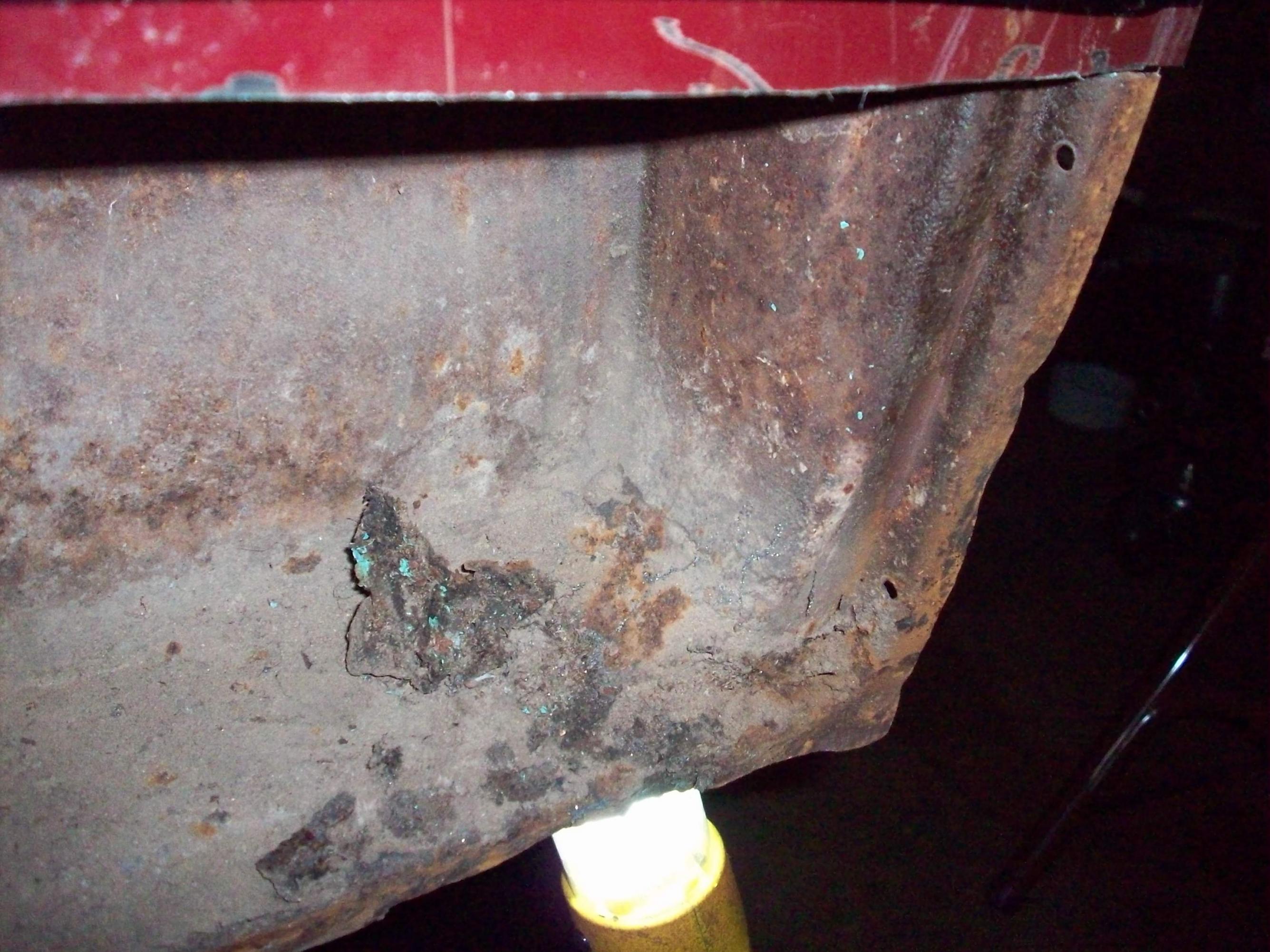

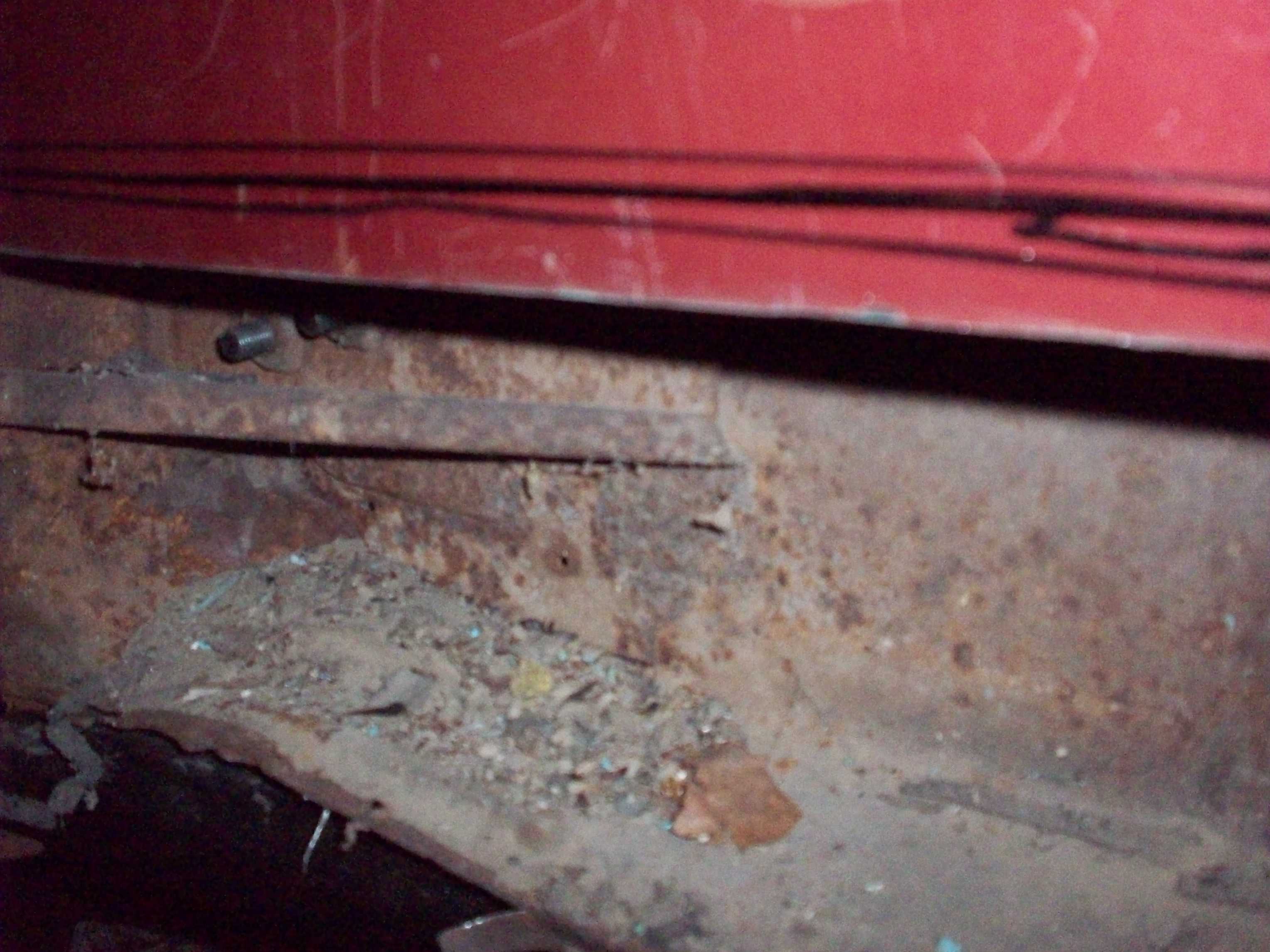

    Well I got the door skin off tonight... EEEEEgad it was nasty.. I am still coughing **** up from the dust flying... :( I need to clean out my masks and start using them again....
    Anyways, when I got it off.. go figure.. it was worse than I thought. Good thing I decided to because I found a can that has been in there since the mid to late 70's that was rattling around. (it was carpet cleaner, but this truck never had any carpet...) and I always thought it was the window rattling back and forth in the tracks... :p So I will have to replace the bottom edge of the door as well since I can poke through it with a screw driver...
    YAY more work..

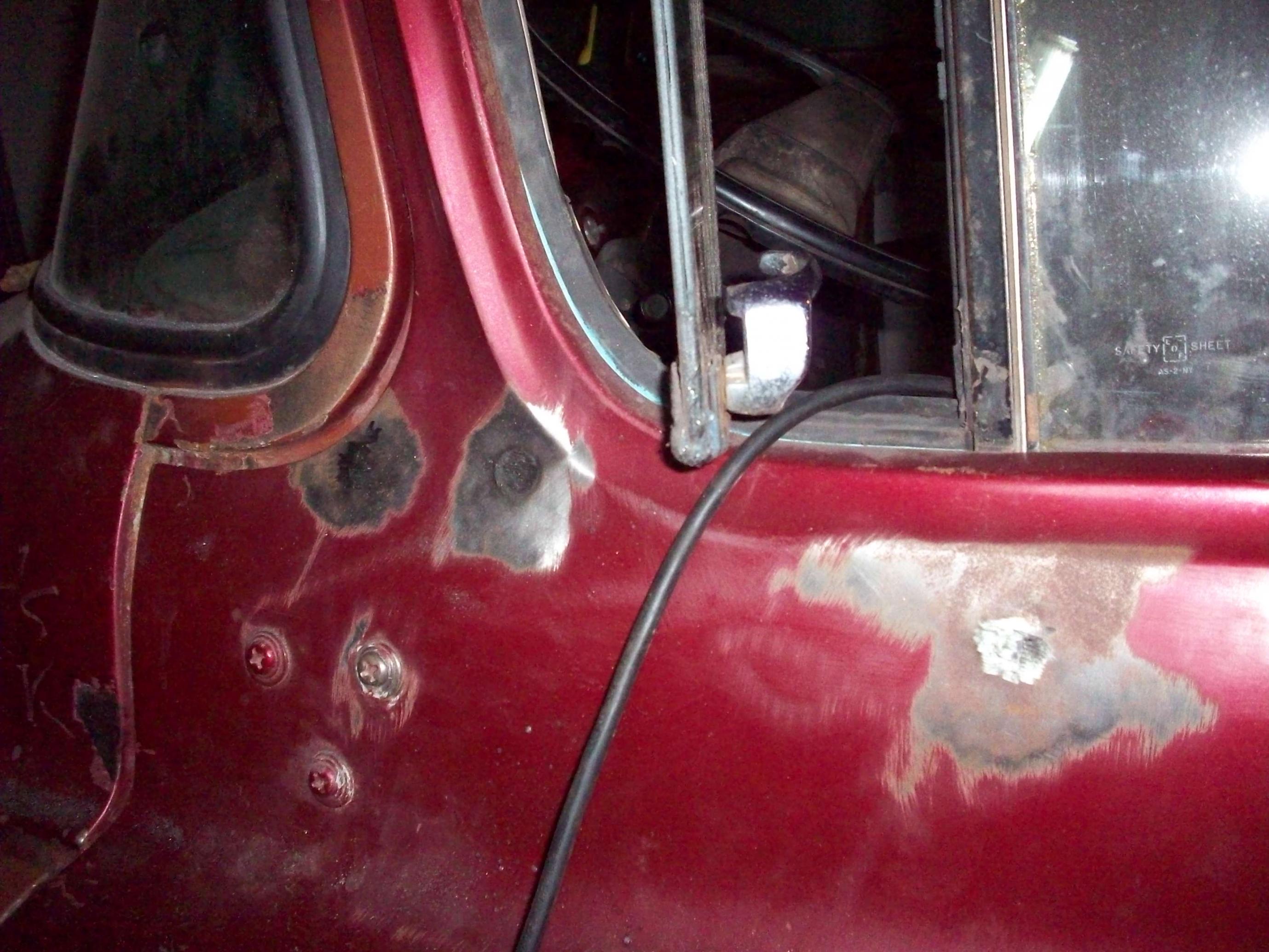

    1959apache
    Well I found out why the truck door would drop about an inch when the door was opened, even after rebuilding the hinges; the bottom hinge bolts on the door were all broken and cracked around each nut and the door would flex when opened. I welded everything up and reinforced the cracks with some more welding. I ground everything down and it should work just fine. I also trimmed the door the rest of the way for my patch panel, straightened out the bottom lip on the inner door all the way around, and patched the lip as well. More pictures to come.
