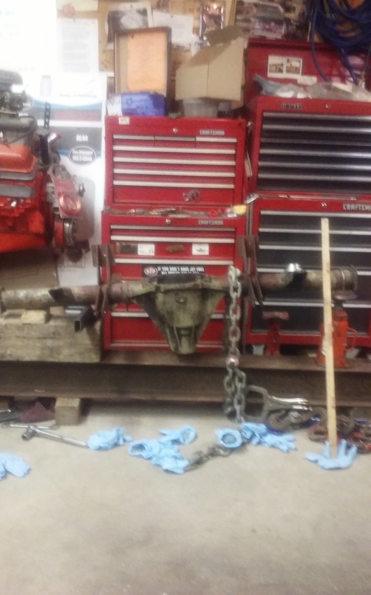

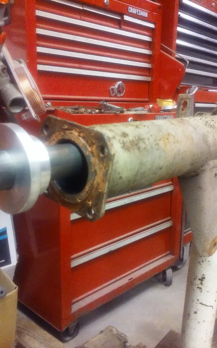

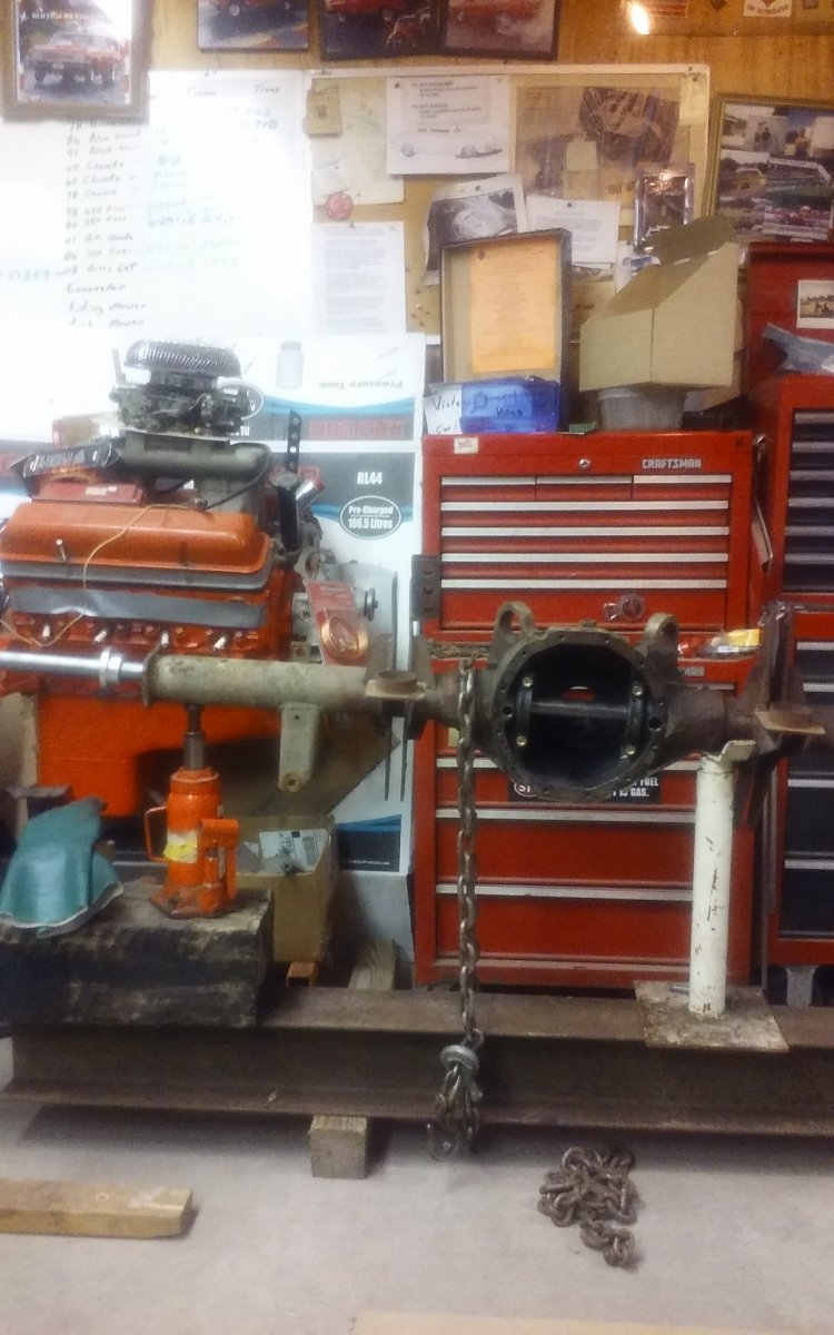

    Dont know? Harlan built it when he cut up the car, That and the cost of changing it is why I would like to save it.
    From what I was told he built this before 4 links were aftermarket. Dont know for sure?
    I didnt check it when putting new axles in around 2005, ( but I know it was not this bad ) would had
    fixed and braced then. :oops: I remember axles went in and out easy.
    Bob
    Going to brace it after straightening,
    I will say a prayer before starting to tweak it back
    Norb

    Norb make sure you don't tie that 12 bolt into a knot when you weld the brace on.
    You may want to look into some thicker axle tubes.

    Dont try My I beam axle set up as pictured at home. :eek:
    My 8 ton just jack s...t out and flew out 6 ft ( all most hit Sugar Mamas Chevy Cruise) :oops:
    Taking a break
    Going to move the car and think about a new set up. ;)

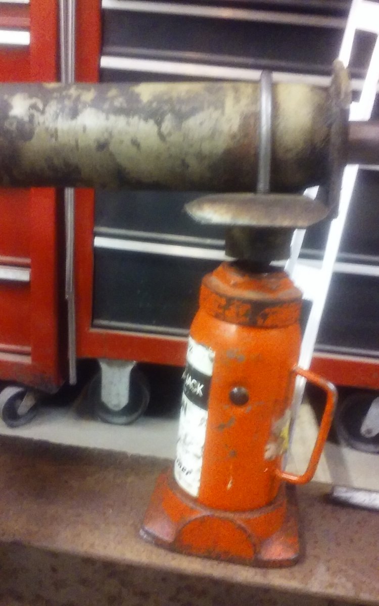

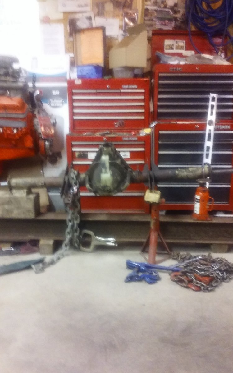

    Made some changes. ;)
    Lowered the set up. Changed chain location to other side of housing (for more leverage)
    Sawed the pad end off an junk trailer jack, leaving about 2 inch of tube on it so it wont slide off the jack. :oops:
    Then drilled the pad side for a 3 inch muffler clamp to strap it to the tube.;)
    Got bigger log chain ( 1/2 inch link )
    Soooo far got the p*** side back about 1/8, got to start measuring the jack height v/s movement so I dont go too far.
    Trial and error process :rolleyes:
    Lots of pucker factor going on pumping the jack, :D

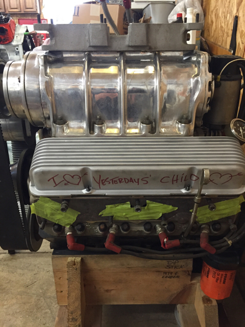

    Thanks for the valve covers Ric... They fit great! ImageUploadedByH.A.M.B.1450561032.041583.jpg

    You should hold a telethon for that poor motor,Jeff....That little fella is sporting an iron lung!
    Come on folks!Our operators are waiting!Your generous pledge of $5,$10,$20,or even $100 could help get Timmy the Wonder Mouse out of that iron lung,and into a long term facility for the horsepower-impaired!
    Let's light up those phone lines,and give little Timmy the quality of life he so desperately needs!

  13. That's great!.. but.., uh.., the notches in the gasket rail, are for intake manifold clearance. Ergo, there on upside down! Guess I should've drawn instructions on them too.

    I preferred the art on the side shown... You had quite a bit of misspelled words on the other side.

    Dont try this Branch Boy Farmer engineering at home with out adult supervision like I did. :rolleyes: 12 bolt 11.jpg 12 bolt 9.jpg 12 bolt 10.jpg 12 bolt 10.jpg 12 bolt `13.jpg

    That looks about as close as can be.
    Nice work Buddy!:)

    Now have to brace, going to check out the one Ric recommended also want to brace from the bottom.;)

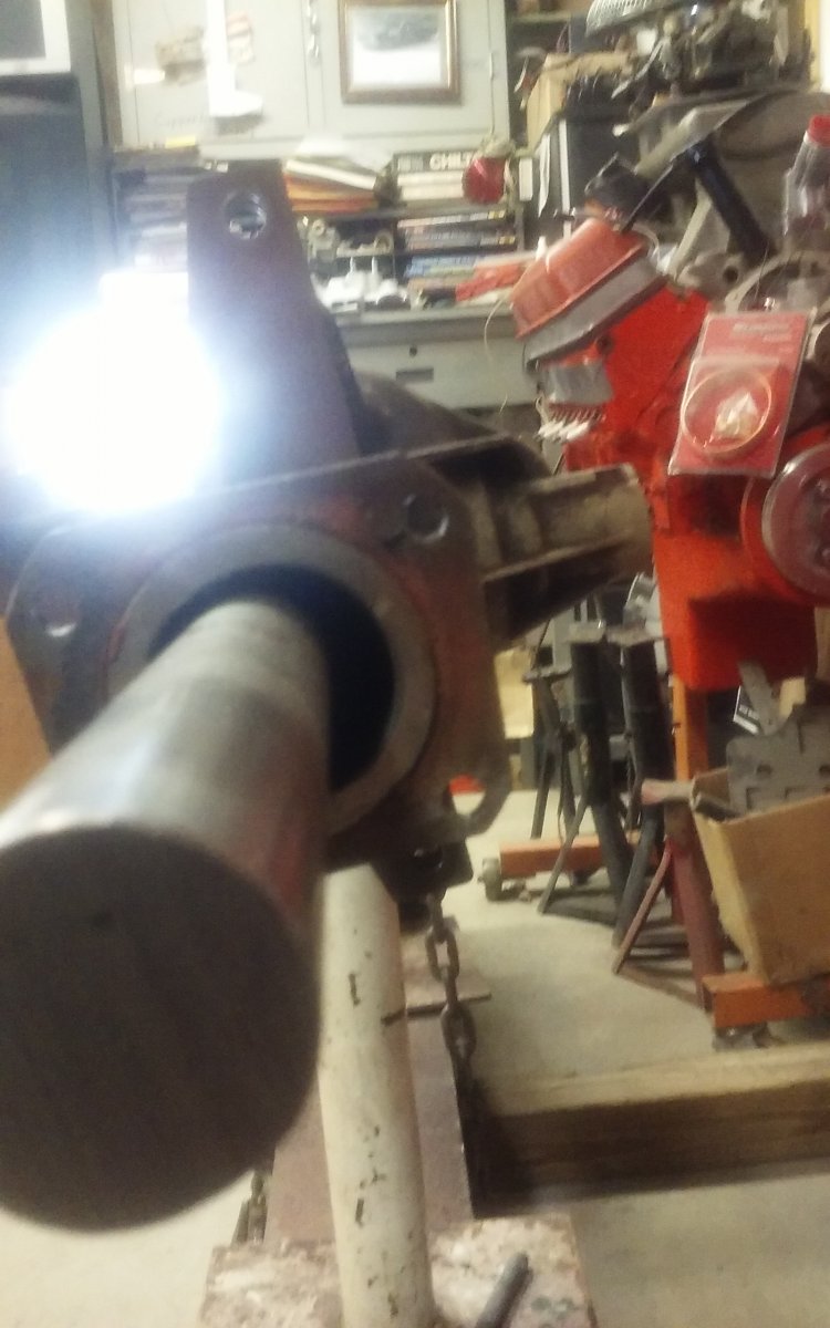

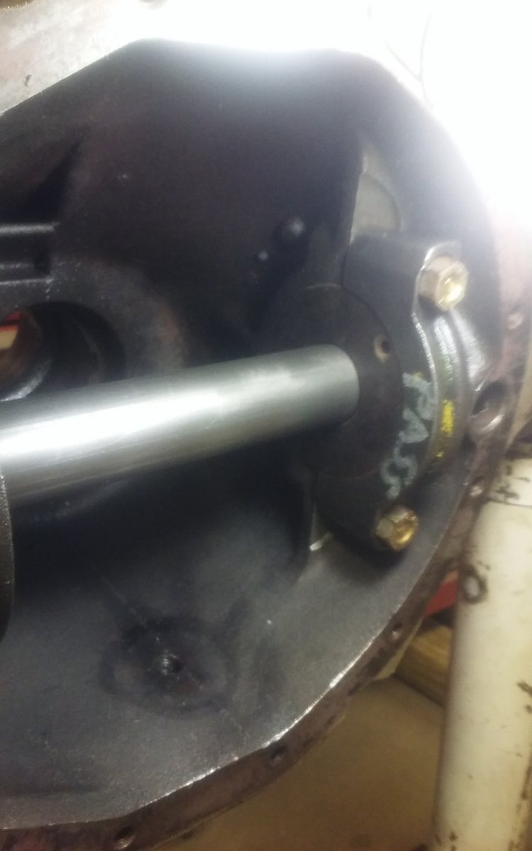

    Norb, if you take the pressure off the bottle jacks see how far the tubes come or flex back? The way my friend Don explained to me is once metal is bent it has a memory, that you'll have to keep pushing the tube till you can let pressure off jacks & that cold rolled bar is in the middle like in pic with zero pressure from bottle jacks. But you want to go in baby steps & not bend tubes other way if you go too far... Don builds Mud Bog Drag Ch***is here's a pic ImageUploadedByH.A.M.B.1450577058.765404.jpg

    Yup, thats how I did it. (last pics are with no pressure from bottle jack)
    Had to bend way over center , after trial and error found this worked best.o_O
    Bent axle tube to opposite side of cold rolled bar , then slide back cold rolled bar and bend about 1 inch more. :eek:
    The tube would spring back almost center. ;) Oh Ya dont forget to say a prayer first. :)
    Now need to brace back and bottom to prevent tubing from springing back again under power.
    Dog_Patch and powrshftr like this.

    It was binding bad, hard to turn at the driveshaft ( thats why I pulled it apart)

    The full spool and axle splines look good but now going to look real close for cracks in spool. the only thing stopping
    more movement had to be axles.
    No vibrations or anything, but 60 ft was down ( I thought the motor didnt like the new carb.)
