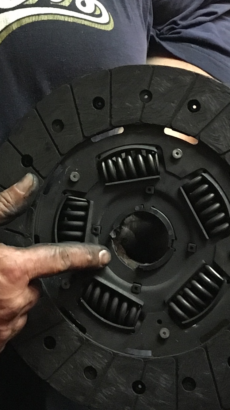

    Well Norb Jinxed me, he said I was the only Ford that didn't break... As luck would have it, Murphy didn't strike till Sunday on my first p***... Aim was to get into 13's, so I figured what the heck & got aggressive on burnout, launch & shifting... Slammed 3 gear & pegged the tach... Coasted across finish line & got her off the track. Motor still ran, but had nothing when I tried to put in gear... Thought I broke trans or blew clutch... Took it apart after work Monday & broke the center of clutch disk out of her! [​IMG][​IMG]

    Have Lakewood shatter shield... Wonder if that was hindering me off the line or binding? Or not clamping out of hole? Just having fun with ya on jinx... I just found the next weak link...

    There is a way to check housing center with a dial indicator. If it is off center, they make off set pins to
    correct.
