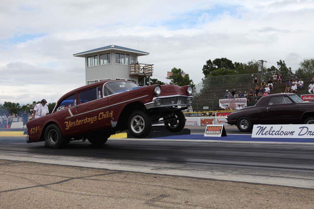

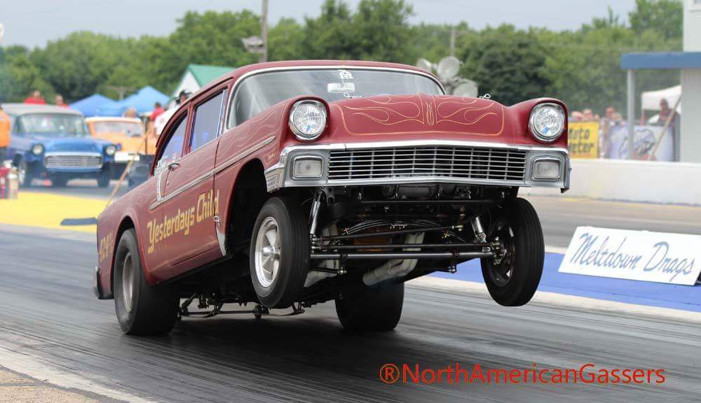

  11. image.jpeg image.jpeg I'm calling air under the left & right front, as well as soiled underoos! The house of hook definitely had a grip on the ole Child's shoes!

    Yeah Yeah Ric I get it.
    Give me a year or two.

    Just how much power will we need to stick to make our front wheels come up? [emoji849][emoji6]

    Looks great, do you guys run an anti roll bar to get an even launch? Im trying to figure out what to do to mine. It picks up the lf and rr sinks down pretty good. would like to straighten out before i ever go to bigger stall or transbrake . Or if i ever get a manual trans

    All you can afford.
