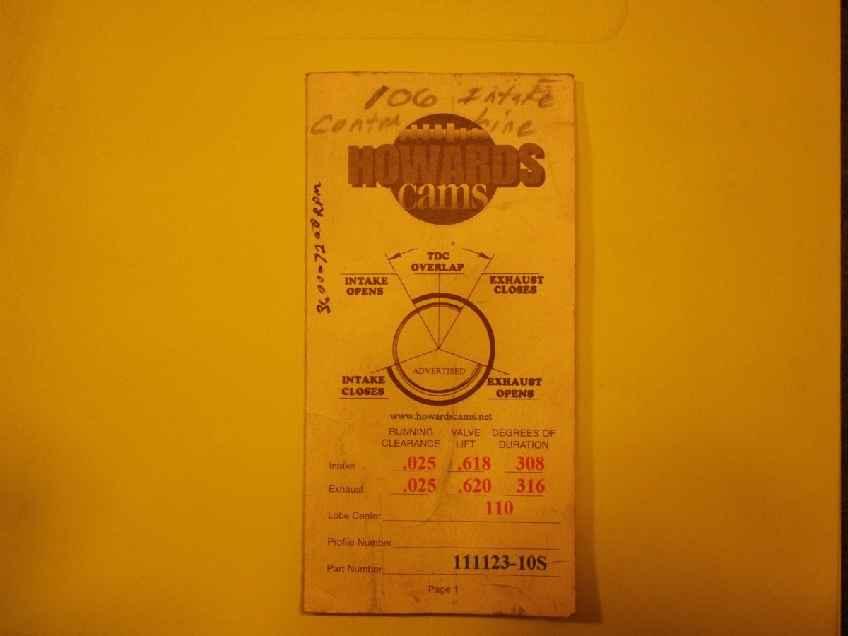

    Been looking at deeper gears, ( the rear end is apart yet to brace ) :oops:
    Pulled out the cam card ( after reading your post ) and noticed it 4 degrees advanced. :confused:
    Any one know about to estimate how much lower the upper r.p.m. limit becomes when advanced?
    Looked up cam specs, actual limits for this 111123-10 s cam straight up is 4400-8400
    Dont want to go there, my heads and valve train wont support that kind of r.p.m. :eek:
    With 4.56 gears with 29.5 tall slicks been shifting @ 6900 and going out the big end @ 6300.
    Been looking @ 5.14 gears to go out the big end @ 7300 ?
    Any Ideas cam card 1.JPG ?
  7. Was the cam ground with the intake CL at 106', or is it installed at 106'? If your engine is a 434, and doesn't have any more intake port flow than 300-320cfm, its never gonna make power past 6800-7000 rpm any way. Once the chain slacks a little its gonna retard a couple degrees anyway, so if you have enough piston to valve clearance on the intake valve (every 2 degrees you advance it, you loose .008-.010 of intake valve to piston clearance) I'd run it 6' Adv. (104 int. CL) to 8' Adv (102 int. CL). It'll just be that much stouter in the bottom and mid range where that combo wants to run. With a small rear tire, I don't see that one wanting more than a 4.56 gear.
    Tickety Boo and loudbang like this.
  8. PS. Tickety, my guess is that Howard has a relatively lazy lobe rate, so you could ****e up the opening speed, with more intake rocker ratio, as long as you have enough piston to valve clearance.

    Thanks Ric
    You just saved me $300.00 gear money, maybe I should be cam shopping for a better package.

    Nothing to see here Scott ( just a miss print ) what he really meant to say is that cam is to big for my 327.:D

  15. Alot of people really miss the boat on cam timing verses stroke, and piston acceleration. Its easy to get "small block Chevy" on the brain, and forget you have a 4.000 stroke, same as a 454 big block, with nearly the same rod length, and upwards of 1 to 2.5 ratios less of rocker arm. The worst part is, your cylinder wall lengths is about .750 or so less than the big block, so there's way more piston hanging out of the cylinder wall at bottom dead center, and piston rock/ring seal are much more aggravated, and harder to control, although I will admit, we have a very good handle on that @ CP Pistons. This piston issue, and the cam deal have left many a 434 small block owner, wondering way the performance of their big stroke small blocks, isn't any better than a good 355-410" engine.
    loudbang and Tickety Boo like this.
  16. PS. The other problem with 4.00 stroke small block chevys (unless you have a Dart Iron Eagle, with a raised cam tunnel, you have to run about a .100 smaller cam base circle to clear the connecting rod swing. I call .850 base circle SBC cams.., "Torsion Bars". The trend is going to bigger, and bigger base circles, for torsional strength, and much more cam tuning, abilities, while being gentler to the valve train. The small base circle deal is just going backwards.
    Tickety, if you want to try something different in the cam dept., call Scott Brown @ Compe***ion Components (517)719-5935. Tell him Ric Panneton sent you.
