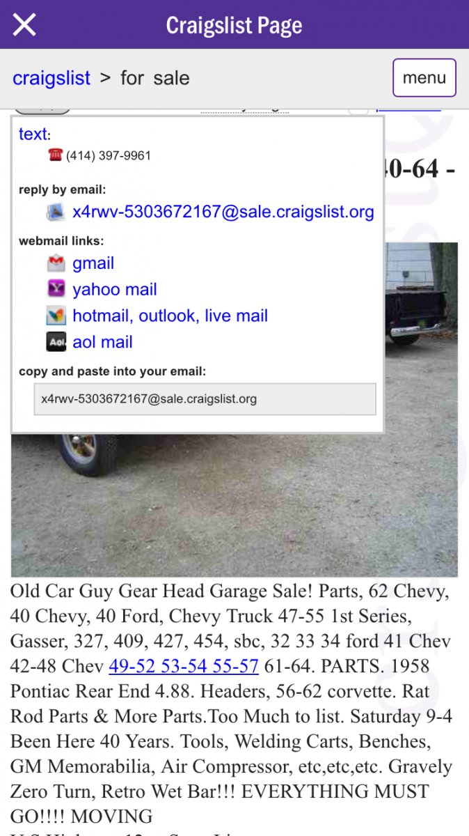

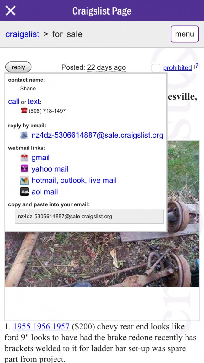

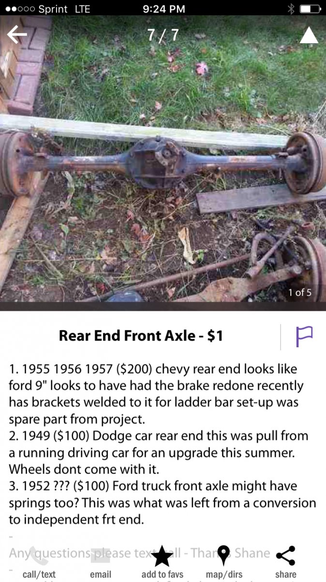

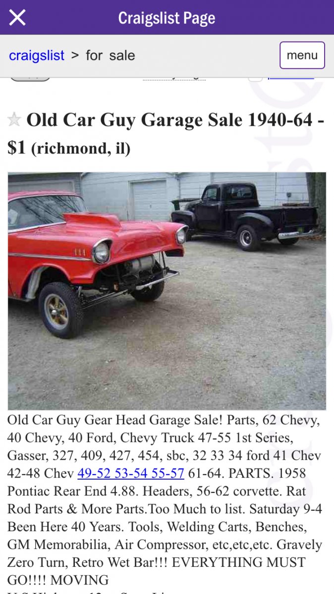

    You looking for something like this? On Craigslist Janesville... Took couple pics, Jimbo... ImageUploadedByH.A.M.B.1448940464.581007.jpg ImageUploadedByH.A.M.B.1448940490.730413.jpg ImageUploadedByH.A.M.B.1448940656.341427.jpg ImageUploadedByH.A.M.B.1448940674.292304.jpg
    One in Richmond in add has 58 Pontiac with 4.88! That be up your alley

    Posts: 2,197
