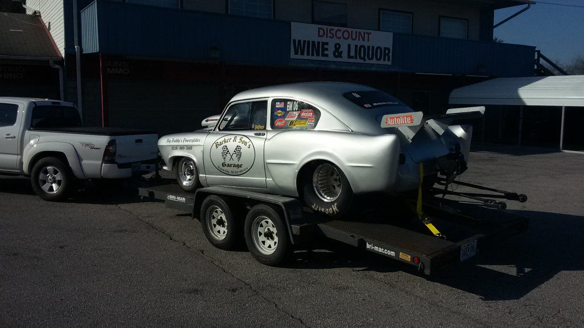

    I hoping that with a few minor changes I can run my Henry J that I just bought. 20160101_133023.jpg 20160101_133011.jpg

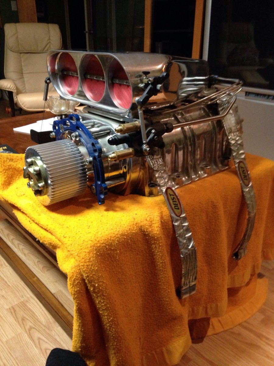

  12. sa**on looks great. with that k-valve it allows you to run port nozzles. are you planning on running them? its become a slippery slope now. you have the parts to run nitro. have fun.

    Henry J's are awesome little cars!Congrats on your new purchase!
    From your photos it looks like all you would really have to change in order to meet event criteria are your wheels,hood scoop,and the wing.
    Other than that,it wouldn't look out of place.
    With a set of Torq-Thrust Americans,or Halibrands,or even a set of Cragars,and many of the fibergl*** manufacturers make cool,period-looking g***er-style scoops.
    How fast does that car run,anyway?What are you running for a drivetrain?
    One of the guys that has run the Meltdown for years has started a Henry J build,maybe we can hook you two up and you guys can buy doubles of any parts you need,to score a bit of a discount?:)

    Just so I'm up front with this - the focus is on the injection. The blower is an empty case but I managed to get it and the "good" stuff attached to it included in the deal. The bearing plates and BDS drive are good to go and I also got the return loop, shut off valve and an ***ortment of pulleys, lines and fittings, throttle cable, pump drive extension etc etc . I'll be shopping some of these parts out to offset the overall purchase.
    I am not going to run port lines. My current intake isn't tall enough to provide clearance for the port injectors. I have thoughts of selling off my GMC bus blower, street intake and carbs as a unit and going back to a compe***ion intake and a blower more suited to alky ... maybe more compression... more aggressive cam .... shaft rockers .... Obviously this has real potential to become a runaway train and risking not being ready for Meltdown... so I'm taking one step at a time. I need a pump and other ***orted parts so I've called Mike at Alkydigger. He is interested in taking this Birdcatcher in on trade for a finned Bug (maybe a tall 4 Port). Hopefully we can come to an agreement. If not then I will run this one as-is

    holy **** batman, now we're talkin' !!
    you'er gonna need better wheelie bars !!
    please tell me you're running alky !

    Yes I'm running alky - Swapping to alky is what started this whole affair. I wanted to stay with carbs and was going to drop a hockey-sock full of cash on some from Pro-Systems. Then my buddy with a vintage FC decided to sell the car and parts for cheap. I'm really hoping I can swing a deal for a 4 Port or a finned Bug... but like I said, if I can't - then we run the Bird as it is.

    AWESOME_AWESOME_AWESOME !!! HUGE *** WHEELIES !!!
    yep we need to have a beer or two.. for sure..
    just changing to alky, adds INSANE POWER !!
    just with carbs(like your set up) we built a 355 chevy, stock block,all low buck ****, and a junkyard, 6-71 . it make 1069 H.P. on alky, then he switched it to race gas, 671 H.P. and the torque is even bigger improvement. (don't remember torque figures) and the torque improvement was from like, an idle !! adding injection and a stripped blower will make it even more silly !!

    hey, also ALKY is much more forgiving on the tune-up than gas. you can miss it by a mile, (rich) and it'll still run good.

    Yah - like I need more torque off idle... stronger bars may definitely be in the future
    Alky was always in the plan for this year... The current combo makes 650 hp with 6 lbs of boost and an old GMC "truck" blower that we converted. A stage 2 with teflon strips is definitely on the agenda - just maybe not this year.
    Yee haw !!

    It's got a 496 BBC. I already have a different scoop. The wing just unbolts. But I really can't afford new wheels. They turned me down already, but offered to make a few changes, still waiting to hear back. Last ran 6:20's in the eighth.

    I can guarantee the Meltdown guys won't make an exception on the wheels.
    It's part of what makes the event what it is:
    A flashback to 1966[emoji4]
    If you keep your existing tires,all you have to do is get different wheels.
    If they are used,they will save you some cash.Sell your existing wheels,and the new ones are almost free![emoji4]
    I know replacing a set of wheels is a pretty big commitment to the average guy,but it's in the name of preserving the authenticity of the event.
    Look at it this way:It's a big commitment to install new wheels,but it's an even bigger commitment for a couple dozen guys to spend most of a year,and nearly 24hrs a day on the event weekend,making sure that the Meltdown is the best vintage drag event on earth for the rest of us lucky slobs.[emoji4]
    If you have to beg,borrow,or steal a set of vintage looking wheels to get your o the Meltdown,do it!Its totally worth it!
    If you miss it,you will be kicking yourself until next July![emoji16]
