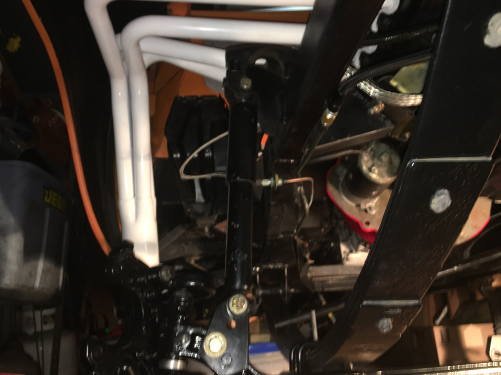

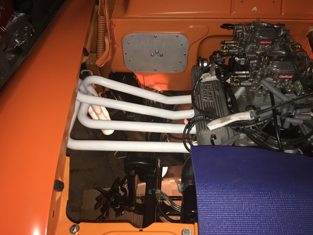

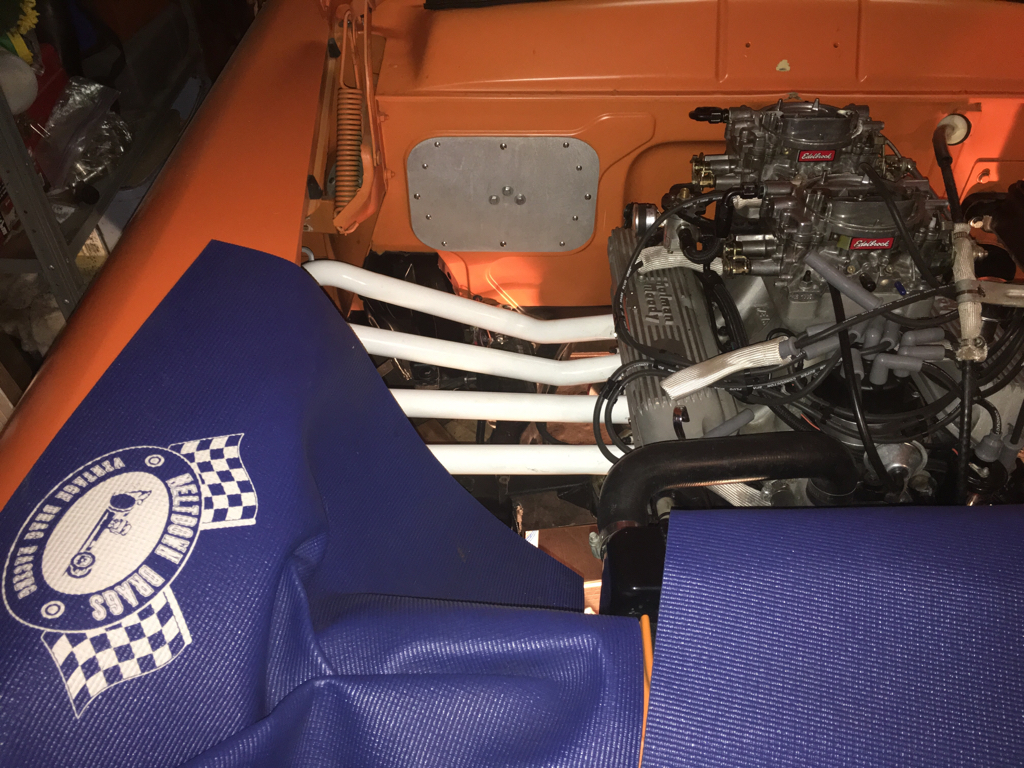

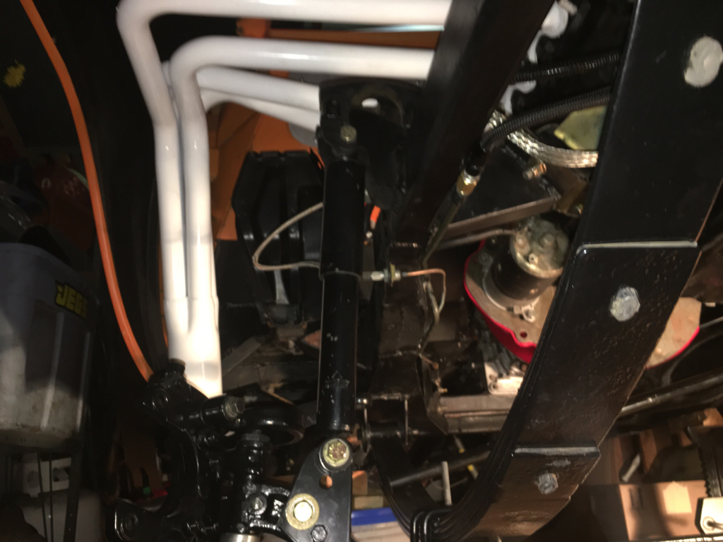

    Got a lot done on car this weekend. The header wrap that was on headers was falling apart & headers were getting rusty under wrap so I had them sand blasted & powder coated. For most part turned out good. Couple sags but look a hundred times better than they did...!
    Used some Prep-All & paint brush & scrubbed the frame & floor of car! Had quiet a bit of grease & grime under there...!
    I had entertained thoughts of changing from Econoline axle to a tube axle in the front but think that's going to be on the back burner for now or at least moment... Found the drag link rod end was worn & p*** side king pin you could rock it & move it up & down about 1/8"... I also found the hard sleeved spring bushing was in the wrong end of leaf spring... I thought something was wrong when I put a wrench on rod end jamb nut to break it loose & leaf spring & axle moved! I'm like WTF that's not right...! So I'm hoping all that is why it get so squirrelly on the top end when I'd get above 80mph...!
    So I everything apart on front end, I had it all powder coated... Springs, axle, spindles, rotors, shackles, u-bolts.. Plus had fan, pulleys & alt bracket done too! Ordered king pin kit & spring bushings from Rockauto... Thought it was odd the bushings were AC-Delco.... I got new poly bushings for front shackles too. Got the springs, axle & spindles ***embled & put back in... Its fricken sweet now! Nice & tight no movement like before.... And powder coat makes the stuff look like new!
    Just have to get new rod end! I took it to hardware store, found the hole is 5/8" & the threaded part is 11/16" I think? 3/4" nut was too big & 5/8" nut too small... They didn't have a 11/16" nut to try!

    Good job man but you should have went ahead and drilled that axle when you had it out.

    Thanks Jim, I had thought about drilling it. But I'm pretty limited on garage space... I can walk down one side of car. Just a small, Unheated, one car garage to work out of... Got a small inferred heater I got at Menards, takes the chill out of garage... But anyway prob could of bolted down a drill press on bench but then loose that space... There's lots of things I'd like to do to car, but I'm limited by what space I have. Wish I had a wire feed welder & torches too, but I feel pretty good on what I've been able to get accomplished on car for what I have to work with or out of...! [emoji106]

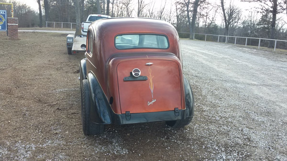

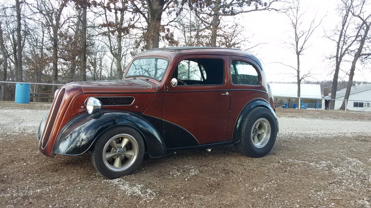

    Well I've decided if my Henry J won't get accepted, I may just take my Anglia. Just not sure if I want to out it on the track though. 20160124_144939.jpg 20160124_145002.jpg 20160124_144955.jpg

    that Anglia is sweet, what in the world would keep you from running it down the track?
    in reality, nobody cares what it runs. just have fun with it !!

    It's a bit squirrely. I hate the thought of anything happening to it while on the track. Whereas the Henry j is fully set up to race. I tried to send pics of the Anglia to meltdown registration, but my emails keep getting kicked back.
