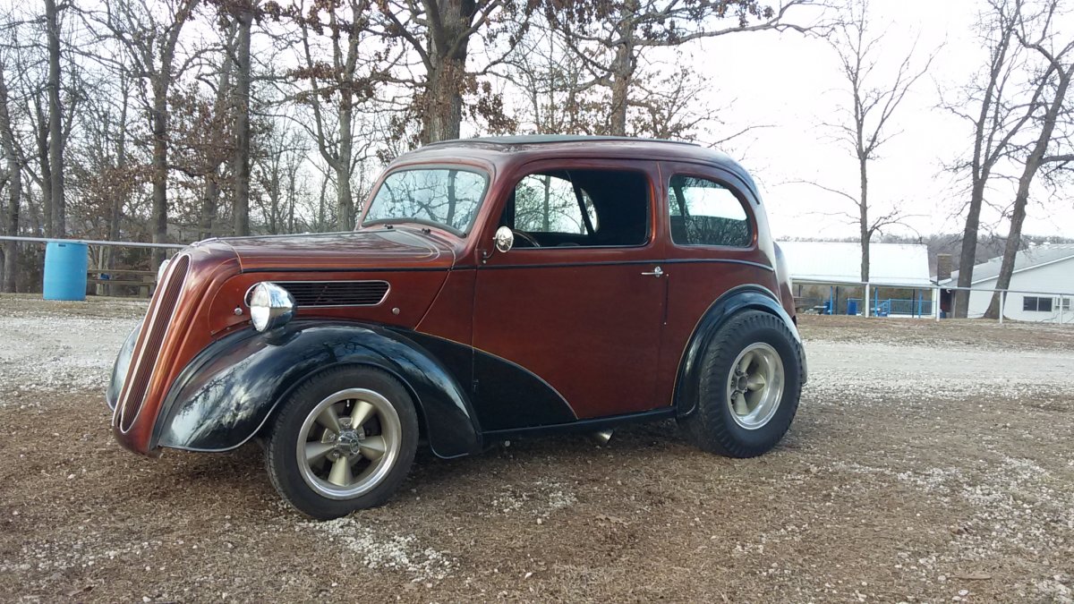

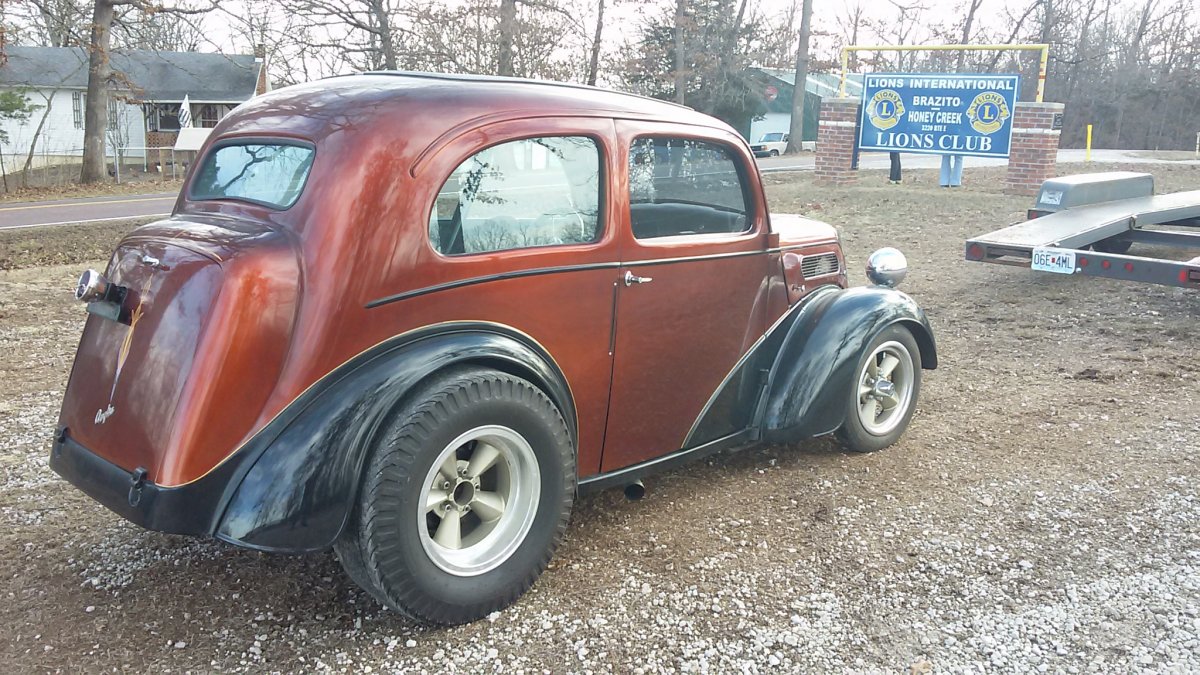

    Well im in! the Anglia p***ed with flying colors. Ill just race the Henry at other events. Im so excited. Ive never been, and my son and I cant wait! We are building my son a 1948 Prefect to run.

  7. You had me at "hello, here's my Anglia". Now you tell us your building a Prefect for your son to run too.., I'm truly speechless.., for maybe the third time in my life. When you showed us your Henry J, I was thinking, "cool car, but this guy doesn't quite get what the Meltdown is all about. Well sir, you get it.., in spades! I'm wondering now, if the Henry J introduction was a clever guise to see if the Period Police were gonna tear you up, instead of help you up? Another lesson in "don't judge the book by the cover".

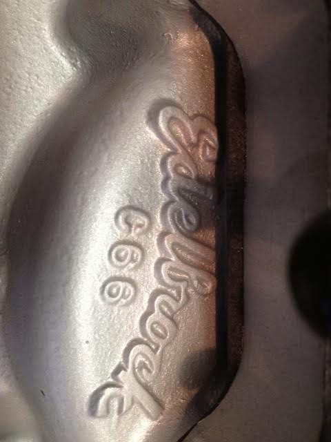

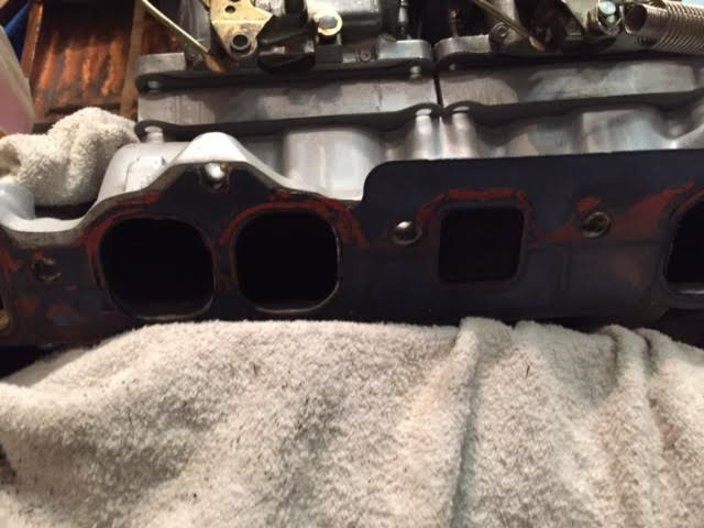

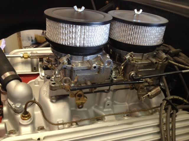

    Hey Guys, I just posted this for sale on the HAMB cl***ifieds:
    2X4 vintage single plane Edelbrock manifold with 2 600 cfm Edelbrock carbs. Complete with linkage. I had this set up on the White Noise Altered Wheelbase Nova before I put stack injection on it. The Nova ran great with this set up. I wanted to let you all know just in case someone needed it for the Meltdowns. My bottom dollar is $500. I can ship it if you pay those costs. Thanks manifold1.png manifold5.png manifold7.png
  17. speedwise
    Joined: Aug 2, 2009
    Posts: 210
    speedwise
    The set up is for a Big Block Chevy. Forgot to add that sorry.

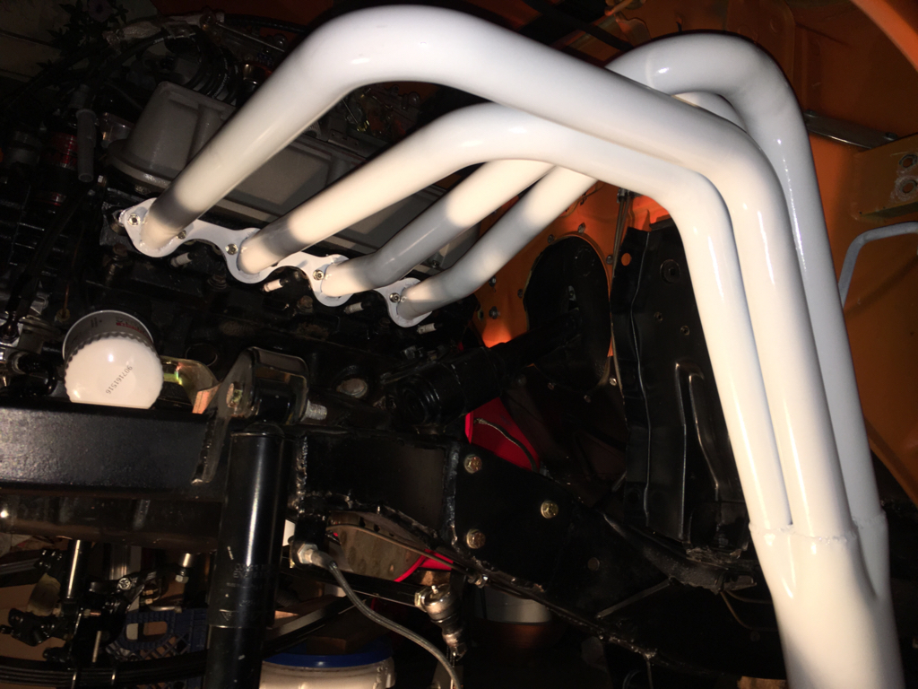

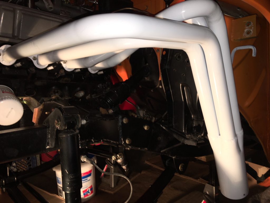

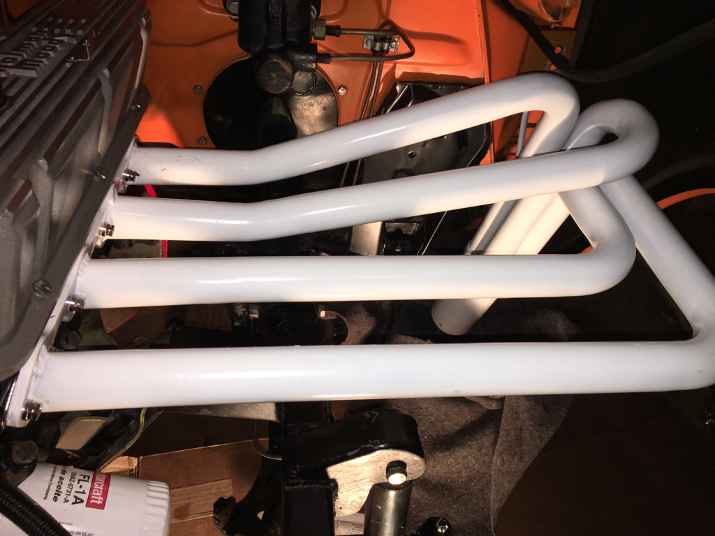

    Got the other header on tonight & new steering drag link rod end came today! Got that on also... Should have rotors, alt bracket & master cylinder cover back tomorrow from powder coat... [emoji106].
    It was cool to see Pauls Hairy Hauler spread in Hot Rod Deluxe...!
    Jimbo... ImageUploadedByH.A.M.B.1453950728.583272.jpg ImageUploadedByH.A.M.B.1453950745.531694.jpg ImageUploadedByH.A.M.B.1453950778.285060.jpg
  21. Those pipes are Aldente'

    Bigslim
    Did you powder coat those headers? How will that hold up?
  24. bigslim55
    Joined: Jan 2, 2014
    Posts: 443
    bigslim55
    Jeff, yes their powder coated. Have a friend Rich Londberg who does powder coating. He uses Cerakote or Tech Line. Heat range depends on color. 1500 degrees or 2000 degrees... His oven is 8' tall - 4' wide & 4' deep. Told me Headers 3/4 cured, have to bolt up & start engine to finish them off... lives between Spring Grove & Richmond, IL, just off 12... Let me know if you want to talk to him, give ya cell number... Jeff it's gotta be better than the rattle can!

    I think Cerakote is actually a Ceramic Coating. Lots of powder coat guys also do ceramic. But standard powder coat will not survive exhaust temperatures, only good to around 600 degrees or so.
