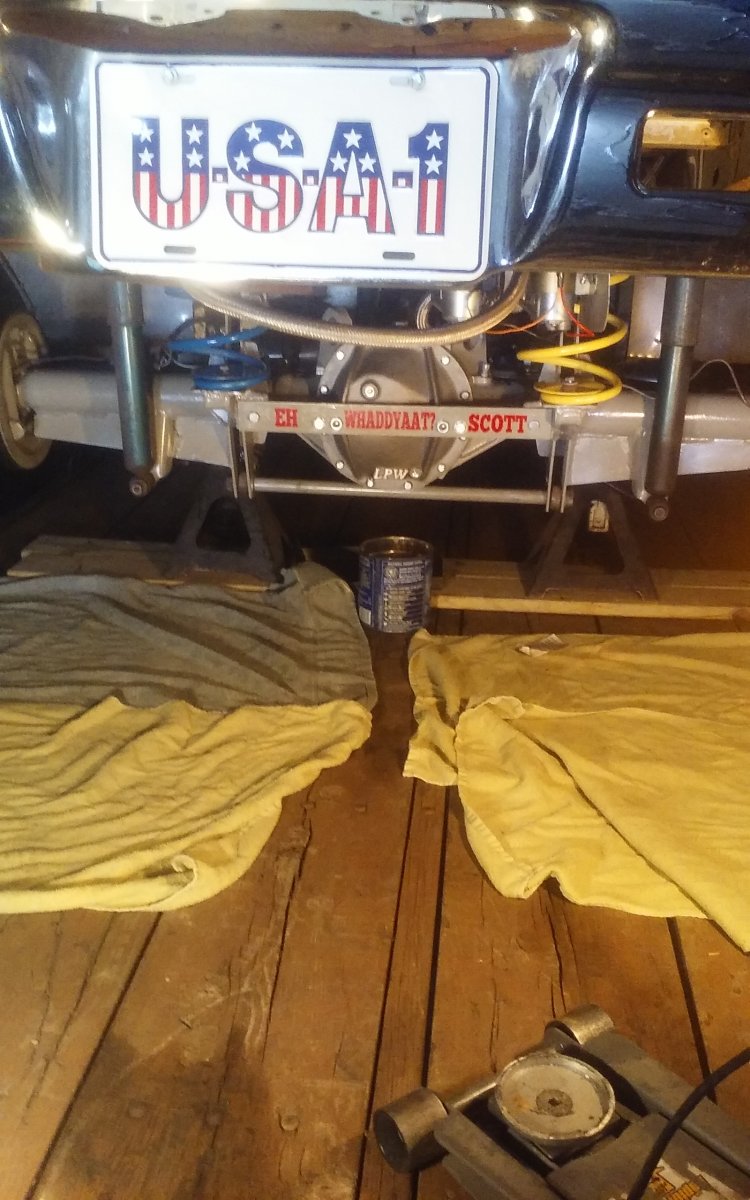

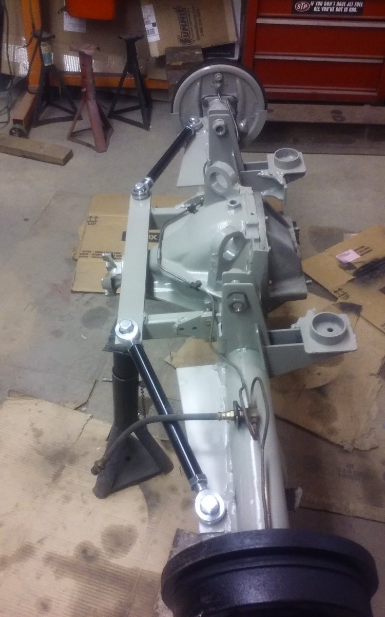

    Got the 12 bolt braced and back in today, waiting for Jay to come over to help bleed the brakes. rear done 1.jpg rear done 2.jpg

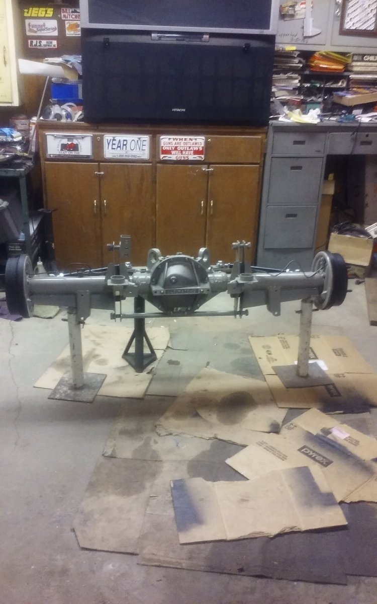

    Norb looks killer but I have to ask Don't you have a tubing flare tool?

    Ya I got one, (but it wasnt meant to be) o_O
    Borrowed my flare out and got it back missing one of the double flare heads. :oops:
    Sooo put the old one back on ( 40+ years old no rust )
    Wanted to getter done today ( high of 41 degrees today) no heat where its kept.
    May fix it in May:)
    Ya, thats Snow on the floor in front of trailer, its where the tractor gets parked after plowing snow.

    NORB IS THAT A 12 BOLT REAR OR A LANDING GEAR FOR A AIRPLANE?!? HOLY SCHNIKES...! WELL IF YOU BEND THIS ONE UP YOUR DOING SOMETHING RIGHT...! [emoji15]

    Nice, are those front links set up pushing or pulling for preload?

    Thanks ( Pushing )
    But it wasnt planned that way, had it pretty straight but when my buddy welded it, the ends came forward a little.
    So set up the jig again to flex them back ( then installed the links to keep in place ) so they are pre-loaded.

    LOL I gotta paint that brake line Neon Pink, more pretty stuff for Scott to look at going down track.:D
