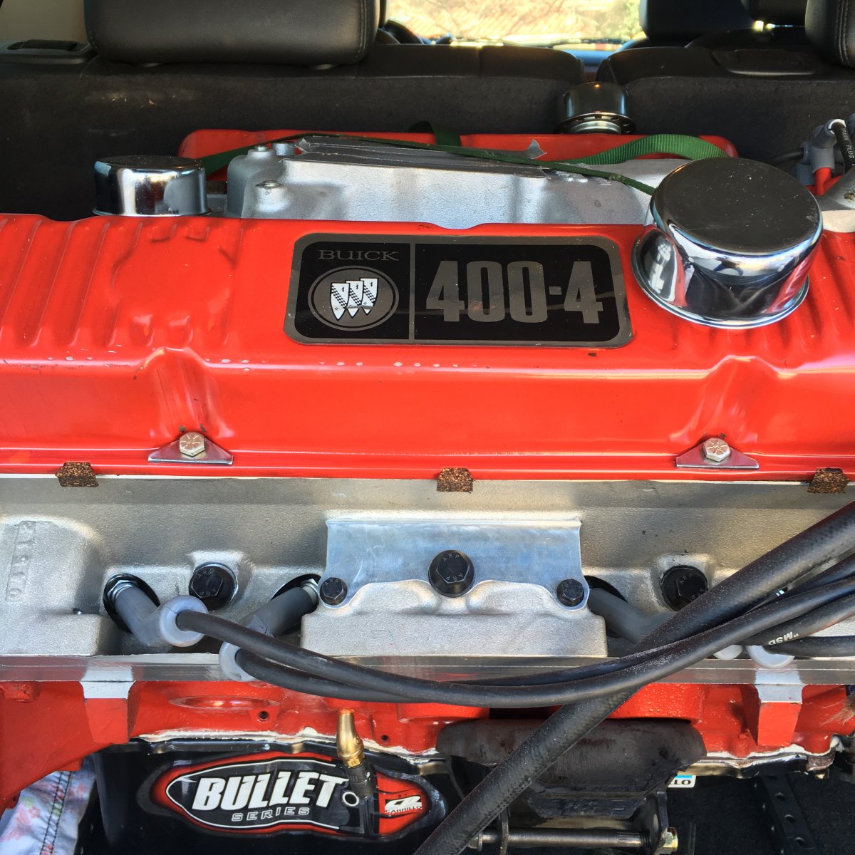

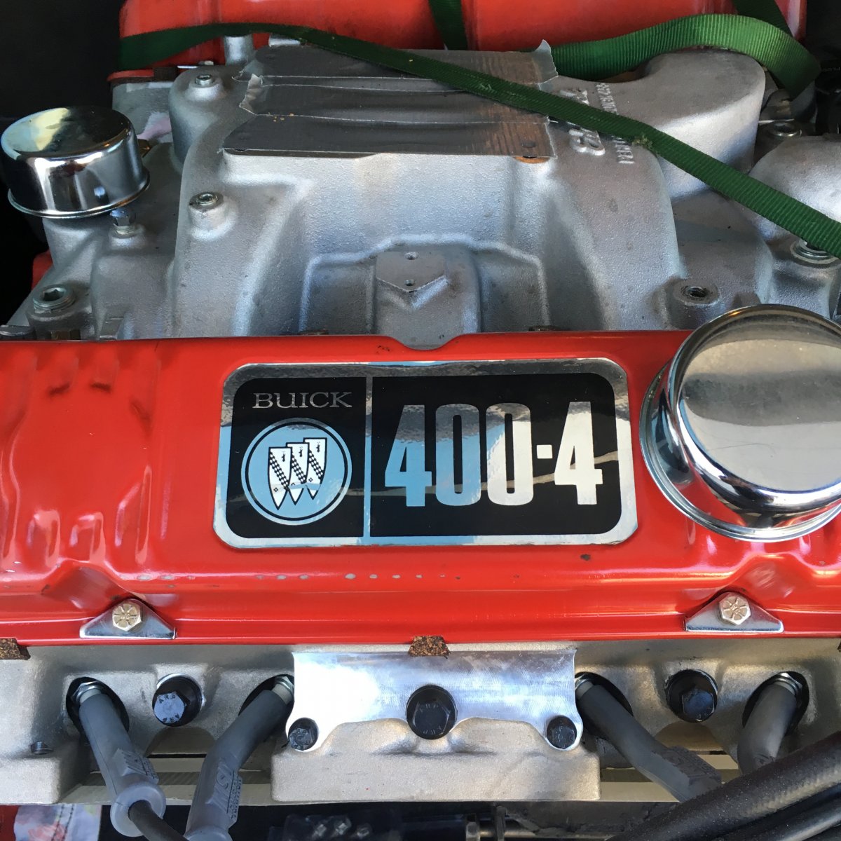

    Well I guess I'll go ahead and get MDA to stick this on their waiting list 20160206_132327.jpg 20150630_010730.jpg

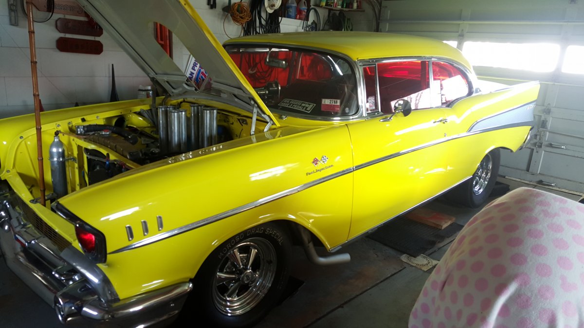

    it's got a way's to go but we'll make it , More progress on my 63 vette g***er build.
