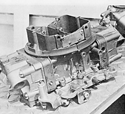

  13. Why not, I think some of the older school double pump Holley's came that way.

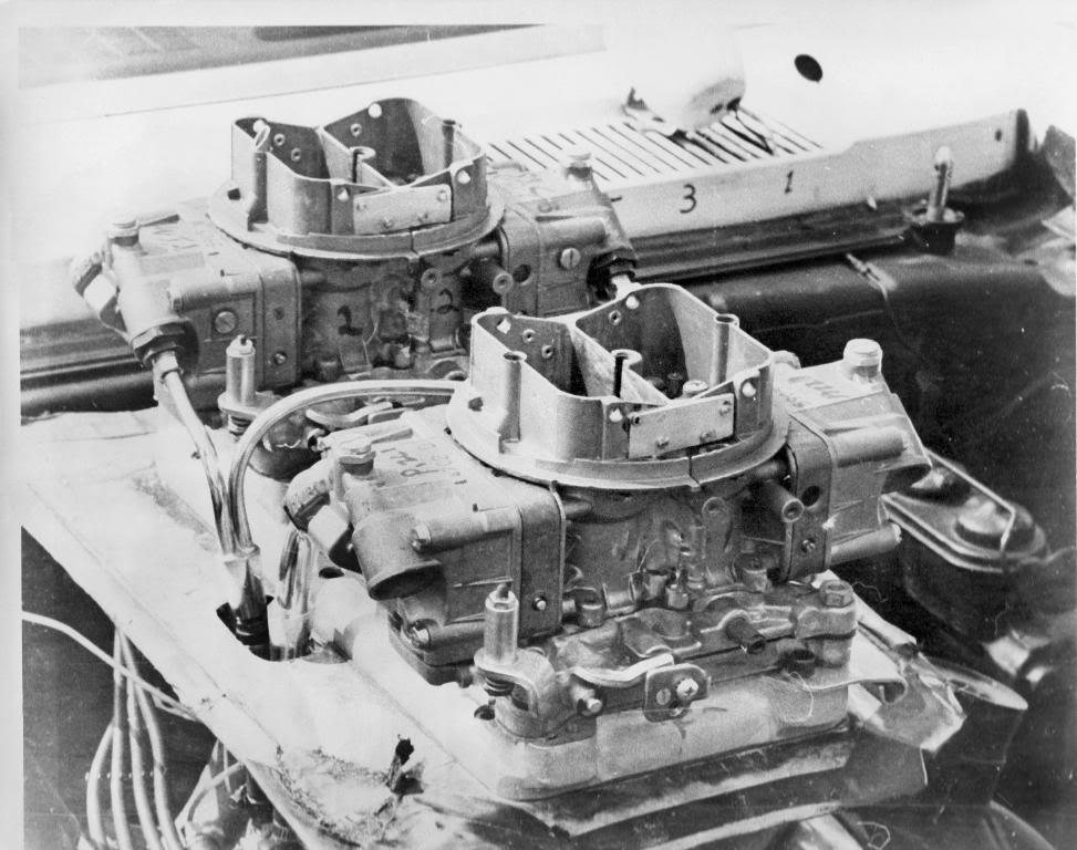

    Speaking of Holley questions,I'm thinking I should definitely be running 50cc pumps on these 6109's of mine.Does that make sense?I figured with the big plenum and long runners,it would help the balance of nature in harmony when feeding this lil ol 289[emoji4]

    I would start out blocking off the power valves, the ski slope cam you have wont make much vacuum, along with the tunnel ram slowing the vacuum response will contribute to the low speed BOG :eek: when you flush those two 750s.
    Da Big 289 Gulp
    The 6109s came with factory 75 front and 76 rear jetting so with out power valves, try about 82 square.
    Later when your tune is close, you can do a vacuum check for power valves (if they make a low enough number) put them in and reduce jet size. ;)
    powrshftr likes this.

  29. He better figure out that jetting etc. pretty close on the Canada Dry DYNO! If he gets sloppy and try's to just track tune it, I'm gonna "split his weld"! By the way, I'm betting 30 cc pumps on the primaries is good n plenty. I start with 50's on the back, but don't rule out 30's there either, and that should be left to street n track tuning.
