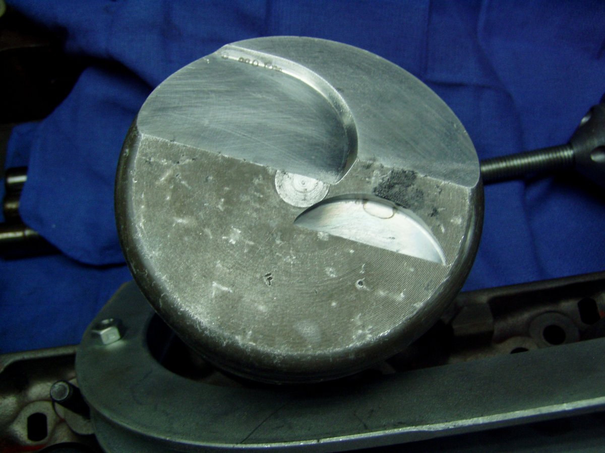

    This is the piston that I had to cut for the engine that is in the car now.

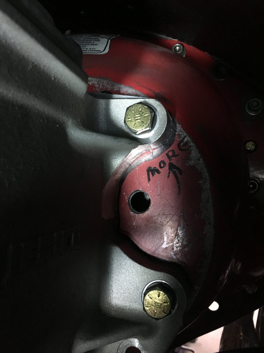

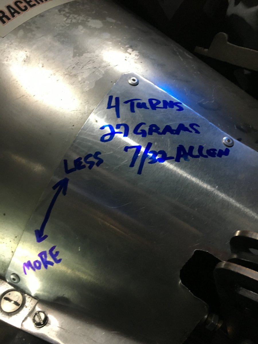

  2. image.jpeg image.jpeg Clutch is adjusted, did it Quick n Dirty and it turned out 0kie Dokerie. There were no Shenanigans, I didn't Duece it up, It's ready for the Salt Flats, Lakeshores, and the drags. Tight fit for my adjustment Wrenchbender, but I Slim Jimmed it in there. Now I'll be able to Powershifter like an Eric, she'll be wailing like a scalded *** 30 Dodge BOY! This ****er is gonna be a Hairy Hauler, a real Charger! We'll be in the fast lane, not the Scaredlane. If we whoop ya, no Sour G****s now, ya hear.

    I sure wish I had nothing better to do than sit around and think of sayings like ric does but I don't gotta get my dragster done and the tow rig and I might even put some new plugs in the Willys lol but I must say ric sure does make me laugh

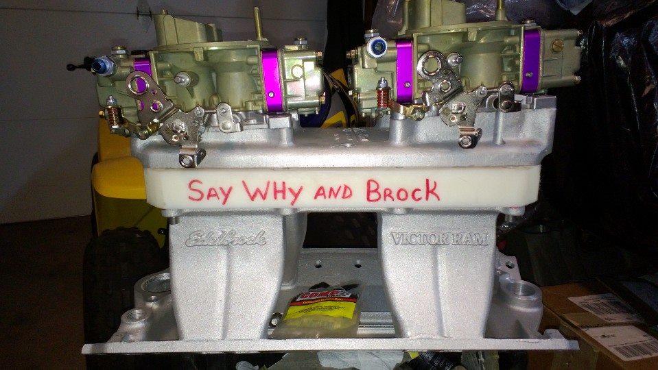

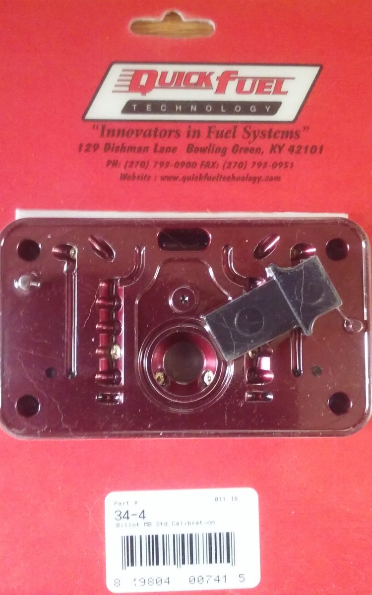

    The Child could get Spanked, Its gonna be close( still didnt give up on that 1050 ) just got a new metering block
    with power valve opening for the secondary side.
    Still working on the diet, both me and the car. :rolleyes:

    Well Norb that metering block looks like it has more tricks than a monkey on 60 foot of g**** vine.

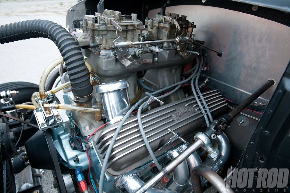

  13. Heck Norbitty Neighbor, I may even just throw the OctoJet Super Cramm back on the ole tramp just for you! 1500 CFM of Rottencatcher Baddness! OctaJet Super Cramm.jpg

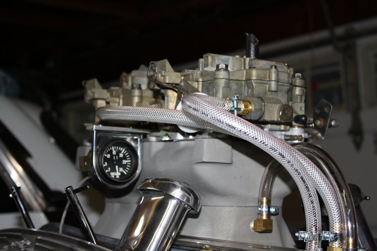

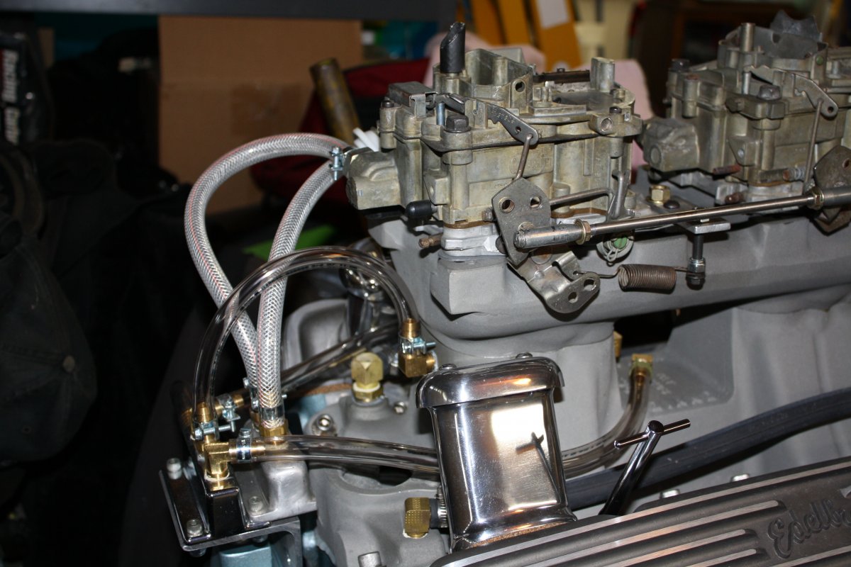

    School me on whats going on with the clear tubing going into the tunnel ram?
    The 90 fitting under the the top?

    That's top secret sh*t man!

    I think he forgot to remove the Styrofoam packing...lol
  21. Who says the mechanical fuel pump has to pump fuel, it can pull vacuum in the crankcase too. ;)

    Very Cool :cool: I LIKE IT
    Wonder if you could run power brakes ? ( With a pump that requires a regulator ) o_O

    And here I am doing it the hard way...drilling holes in headers etc. Very cool!
  25. I borrowed the idea from a guy at work, he uses his to build a vacuum reserve for the factory power discs on his 65 Chevelle. It keeps 16" of vacuum in his reserve tank. I need to add a power brake check valve in my set up, to build a crankcase vacuum reserve, still sorting it out

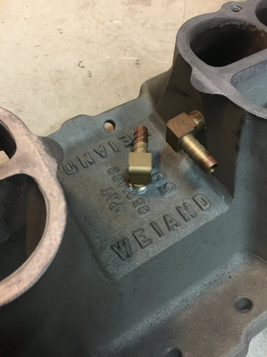

  26. Cool idea. But one line appears to go from the intake plenum to the vacuum block which also "sees" the vacuum from the mechanical pump ?? You don't want to **** more from the intake do you ??

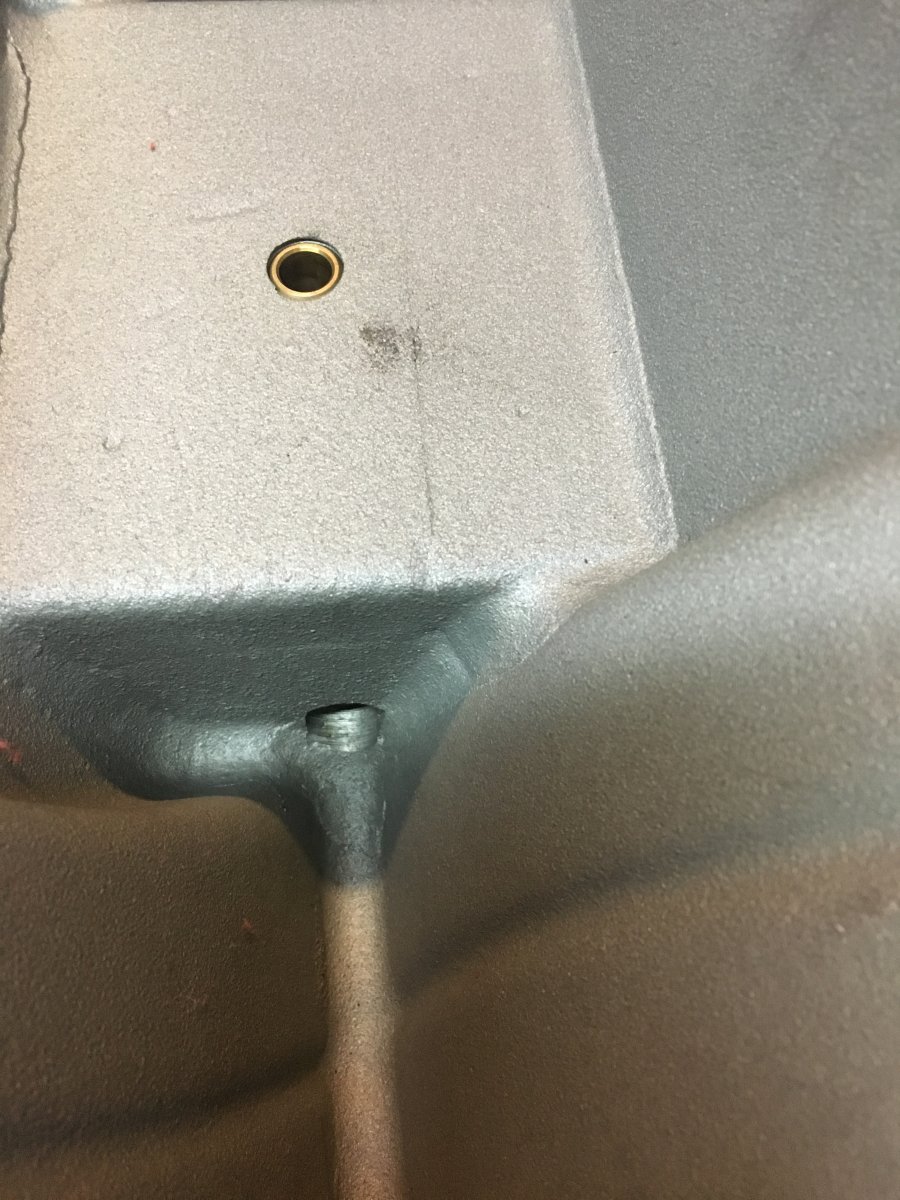

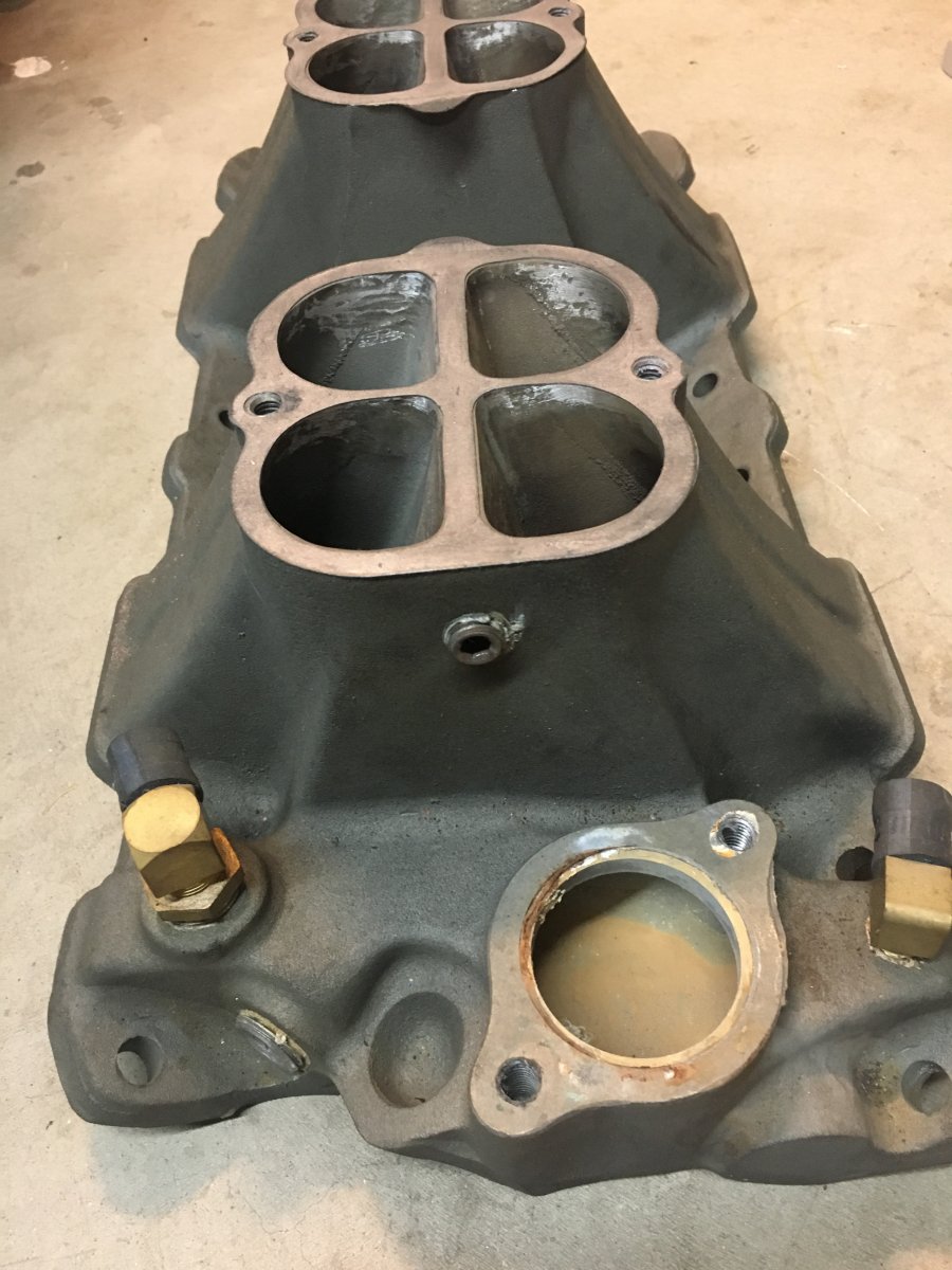

  27. image.jpeg image.jpeg image.jpeg image.jpeg Thats not the plenum, it's the highest point of the lower manifold, and is also ****ing from the lifter valley.., now I gotta put it all back together, and get it back on the engine, before Marc finds ou..,t.., aah ****.., never mind.
  28. Ok I get it, all lines are ****ing from the crankcase, but that is quite a few lines ****ing.....need that much ? High RPM pressures ?
  29. Tickety Boo
    Joined: Feb 2, 2015
    Posts: 1,800
    Tickety Boo
    from Wisconsin
    If you dont **** the seals in its all good, helps piston ring seal and stops oil leaks when running.;)
    I have been using a header evacuation system (like Deuced Up) on one end of the valve covers, on the other end of covers running filter breathers to pull clean air in. The breathers prevent to much neg. pressure.

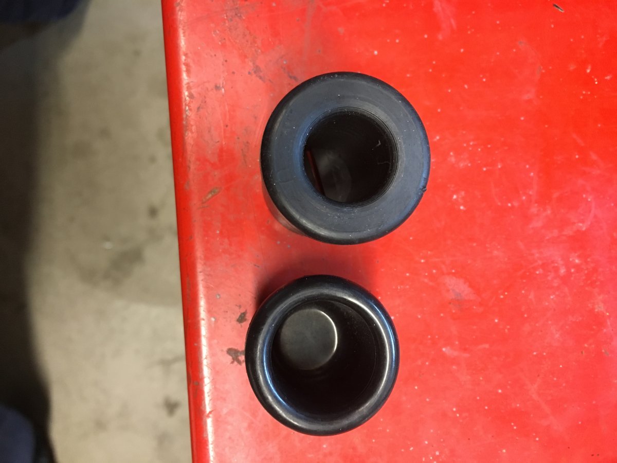

    These are the typical sized grommets for push in breathers, either static, or pan evac style. The bigger of the two has .900 id, so the breather hole is .875, and two of them would equal a 1.750 hole. My tunnel ram has .375 x 3 holes for a total of 1.125. The moon breathers have no holes beneath them, they're just for show. 1.750-1.125= .625 Looks like I'm 5/8" less than typical. ;)
