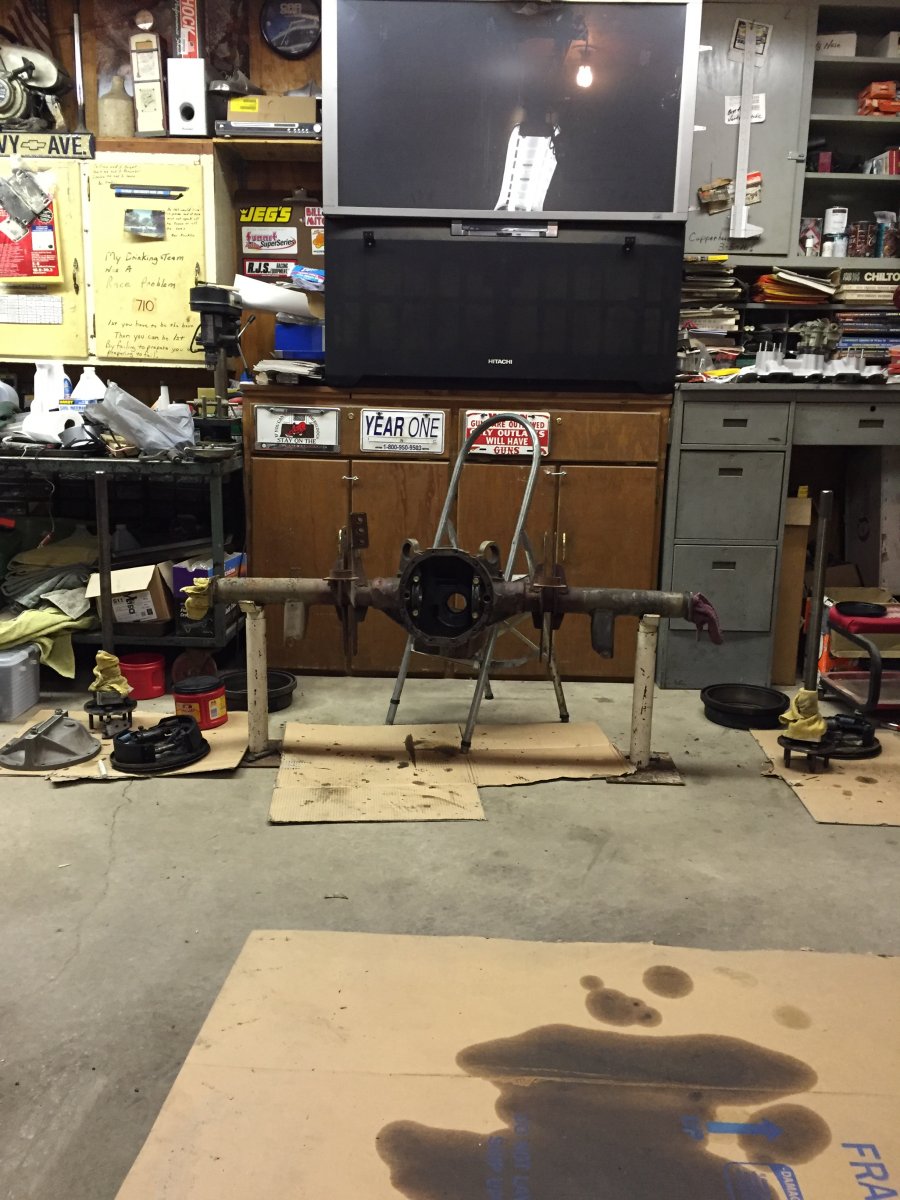

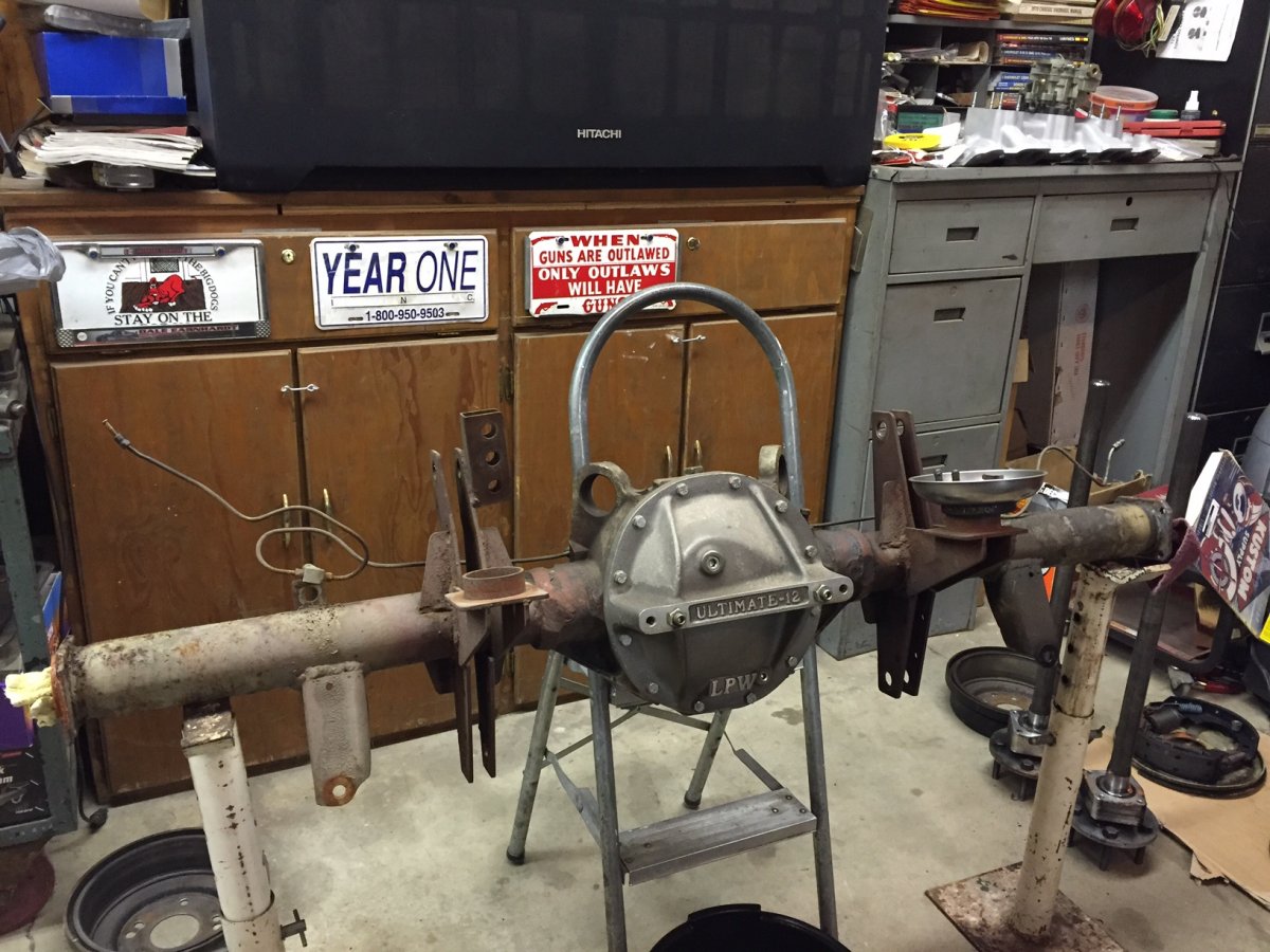

    Pulled the 12 bolt rear end out of Tickety Boo today. :(
    Axle tubes are bent, :eek: Had to Beat out driver side axle and p*** side not much better. :oops:
    My bloggie camera battery is shot so I will get pics asap

    Noticed that it took a lot of force to turn ( even more than a 9" ) binding?
    When I took out the bolts in the C-clip eliminator the axle went tight against the axle tube edge. :eek:
    Spline on both axles look good. :cool: Going to pull out spool tomorrow ( check the splines )
    Put in a Moser full spool and axles about 10 years ago ( when replacing a broken axle ) every thing was ok
    then.
    Painted a pin stripe on both axles, that still looks good now ( no twist ).
    The problem lies with factory stock length 12 bolt rear, ( it has 15" of unsupported axle tube ends) out side the
    4 link mounts. ( Needs a rear support bracing ). :oops: Hope to straighten and brace?
    Hummmmm this is the first year not using rev limit on trans brake. ( found the weak link ).:oops:

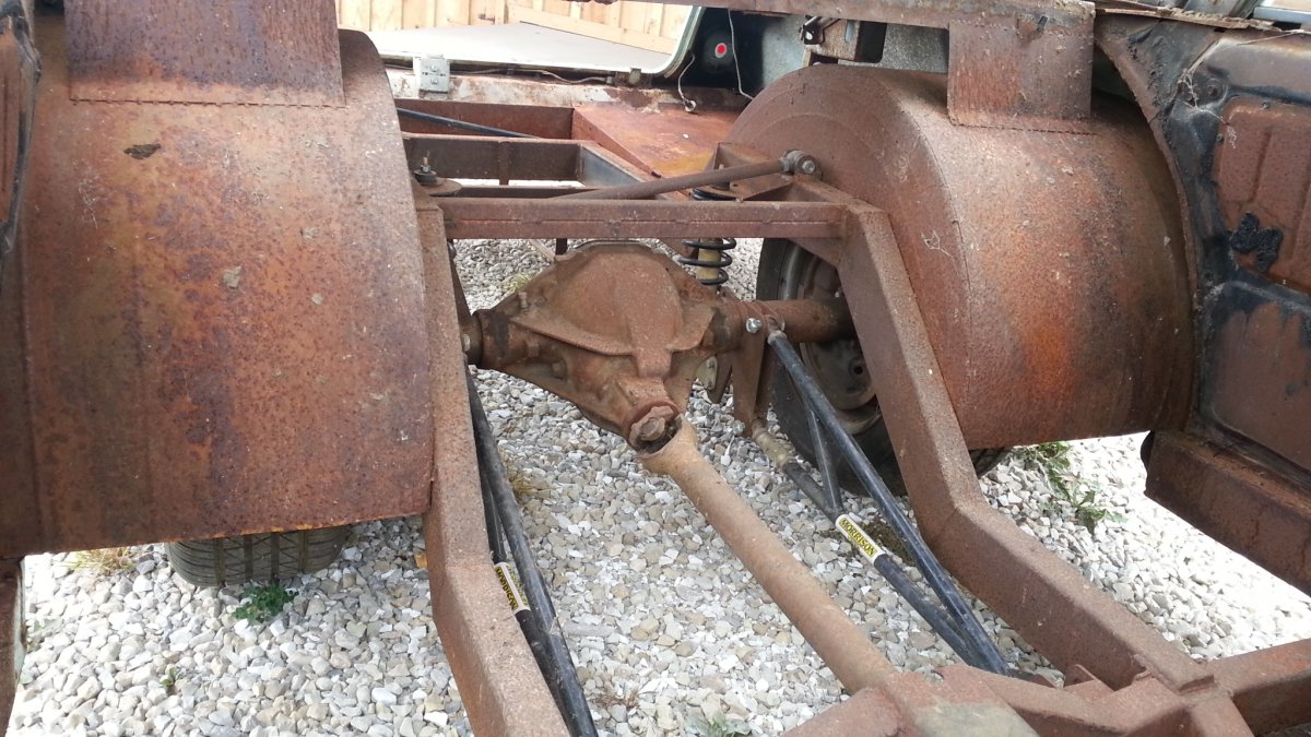

    Still in planing stages on the 61
    This car someone started a pro street project and never got finished.
    So somehow I have to try and make or remake this to fit the bill for my liking and some tires that we can afford.
    When we picked it up we thought it was a good deal but now I am scratching my head. 20151026_151250.jpg

    Pulled the spool out today and splines look good on both spool and axles :rolleyes:
    It looks like the axle tube ends bent down. :confused: 12 bolt #1.JPG 12 bolt #1.JPG 12 bolt #3.JPG

    Got to change bending motion into forward motion. :oops:
    Happy it was bending not breaking stuff.:)
    The spool / axle spline fit must have limited the bend. :eek:
    Let me borrow your not braced 9" ( just for a weekend ).o_O
