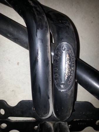

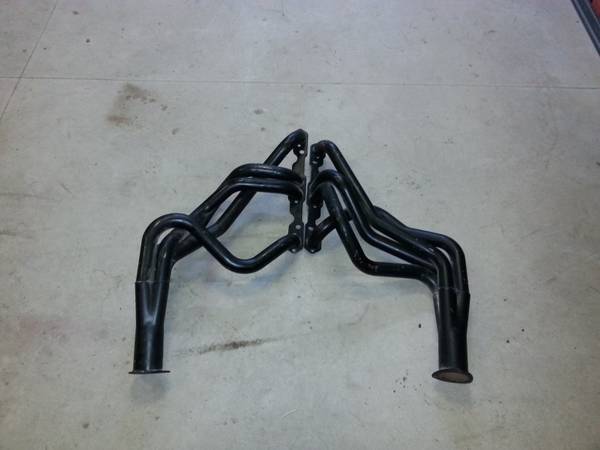

    Getting some things done on my 55. The new headers are on their way back from Jet Hot. They were coated in white. Since ****** discontinued these, about 10 or so years ago, it took some time to find a new set.
    By the way.....Does anyone know if racing gas, (110 - 115 octane) will rust out headers more than 93 octane pump gas? Two sets have rusted out on my 55 since 1998. The ******s on my 59, (which runs on 93 octane and sees many, many more miles) were new in 1999, and are still good and solid.
    Also, the Muncie is torn apart to be freshened up. The main case is getting a bushing for the counter gear shaft, (and a new shaft). Also replacing the 3-4 synchro ***embly, (new hub, slider and synchro rings). Considering an iron mid-plate, too. This should take care of the leaking gear lube, and..... Hmmm.... Maybe, I won't miss 4th gear anymore. LOL.
    A new clutch is on the agenda, as well.

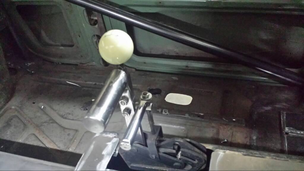

    LOL. ....sorry Scott couldn't resist. Check this out though. My addition to the Vertigate to make it more street friendly.
