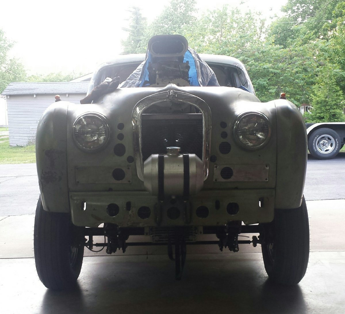

    Well we had to get a bit creative this weekend, first drive with the nose on the car. Not nearly enough air available up there to keep her cool. First we cut all the louvers out of the grill but we still had to add a few well placed holes. The next step is to build a box that fits between the front of the radiator and the front clip when it is in place. That way all the air coming into the area HAS to flow through the radiator.

    Seems odd that it would get that hot. Is it the blower that's adding all the heat? My car won't hit 180 even at 15:1.

    What about dual radiator fans?
    Went back to look at video of the 1st test run and looks like you need more fans.:rolleyes:
    I run a large single 2 speed fan from a 90s Buick, (cause its junk yard cheap)
    on high speed ( through a headlight relay ) it moves a lot of air:cool:

  19. a blower creates pressure and the byproduct is heat lots of heat. my manifold inlet temps run close to 240 degrees. think about how that pre heated incoming air is placing more demand on the cooling system. not to mention a opening in the front of the car the size of a postage stamp with a gas tank covering some of that up. air flow is everything.

    Well the issue, as always with this car is real estate. When we changed and went to the blower, we lost the room for the dual puller fan set up that we had in place. All that was left was a fairly thin front area for a pusher fan. I searched all over the for the most powerful pusher I could find that would fit. It is a 19" and moves 2750 cfm (a huge number for a pusher). But when we put the front end on, it not only captured the engine/blower and header heat, but more importantly the factory nose really restricted the air flow. I think we are all good now. But if not, we have already devised hiding a duck system in the firewall that has the potential of pumping nearly 5,000 cfm out of there on demand. That would be like driving 56 miles per hour standing still...
