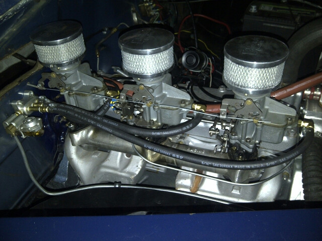

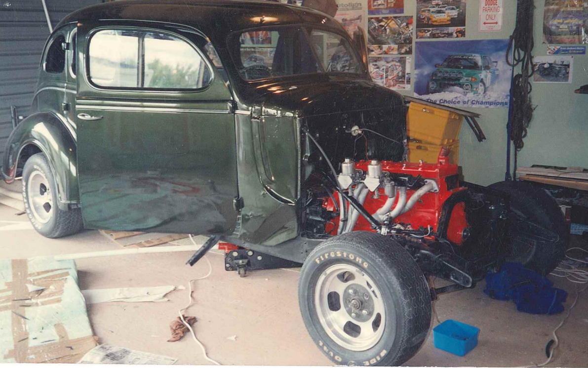

    The car is no longer mine however I did manage to find a couple recent pictures of the car.
    I have recently purchased a stock P8 Chrysler with an 3.3/8" engine. it has a KEW engine number. This is a later model engine with the water byp*** in the head. I suspect it is from England.
    The rebuilt and runs sweet but I don't know how good it is in side. I still have the cam and extractors off the old car. I am considering later inline 6 drive train (Australian Ford falcon of maybe jeep) or do I keep the side valve with an Edgy head and multipoint injection?

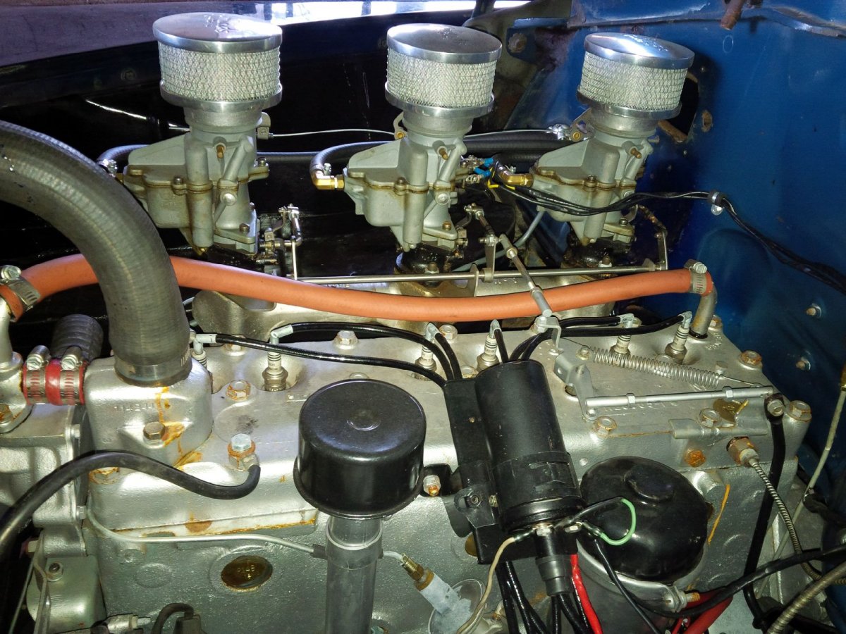

    It will go on the dyno in the spring. Just want to see what it puts out .
  6. Flat Six Fix
    Joined: Feb 6, 2010
    Posts: 1,270
    Flat Six Fix
    Okay great, look forward to your results, so what have you for induction ?
    Does this preclude pics of your engine at this point?
    What are the plans for the engine Your pic of the engine is near 7 years old, is it in a car or truck yet?

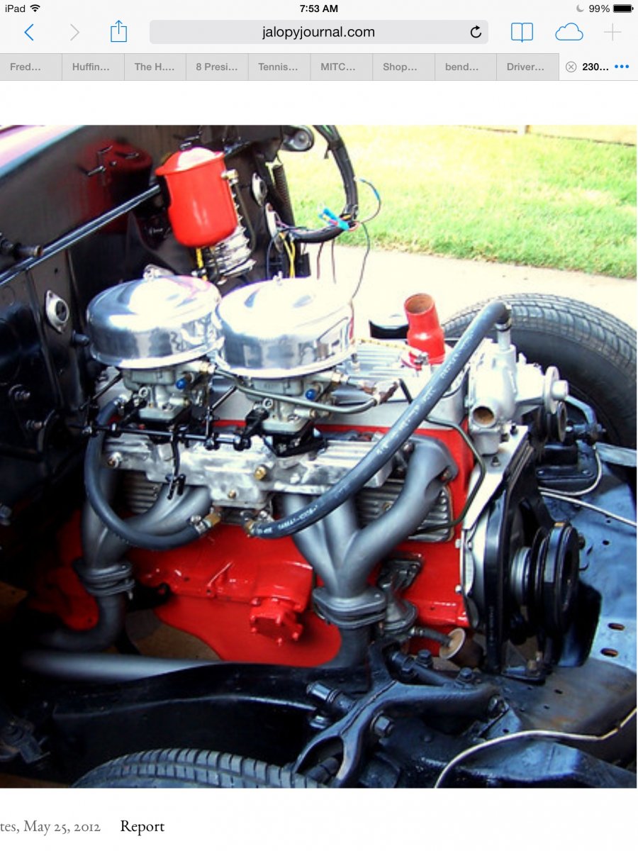

    Not my engine but the look I aspire to. Now that is a beautiful engine.

    Lol - to each his own, but the carter webers are pretty small cfm. The offy and/or fenton intake is too low so if looses tons of torque. The fenton headers work, but I prefer the look of the stock ones split like in my 1949 Plymouth Business coupe, lol, or 42" pipes on our AoK dragster. but in the area of duals, I love Freds. Better torque and better hp gain than the one your aspiring to. Sorry Fred for Photo-bombing your dual thread with triples.

    Absolutely, your engine/car, your money Bro.
    An the pic you sent looks like a nice piece, not what exactly I would want.
    The post by Hitek, is where my style is.
    Hitek, is bang on with the comments of how well the offy/fenton intake and carter/webbers carbs is not just talk, not as good a set-up performance wise.
    Now having said that, if that is what you want, it's your choice, and it's welcome on this thread

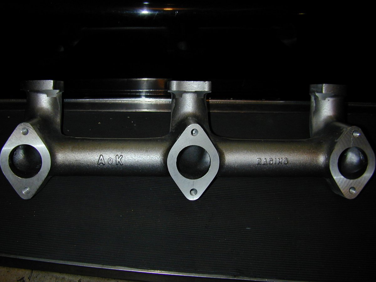

    Who casts those dual and triple intakes in your photos? I see the "AoK" cast into the manifold. Are these for sale?
    Brian
  17. Flat Six Fix
    Joined: Feb 6, 2010
    Posts: 1,270
    Flat Six Fix
    Brian those are designed and cast by AoK Racing which Hitek is a partner in, with Mr George Asche in Pa. They are for the 25 inch long block engines. The new dual cast intakes are ready very soon, those are for the USA shorter engine such as the 218/230.
    But Tim will be able to answer all your questions, maybe shoot him a PM
