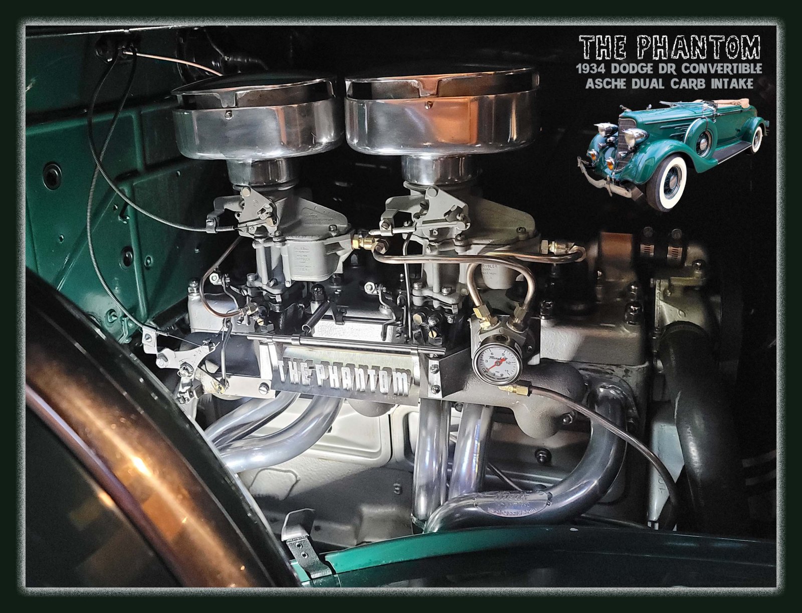

    I have it Spitfire head for the 25" Chrysler engine. Should make it look faster.

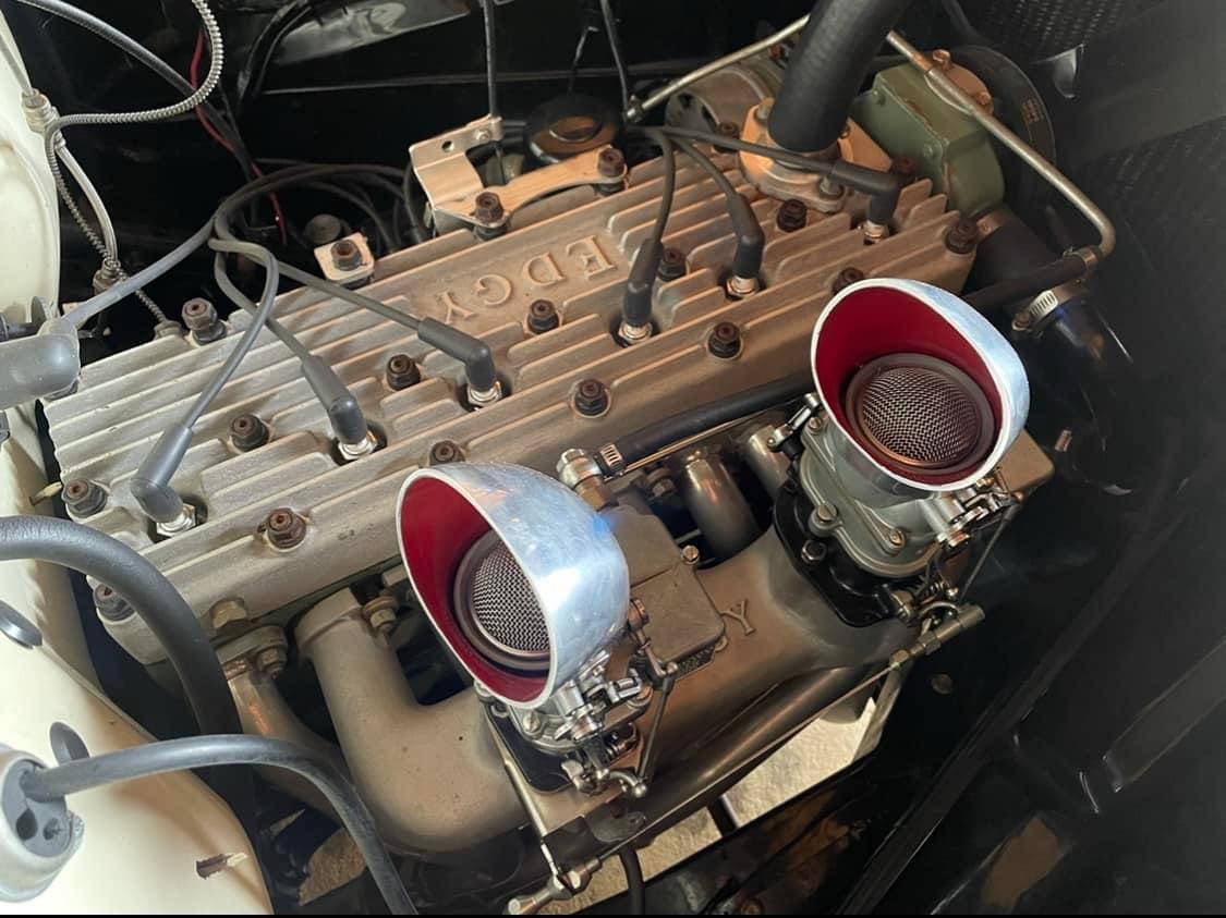

    anyway, here's a triple carb independant runner setup with equal lenght headers that i used to run on my 23" block in the 40 Plymouth.
    i swapped the 23" block for a 25" 265 block, fully built and bored out to 283cui

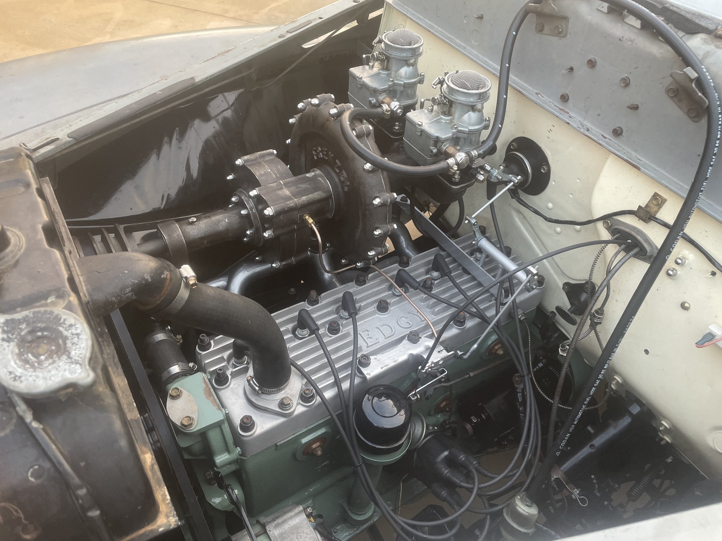

    the old setup lives on in a friend's circle track racer that i built an engine for,
    a bored out 230 dodge block with a wild cam

    had trouble with some of the pictures, i'll try again. here's 3 more of the 283 Chrysler block
    it is 120 over, bored and honed with a torque plate,
    zero decked, ported and relieved, 5 angle valve seats,
    has custom forged JE pistons, the longer DeSoto 236 rods,
    a 260° (222° @.050) .417 lift cam in it, Edgy aluminum head from MoparMontana,
    all ARP bolts and studs, a full flow oil filter conversion,
    Asche triple intake with D6A1 Carter B&Bs, custom made air cleaner housings,
    a 123ignition conversion with spark enhancer and high output coil, 11" clutch
    and a million other tiny things i already forgot because
    it drove me to the edge of madness

    Sure am glad I found this thread!
    got a hotted up 230 in a 40 Plymouth coupe. but it’s getting a supercharger shortly and am collecting parts to build a long rod 265 for my 39 coupe

    Finally got the Frenzel setup on my 230.

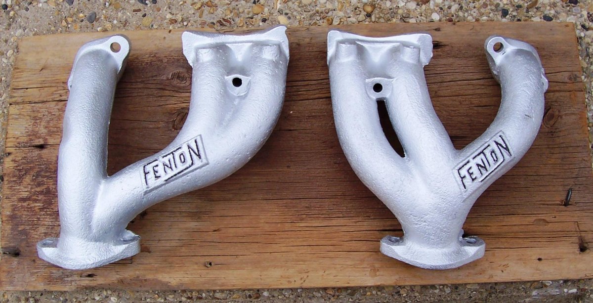

  24. kustomfordman
    Joined: Feb 28, 2006
    Posts: 540
    kustomfordman
    Anybody have a tried and true formula for building a dual exhaust system? I have the dual cast iron exhaust manifolds from 12Bolt. I want to say that there were some tips included with the manifolds, but I cannot find the paperwork. Should each manifold have an individual straight pipe run or should the two have a certain amount of individual runner lenght and then be collected 2 into 1.
