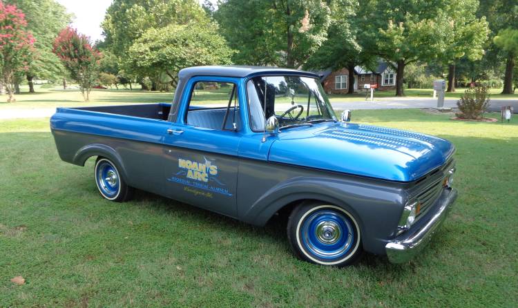

    Signage completed by Leonard Wren, think he really nailed it for me. I'm the third generation Noah. DSC01850.JPG DSC01847.JPG

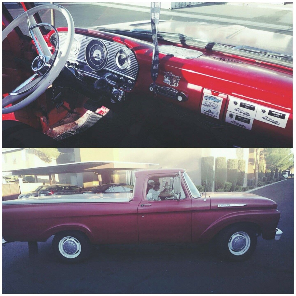

    Well here's mine drive it a lot stock pretty much.[​IMG]

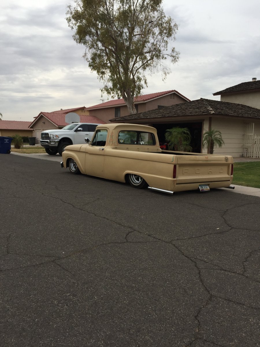

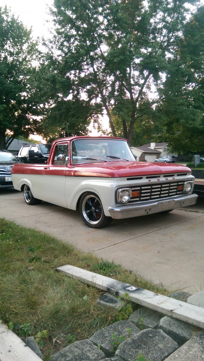

    Bringing this thread back to life here's mine
    Now here
    And here
    Full on suspension drop. Used bigredtodd 's uni thread. Putting engine in today.

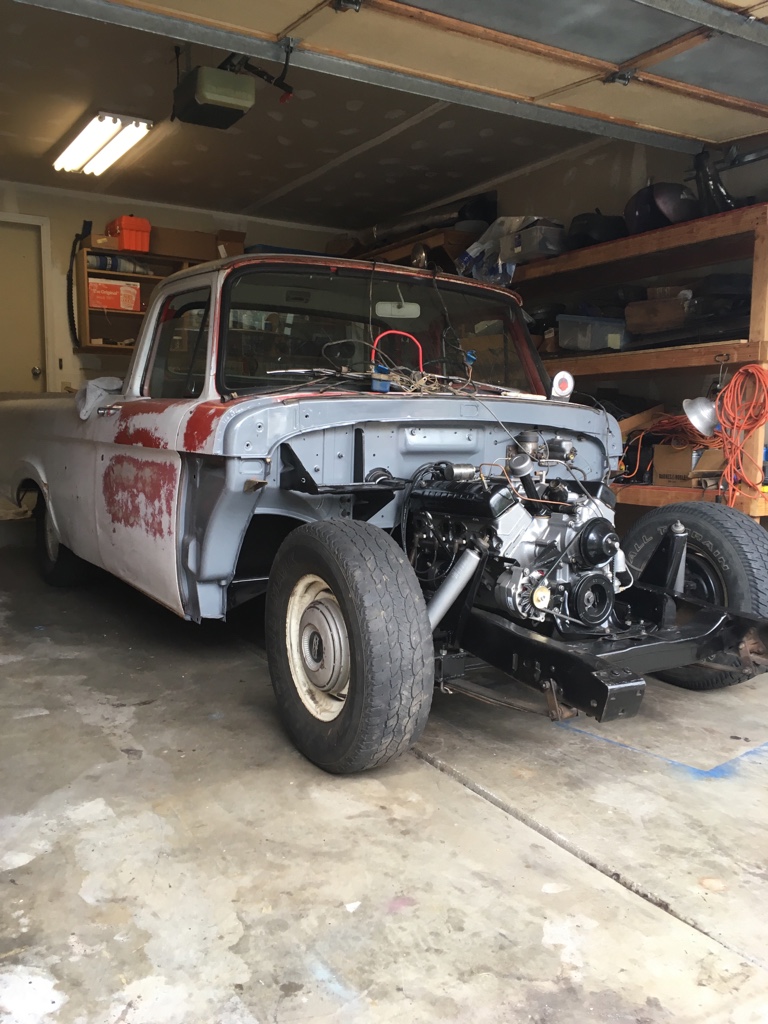

    As promised got engine in

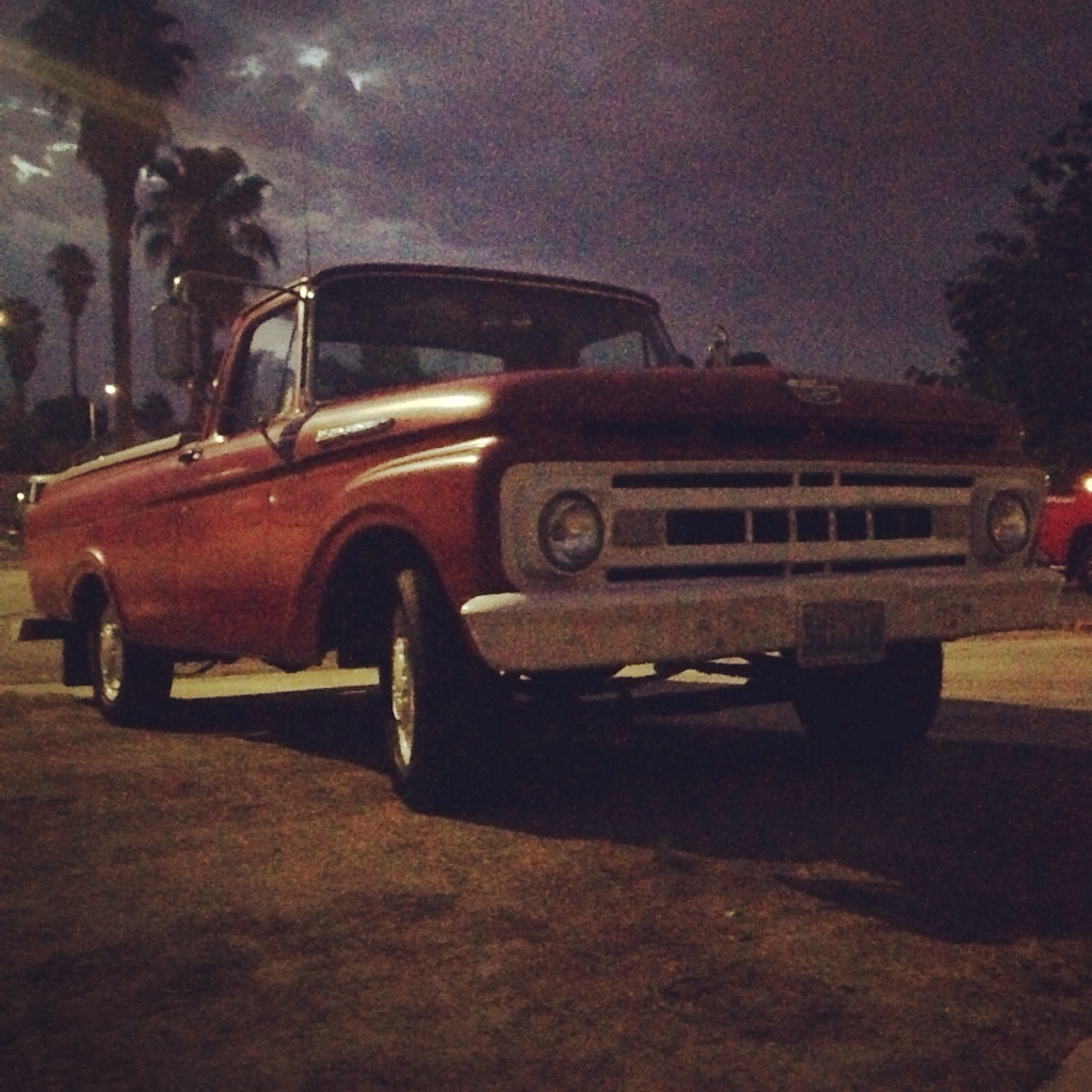

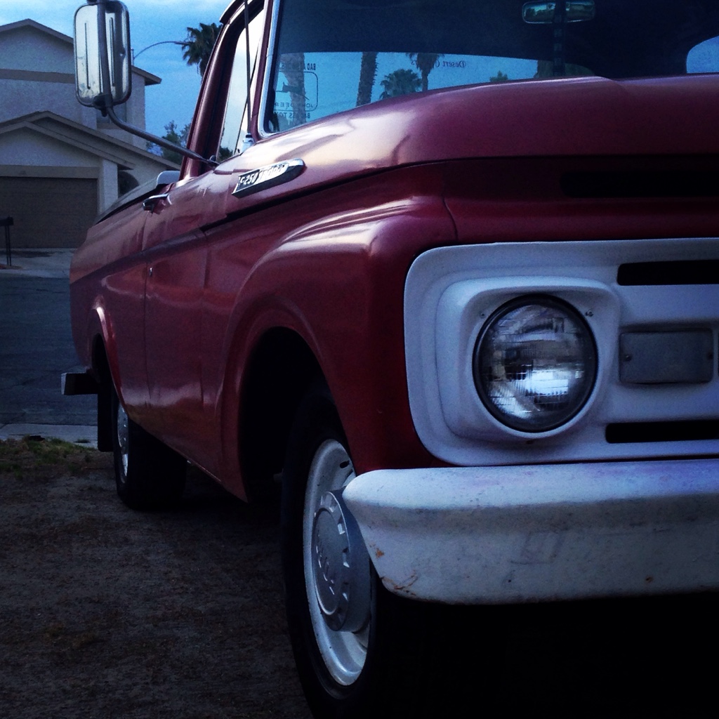

    Here's Big Red out front the other night after a bath [emoji6][​IMG]
    A very Long Bed!!! [​IMG]
    Yup looking good! Trucks a 61 F250 Unibody, Yblock 4 speed.

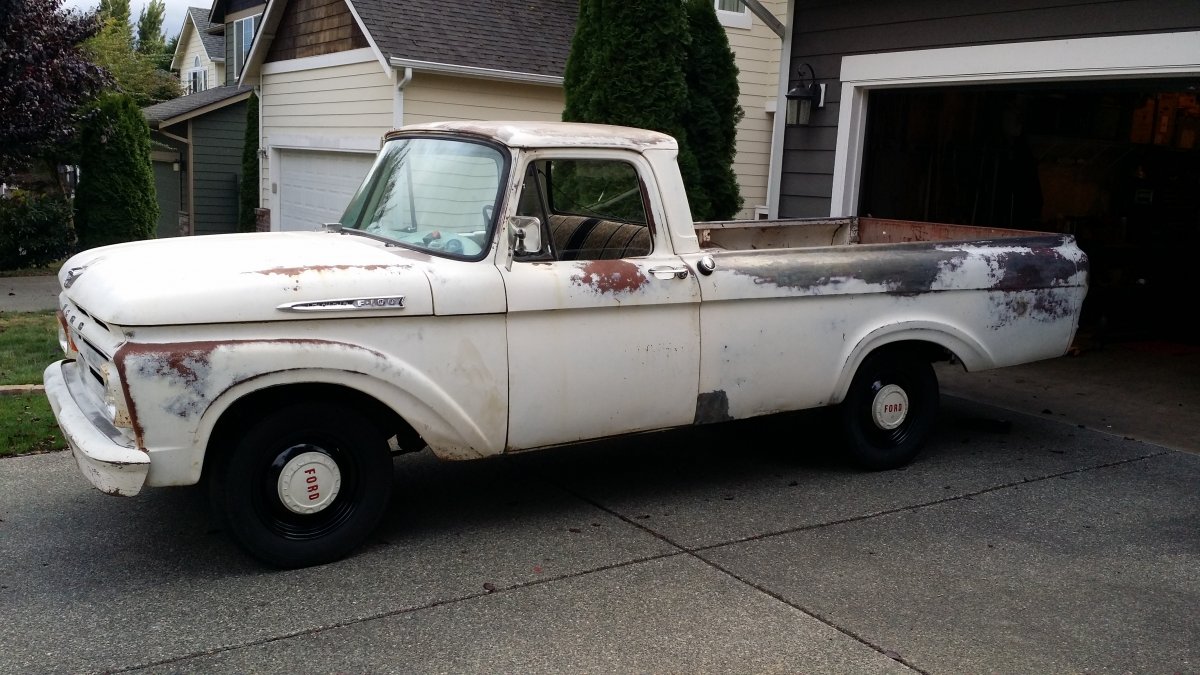

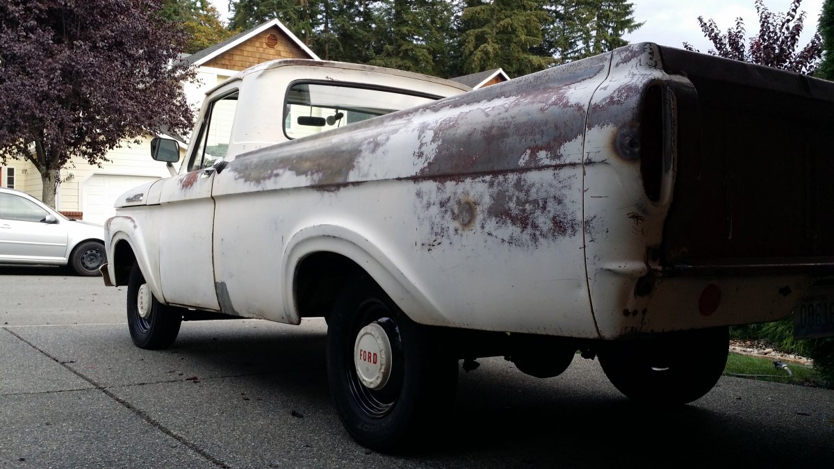

    20161001_171723.jpg 20161001_171800.jpg I've been working on my 62 for the last few months. Everything works now. Just need to figure out how to drop it.

    Hey great lookin truck. PM me for more info, however lowering depends on budget and your fab skills. Flipping front axel was my choice and the rear I lengthened shackles and removed springs. You can also follow my build thread
  22. Timbermax
    Joined: Oct 2, 2016
    Posts: 2
    Timbermax
    Thank you. Im pretty open cost wise but I would like to do it myself. I was hoping to just pull a few leafs front and rear as i only want a 2-3 inch drop but ive read that's pretty bad to do. I was going to have the leafs de-arched but they wont because of the pitting. (Doesn't look that bad to me to be honest) I'm not sure what direction i want to go. I only plan to drive it to the occasional Rat Rod show in the summer time. Any input would be great. Thanks.

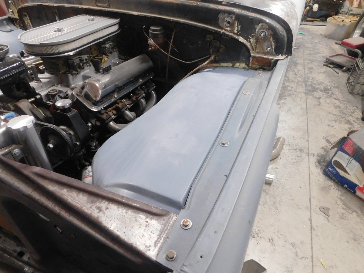

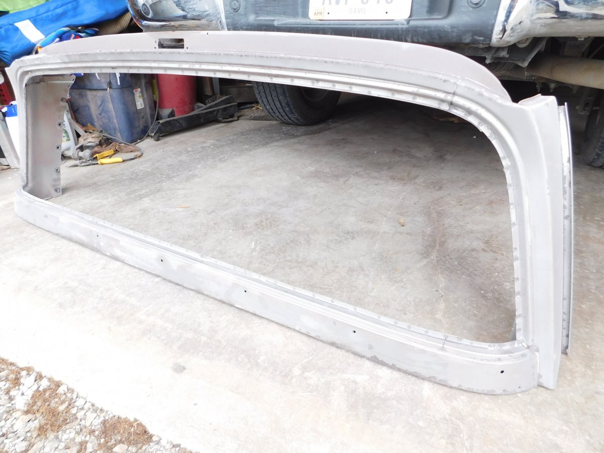

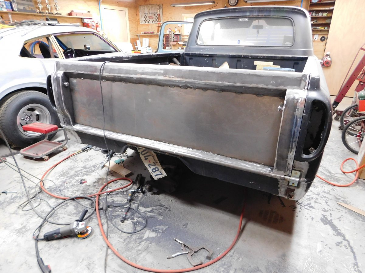

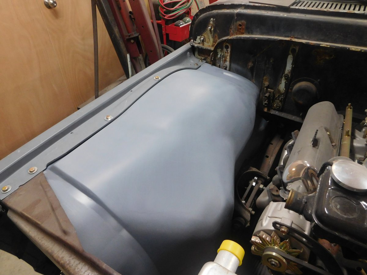

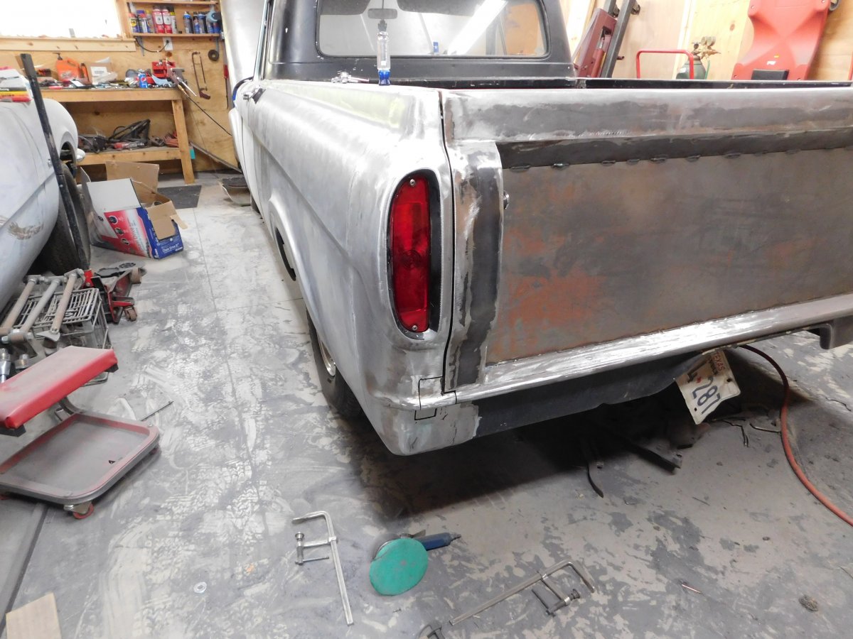

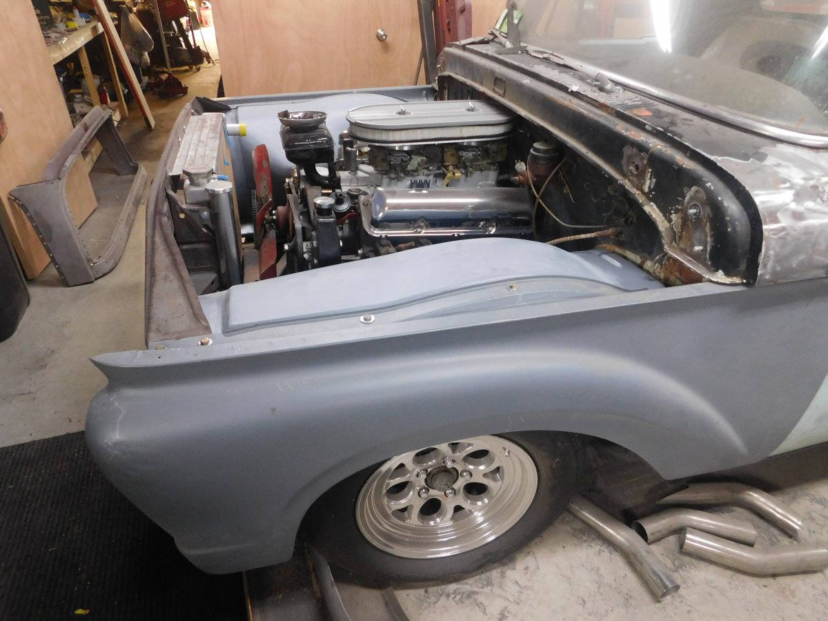

    Since this post is back on the top again, thought I would update a little progress on my '62.
    Put in an Industrial Chassis/Dakota front suspension.
    Built a smooth tailgate and frenched the hinges.
    Got it ready for a big window section in the back of the cab.
    Re-worked the inner fenders so they were mirror images of each other.
    Mounted the 390 (with a 428 crank) and C6.
    Tightened up the taillight openings a little. Also welded all the box cap seams.
    Also started the interior. Scat buckets and Ididit tilt/shift column.
    Also have a 4 bar and panhard bar for the 9" rear going in next.
    100_4009.JPG DSCN0018.JPG DSCN0625.JPG DSCN0812.JPG DSCN0814.JPG 100_4009.JPG DSCN0816.JPG

    Removing leafs is fine, just do three at first every other one. Keeping the main leaf and start from there. Depending on how tired they are you might get the drop you need. There a lot of variables though. Some shops don't want the responsibility messing with springs. But occasionally you can find one. It's takes a lot to drop over 4 to 6 inches. Flipping axel, maybe drop axel, just remember you'll have to start compensating for the steering and ride when you lower things. To eliminate any bump n steer you should raise steering box the amount you lower. However 2 3 inches may not have to. Just my 2 cents.
