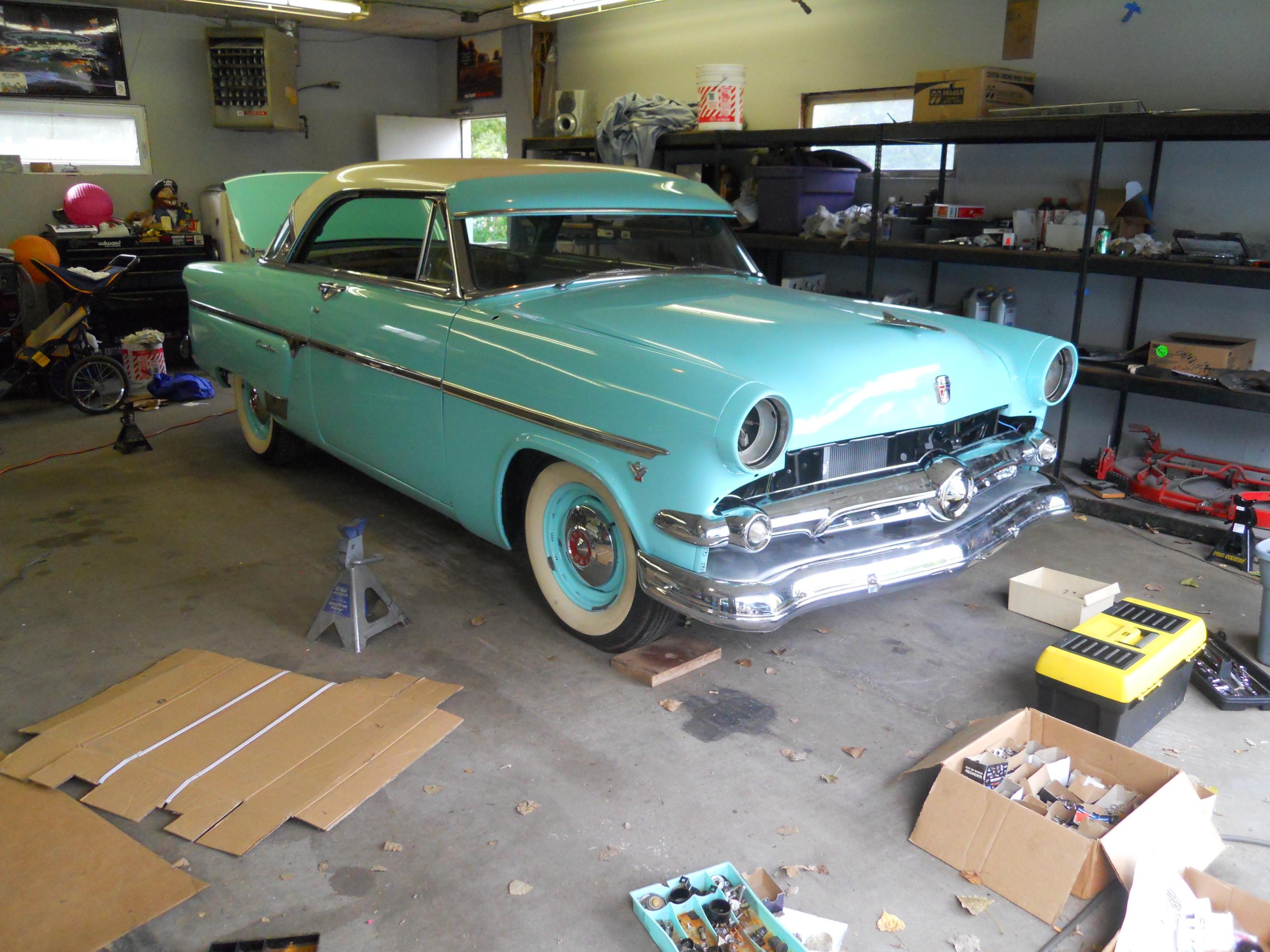

    here is one more. i set a fender on just to see what it looks like. i will say im happy with the way it looks, but im hoping it settles another 3 inches!!!

    Baggs, I can't remember- did you go with the Aerostar springs in the front yet? She probably will settle a bit, but those will definitely do the job.

    Well i bought a set of "dropped" spindles, (fatman). plus all the granada brake parts. i have a photo of the car from way back when it was bought. it is def. lower than it was in that picture. but not much. i also cut one coil off of the springs in the front. i also have two inch blocks in the rear. i know the car doesnt have all the weight it will in the future. there are no fluids, not front end etc. so maybe with the added weight it will come down enough. if it doesnt i will either get the areostar springs, or the lower a-arm spacers. and add another block in the rear. im just a freak when it comes to how something sits. if it doesnt sit right i dont like it no matter what. i have a vision in my head of how it should look and it has a ways to go!!

    Even if the cut coil gets you where you want to be height-wise once everything is hooked up and in, the Aerostar springs will give you a VERY noticeable change in handling. I have heard the exact opposite of cut coils. And, for under $100 brand new, how could you go wrong? Good luck!

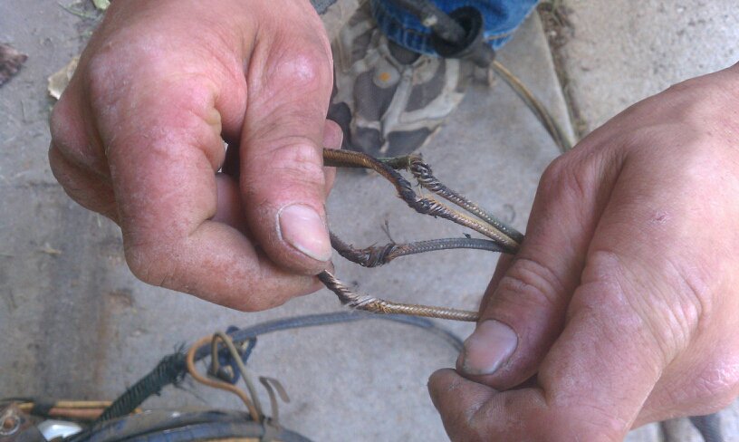

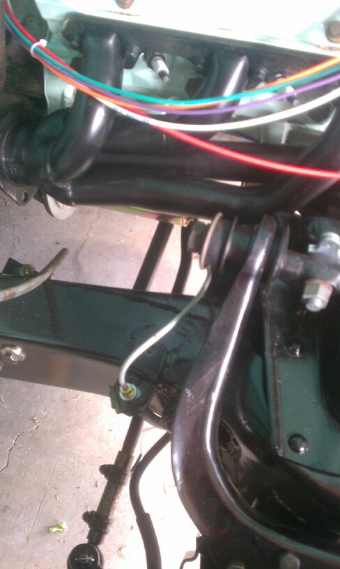

    ok, so its been awile since i have updated my build. i have made some really good progress in the last few weeks. i re-bought my headers and some other parts. got the headers installed, finished up all the brake lines except the ones that run up to the master. got my new radiator in and it looks great. got the core support in. pulled out my original wire harness, and thank god because there were alot of nasty wired up under the dash. got a new rebel wire kit half way installed. finally got my gennie shifter swan stick and installed that, and it fits great!! finished all my fuel lines. so all in all i have been busy lately and im really trying to get this going in the month of september. its looking promising. with some help from slim53, and bryan6902 i should be driving next month!!! here are some photos to show what ive been up to, thanks for looking!!

    the headers are hedman. number 88400. someone on the 52-6 social group was able to find them. they fit perfect with the 302 swap on these cars. there were under 200 bucks too!!

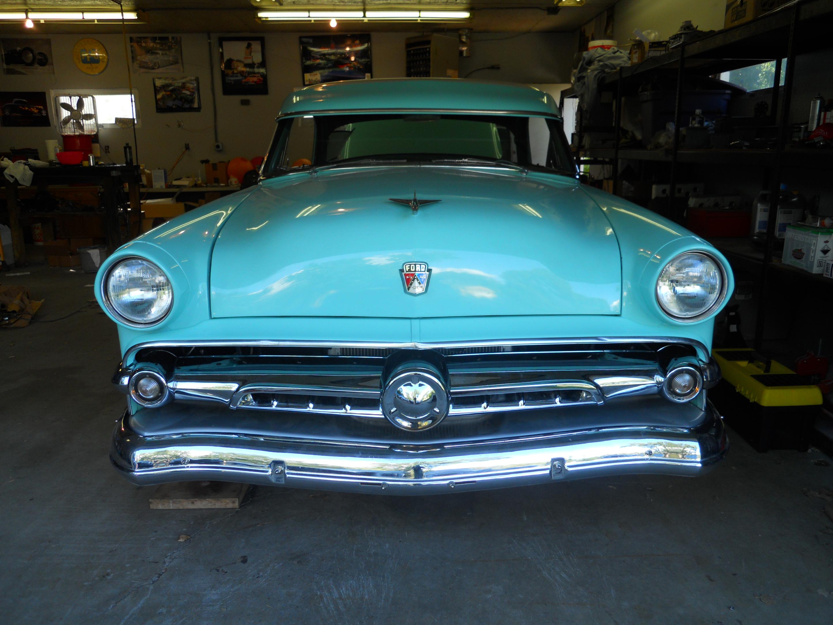

    ok so its been awhile since i have made a progress update, but i have been busy working on it trying to get it ready for a fellow club members party on the 24th of sep. so here is some updates. i have many more pictures than this but i thought i would just cover the major steps. so as the car sits now i have the exterior 100% put back together including the grille, and for those that have played with a grille for a 54 ford you know how BIG of a pain they are to assemble!!! but i got it done with minimal damage to me and the grille! i have all of my brake lines finished, and master cylinder in, all shocks in, 85% of the new rebel wire harness installed, trans cooler lines made and installed. i also flipped my trans crossmember to allow the back of the tranny to drop for a better angle. this also helped me out inside the car so i dont have to make such a huge cover for the floor shift. i also got the gennie shifter stick installed, no shifter knob yet (still deciding on it). undercoated the floors, got my autometer gauges installed for the basic things, oil, temp, voltage. installed my holley carb, and the lokar throttle linkage, cable, and aod kickdown cable. glad i bought the good stuff on this one, everything worked together well and the way it should. im sure im forgetting some things but i will post them up as i remember. so the plan for the car now is to finish up all the wiring inside the car, prime the oil system, drain and fill the tranny and install a new filter, have an alignment done, exhaust done, and install my fuel tank, (not in that order of course). the plan is to have it road worthy for a party called the Bull Bash put on by a fellow hamber and a fellow scavenger on the 24th of sep at his house. a interesting thing also is that labor marks one year exactly that I and ssleeper pulled all the parts out of the shed and started this project. not too bad for my first build i thought!!!! its getting there and i have had a lot of help from bryan6902, slim53, bull, sleeper, ringo57 and many others in this journey. thanks to all and i cant wait to go cruising with you all!!!
