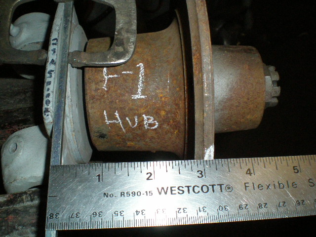

    I can't tell you the difference in offset between the two but I can tell you that the '40 style hubs work with Buick drums and F2/F250 12" bendix style backing plates on 37-41 spindles. The OD of the '40 hub mounting flange gets turned to fit the flat mating surface inside the Buick drum; a hub to drum centering ring is created and the drum is redrilled to the 5x5.5 BP.
    I know that others have used F1 hubs with the bearing conversion for the above brakes and spindles. I haven't tried it but I do know that F1 hubs and F100 hubs have different offsets as shown in this photo that I lifted from RICH B on this site;
    It is interesting to note while F1 and F100 backing plates interchange, the hubs and drums interchange only as a set.
    If anyone can measure any offset difference between a mounted '40 hub and a bearing-converted-and mounted F1 hub on the same spindle, I would love to know.
  3. The inside mount '40 Ford type hub measures 3-1/8" from the face of the backing plate
    flange on the spindle to the outside face on the hub.
    The '48-'52 F-1 hub measures 3-7/32" from the face of the backing plate flange on the spindle to the outside face on the hub.
    Didn't measure one; but the '53-'56 F-100 hubs would be about 1/2" closer.
    Measurements were made with a straight edge and a steel rule, so they are not down to
    the thousandth; but close enough for this kind of stuff.
    Added a couple of pictures for reference.
