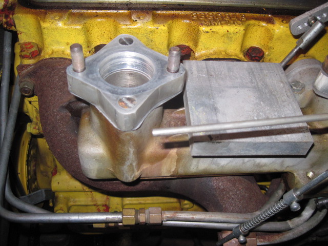

    The only way to get it 'smooth' is to turn the carbs 90 degrees - I spent over 2 years trying to make a 'sideways' progressive linkage and could never get a system I was happy with. The problems were binding and/or not getting WOT on all 3.
    Last winter I fabricated spacers to turn the carbs, and after making my own extended throttle shafts I was able to use 'V-8 style' progressive linkage. It works great.

    The adapters really don't look 'billet' - in fact, now I want to polish the Offy manifold - my 2 carb Offy was polished aluminum and I really liked the look.
    I started with a countershaft-type design but just on a bracket at the center carb; I was going to go with a long countershaft when I got the idea to turn them. You would still have to extend the throttle shafts.

    Sounds like you have a good system. How about a pic?
  11. Dave Downs
    Joined: Oct 25, 2005
    Posts: 949
    Dave Downs
    from S.E. Penna
    OK -
    PS - Engine compartment detailing scheduled for this winter :p

    Dave:
    Those adapters turned out nice. I am thinking of a way to do that and combine it with a phenolic spacer to serve two functions: Thermal break and 90 rotation.

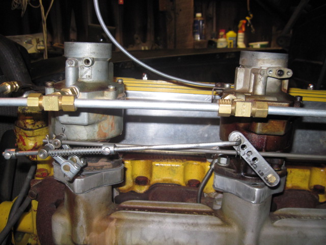

    Here is my version of solid linkage for duals:
    Other side:
    My idea for a progressive triple would build on the concept above. Both end carburetors use a continuous siamesed throttle shaft. The shaft will p*** through a spacer at the middle carburetor. Middle carb gets the throttle linkage and an extended throttle shaft. Non-throttle connected end gets a lever that feeds the end carb shaft. That is about as simple a system I can come up with. I will experiment with this idea over the winter...after I source a triple intake.

  14. Dave Downs
    Posts: 949
    Dave Downs
    from S.E. Penna
    1931av8 - I was originally thinking of making the adapters from phenolic or a similar insulating material but was worried about strength. I haven't had any heat-related problems with the aluminum; my intake is water heated, not exhaust and I really haven't driven in any long, hot situations.

  17. Curt B
    Joined: Oct 15, 2009
    Posts: 325
    Curt B
    Yup. the fine threaded ball joints in my setup provide for extremely fine adjustability making it real easy to get them singing in harmony.
