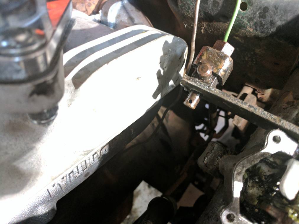

    Okay, have the back bolts taken off the bracket the holds the H-Box but not understanding how the box comes off.. does it slide all the way down off the shaft? If so, I think my external oil line is going to be in the way.... Neither of my manuals are showing this too well. :(
    Sent from my Pixel using The H.A.M.B. mobile app
  2. 302GMC
    Joined: Dec 15, 2005
    Posts: 8,477
    302GMC
    from Idaho
    Look on top of the mast jacket - should be a coupler in there ...

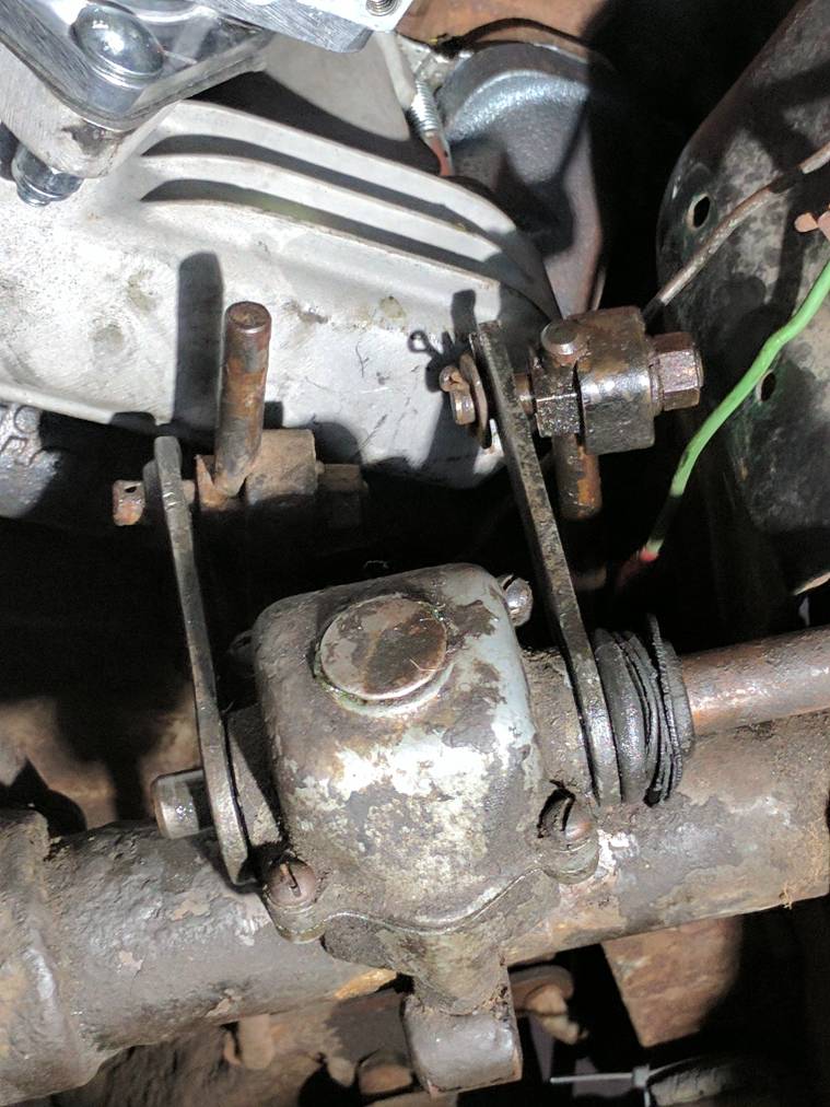

    Okay everyone, how do I get this piece of so I can drill new hole?
  4. 302GMC
    Posts: 8,477
    302GMC
    from Idaho
    The whole box is supposed to be out, in your hands ... like, loose ...

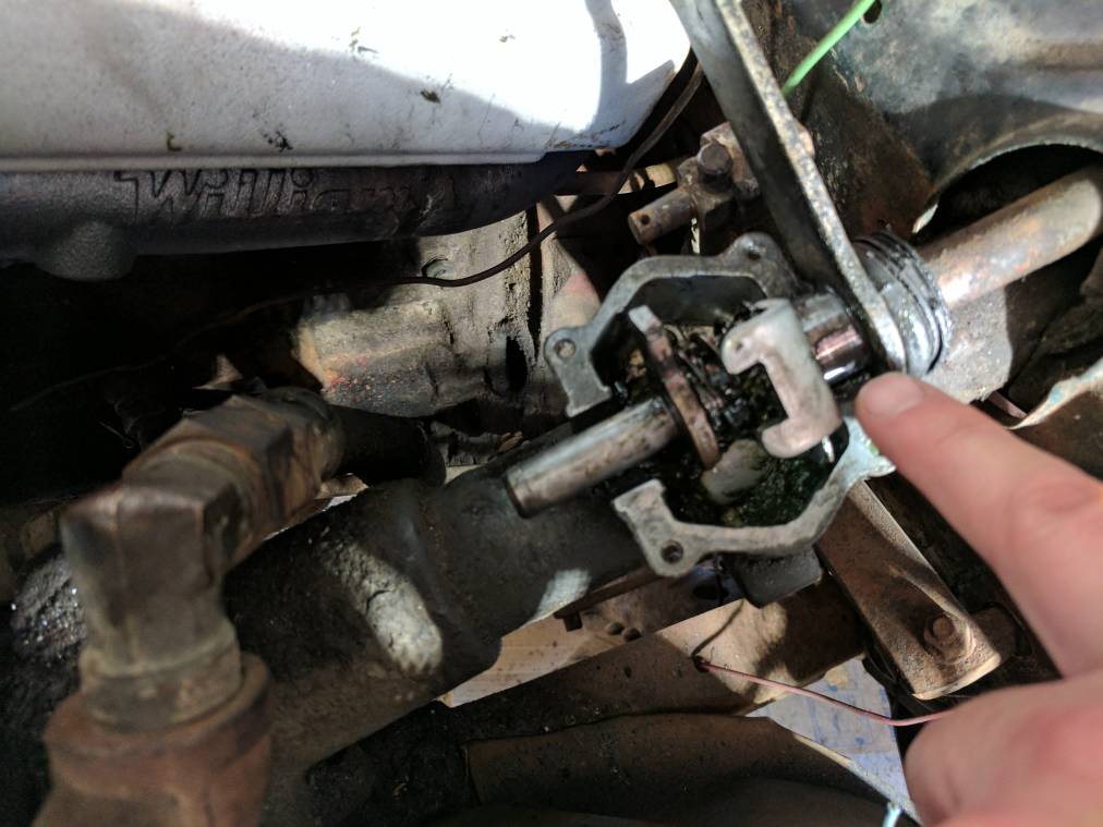

  5. Matt Davis
    Joined: Sep 25, 2016
    Posts: 238
    Matt Davis
    That would not make a difference though, I'm trying to get that bar off the shaft so I can drill a new hole. If I remove the bottom portion of the box I'm still in the same situation.

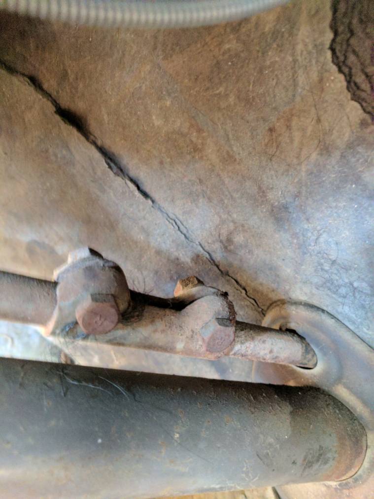

    OK .. look inside the truck, up by the floorboard. Isn't there a coupler there to separate the shaft coming from the H-box to the column shift control ?
  7. Matt Davis
    Posts: 238
    Matt Davis
  8. 302GMC
    Posts: 8,477
    302GMC
    from Idaho
    TAAAA-DAAAAAAA

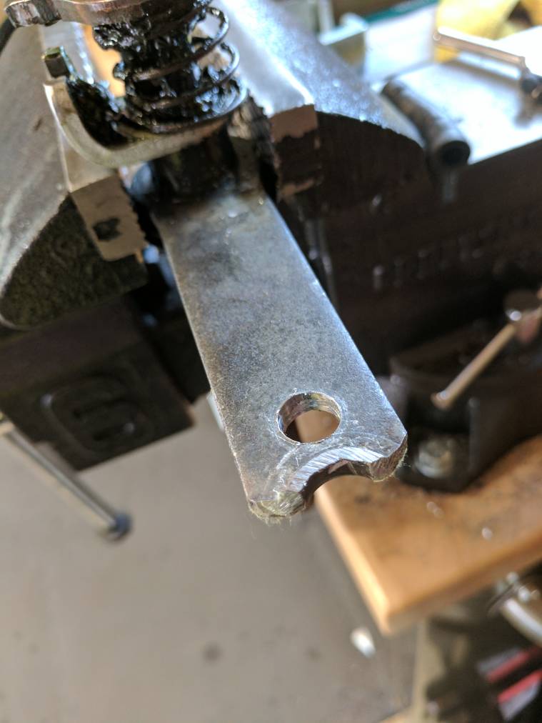

    Outstanding ... now file the face of the end round & clean up the tool marks. Leaving it like that is bordering on R** R** workmanship.
