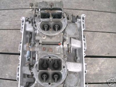

    ...than I come across THIS. The going bid makes the carbs seem like free. It's an aluminum factory FoMoCo. But being that my '57 Effie is a daily driver, and knowing gas prices in Humboldt, it seems suicidal to Mileage. Tempting, though...
    Anybody run with a 2/4 setup before?

    That Offy looks like a small port low rise single plane. The Performer is a low rise dual plane. The Eddy *Probably* benefits from a few more decades of R&D.
    As for the 2x4 setup, if you want to use a bunch of carbs, but maintain some semblance of fuel economy, you could always run 4 to 2 adapters on each plenum and use 2 Weber 32-36 Staged Progressive 2 Bbls.
    *Edit*
    Looking at that Offy pic again and it says "Dual Port"
    Is that one of those intakes where there's a set of runners for the primaries and a set for the secondaries, with the port divided about 2/3 top to bottom?

    Ive actually ran both the offy and the edelbrock, and I liked the offy better about 400 more rpm on the top end. I would stay away from the dual quads looks cool but headaches unless your racing it. Go with the offy besides not to many people have them old school ya know.

    I've pretty much talked myself out of the dual quad option, because of it being a daily driver, and the thing's thirsty as it is. For the NEXT ride, though. [​IMG] Anybody have any Edelbrock's for a 390 they want to sell?
