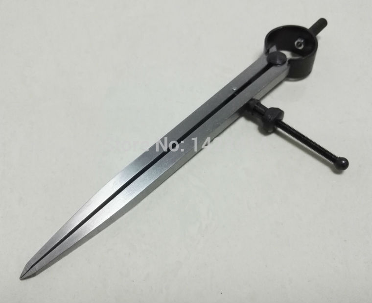

    Yup, that ****s. Ford 8.8 is the same way, broke them on my work van replacing axle bearings. You might try to find a metal comp*** or divider and use it like a spanner wrench. You can walk them out, if patient. HTB1CD0RNXXXXXX8XFXXq6xXFXXXU.jpg
    VANDENPLAS, loudbang and saltflats like this.

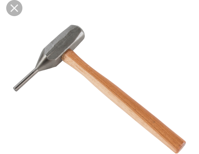

  16. Place punch on crosspin
    Strike punch with hammer
    Crosspin can now fall out
    Removing renaming bits of crosspin bolt
    blowby likes this.
