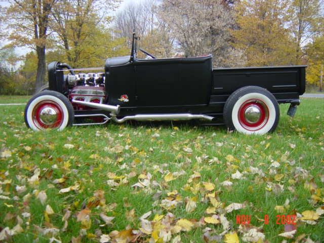

  4. Stay away from putting a flattened clear over a black base. I did it on my pops RPU and had a real mess. It came out too shiny but had a milky look to it. I quickly sanded it and covered it with a flattened black paint. I used PPG it is the same as the 2021 clear but in black. They said the formula is for bus and helicopter hoods. It's been this way for about 4 years now. It still looks great. It wasn't cheap but worked great.
    Here's the RPU.
