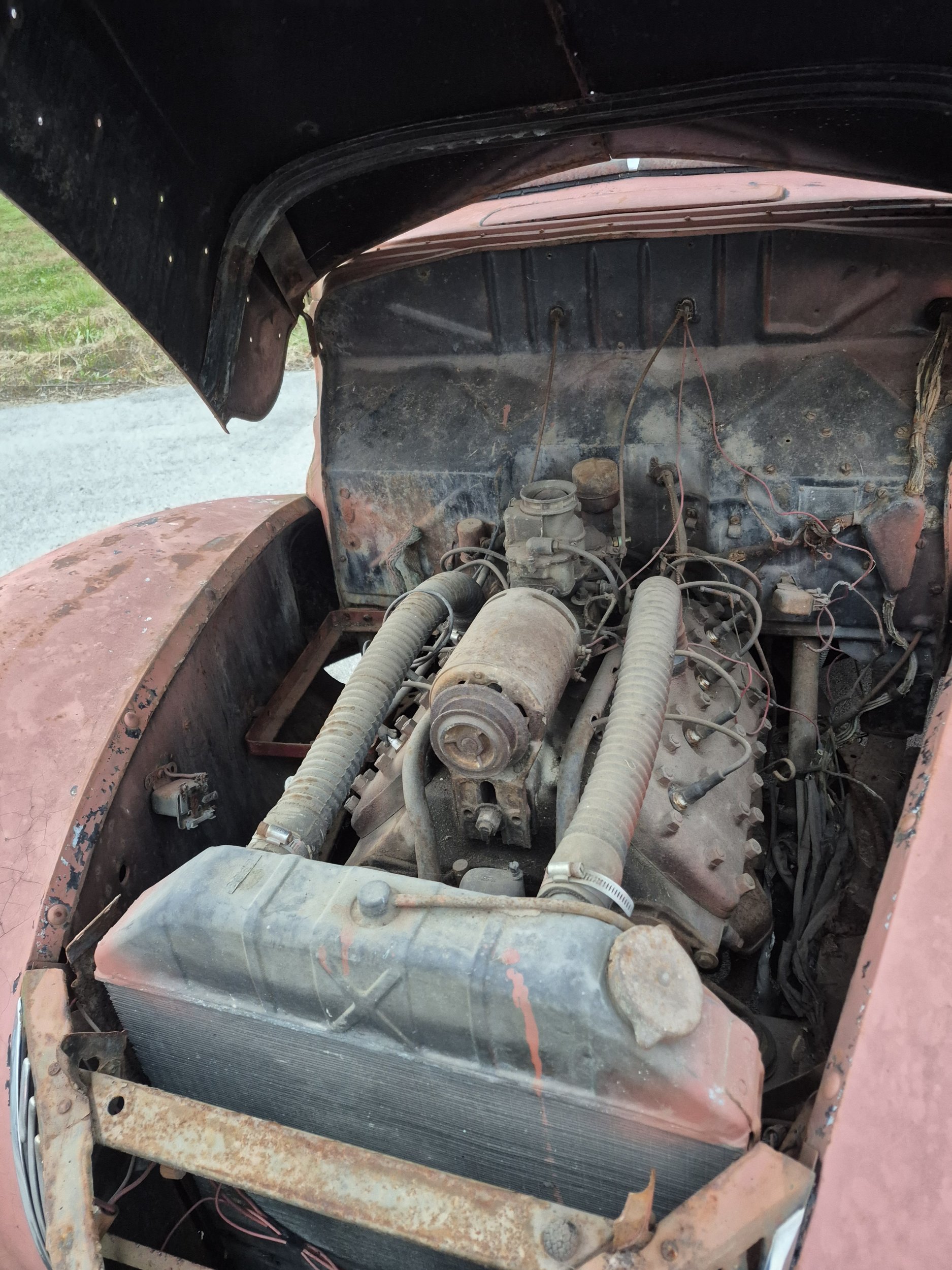

  22. oldiron 440
    Joined: Dec 12, 2018
    Posts: 4,026
    oldiron 440

  24. Lloyd's paint & glass
    Joined: Nov 16, 2019
    Posts: 10,882
    I figure it's rusted beyond running. The carb is froze also. I might look at it a little closer this week. But I seriously doubt that thing ever running. 20251101_182227.jpg

  26. warbird1
    Joined: Jan 3, 2015
    Posts: 1,353
    warbird1
    If the original engine isn't seized it just might run again, put some oil in the cylinders and see it will turn over with a wrench. If so, it may be less work to get it running than swapping in the late flathead... If the crank won't budge then go for the 8BA.

  27. Lloyd's paint & glass
    Posts: 10,882
    Oh it's seized lol. I just found a sbc to early ford trans adapter on marketplace for a good price. Might go that route. Or at least throw it in if I sell the car. I told Andy to keep the 8ba, I'm not interested in it anymore. Not worth that time.
