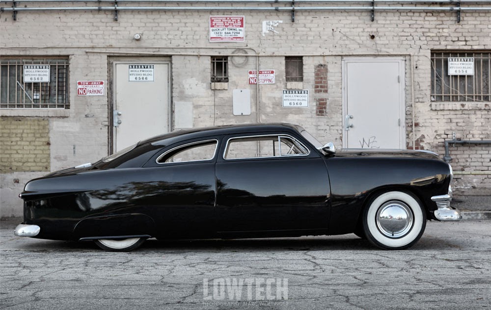

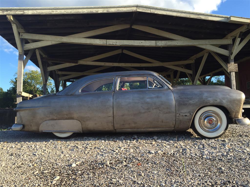

  13. the-rodster
    Joined: Jul 2, 2003
    Posts: 6,960
    the-rodster
    The chop looks like it will be in between mine (4 front 5 rear ).....
  14. the-rodster
    Joined: Jul 2, 2003
    Posts: 6,960
    the-rodster
    And the Chris Casny shoebox ( 5 front 7 rear)...

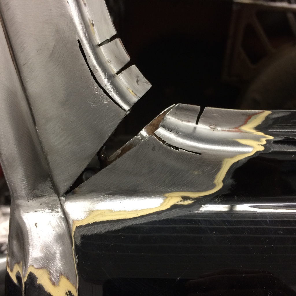

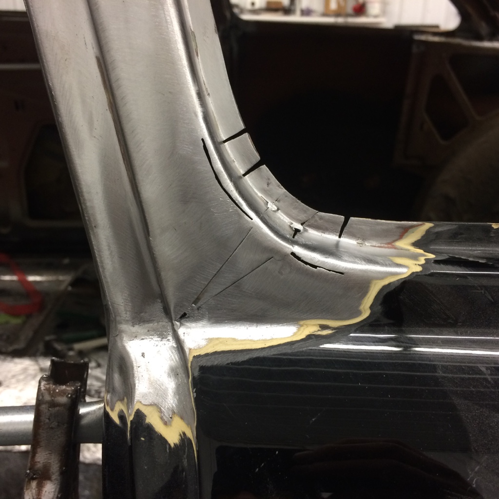

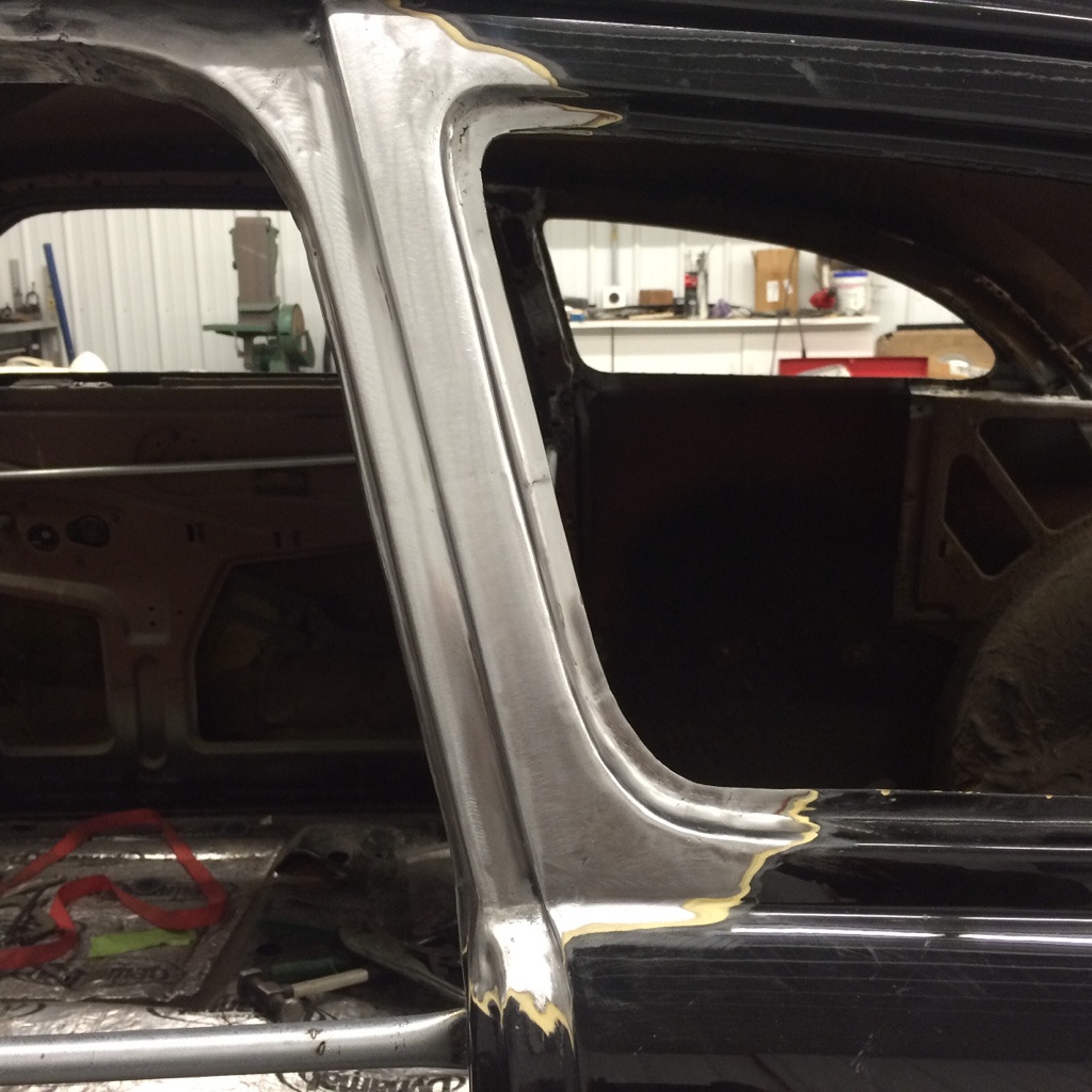

  20. I finished up the drivers side B pillar last night. Not much to show but here is how I fixed the lower corner. There's probably a couple different ways of doing it I think this was the simplest way. [​IMG]
    I put a few relief cuts in the pinch weld and cut around the outside edge of the opening. I tapped the inside down slightly till it looked like it had a flowing curve to the corner. I made a template out of poster board off the p***enger side so they would be the same. [​IMG]
    I made a little wedge patch out of 18ga to fill the gap. I have a old railroad rail I made a anvil out of. I used that to make the one part of the patch have a little curve to match the curve in the window opening. [​IMG]
    I always like to tack stuff together with the mig, then grind the tacks down and tig weld it all up. [​IMG]
  21. When I cut the pillars A, B and the door top I took the piece that was cut out and used that as a inner sleeve. It's helped line the two parts up better and gives it more strength. This is the section I cut out of the door top and used as the sleeve. I couldn't believe how clean it was. 67 years old , bare metal and that's all the rust it has. [​IMG]
