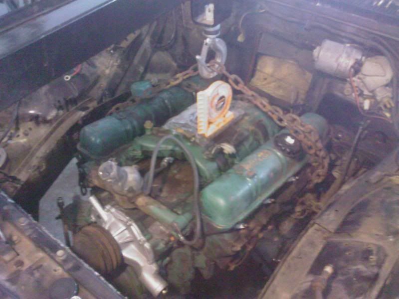

  9. BloodyKnuckles
    Joined: Apr 9, 2005
    Posts: 2,915
    BloodyKnuckles
    Great day today!!!
    I went to the shop today with a clear mind. I decided I was going to slide the engine under the car and slowly pull it up into the engine bay. With help from fellow HAMBer and friend Brad Todd we raised it into place. It took a while but we were able to get it moved around to allow enough clearance. The heater core location is centered on the firewall and is now the home for the distributer. I then fabricated the transmission mount crossmember. It took along time as well but I couldn't be more happier.
    Here are some pics from today;
    A shot of the shop from my car leaving at 1:30am...**** it's been a long day!
    The amazing thing about this car is it's interchangeability with the Electra. The transmission mount location is real close to the original ******. The linkage for the transmission bolts right up including the original frame pivot point. The speedo cable also fits. I have been surprised how similar the two cars are.
    Thanks for keeping up with my build. I have truely enjoyed everyones comments. It gives me a bit of a drive to continue. Thanks.

    So...I don't normally ask for this kind of ***istance because I like to figure things out on my own. That's what I like the most about building cars is using that lump of grey matter in my skull called a brain.
    I have the engine in the hole. The ****** mount is made and installed. Now I need engine mounts.
    Here is a shot of the frame and engine mount;
    Now I know I could come off of the frame mount with a piece of 2x2 to the front of the frame level and then attach mounting legs for the engine mounts to that but my thought process would be that it would look peiced together. Then I thought of plating the side of the frame and bringing the arch down lower and the attaching the legs, nope. On top of the engine mount I also need a location for a steering box.
    So how would some of you tackle this? I love the arch of the frame and would rather not block it with another frame rail. I could have already had this done but I'm not thrilled with what I think the final result would look like. So any bit of feedback would be great.
    ******Knuckles

    50 Ford 1963
    :confused::confused::confused:Quick thought, not knowing what the engine to frame rail space dimensions are... have you considered a cradle from frame rail to frame rail going under the front of the engine? You could come off of it for your engine mounts, and probably mount a steering box to it as well. Maybe fabricate a u-shaped mounting plate to fit around the frame that bolts in... you could still drop the engine out the bottom... :confused::confused::confused:

    Not really any ideas, but you should definitely try to keep the ability to drop the engine out underneath.

    This is one of my thoughts also. I will definately make it so I could still remove it from the bottom. I also need to figure out which steering box to use. I may just incorporate the steering box mount into the cradle. Good thoughts. Thanks!

    If it were mine, I think I'd do a lower cage that cradles the engine, and has the front suspension as well as the steering box mounted to it.
    If the cage were made out of "roll bar tubing", it could enhance the "maximum street effort" look without taking away from the existing lines.
    Also, as a complete unit, you could un-bolt the 4 or 6 places the cradle ataches to the frame, the "rag joint" from the box, and 2 brake lines, and then lift the entire body off the engine and front suspension ***embly.
