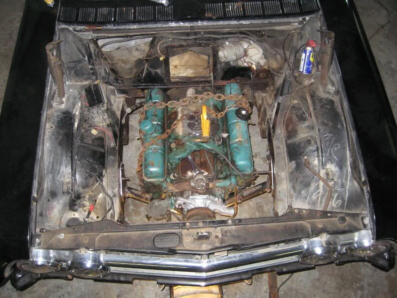

  12. BloodyKnuckles
    Joined: Apr 9, 2005
    Posts: 2,915
    BloodyKnuckles
    Here you go;
    Looks small in there huh?? That's the hole for the distributer that I'm using.

  14. Pir8Darryl
    Joined: Jan 9, 2008
    Posts: 2,487
    Pir8Darryl
    Since we are on the subject, and your taking pic requests, how about a shot from the front edge of the fender looking down into the engine compartment... Maybe drop a yardstick across the rad support, or just mock the rad into it so we can guage your water pump issues.

  15. BloodyKnuckles
    Joined: Apr 9, 2005
    Posts: 2,915
    BloodyKnuckles
    Thanks man,
    I will take a pic for you tomorrow. I could run the water pump set up the way it is but with out a fan. I want to run a mechanical fan so I need to pick up a couple of inches.

  18. BloodyKnuckles
    Joined: Apr 9, 2005
    Posts: 2,915
    BloodyKnuckles
    Here's the pics that you ordered. Would you like to upsize your fries and drink for $.25???
    What I'm pointing at is the brackets that hold the lower radiator tank;
    ******Knuckles

  21. Pir8Darryl
    Joined: Jan 9, 2008
    Posts: 2,487
    Pir8Darryl
    Yea, go ahead and up-size me. Oh, and add 2 more taco's... But make sure I get a diet coke. You know, gotta watch the calories. :D
    Ok, got a good mental picture of the water pump problem...
    How's about removing the A/C condensor, and replacing it with a smaller unit out of a newer car? Prolly be able to get one that's more efficent anyway. Then maybe move the rad forward 2 inches.
    The new smaller condensor could be secured to the front of the rad with zip ties like an oil or ****** cooler.
    The lower rad brackets look as if they are on clips that bolt to the core support... Shouldn't be too difficult to fab some simple new brackets that move it forward a little.
    How's the rad secured on the top end? Plate? or brackets? If it's a plate, a new one out of shiney aluminum could be fabed cheaply, and it would add some bling without being billet or gold chainer.
    If my idea would work, it comes down to the difference between your time to make the parts to move it, -vs- the cost of a new timing cover and short pump to replace what you have now.... 6 of one, 1/2 dozen of the other....
  22. BloodyKnuckles
    Joined: Apr 9, 2005
    Posts: 2,915
    BloodyKnuckles
    "If my idea would work, it comes down to the difference between your time to make the parts to move it, -vs- the cost of a new timing cover and short pump to replace what you have now.... 6 of one, 1/2 dozen of the other...."
    You know...you just made me realize that I need to just move the radiator forward. I'll have to agree with you. It won't take me long to move everything and it would be the cheapest way. I still think I'll be able to use the AC condenser but I will have to add a transmission cooler.
