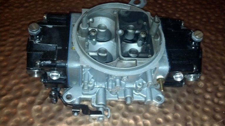

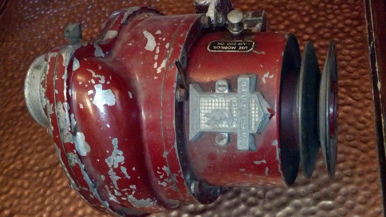

    Holy ****!! That was, seriously, the absolute best time I have ever had in that car. We never stopped laughing. Funny thing is, it took about 8 miles for all the spark plugs to clear out!!!!
    Brrraaaappppp, Brraapppppp, raaapp, raaapp, raaapp.....
    Hoping to pick up the Paxton and carb tomorrow.

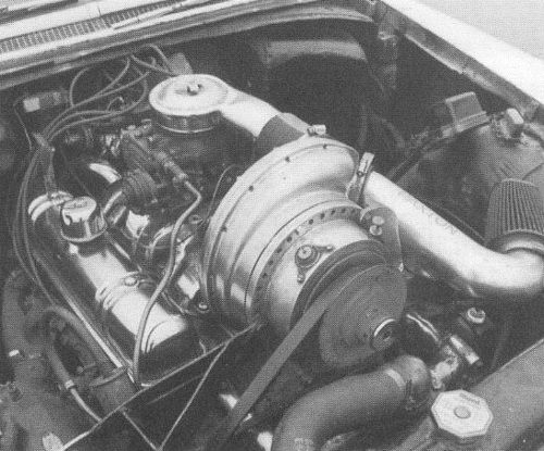

    As you requested;
    So I spent an hour and a half speaking with John Erb. Wow! What a cool guy.
    I plan to install it on the engine first then send it off to him after I know everything will line up and work.
    Baby steps....
    Inspiration;
