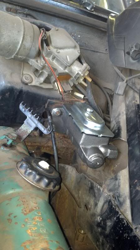

    So, a bit of an update. I've been working a lot lately so the car has been sitting for a few weeks.
    What I have accomplished;
    1.) I needed a new master cylinder, purchased a new 1969 Roadrunner dual manual drum set up. With a few adjustments to the push rod, everything works as it's supposed to
    2.) I've been struggling with radiator placement and fan interference. So with a ton of discussions with a close friend, I have decided to place an additional radiator in the trunk with dual electric fans. I will install the original one in it's place in addition to the one in the trunk, I should have zero cooling issues.
    3.) I figured out the steering column. I ran a 3/4" Borgeson from the box straight into the cab. I then used a 3/4" Heim to support the steering shaft. Done.
    4.) Spent time speaking with John Erb and the Paxton will be shipped out tomorrow. He is also supplying me with a custom cam to match the 401 and the supercharger. BIG increase in power.
    Everything is working out well, a bit slow but well.
    More details soon.
    ******Knuckles

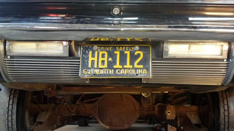

  30. BloodyKnuckles
    Joined: Apr 9, 2005
    Posts: 2,915
    BloodyKnuckles
    Today went well.
    Rear suspension is finally complete. Built a new upper control arm and man, is it beefy! The pan hard bar mount has been fully welded and now is complete. The rear axle is finally centered under the car. I just have to make 2 quick shock mounts for the frame.
    I also installed aluminum grating for exit air from the trunk mounted radiator.
    Here are a few pics from the last 2 weeks;
    Tomorrow is radiator placement and install.
    ******Knuckles
